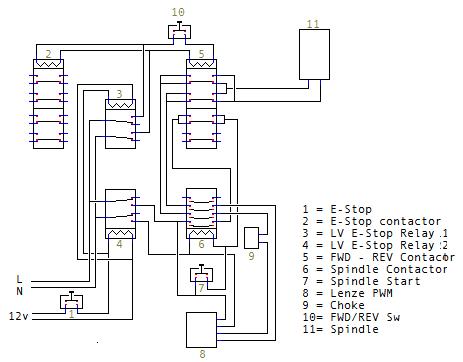

Ok then... Im ready.
Attachment 2636
:confused:
This is my basic interlock for the spindle direction change, ive stared at it for some time so i dont think there are any mistakes lol....I hope..
