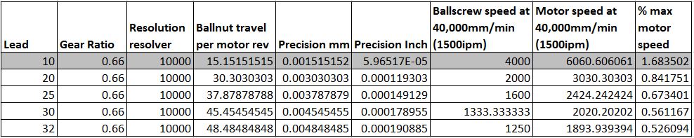

Sometimes I forget about the speed of the screw also being an important factor. I put together a little table for resolution based on ballscrew, based on my calculations I need to go with a higher pitch or up the gear ratio to keep the speed ~80% max. Upping the ratio of course hurts resolution so Im looking for a 20 pitch screw. Higher pitch also helps keep the ballscrew speed down, but of course hurts resolution per mm.
Attachment 17903
Thoughts on this?

Alright new table now that I got the gearing correct the ballscrew and motor speeds were correct but I took the ballnut travel per motor rev the wrong way.
Attachment 17904
So based on these numbers still looking at 25mm lead screw. With a ratio of 2:3
Ballnut travel per motor rev 25*0.66 = 16.5mm
Precision mm = 16.5/10,000 = 0.00165 (is this real? i.e. with a quadrature resolver will I truly get 10,000 counts per motor rev?)
1600 rpm ballscrew speed to get to 40,000mm/min (~1500ipm)
Motor speed of 2424rpm (67% of max motor speed)
So am I looking good here? The precision seems great and the speeds would be very acceptable with some headroom on the motor speed.

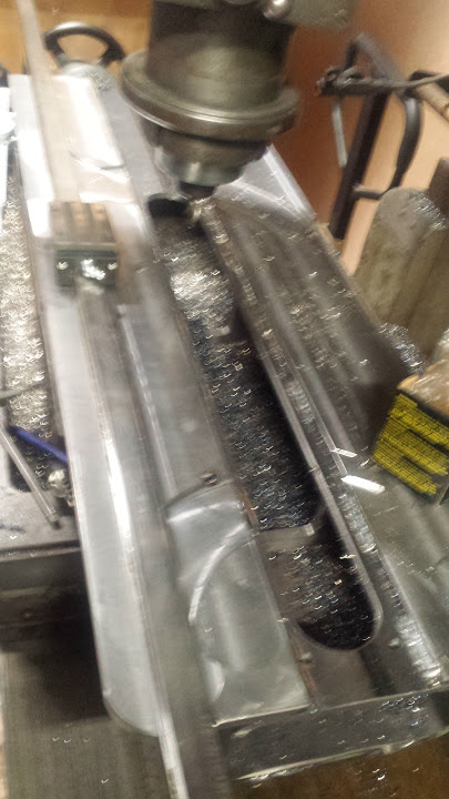

I got a bit done on the Z axis over the weekend. When I was laying everything out for the Z I decided that 4.5 inches between linear rails was not wide enough. So I welded on some 3/8inch plate in order to widen it to 8 inches center to center on the rails.
Starting the milled slot for the ballnut to travel
Attachment 17975
Slot cut through and now cleaning up the edges
Attachment 17976
Attachment 17977

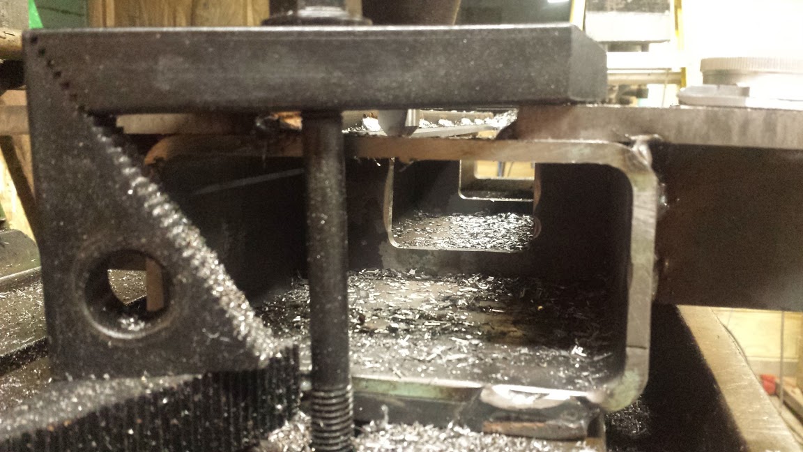

Internal view showing 2 internal supports. I figured these were needed to help keep movement to a minimum when I cut the large slot in the tube. They had to be driven in with a sledge as they were a little tight but I got them in. They are welded in place by drilling 3/8inch holes in the box tubing and then spot welding through those holes.
Attachment 17978
Begining the face milling process. I milled a linear reference for one of the rails. The curves are just the tool paths I had to take to make it all work as my mills travel isnt enough to do the whole thing in 1 pass.
