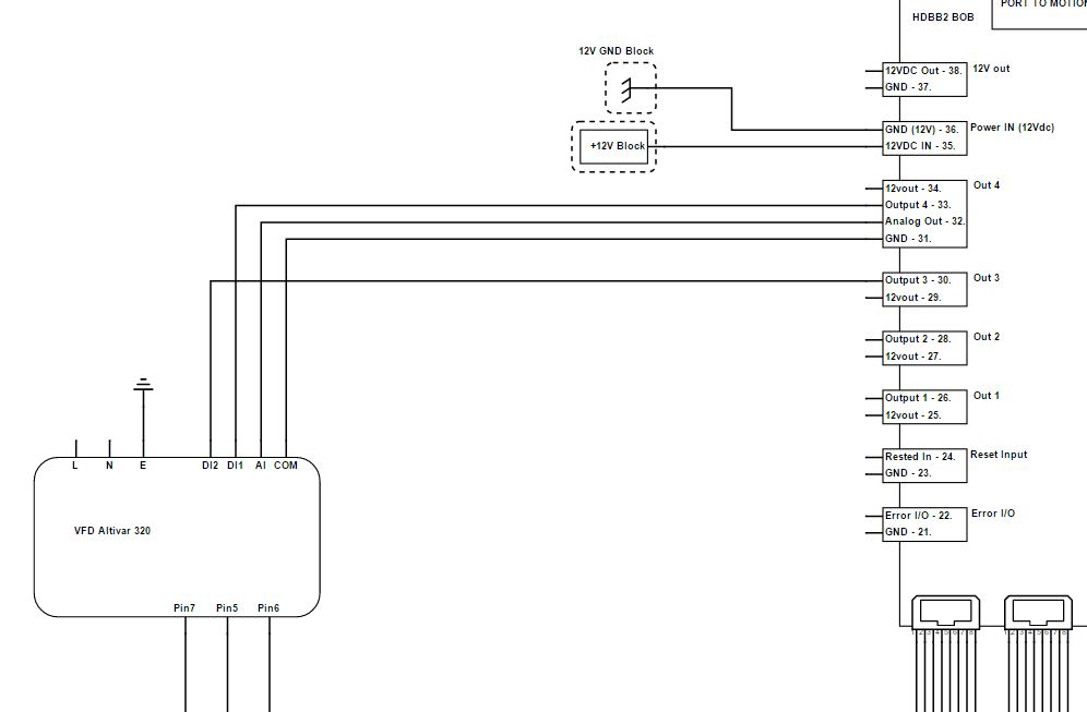

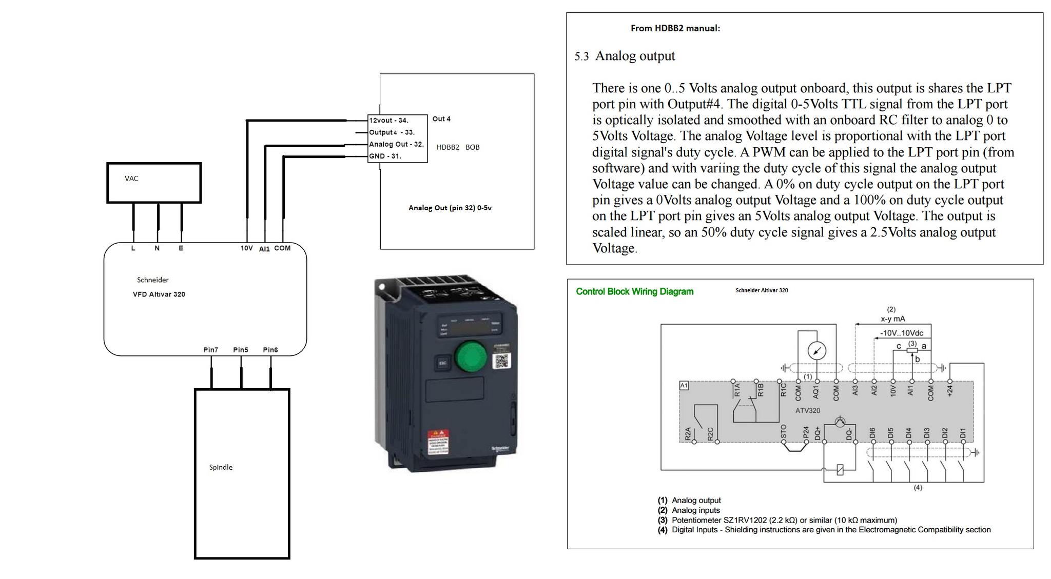

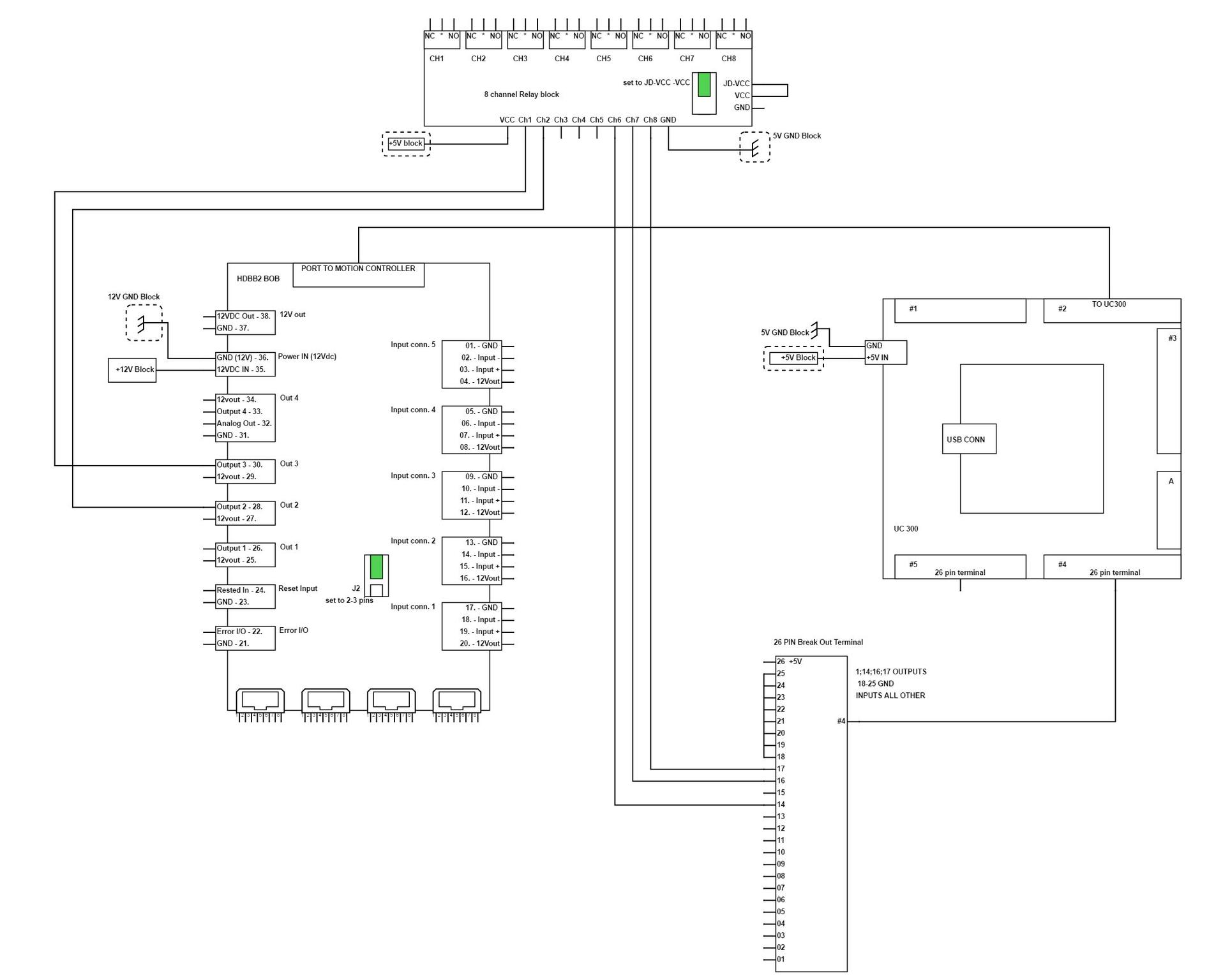

Here is wiring / information of the current setup:
Attachment 19260
Spindle Data:
Power: 800W
Current 5A
Frequency: 400Hz
Torque: 0.61Nm
Speed: 0-24000 rpm
Current Altivar 320 settings:
bFr [Standard mot. freq] - 50 Hz
tFr[Max frequency] - 400 Hz
Ctt [Motor control type] - uuC ([SVC V] : Sensorless vector control)
nPr - 0.8 kW
UnS - 220 V
nCr - 0.5 (5.0 A)
FrS - 400 Hz
nSP - 24000 RPM
Ctt - PErF
Ai1A - (Fr1): Reference source 1 (Dont know why - cant change this parameter...)
UiL1 [AI1 min value] - 0v
UiH1 [AI1 max value] - 5v
The problem is that I cant activate spindle through UC CNC (or activate at all :) ) . Am I doing something wrong here, either in wiring or VFD settings ? or miss some vital detail to do ?
Thanx ! :)

Re: Schneider Altivar 320 wiring / setup help needed
You have the BOB 12V pin connected to the 10V output pin on the VFD. This definitely looks wrong. No connection needed here.
Otherwise, analogue out and ground pins look fine. From the data you give, it looks as if you have configured the VFD for 0-5V speed input, which is correct for that BOB.
As m-c says, that analogue signal is just for speed control. You also need at least one connection from a digital output pin on the BOB to one of DI1-6 on the VFD. The VFD manual should tell you which pin but these can often be reconfigured. Look for an input called something like Run. There will probably also be an input marked For/Rev. However, sometimes these are configured as two pins, one for forwards and one for reverse. For normal router use, you can forget reverse as you only want to run the spindle in the forwards direction. So, you need the analogue signal to set the speed and the digital signal to turn the VFD on.
What software are you using to drive this - Mach3? This will also need to be configured to generate the right signals from the BOB.

Neale,
Thank you for your reply.
I assumed that the +10v shall be provided from external source. Thank you for clarification on that :) I have disconnected wire that goes from +12Vout to VFD.

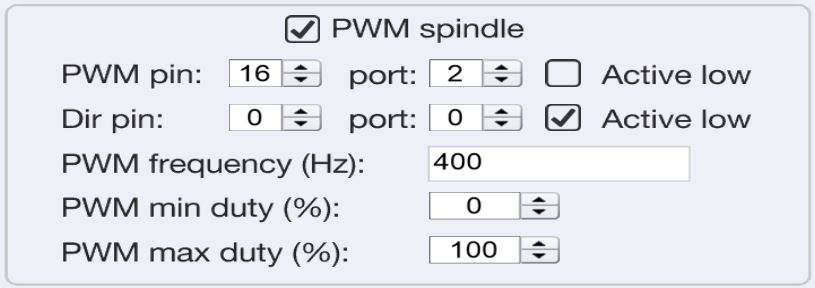

The software I use is UCCNC (purchased together with UC300 motion controller), and spindle settings are:

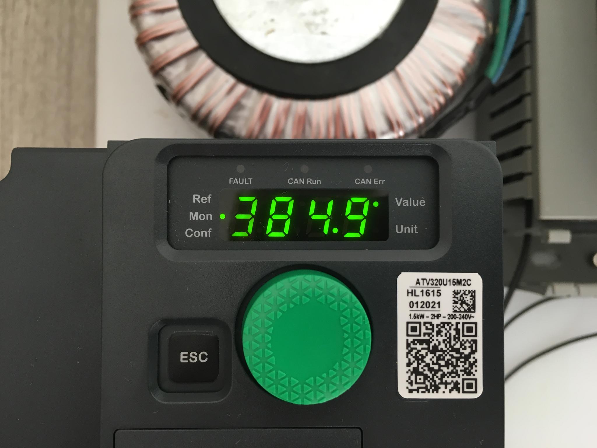

Attachment 19263
once M3S24000 is given through UCCNC app - the VFD shows close to 400hz (the voltage from analog out is not 5v however (4.5 approx)).
Attachment 19264

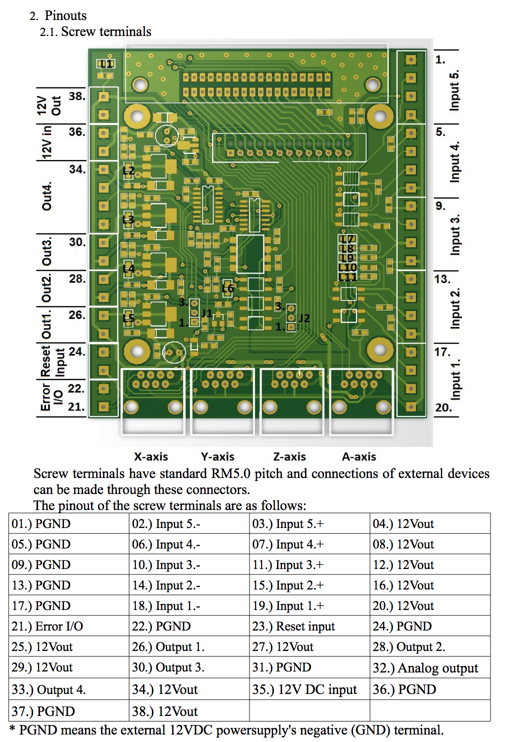

The bad thing is that for DI control I need 24V power supply.. I thought I will get away with 12 + 5 (HDDB2 needs 12V, UC300 needs 5V). But looks like not :) :)
Than the question is from where in the BOB i shall take digital signal for "start" "stop" signal, or maybe than it is possible to have forward and reverse control too (I know that VFD as capable doing so, but where to get signals to control that) ?
I have 3 AM882 connected to BOB and 1 output is free to use - can I use this as my "digital outputs" to VFD ? :

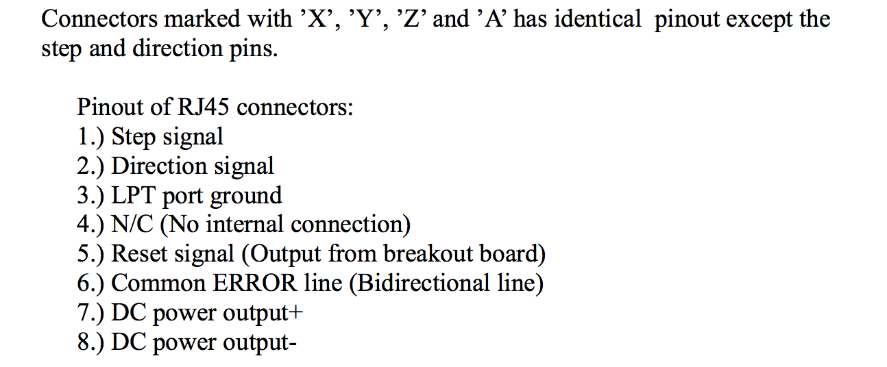

Attachment 19265
Attachment 19266

I have been having a look at the relevant manuals. Good news is that the BOB and the VFD inputs are compatible and you do not need any additional power supply. The installation manual, p48 in the copy I found, shows that there is a switch which will let you do this. See "Sink position using the output power supply for the digital inputs". The BOB outputs have a voltage and current rating that should be fine. Set the switch as shown in the diagram, and connect e.g. BOB pin 26 (output 1, LPT port 17) to the appropriate VFD DI pin.
Next job is to configure (or check) that the VFD DI pins are correctly set up. The pins are programmable - see Programming Manual p125 onwards. You should start by checking how these are currently set but I would guess that from the factory a couple of these pins are set to For and Rev by default. You will need to check the manual to find out how to read a parameter and then modify it if needed.
That's a start - I'm afraid that I don't have time to read the manual in great detail but I hope that that points you in the right direction. Overall, it looks as if everything should work fine once you have the correct pins connected and the VFD configured.

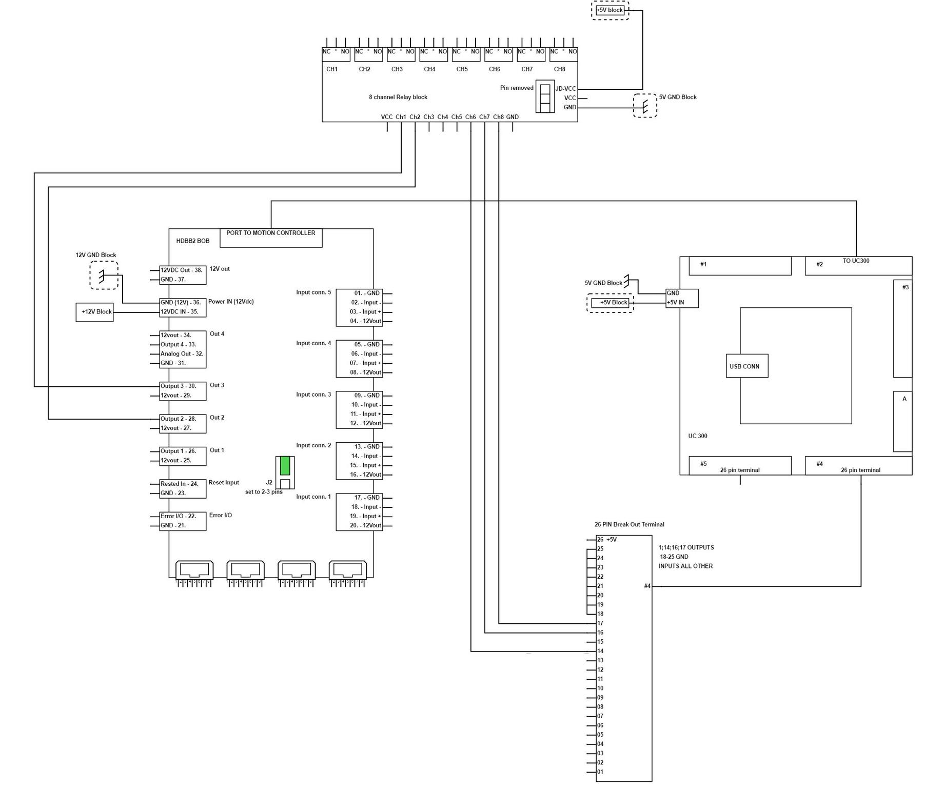

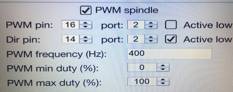

Here is my wiring at he moment:
Attachment 19284
Output 4 and Analog Output are activated together (PIN 16)
Output 3 are set as Dir in UCCNC software, activated with PIN 14.
I have managed to connect and use Output #3 as Direction signal. Settings in UCCNC:
Attachment 19285
Here is short video from the test:
https://youtu.be/5PCzQ_zcrys
However I have few problems so far:
1. When spindle is activated with "forward" signal (M3S24000), spindle goes up to speed and handles speeds down to approx M3S1000). The problem is with reverse - it goes up to speed all good with M4S24000, but once speed set to 12000 spindle stops. It is the same if I would try to start spindle with lower speed than 15000 - spindle just wont start. Sometimes this happens with FWD too.
I have tried search if there anything to configure in VFD - but no luck.
2. From time to time when reverse direction (M4) is given through UCCNC, spindle starts to rotate in FWD direction. Once stopped and reverse command repeated rotation direction is correct.
3. Once M3 command is given, spindle is getting up to speed and sometimes even at acceleration process UC300 giving message on screen that motion controller has been disconnected and everything stops. It is not possible to use spindle at the time as UC300 gets disconnected at any time once spindle rotation is activated.
I tried to play with SFr [Switching freq.] and at 16hz was total nightmare as the UC300 gets disconnected once spindle is started. Currently I left setting at 2hz as this option lets to get spindle up to full speed, but shortly UC300 gets disconnected...

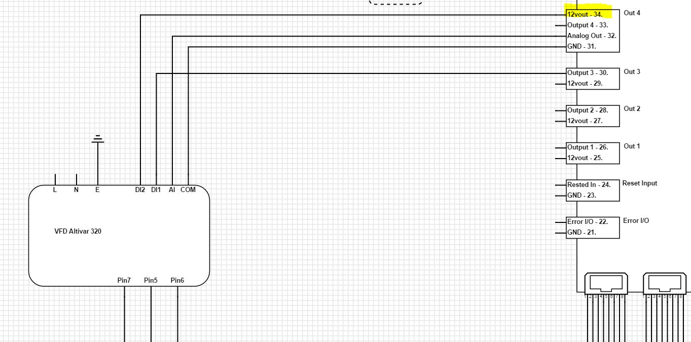

Gents,
Thank you for your help. Much appreciated!
All is working now as it should be (at leas t for now - until next idea or upgrade for the spindle :) ).
The problem was that I have used Output 4 as FWD (or REV output), the output from this pin cant provide stable voltage (probably due to used analog output as they are kinda combined... (HDBB2 manual). I have connected 12Vout (from output 4) to DI (as rev) and Output 3 to DI1 as FWD directions. Changed VFD settings as per Neale recommendations (FWD priority and Sensorless vector control) and all is working perfectly now :) Spindle can go down to approx 2000 rpm without stalling. Lower than 1000 is making spindle to stall.
Attachment 19341
So thank You gents again and I really appreciate your time for helping me out on this issue.
TM

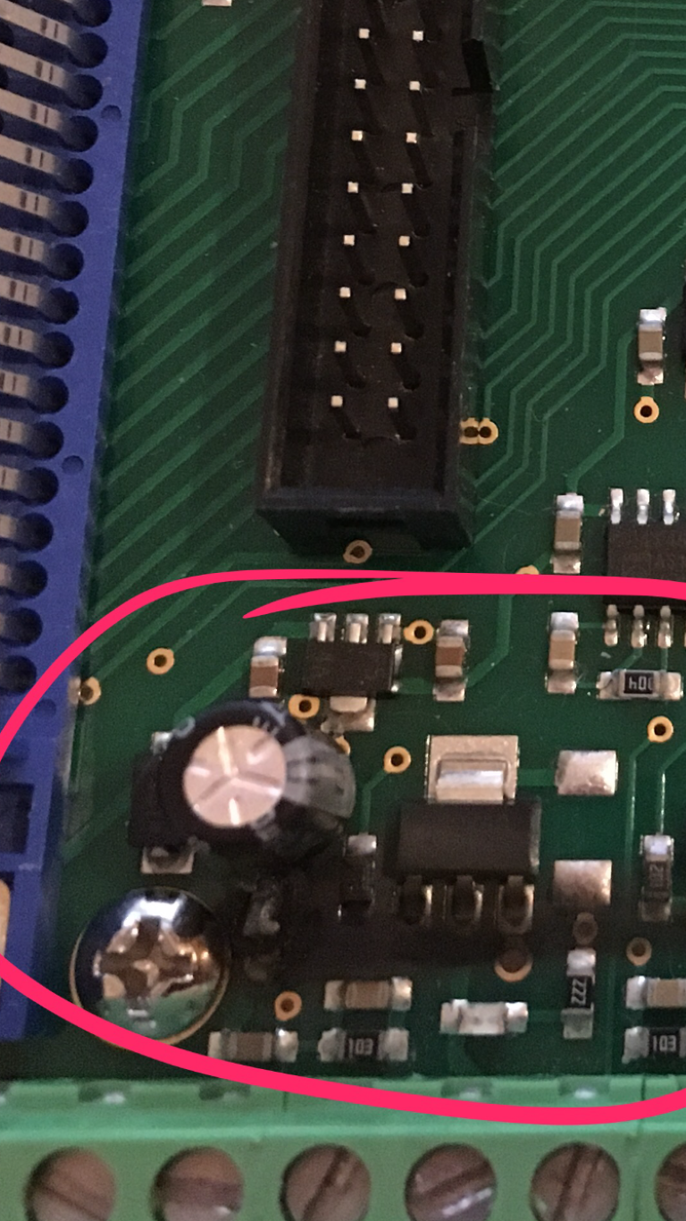

I must say that I don't understand how this is working! The hddb2 board has a constant 12V on the 12V output pins, not controlled by UCCNC. There should not be a problem with the output pins - they do not deliver any power, they are open-drain Mosfet outputs. In effect, an electronic switch with one side connected to ground. The manual shows that these digital output are completely independent of the analogue signals. That's why the VFD is configured to use its internal 24V supply so that you control it by switching the DI inputs to ground. I would not be happy to use this setup as it is now wired because I do not understand how it works at all!
Neale
I will make short video this afternoon to show how this is working and what problems I have if output 4 is used (instead of 12Vout). I was surprised my self - but after I just tried and it did worked :D

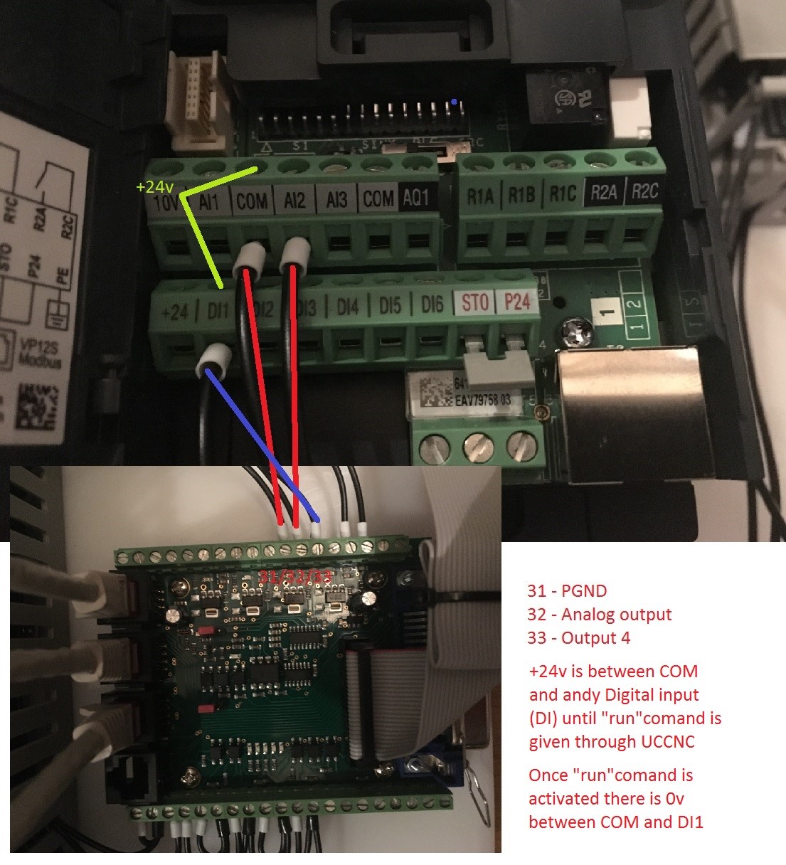

Hi again :)

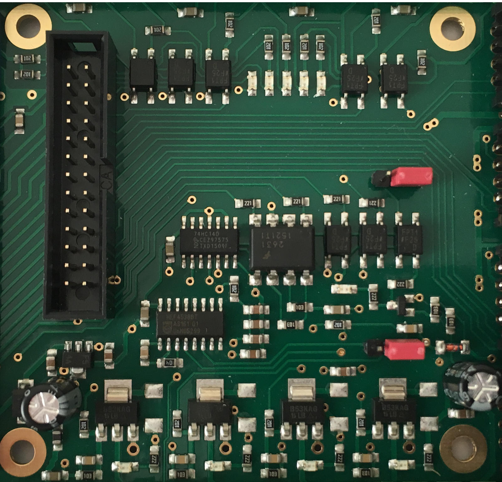

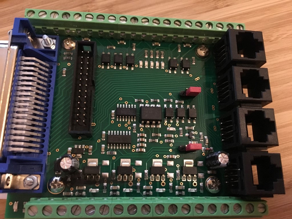

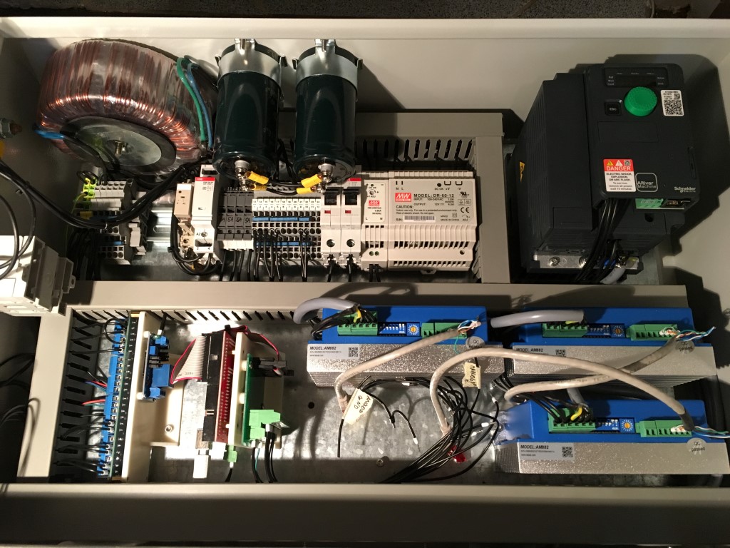

So finally I got additional information, here is photos showing how spindle is connected:
Attachment 19357
And here is the video showing the problem:
https://youtu.be/oXi-0nUM1AU
I have measured voltage between GND and Output 3 - it shows approx +24v when spindle is in "rdy" mode. Once I hit CW rotation in UCCNC voltage drops to 0v and as you can see in the video I receiving message that UC300 have been disconnected.
Should the voltage be 0v at idle and +24v when spindle starts to run ?
Lee, thank you for your advice reg. USB cable. Tried with shorter one - same results. I have added ferrite rings on the both ends of USB cable - no luck either :/
Any thoughts ? :)

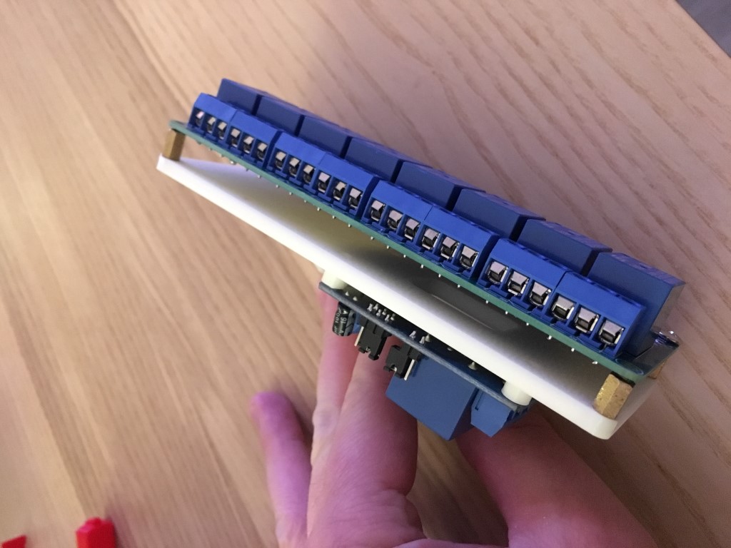

I think that I might have found the problem. Altivar installation manual, top of p48. "If using Sink Int do not connect 0V to ground". The manual is not consistent but I think that they use "0V" and "COM" for the same connection. Unfortunately, the HDDB2 has one side of its output connected to ground, so that this connection breaks the Altivar connection rules.
I think that the easiest and safest way to connect the two devices is to use an external relay between the BOB and the VFD. You can then use the Source mode on the VFD, which allows you to connect the analogue ground on the BOB to COM on the VFD (as far as I can see - but I have not read the whole manual!). If you use 12V relays, then you already have 12V available from the BOB. Connect relay coil between 12V and BOB output pin, and connect the relay NO contacts in place of the switches shown in VFD installation manual p48, first diagram. This is an example of the kind of relay that you could use although I do not know what is easily available in your country.
Neale

Gents,
Thank you for your help. I will do as advised - will use relays to control CW and CCW of spindle. I have ordered relay set from link provided by Lee Roberts. Will try and come back with results :)
One more idea I have, and I will risk to share it :untroubled:. UC300 have 2 analog outputs and those are without opto-isolator. Would this be a solution ? Or should I stick with opto-isolated outputs / relay confirguration ?
Another question I have regarding stopping spindle if e-stop is activated. At the testing VFD /spindle I had an issue that when UC300 gives message on screen that it has been disconnected - spindle is up and running anyway... I want to avoid that in the future. VFD has 2 relays that I could use for this purpose. Please see attached pic of the wiring I think to go with. I see that relays are 24v operated, can I use internal VFD +24V supply to drive the relays ?
Attachment 19360
Thank You
No, do not wire your VFD to BOB like that. That will put 24V on the output of the BOB which will probably destroy it. If the VFD has an estop input, you could take the output of the BOB to that so that it enables/disables with the stepper drivers, but this will need a relay between BOB and VFD, like the for/rev connections.
Neale
You can also set it to "Source" and use the internal +24V. Whichever you prefer.

Hi Gents,
I finally received relay array (8 ch). While I was waiting, reassembled all electronics to proper enclosure:
Attachment 19456Attachment 19457
While connected only power source, I have wired BOB power inputs (12v) and tried to power on and see if all is good. And my BOB gave some flash and smoke :nevreness: :
Attachment 19458Attachment 19459
and here is closeup before this :
Attachment 19460
I'm not sure how this happened, but I only see that the bolt I have used, head was too big (even before it was ok..) Anybody see other issue here ? I hope that new BOB will no act same...
Now I'm waiting for the new BOB to arrive and hopefully get everything going...
Where did the magic smoke appear from and exactly how did you connect it up.
Hi Clive,
The smoke came from the component in small red circle. Before smoke - it got very bright...
It was only 12V power wires connected to the BOB from 12V supply.
Attachment 19461

Finally received new HDBB2. Connected and all looks good - I can drive all axis finally :) Only one issue - don't know why, UC300, when connected to external power source of 5V (jumper settings correct) my pc does not see the board connected... Once I disconnect external power source, reposition jumper to use 5V from USB - PC can see the board and all works just fine ? Any ideas why is that and is it ok to use it without external power source ?
Also, I'm bit confused how to drive relays from two different sources. I want to use outputs from HDBB2 and UC300 to activate relays. Here is a diagram how I connected it at the moment:
Attachment 19476
But, the relays is not working that way... (I can activate them via Arduino with that wiring though). I could use this type of connected (external power supply connected to power relay coil, but from where I shall take 5v to activate relay ?)
Attachment 19477
Could anyone help / guide me how I shall wire the relay board ?
