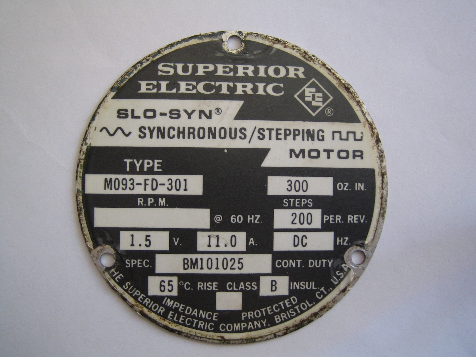

I'm replacing the old Superior Electric MO93-FD-301 stepper motors (see photo) on my Fehlmann Picomax 50 cnc. One is missing altogether and given the massive current requirement for the existing motor I'd like to buy a pair of new ones. Does anyone have any suggestion as to what sort of replacement would be suitable? The original motors are Nema34 but it's no problem to make up Nema23 adapters.
I was thinking of using closed loop steppers, but I can't get to the bottom of what would be suitable as a replacement and UK availability is limited.

Just about any Modern Nema 34 motor will beat those old round steppers so wouldn't worry too much.
Also I would consider replacing the drives with Modern Digital drives. Lead shine EM806 or AM882 drives are excellent drives and pair nicely with smaller Nema34 motors. There advanced resonance capabiltys are great for Mills which tend to be very stiff. It's Night and day difference in how the perform compared to old analog technology.

Without finding the datasheet for the original motors, 200 oz-in = 1.4Nm.
The HSS57 closed loop servo will work well. Just remember you'll also need to get new couplers/pulleys, as I'd guess the shaft on the original stepper shaft will be a good bit bigger than a modern Nema 23 motor.
Personally, I'd avoid the integrated stepper, not because it won't work, but because you need to run the step/dir wires to the motor. If you've not got differential (line driven) step/dir signals available, it makes things very prone to noise.

The nominal torque of the original motors is 300 oz in which is 2.1Nm - the machine's manual states the "maximum holding moment" as 3.2Nm.

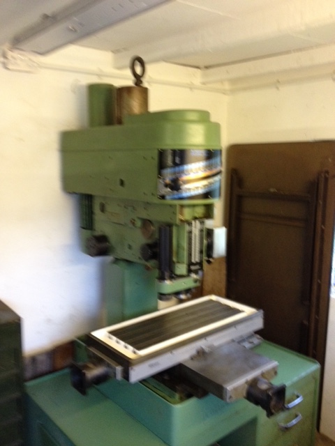

Just to give some idea of the sort of machine - here's a (bad) photo:Attachment 19670
As you can see, it's a kind of mill-drill. But don't be fooled, this thing is a beast weighing in at about a tonne. The table weighs around 150kg - hence my 100kg load per axis estimate. The motors drive the ball-screws directly.
Re: Superior Electric Steppers
My gut instinct for a machine like that with direct drive steppers, would be something in the 4Nm range to give plenty safety margin.
I think personally I'd consider altering things to use a belt drive with some Nema23 steppers, which should give you better performance. With big Nema34 motors, for best performance you've really got to use high voltage drivers, but you're then still limited at torque drops of quite quickly with big steppers.

Thanks. I had considered driving via a belt just in order to make the machine more compact. Would you gear up in order to increase the speed of the ball-screw relative to the stepper?
Opposite way!
You want to decrease speed of the ballscrew in relation to the stepper, so you get more torque at the screw. Somewhere around a 2:1 ratio would be a good starting point.
Try running some figures through the spreadsheet to see what kind of speeds you can get with different ratios, while still having usable torque to handle the cutting forces.

OK, that's certainly how I would have dealt with torque issues with a conventional motor, but I thought the whole point was that torque went down as speed increases. I see that gearing down, by say 1:2 would give twice the torque, but getting the speed up to 1800 mm/min (900rpm for the motor) for rapids will mean that the motor is well outside it's optimum torque region. Or is it the case that in practice this wouldn't be an issue?
