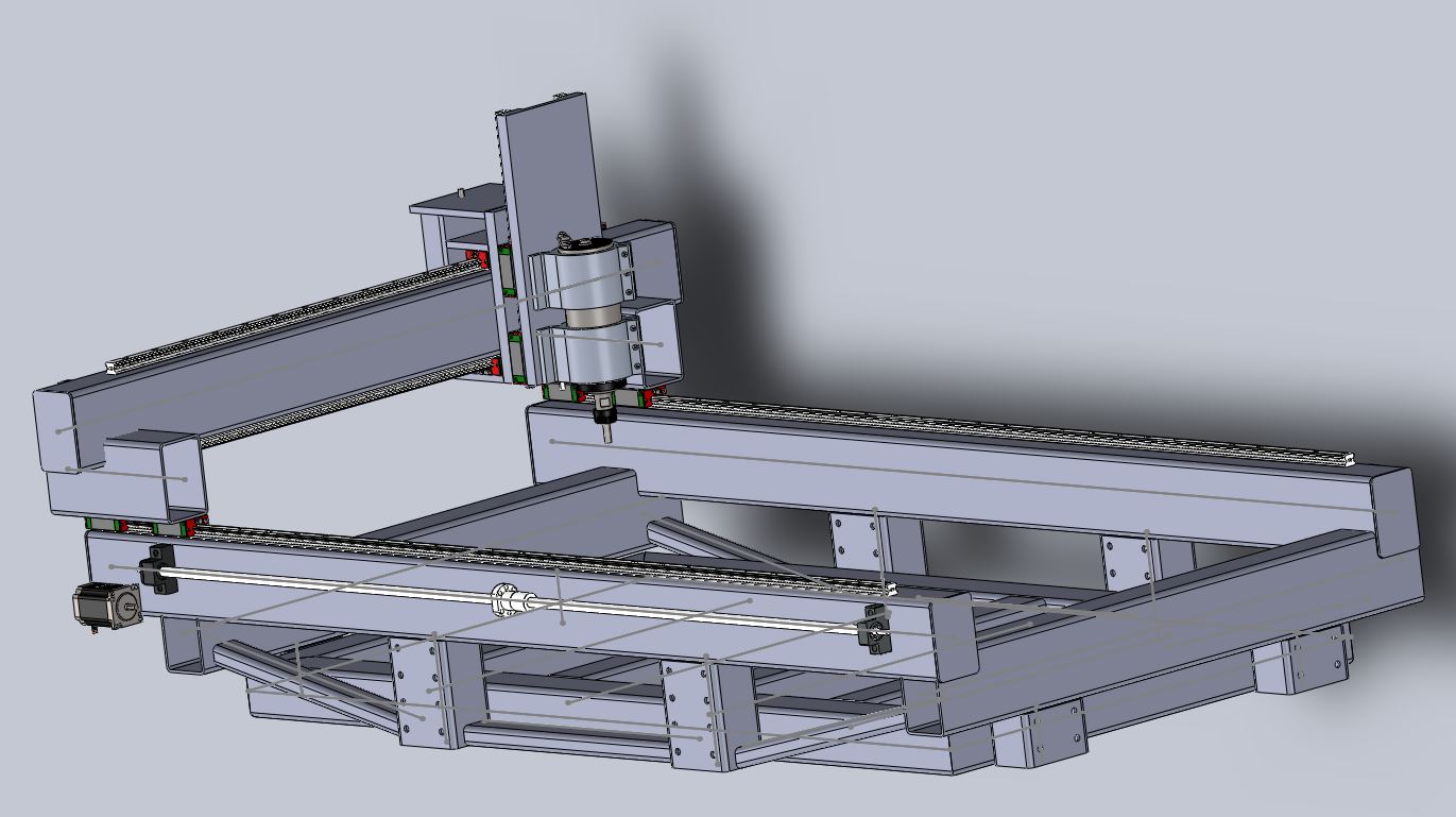

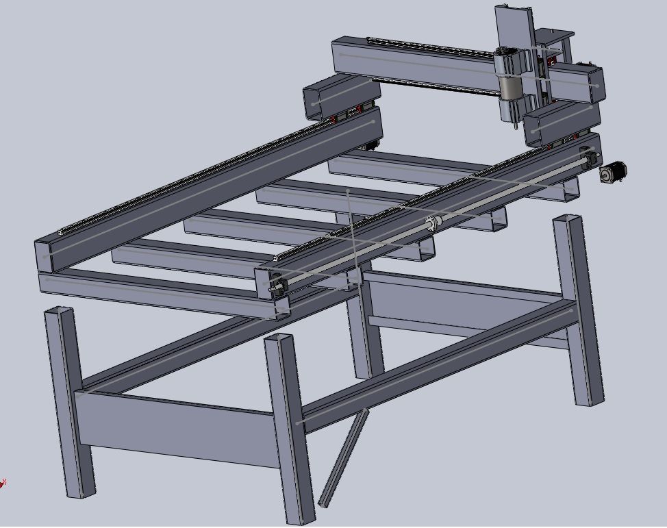

Yes... pictures... ill try to post on every progress..
Actually i started work on a design over a year ago.
1st the plan was to make an adjustable bed.
Attachment 22521
This over complicated the design.... or weakened it...
now the design is more basic.
Attachment 22522

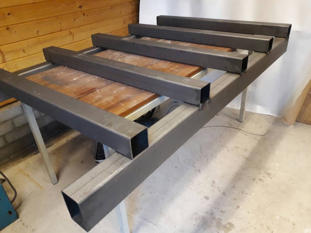

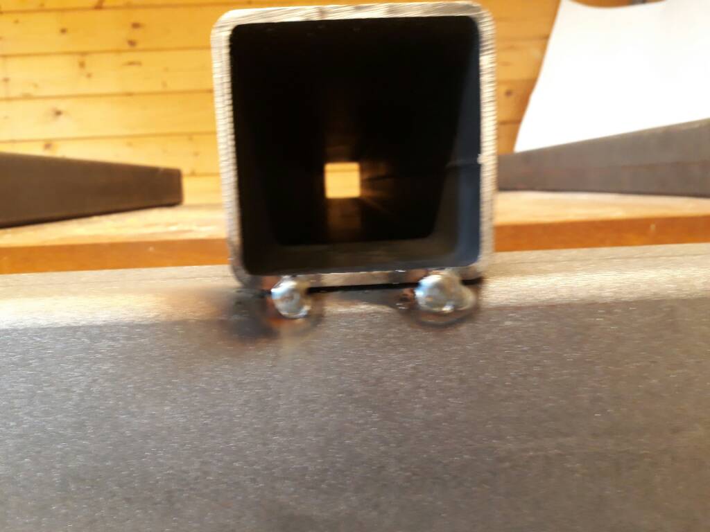

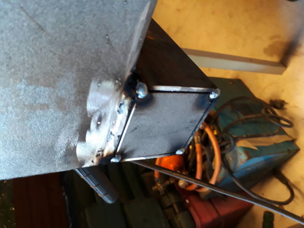

6 Attachment(s)
Re: MK1 Steel router build log 1500x800x200

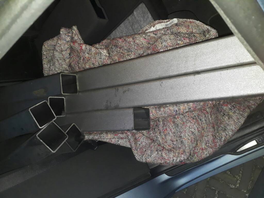

This is what the start of my cnc hobby looked like in the back of my car
Attachment 22523

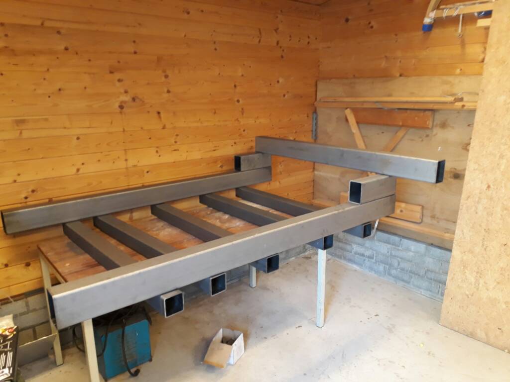

I spirit levelled the top of a standard used desk for setting up the bed box section.
Dont ask me why i did not start with the legs of the frame.
Attachment 22524
Ok .... its gonna be bulky...
Tag welding it up
Attachment 22525
Attachment 22526
Attachment 22527
Attachment 22528
After final welding i found out warping will happen...
Total distortion is now +/- 1.5 mm
1850x1160 mm total size.
I have read on this forum this could happen... But is was still more than i expected.
Epoxy has to solve this problem in a later stage...
More to come.

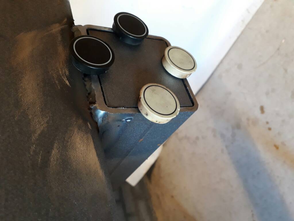

Ok some progress.
In the summer months the build did not get a lot of attention.
I did manage to get some of the steelwork done.
Did any of you run wiring through the box section?
https://uploads.tapatalk-cdn.com/201...1ad1eeafb6.jpg

Aren't you going to put brace at the bed, at the long axis?
Frame bracing.
Well no...well not yet.
Span is 2x1650mm span 120x80x4 mm box section....
plenty stiff one would think...
In Theory,
At 400 pounds of moving gantry weight 0.0027 inches vertical deflection would occure ... but the bed would move also. so. well.
At a more realistic 100 pounds 0.00068 inches
This would only be a problem if the workpiece was stiffer than the box section right?
In my design there is no absolute movement between router bit and workpiece when vertical X axis flex would occure. So no accuracy problems there.
By now total weight is 190 kg with no gantry...
I do believe "ringing" might become a problem... the assembly has a +/- 1khz resonance frequency.
I might fill her up with something like sand or epoxy mix concrete or something need to look in to that.
For shaking appart there is something to be said though.
Bracing at the bottom should solve x axis flex.. some of it anyway. It felt plenty stiff  those diagonals are out of the way great.
Y/X direction flex / bracing... yes.. well.. erh there is going to be cabinets installed ..
And maybe a few bits like: compressor airbrush type , vacuum cleaner, dust removal cyclone, cooling for spindle,
electronics cabinet.
X-direction flex bracing
I cannot yet fill the under the bed space with diagonals... yet.
There will be bolt on triangles when stuff like that is sorted.
Y-direction flexbracing
There is a 3mm thick plate 1000mm x 200mm with curved edges between the legs.. bolted with 4xm10 threaded rod to the legs.. plenty long m10 rod +/- 100 mm for building up tension.
Diagonal cross frame flex.
At this time i have prepared 4 m12 screws at the bottom of the legs to level the frame
And help with aligning icw anker bolts to the concrete floor.
When it is level and all legs (set screws) are in contact with the floor.
It feels incredibly stiff.
When now a set screw is set out of alignment by a 1/4 turn (M12) the table is wobbly ... proof of stiffness...
Any thoughts?
I have no good idea what the shaking forces are like in real life.

ok welded in braces today..
Now some more degreasing and set up for pouring.
Will post soon.

Nickhofen
Looks good!
Update
Last steps welding .
Prepping stuff for pour.
Idea is to use simpel floor board and silicone kit to leak proof..
https://uploads.tapatalk-cdn.com/201...6c9c2b522b.jpghttps://uploads.tapatalk-cdn.com/201...322f248f3b.jpghttps://uploads.tapatalk-cdn.com/201...4ba52123cc.jpg
