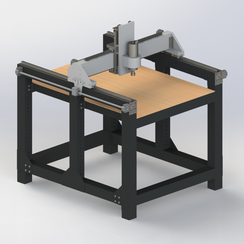

Hi All,
First things first - Thankyou everyone. This forum is an amazing resource. I've spent the past year lurking and researching, and thought it was about time to get a build log started. Now, if you don't mind, lets begin the self-indulgence!
What do I want out of this?
The biggest draw for me is learning the skills in building and improving the thing. I want your opinions and suggestions. Secondly, I want an awesome tool that can help with my DIY projects going forwards - I would like to be able to work primarily in wood (I'm thinking small furniture building, engraving etc), but want to do small things in aluminium too (like parts for models, handy things for the house or whatever). One of the more exciting applications I have in mind for the future is helping my wife with her glass work - either by scoring / cutting / engraving glass, or creating moulds for the kiln.
Tools
So, I intend to expand my garage substantially... but, I have the basics like a chop-saw, bench drill, etc. My designs are conscious of the fact I have (occasional) access to a Bridgeport milling machine and a reasonable size lathe. The largest 'tool' in the garage is me (in every sense)... I'm a Physicist by trade so can handle electronics and equations - I have greater trouble with the structural design aspects and the physical creation, so those are what I want to learn the most about - I've never welded or tapped a hole before, so they're going to be fun to learn.

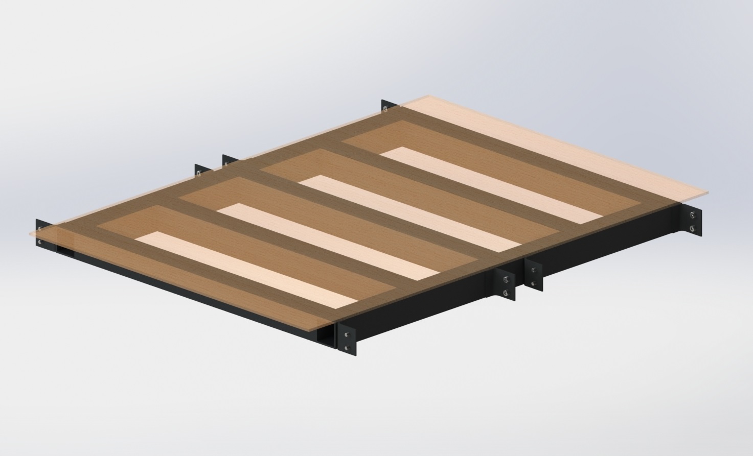

The Design So Far

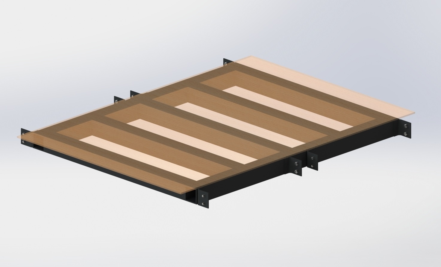

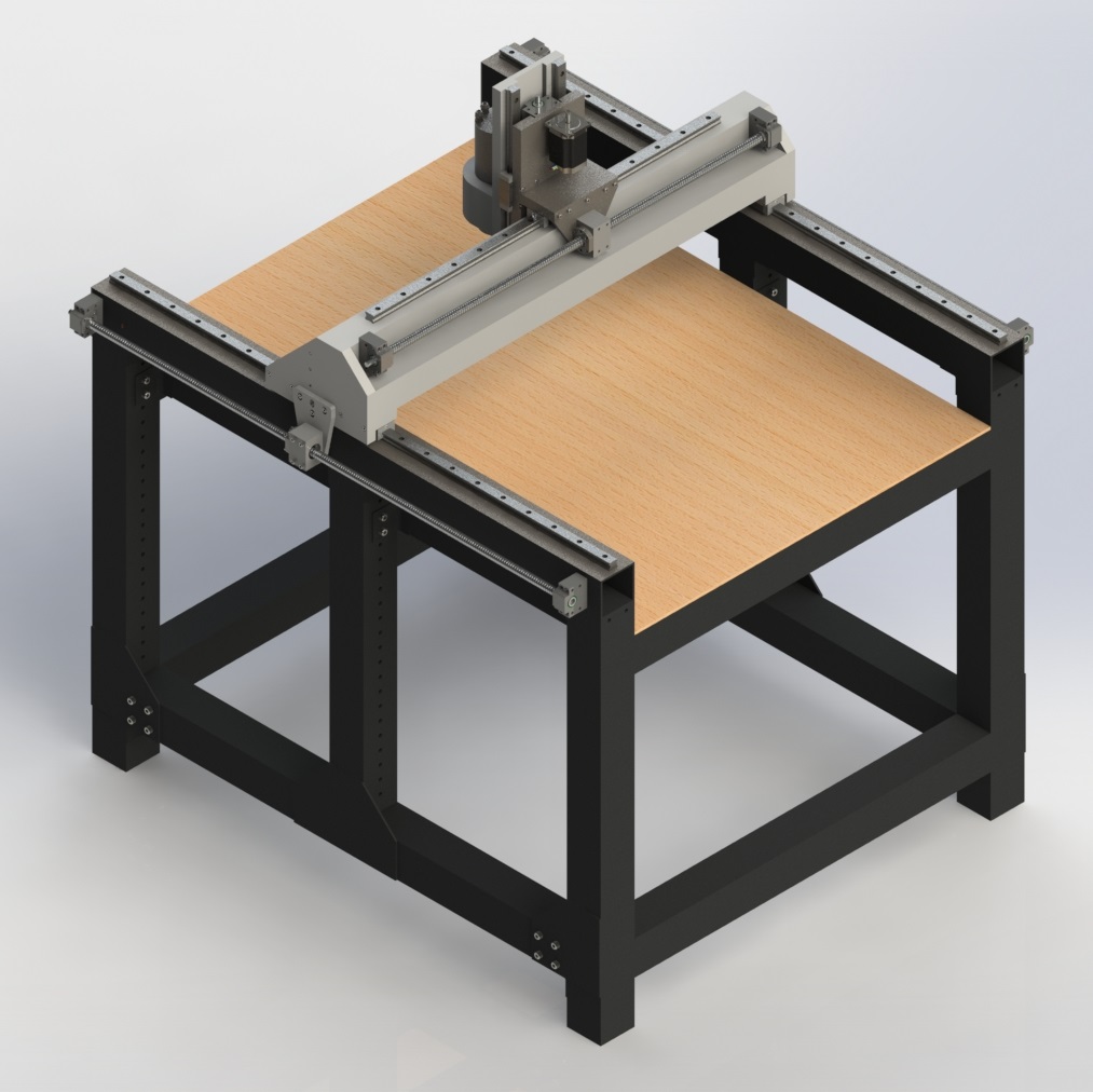

I've thusfar chosen a gantry-based design, about 1.2m by 1.0m which gives me a working area of approximately 1.0m by 0.8m. I think this will be large enough for any project I can throw at it, but small enough to fit in the garage and still have a degree of stiffness! I've particularly liked the common design on this forum, and have used Joe Harris' thread and video logs in particular for ideas and inspiration (cheers!). I've also chosen a L-shape gantry, currently proposed to be created from a rectangular and box section steel extrusion, and a C style carriage to wrap around it, after looking at the gantry design study threads and following through the mathematics (largely helped by the cutting forces calculation spreadsheets on this forum). I was thinking of having a dual X-motor setup, which I know is the slightly less-favoured setup around here, but I don't like the idea of large timing belts - they just weird me out. I do plan to use small belts on all the drives though to give myself some gearing and alignment flexibility. I'd expect to go for one of the large Chinese water-cooled spindles with a VFD. I was anticipating welding the square sections for the gantry, and then using the milling machine to give me good parallel even faces - same goes for the large square tubes that the gantry moves along, but they won't be welded. Not sure if the gantry side plates and the z drive plates should be made from 20mm aluminium or steel yet, so would appreciate comments on that aspect - I think the weight is still feasible with steel, and as I can machine it...? I'm also not very good at knowing where it would be good to add adjustment features, and what form they should take.

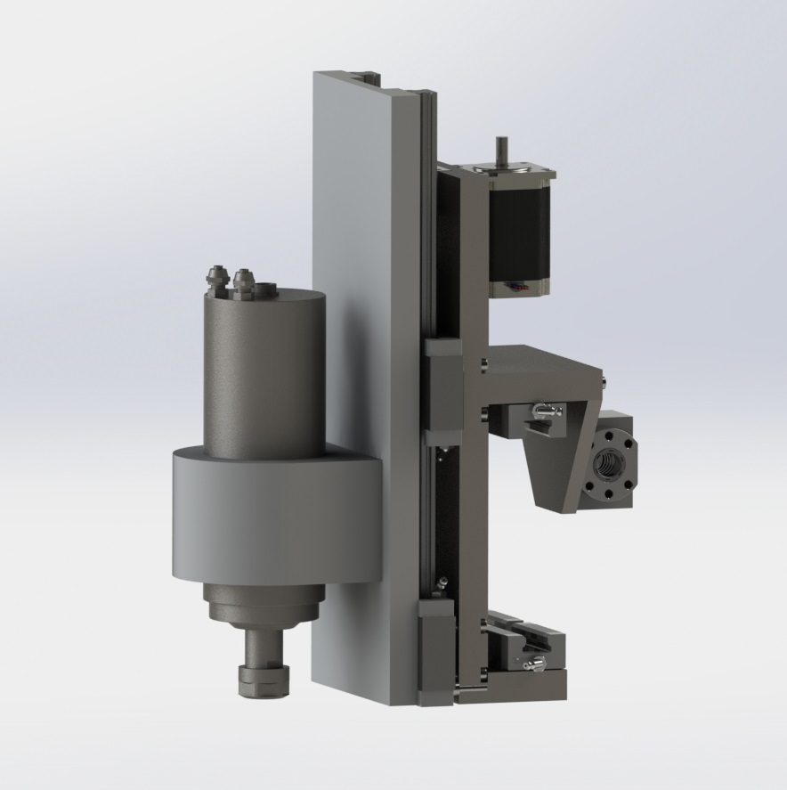

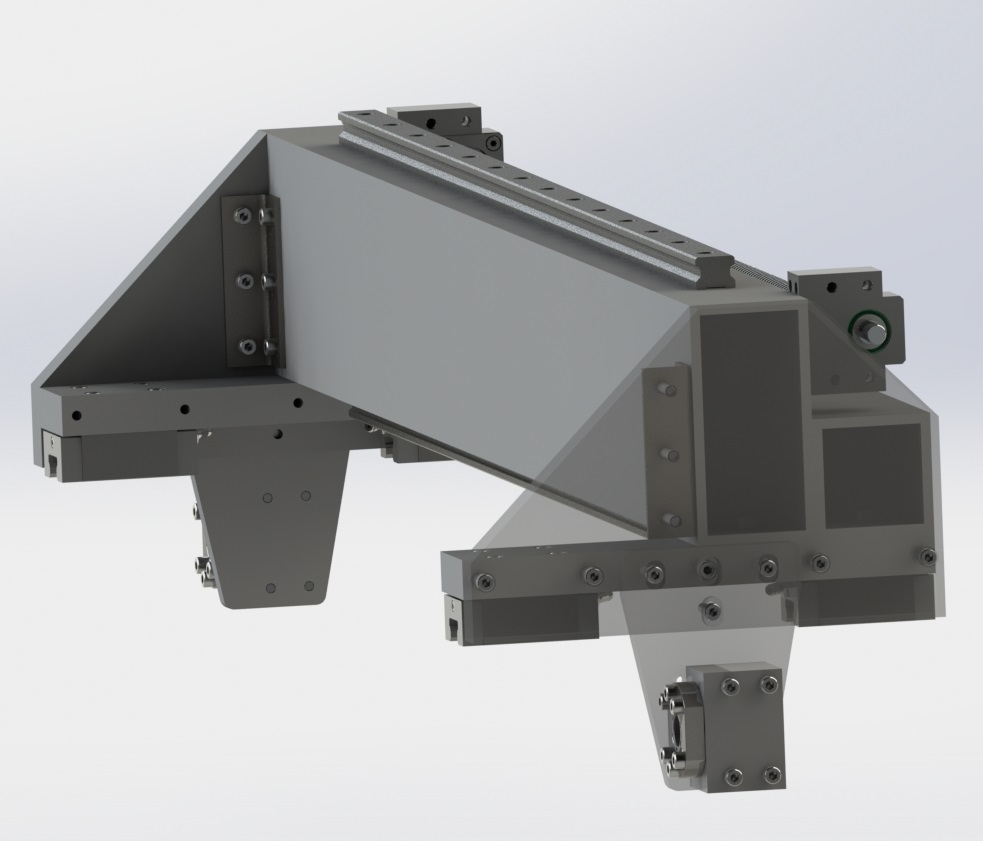

Heres a few pictures of my plans so far.... Forgive my Solidworks skills... they're not the greatest!
Attachment 23468
Attachment 23469
Attachment 23470
Attachment 23471
I'd like your help with...
Everything!
Specifically at the moment, I'm at the stage of wanting to get the build started. I plan to construct the base frame and the adjustable height bed first, which means learning to weld. Before I dive in head first - I'd like your opinions on the overall design and in particular my base and bed design. Is there anything I've completely overlooked? The base is made from 80x80x4mm and the bed is made from 60x60x4mm square mild steel tubing, with the plates and angles you see made from 3mm mild steel. I planned to construct the base in four welded parts which will then bolt together - the two end squares, and the two central sections.

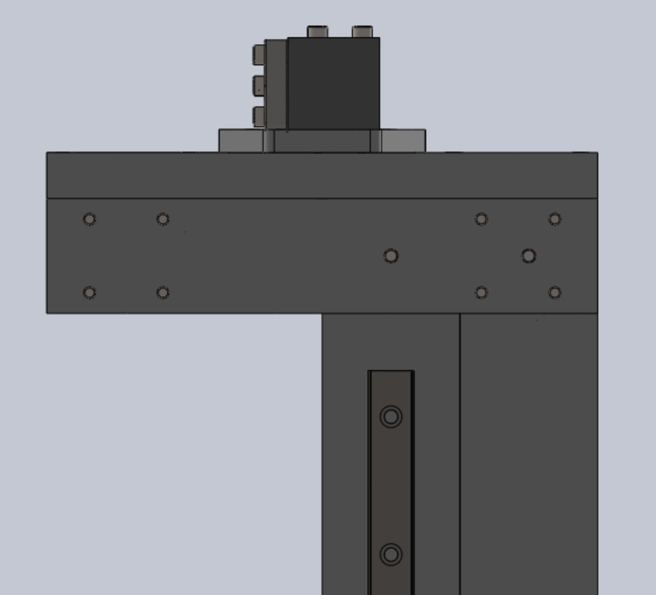

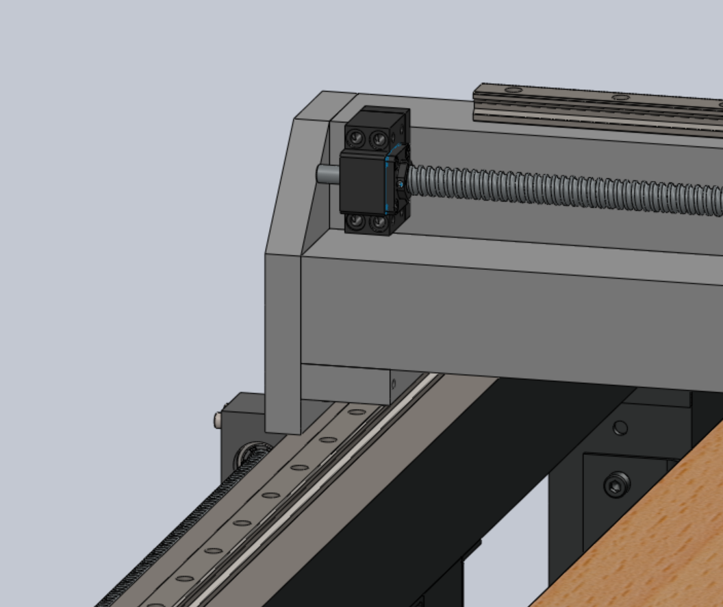

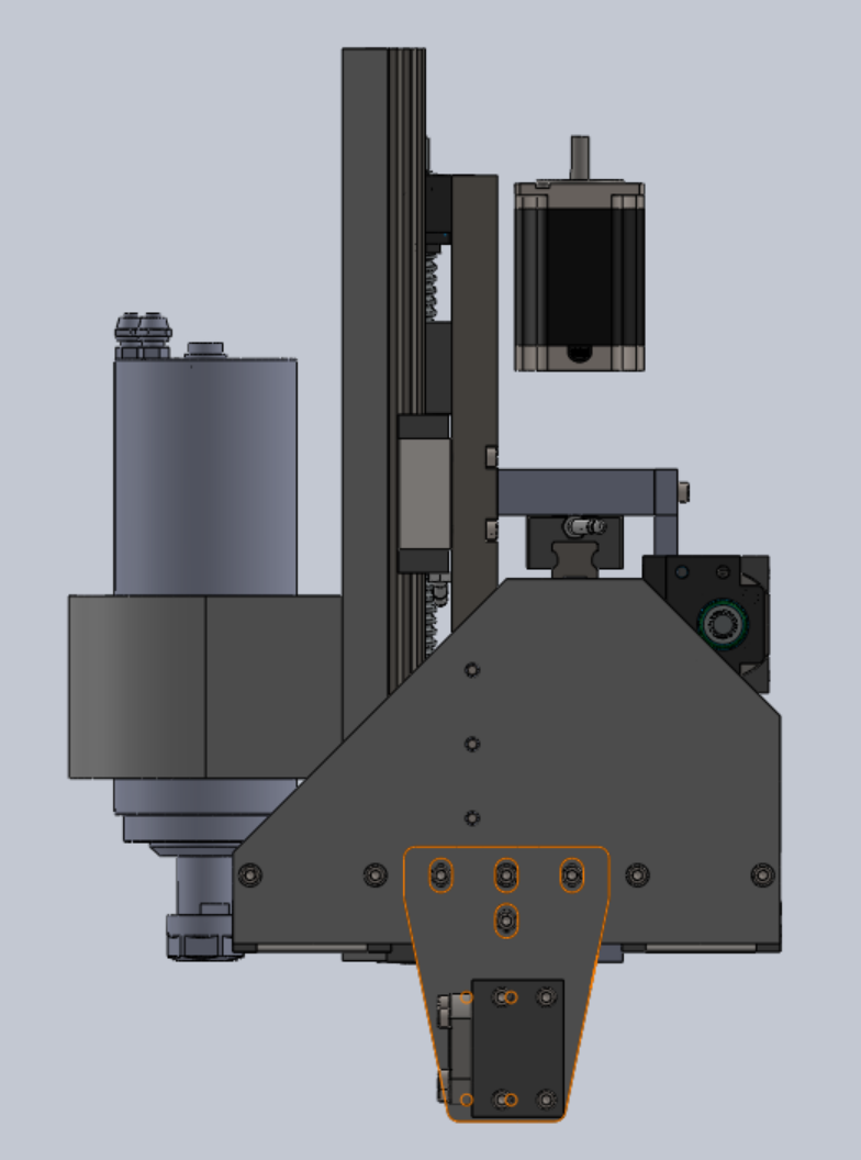

Here are a couple of detail shots:
Attachment 23472
Attachment 23473
Thanks All, and Happy Christmas!

Andy Welcome to the forum and a merry Xmas.
You have certainly done some good research with the design. I use dual motors and home them independently with no problem.
The usual advise on here is to advise not to order any electronics (or kits of electronic)s as thing often change in the design. I don't think you will need the dual screws to be full length as you can move the nut mounting a bit further back on the gantry side and save about 200 mm of screw length.
I would also consider for the gantry HD ally profile say 90 x 45 two pieces one horizontal and the other on top vertical the slots in them are correct for BK12 bearing mount etc. so make it very simple.
Anyway just two sleeps for Xmas:beer:
Re: AndyUK's Build - 1.2x1.0m Gantry

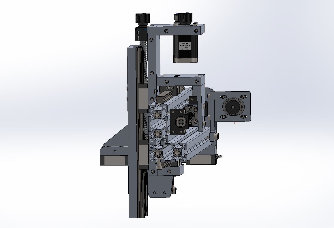

Looks awesome!
I see a few improvements in your design that I will use if I start again with a new machine ;)
One thing I cant see clearly is the spacing of the bearings on the gantry sides compared to the spindle?
Its generally recommended to have the cutter inside of the bearings if you look from the side..
And it might be thats the case here.. but cant see clearly ;)

Hi Clive,
Thanks for the comments, much appreciated! I'm glad to know dual motor setups will work and I'll have someone to bug when I come across some niggles ;)
I'll try adjusting those motor mounts to see if I can shorten the screw - from memory, I think I put them there to have the motors embedded into the end of the frame (may not work, but its nice to dream - I'm thinking of adding cooling into there...) and I sort of thought having the nut mounted half-way between the linear bearings made sense - I don't suppose you happen to have any advice on placement?
Definitely will head your warning on the electronics - at the very least technology will have advanced somewhat before I'm ready to get them going! ;) I'll also try and run the numbers on the Ally profile.
Best Wishes, and a Happy New Year!

Thanks Nr1madman! I don't think theres anything too original in here, I've just pulled in ideas from a couple of people around here - its essentially intellectual theft! ;)
The spindle vs. gantry spacing is an interesting point; at the moment the spindle is just outside the bearing (see picture below), which I gather isn't ideal. Originally this was so I could get right up to the edge of the waste board - should I make the bearing footprint larger to encompass the spindle or is the current setup okay? If so - do you have any suggestions as to how far within the footprint the spindle needs to go?
Attachment 23476
Thanks!
Andy

The way to get ahead is to steal the best ideas and improve on them. So well done ;)
The way you have the bearings probably will work just fine because of the square rails you have chosen to work with. They should take the load.
Just so you know its unnecessary leverage and will intruduce forces that you could avoid.
If you were using other types of rails like unsupported rods it would be a much bigger issue :)

You could take the top rails slightly beyond the end of the machine to allow travel of the spindle past the edge of the base board and still keep it within the bearing span. I pinched that idea from somewhere else (sorry - "research") and it works well.
Design is basically sound. Setting motors inside the section has probably occurred to most people at some point. If worked hard they may reach 80 degrees or more so you may want vent holes in the section.
I can't see how the gantry cross beam connects to the platforms it sits on apart from the small angle bracket. You will need more than that. You can bolt down through lower inner edge of the gantry into the platform on the rectangle and possibly the square if you can get a tool inside. Or if you can weld then cap off the end of the section and drill and tap to fix the side plates. Popular way to do it for steel.
Alum profile was mentioned and this is another way to do it as you can easily tap the ends.
I would go steel as it is stiffer but both can work.

Thanks Nr1madman, I guess its an easy thing to fix if I'm not happy - just need to remake the end plates to the gantry to extend the bearing location. Let me know as soon as you remember the other issue - personally I'm on 'Bad Santa' ale this evening which is going down a treat...!

Thanks - Its really encouraging to have experienced eyes looking over things.
My plan for the motors was, as you point out, cut some ventilation holes in the rails, and to try and mount a fan inside the rail (assuming the vibration isn't too much) - I'm not massively set on having them there, whilst its aesthetically pleasing I can see that placement causing all sorts of headaches while I'm trying to diagnose things!
The gantry cross beam is connected with the small angle bracket, and a pair of M6 bolts from the carriage plate up into the square steel sections (see below - this view is from below the gantry with the bearings removed). I must admit, this connection was one of the most puzzling parts of the design for me, and I'm not entirely sure that this will be up to the job. What I haven't added to the model yet, but intended to do in order to firm up this connection was add a square-ish steel plate to the back of the gantry with bolts into the smaller square steel tube, carriage plate, and gantry side plate (see second picture). I like your idea of welding a cap onto the end, thankyou - although I might not block it off completely and just half-cap to thread into - would be nice to retain an exit path for swarf and I've gathered the impression from youtube that welding things like this completely shut was generally a bad idea?
Attachment 23477
Attachment 23478
Regards the Aluminium profile, I've been running the numbers of 90x45 Heavy Duty profiles against the steel box section. The biggest draw for me simply, as you say, the stiffness of steel - Aluminium's young's modulus is a quarter that of steel. Practically, thats the difference between 0.1mm and 0.05mm max deflection under weight once the profiles are taken into account - I'm not even sure if that'll be noticeable at the accuracy levels this machine will eventually keep - but may as well aim high now while I can!

Hi Andy,
I think bolting the gantry beams to the platform will be a bit awkward from underneath and will make it difficult to align everything.
Better to bolt from the top side - you will also get a better joint because the bolt will pass through the thin gantry section and tap into the thick platform. These can be cap head bolts, but if tool access it tricky then hex head will be better.
I didn't quite follow your 'square-ish steel plate idea' but if you want to bolt the gantry in place (i.e. without any welding) then better to use a solid block at the top and bolt it to the gantry, and bolt the side plates to that. Will get a nice support from the top of the gantry down to the platforms. The small L corner brackets are not really up to the job.
Attachment 23486
I think you said as much but make sure the gantry pieces are connected to each other otherwise you don't get the benefits of the much larger overall shape. Either bolt the inner faces together, using a clearance hole in the rear face of the small square to pass the bolt through, or weld them.
p.s. aluminium is 1/3 the Young's modulus of steel, not 1/4. So in like-for-like sizes steel is stiffer. But as aluminium is less dense (therefore lighter in a like-for-like size) you can increase the aluminium size or wall thickness and recover the stiffness and be no heavier than the steel version. Aluminium profile is easier to bolt together, so good if you don't have a welder. But then aluminium is expensive. In short, use what you feel comfortable working with - either can work well.

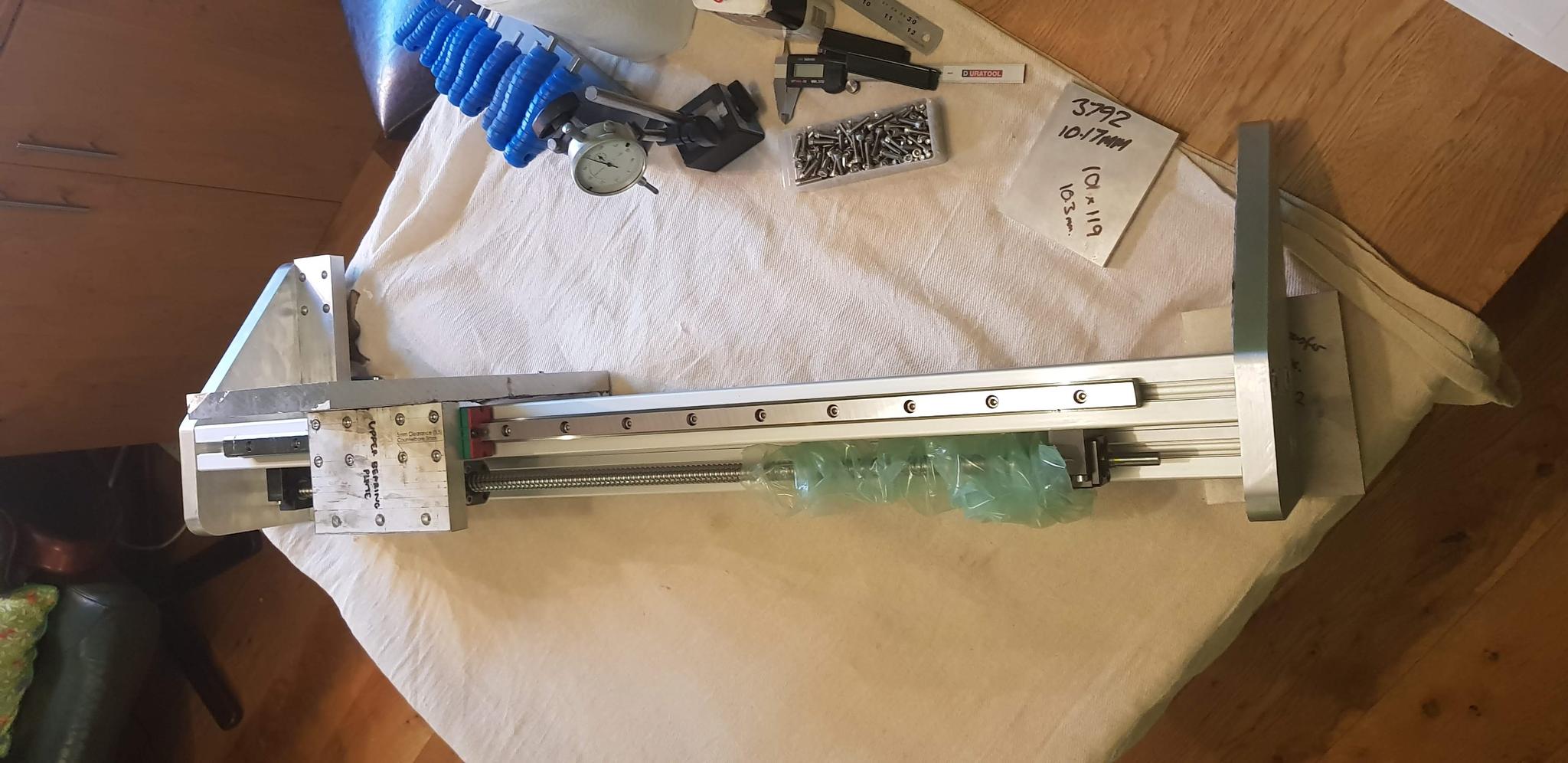

I never tapped the extrusion I used an impact driver to force the M12 bolts into the extrusion, I used corners and T nuts to keep the extrusion straight (My frame is 9045) but the gantry I recessed the aluminium into the aluminium plates by 5mm each side (20mm thick plates) which kept the gantry straight whilst I bolted it on.
Attachment 23487
I got the Hiwin recess wrong so I ended chopping 1.5cm off the Hiwin's which when I checked the Cad model was obviously wrong lol I must have been having a moment.
Hiwin's are rated for 95%+ of their loading capacity when mounted sideways on this is why on my machine I mounted the Hiwin's where the ballscrew is on yours and the ballscrew when you have the hiwins.
Attachment 23489
Removes triangles considerably simplifies the build but increase gantry plate height which can be an issue with flex. I'm only cutting wood and I made my gantry mounts 20mm thick so I don't think this is a problem for me. If and when I build again I'm going to build it same way I did before but undersling the ballscrew so it's out of way of any debris.
I have to say the No.1 thing I would do differently is rotating ball nut but if not then 10mm pitch ballscrews my router is very close in size to yours my travel is 130cm*70cm but I got 5mm pitch ballscrews and this is the biggest mistake I made on my build. (If you exclude me blowing up 1 PSU lol)
As for electronics I went with 4 AM882 (£240 new from China, Toroidal transformer for 70v (£80 from Rapid), $5 BOB for control with a PC parallel port and linuxcnc. I do intend to add an 7i73 board (allows me to use ethernet to breakout boards instead of PP) but I would say the setup I have is the bear minimum for a decent router. Stall protection being the bare minimum in a stepper driver.
Good luck with your build.

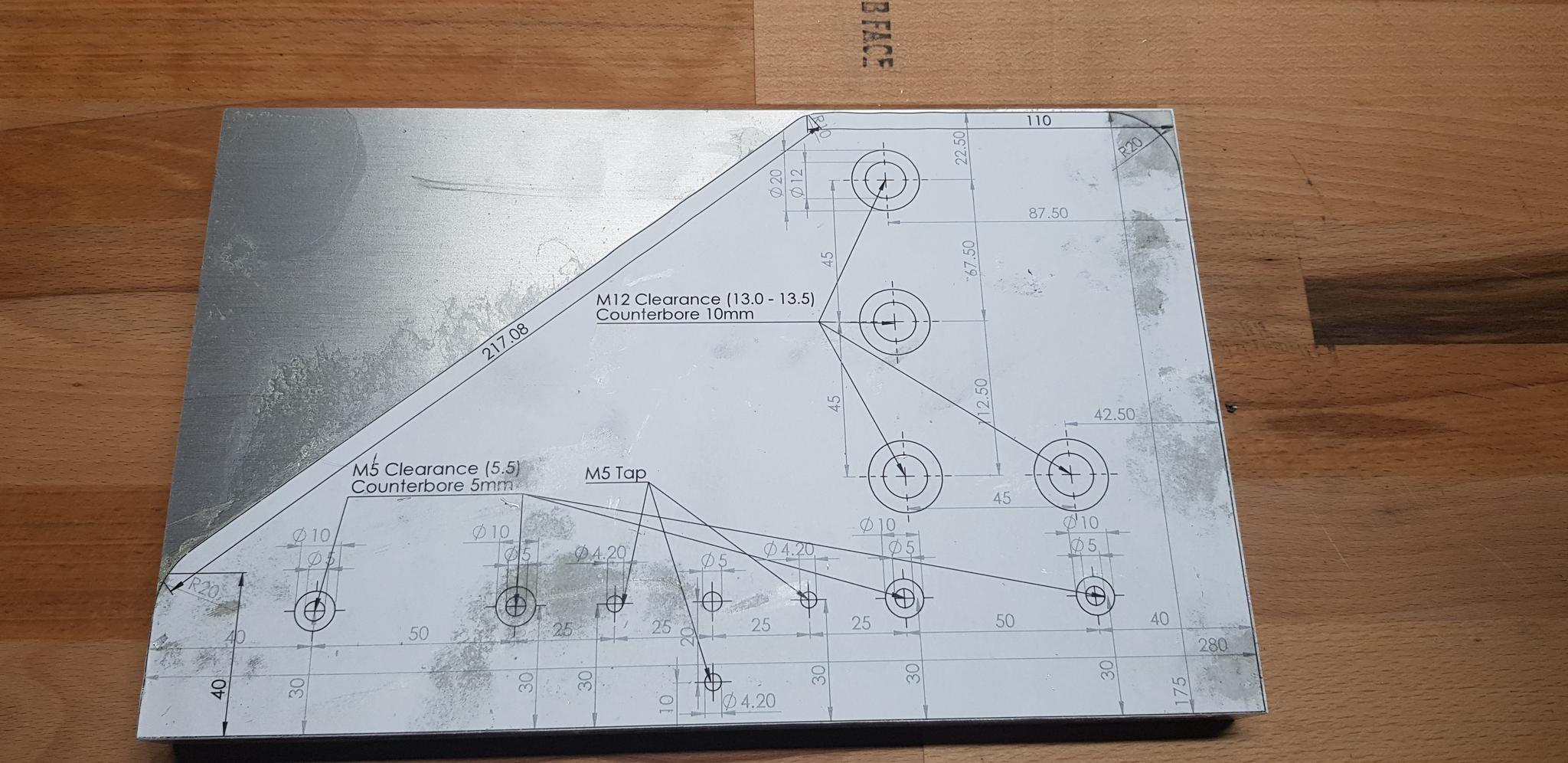

First things first, current drawings:
Attachment 25074Attachment 25075Attachment 25078
Attachment 25076Attachment 25077Attachment 25079
I mulled over the advice I got from Clive and routercnc for a long time. far too long. I repeated my deformation calculations with various materials and geometries. Ultimately, Aluminium won :) There's a few solid reasons:
- Cost - It isn't as bad as I expected. The aluminium profiles are only about £50.
- Ease of working with. The connection to the side plates is just so much easier.
- Deformation is tolerable. I think it increases vs my steel design from 3.0um to 4.9um - Lets be honest, its never getting close to those tolerances elsewhere!
- Proven history of this configuration working for others on this forum.
That decision also cemented the plan for making the side plates out of 20mm aluminium plate - and I think they look reasonable. The other factor is that the milling machine is currently in storage a couple of hundred miles away, and at least I can work aluminium in my garage :D This means I'm also planning on going down the epoxy route for levelling the x-axis, and my belief is that the y axis on the ali-profile should be reasonable out of the box (?). That also allowed me to further copy Joe (thanks bud!) and start designing my motor mount locations etc.

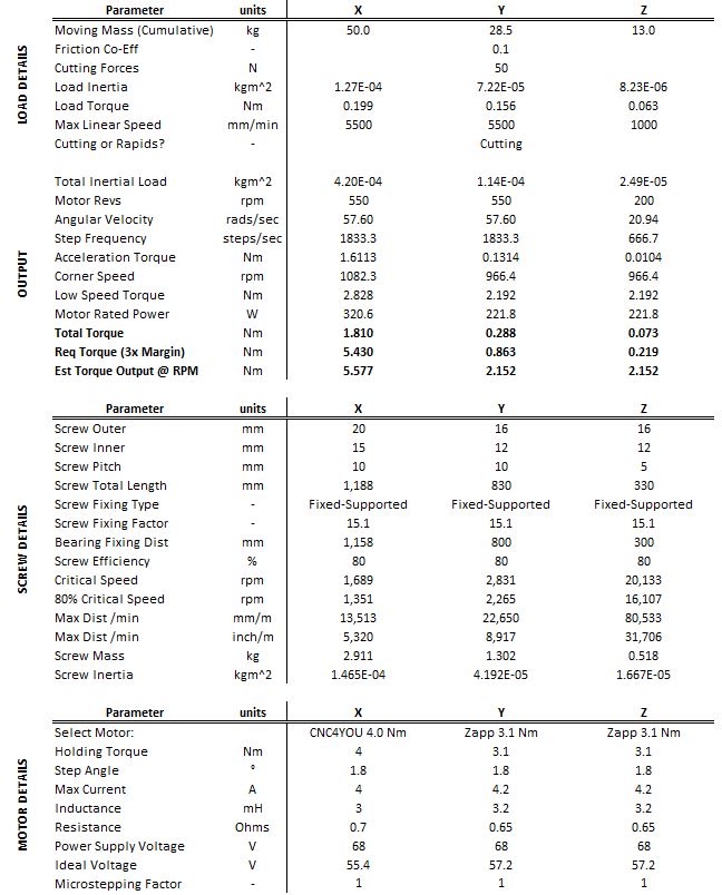

I want to start ordering the linear motion bits - so I've got a few questions:
I've up-beefed the x-axis ballscrews to 2010 1100mm. The y axis is currently 1610 750mm, and the z is 1605 250mm. I'm having a little crisis of confidence in these though, so before I bother Fred for a quote, does that sound right to everyone? Does that get appropriate speeds for what I'm planning on doing? I'm probably mostly cutting wood and occasionally glass and aluminium - I guess I can gear the x axis if it becomes a problem? I was planning on 4x 6nm Nema 23s.
Second crisis of confidence about the screws is the bearings. I'm planning for a BK15 and BF15 (one either end, fixed at motor) for the x axis, then BK12 and BF12s for the Y and Z. Add to that a ballnut for each screw, and thats everything right? :)
Finally, I think my linear rails are as follows: All 20mm, 1200 on X, 850 on Y, and 400 on Z. I think I'll need 12 carriages. Sound good?

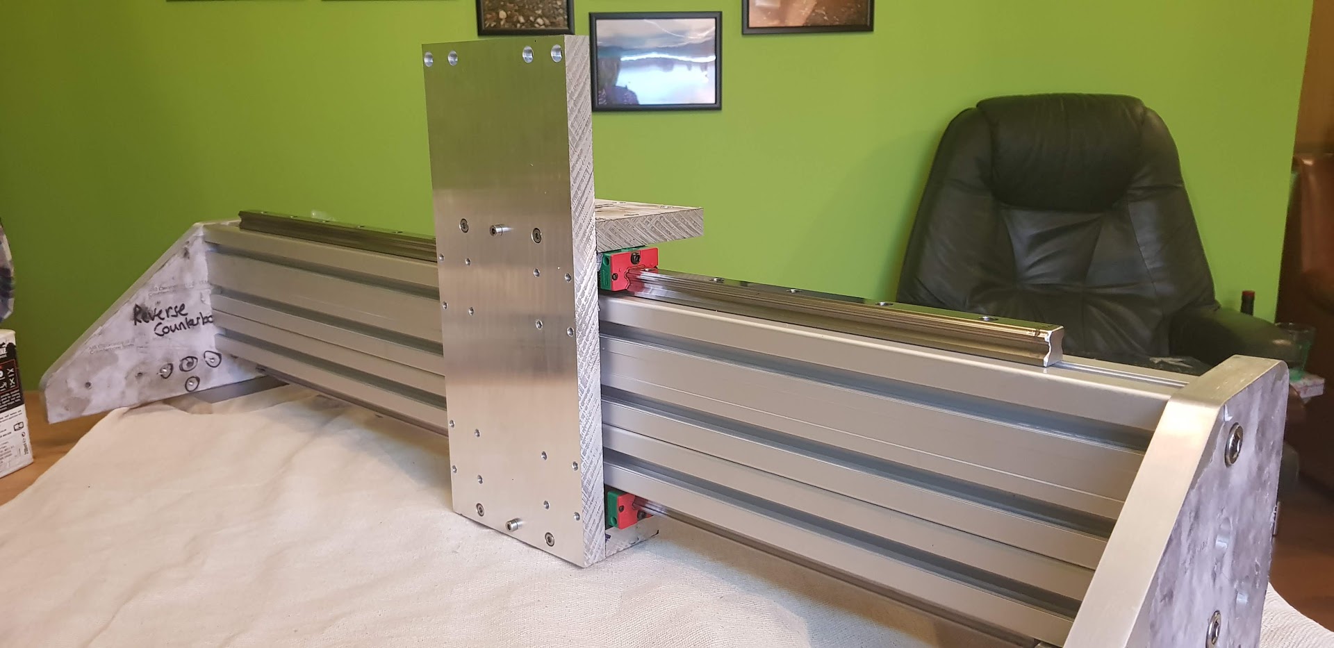

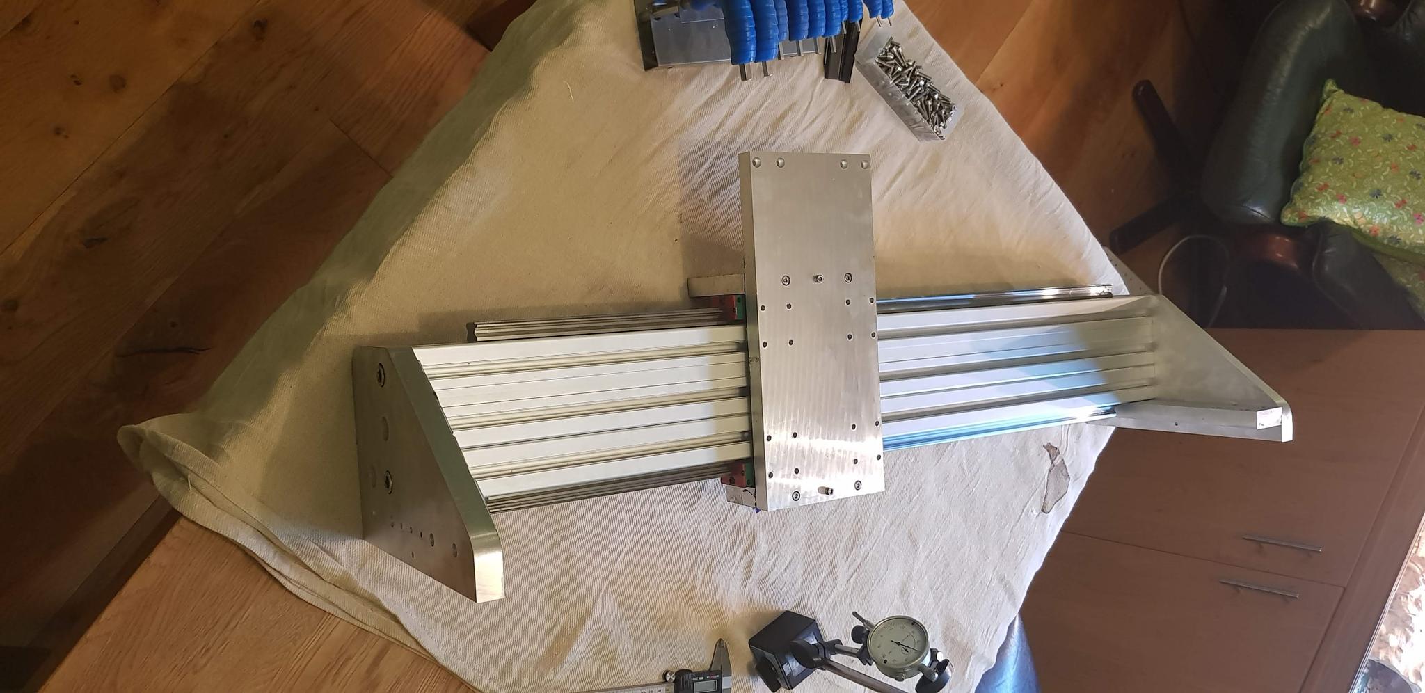

And, just to prove I haven't been completely slacking off since last year - some progress photos!
Attachment 25080 Attachment 25081

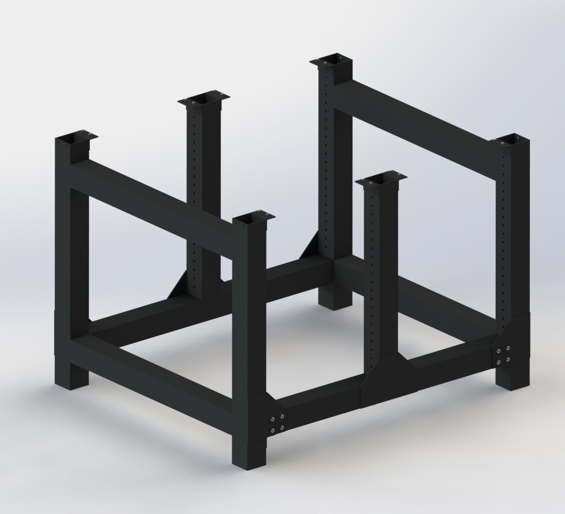

Large steel delivery (about three hundred quid for the base frame and adjustable bed + some sizable offcuts). Lots of cutting... then lots of cleaning up the pieces to make them nice and shiny and easy to weld. At this point, also, you know, learnt to weld a bit :)
Attachment 25082 Attachment 25086 Attachment 25083

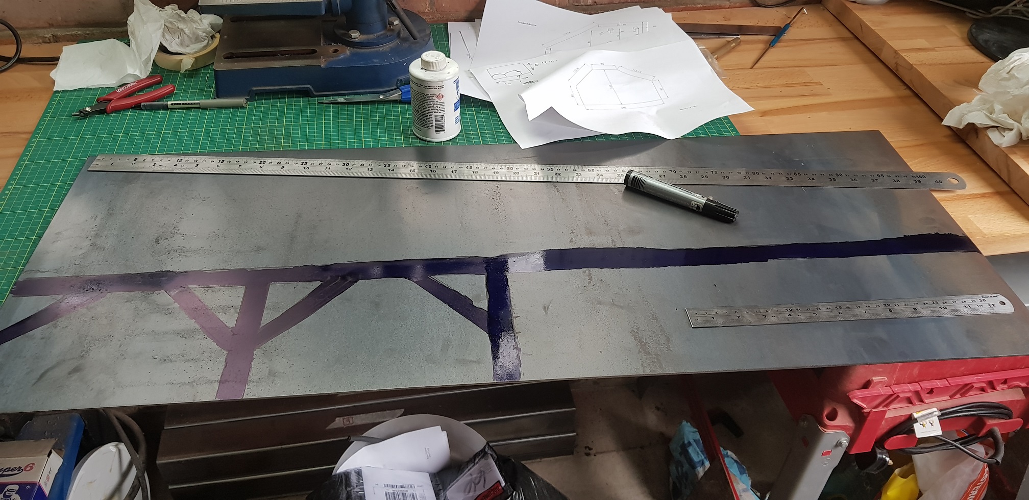

Marking up - discovering what marking up fluid is, and then having to find my own tub! At this point I couldn't wait to layout the steel in approximate locations to give me a better idea of size (wife redacted!)
Attachment 25084 Attachment 25085
Worth also mentioning that part of the reason I've been so slow with this project to date is that I started it a couple of months after buying our first home. My workshop needed a little attention due to a steel lintel which rusted and pushed up the top few brick layers, and the window had rotted out - so here's a couple of pictures illustrating what we did with it. We followed this up with a complete rewire. Notice large pile of steel under bench...
Attachment 25087 Attachment 25088

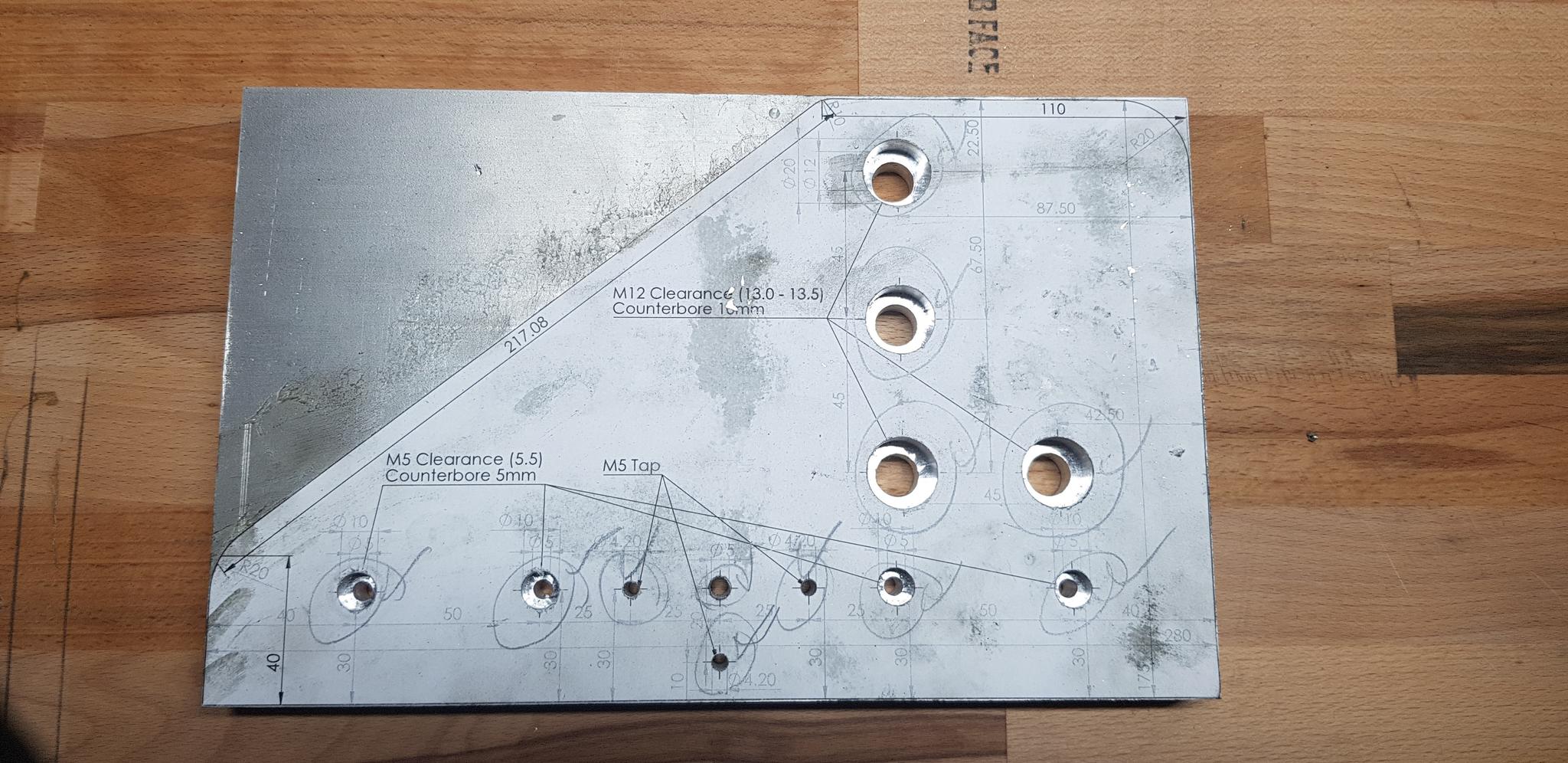

LOTS of drilling, and LOTS of tapping. I said in my first post I'd never tapped a hole before this. Well, Now... lets just say there were evenings I wore blisters! Should probably have got myself a power-tap, but hey, all good experience.
Attachment 25089 Attachment 25090 Attachment 25091 Attachment 25092 Attachment 25093
By this point the milling machine had made it into storage (for various reasons...), and I wanted to get on with my steel plates for the bed. The shape is cosmetic anyhows, so I went ahead and used the solution to hand, which was a jigsaw with a metal blade. Was quite exciting to do a quick visualisation - although a bit of a tight fit before clearing the space for it! Note that one of the key changes I've made is bolting the frame together initially - I still plan to weld it, but I liked the idea that I could assemble then tack weld once I'm happy with the structure and basic alignment. Whilst I doubt it will help much with distortion, it has prevented me from making any big cockups with the basic dimensions of the base frame - and that steel is expensive!
Attachment 25094 Attachment 25095 Attachment 25096 Attachment 25097 Attachment 25098
Time to sort out the angle iron - needed quite a few of these since I started bolting together. Took the opportunity to borrow the bandsaw whilst at the in-laws and get them nicely cut to size. Marking them was a bit of an onerous task, so as my wife had recently taken up 3D printing as a hobby, printed out a jig to prevent me needing to measure! Worked surprisingly well, as our off-the-shelf middle-of-the-range printer is astonishingly accurate on its dimensions.
Attachment 25099 Attachment 25100

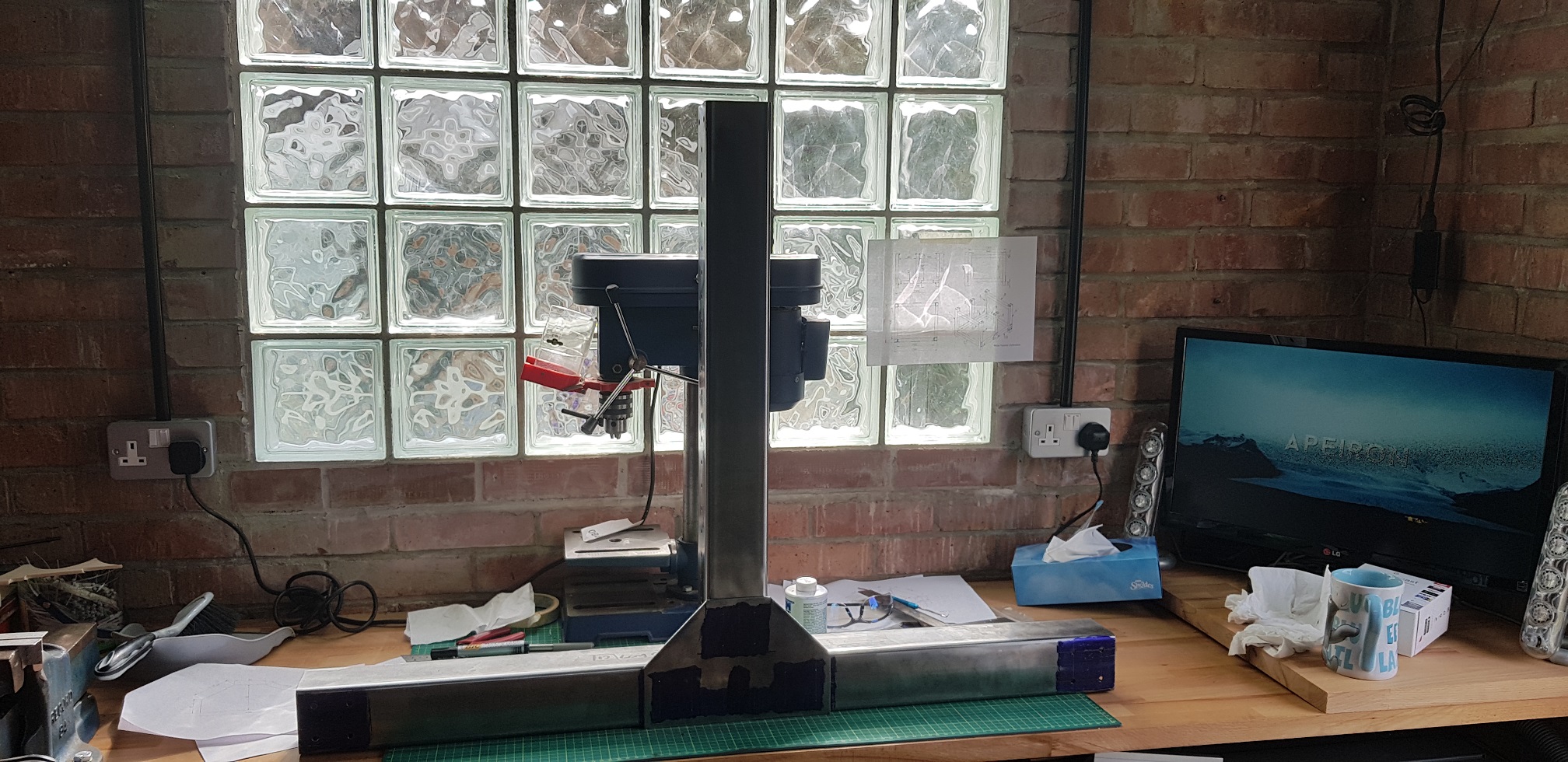

Now that I had the angle pieces, I could start bolting the base together. This is pretty much how it stands today - I've added the other two cross bars, and tightened it all down. I was gobsmacked when I went around measuring the dimensions against the CAD model, to find everything was smack on what I designed it to be - although I don't have a meter long pair of calipers so I'm calling close enough!
Next stage is to start assembing the adjustable height bed - this time I'll be welding straight out of the gate, then I need to tack weld the base frame together and design some height adjustable feet. I'm considering drilling into the concrete base of the workshop and attaching it down - thoughts? Otherwise, as I mentioned in my last post, I want to get the linear motion components on order, and order the aluminium profiles for the gantry to begin assembling those.
Thanks for reading this far - its quite fun sharing this now I've eventually gotten around to it! :) I certainly wouldn't be able to get any of this done without the help and guidance I've found on this forum already.

Marking them was a bit of an onerous task, so as my wife had recently taken up 3D printing as a hobby, printed out a jig to prevent me needing to measure! Worked surprisingly well, as our off-the-shelf middle-of-the-range printer is astonishingly accurate on its dimensions. . . . . . . .
Like that thinking! What make and model 3D printer are you using?

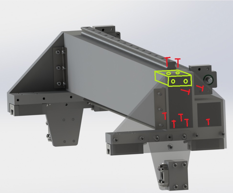

The large dimension box section you've used for the base frame is great but I would suggest that, when you get to the welding stage, you stiffen the frame by triangulating with diagonal bracing.
Personally I would brace roughly the bottom half of the side frames (sorry about negating those bottom drilled holes for the adjustable bed. Eek!)
Your build thread reminds me of the build by Joe Harris, and is a good one to follow!
Andy
So we're on the same page, I guess you're talking about adding the red lines in the diagram below, rather than the green? I suppose if they were removable bracing they wouldn't foul the adjustable bed permanently... I was hoping to use the lower sections of the frame for a second structure, like a coolant trap or something.

Very exciting package just arrived!
Attachment 25244
Still working my way through it, but all looks spot on so far. Very pleased and impressed by Fred.
For those of you who are trying to price up your builds in the future, I think this set me back approx £1150. It includes everything you see above - all my rails, ballscrews (+bearings and mounts), and spindle, inclusive of delivery, VAT and Customs. I think it would have cost ~£2000 from a UK (re-)seller.

Promised a couple of photos of the aluminium parts... so here we go - Don't judge my sloppyness too harshly ;)
I've been using the printer at work to get drawings printed out as accurately as possible. I'm then using contact adhesive to attach them to the aluminium, which makes the drilling process a lot easier. The drawings get a little busy and unprofessional, but it helps when I'm checking how accurate the printout is to be able to quickly know what each relative dimension should be.
Attachment 25537
Oh my life - the counter bore cutters are amazing. I love these things.
Attachment 25540
So, after some bandsaw action, some broken drill bits, a screwed up aluminium part (try and spot whats asymmetrical!), and some other parts made, I finally got around to some rough first-time assembly this evening. The rails aren't perfect yet - they're dialed in to about 0.02mm from the surface of the Ali extrusion whilst I'm awaiting my precision straight edge which is back ordered, but the carriage went together like a dream, and runs nice and smoothly along them.
Attachment 25536
Attachment 25538
Attachment 25539
Looking good Andy,
I and a few others I know print things out like this and it works quite well, if you set your printer to print at a 1:1 scale, it should print out "reasonably close" to true 1:1, then you can just measure what you get on the print out and adjust your printer settings accordingly, though I've never had to do this as its always been good enough.
Great build keep up the good work !

Lets talk numbers first, because I've being doing these calcs behind the scenes. I've written my own version of irving2008's motor calc sheet. Its basicly the same, but I'm doing the calcs myself so I understand it, and I'm doing all three axis at once. I've also modified it to cope with dual screws on the X (I've doubled the screw inertia then doubled the Est Torque output - which in my head counters the additional drag of driving an extra screw against the additional power output.)
I've set the sheet up here for 5500mm/min, with a 50N (Ali) cutting force. Its currently not setup for gearing at all - and I have a microstepping factor of 1x because I haven't thought how to include these factors yet.
Attachment 25633
So, with 2x 4.0 Nm on the X we can just achieve this setup (I say just - as per the original spreadsheet there's a 3x Margin on the required torque), and rapids at 9000mm/min whilst staying below 900rpm (below corner and 80% of critical speeds). Note that although I've simulated 3.1 Nm on the Y and Z, they're massively overkill. Especially the Z.
Questions are - does this look realistic and okay? Is my dual screw fudge acceptable or are there any obvious holes?
Any tips on how to integrate the pulley factor and microstepping? How do I take these results and figure out what gearing to use?
Thanks!
