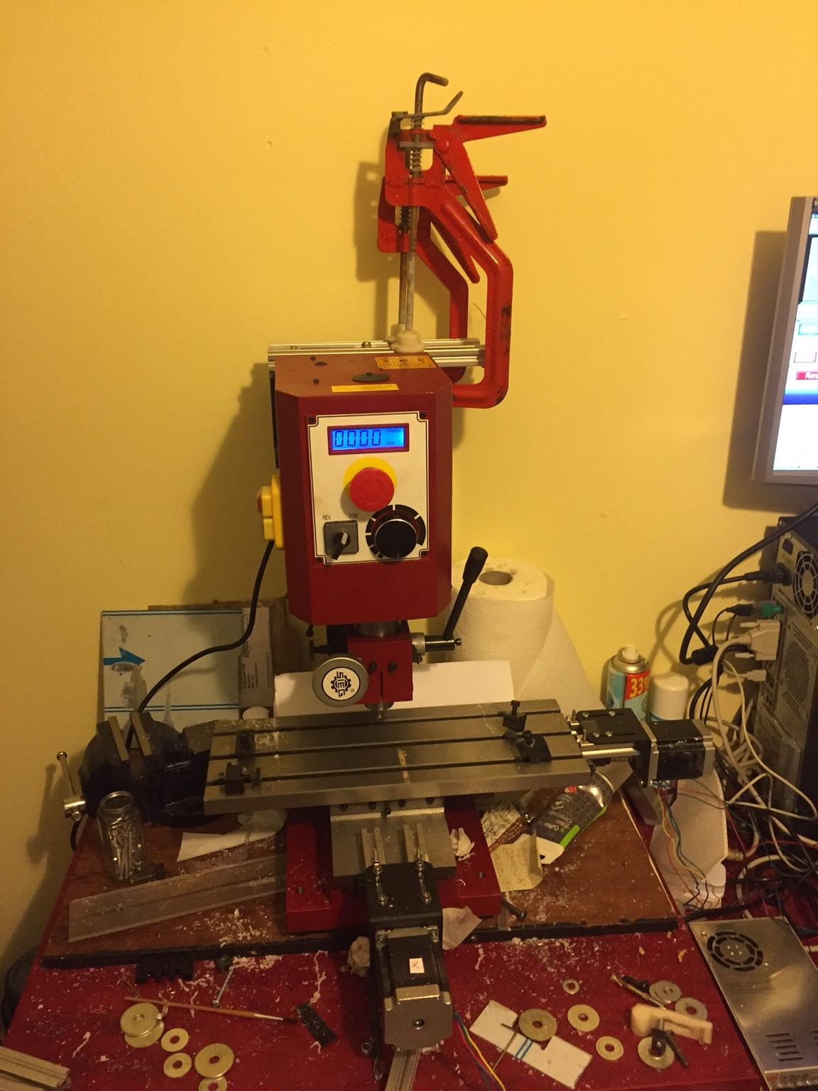

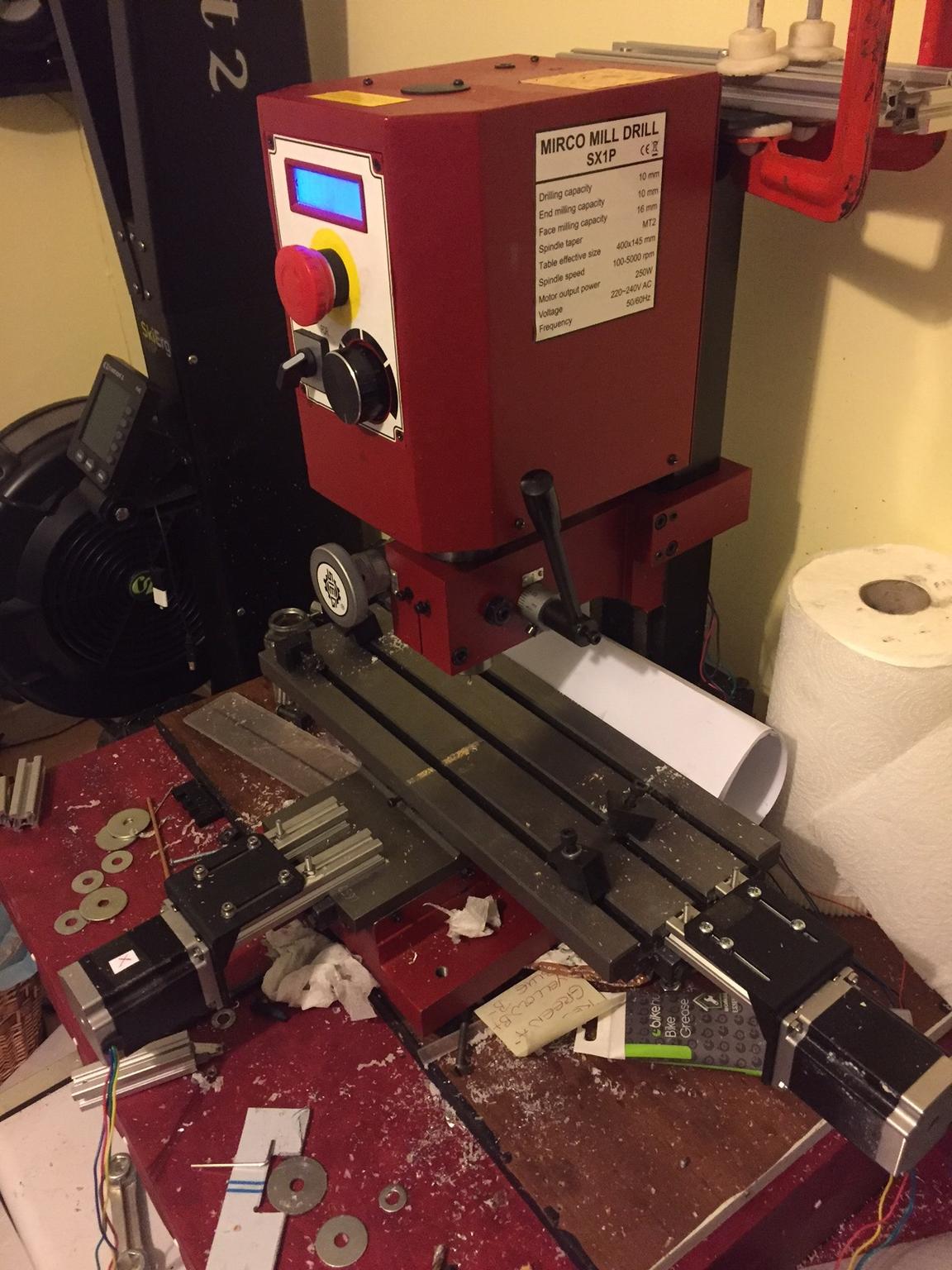

First day to play with this since parts arrived and I have it running, still some finishing to do as the Z axis motor assembly held in place with a pair of quick release clamps. But up and running in a little over 12 hours start to finish, first job pocketing out some acrylic for bearings and a 3mm Aluminium print bed (Using 6mm Router bit) for another project completed.
As an Ex Bricklayer now IT consultant I have no experience with the milling or engineering, ordered and received the Mill about a week ago unpacked and remained untouched until today. My only experience related to CNC previously has been building/repairing 3d Printers and Laser Engravers etc for friends and family and 3D printing a CNC just for fun.
As you can probably see no planning or design went into the conversion, I went with the suck it and see approach, look at each axis one at a time and work out a way to get the motors firmly attached and driving the leadscrews before hooking up electrics and configuring Mach3.
Its an ugly beast at the moment a few nuts and bolts 6 short lengths of 2020 extrusion, 2 x 8mm couplers and a pair of 20-40 tooth cogs for GT2 belt from 3d printer supplies. Now I've confirmed its possible I will look at better materials and fixings to tidy and strengthen thins up at least with the mill running I have a chance to machine parts required apart from trimming the 2020 as required manually I have no experience machining anything other than wood, or acrylic with a Laser cutter.
Any advice welcome but please remember total of 12 hours spent so far and its running smoothly and only £80 spent on 3 Steppers and a TB6560 parts plus a few scraps from my workshop. And surprisingly it works and is quiet enough to use in my first floor flat without upsetting neighbours.
