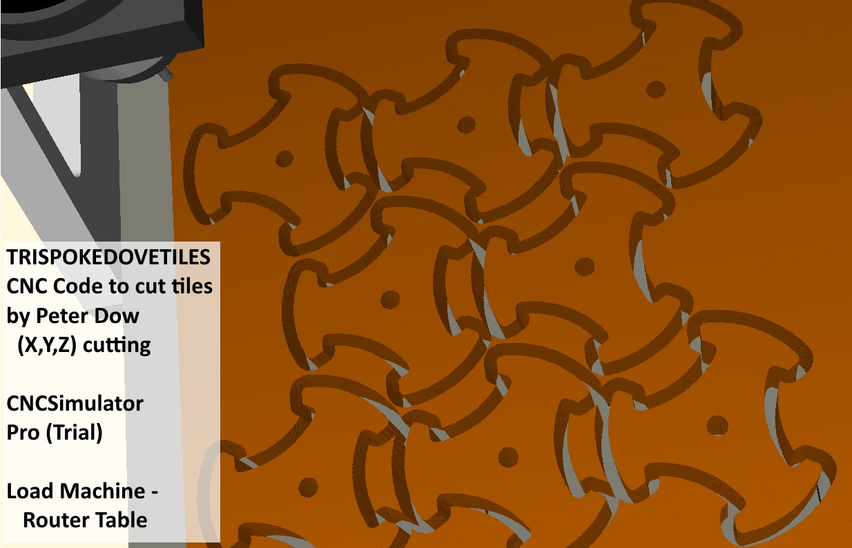

CAM for CNC code for cutting trispokedovetiles (3-spoke dovetailing tiles)
For Computer-Aided Manufacturing of trispokedovetiles, I've published a Javascript web-page -
Trispokedovetiles: CNC code to cut tiles web-page G-code generator [LINK]
- which generates Computer Numerical Control (CNC) code which I've tested with CNC Simulator Pro [LINK] but not on a real CNC cutter as yet.

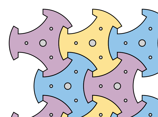

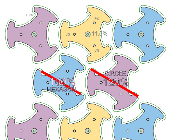

In case you are wondering what a "trispokedovetile" is, it is the name I have given to a class of 3-spoke dovetailing tiles which fit together like this.
Attachment 19833

Then image says Hexagon 100%
The parameters ask for a mm input????
Re: CAM for CNC code for cutting trispokedovetiles (3-spoke dovetailing tiles)
Mach 3 can't read the code.
I edited out the stuff that stuffs Mach3's interpreter and the path looks OK but if I use a cutter with a positive diameter then there will be gaps of cutter width between the tiles once assembled, so for a router to cut the tiles they would need to be arranged as densely on the material as possible but not in their assembled pattern.
- Nick

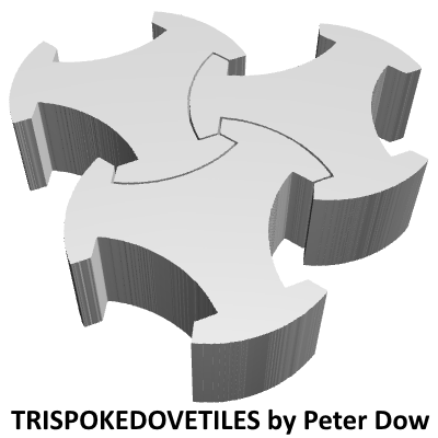

magicniner

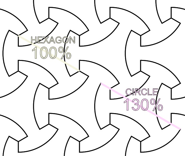

My method for specifying a particular shape of trispokedovetile is to specify the "CIRCLE" length as a percentage of the "HEXAGON" length, as illustrated in this diagram.
This image shows trispokedovetiles with CIRCLE = 130% - in other words the length of the diameter of the (partially drawn) circles is 1.3 times the maximal diameter of the (partially drawn) hexagons.
Attachment 19844
magicniner
Yes of course. My CAM webpage needs to know what actual sizes are intended to be cut to generate the correct CNC code.
So you type in what is the length in mm of the HEXAGON maximal diameter, what length will be equal to "100%"?
It's like if I tell you "the width of a rectangle is to be 100% and the length 130%".
Fine but before you can cut the rectangle from a sheet you need to know what length 100% is to be in mm.
John S
magicniner
Yes there's text in there which is needed for CNC Simulator Pro, which won't mean anything to a CNC machine and should be edited out.
#region
$Millimeters
$AddEmbeddedRegPart 9
$SetCuttingWidth 1.2
#endregion
But I include it in my webpage code generation in case anyone wants to test the code on CNC Simulator Pro, which is the only place I've been able to test it.
UPDATE: I've updated my webpage to include a yes/no "+ simulator commands" option which if set to "no" will automatically edit out the text intended for CNC Simulator Pro.
magicniner
- Nick
Yes that makes sense.
So to aid cutting with a milling router bit I should add a new code generator option for "densely arranged" as opposed to "as assembled".
I have read that with laser cutting, the kerf width can be of the order of 0.5mm or even narrower, is that right?
So it might it be the case that for some cutting methods, such as laser cutting, if the kerf width is narrow enough, the code as is, would allow the tiles to be cut in their assembled pattern?
Such interlocking tiles probably require to be slightly smaller than the mathematical shape to allow for tolerances because if the tiles are in any way too big, they definitely won't assemble wheres being slightly too small may be necessary?
On the other hand, if cutting very small tiles, then a laser cut kerf width would become relatively bigger and perhaps then the undersized tiles would not interlock together, being too loose, meaning that once again, a "densely arranged" cutting option would be needed?

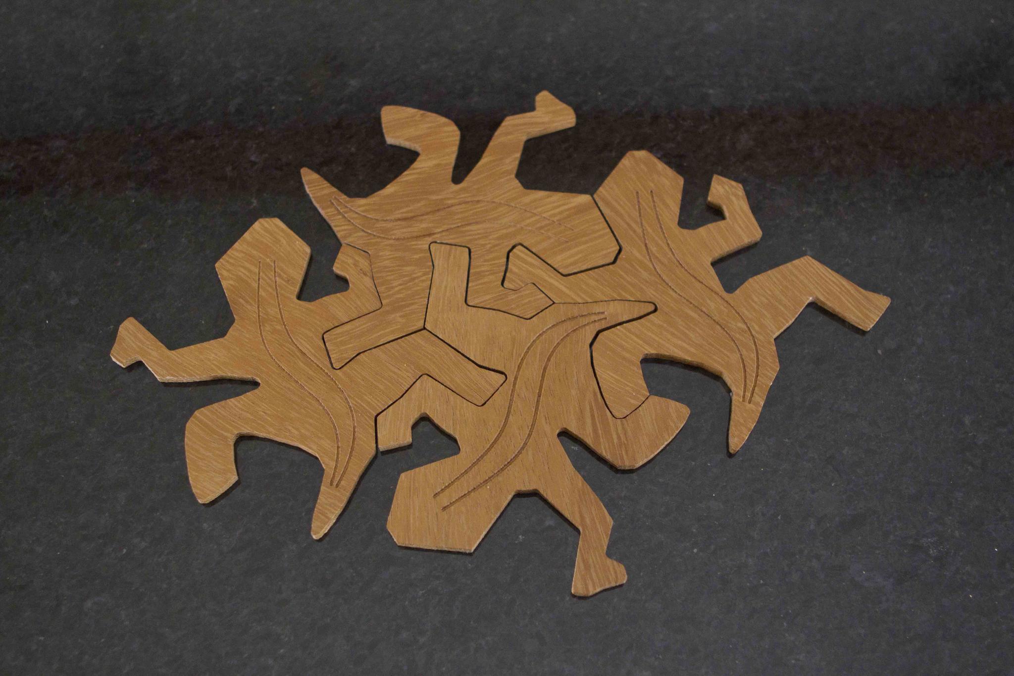

It all reminds me of this, again based on deformed hexagons but with no symmetry (although in that case the guy took a very roundabout route to generate his gcode). Both designs are necessarily a bit wasteful as you cannot cut the interlocked figures and you just have to try to fit them on the material as best you can. I recreated this latter design from scratch to use for sets of coasters which will then interlock across a table-top. The design in this thread would work quite well for the same kinds of things.

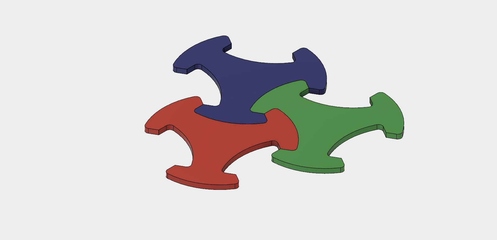

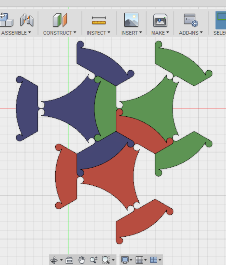

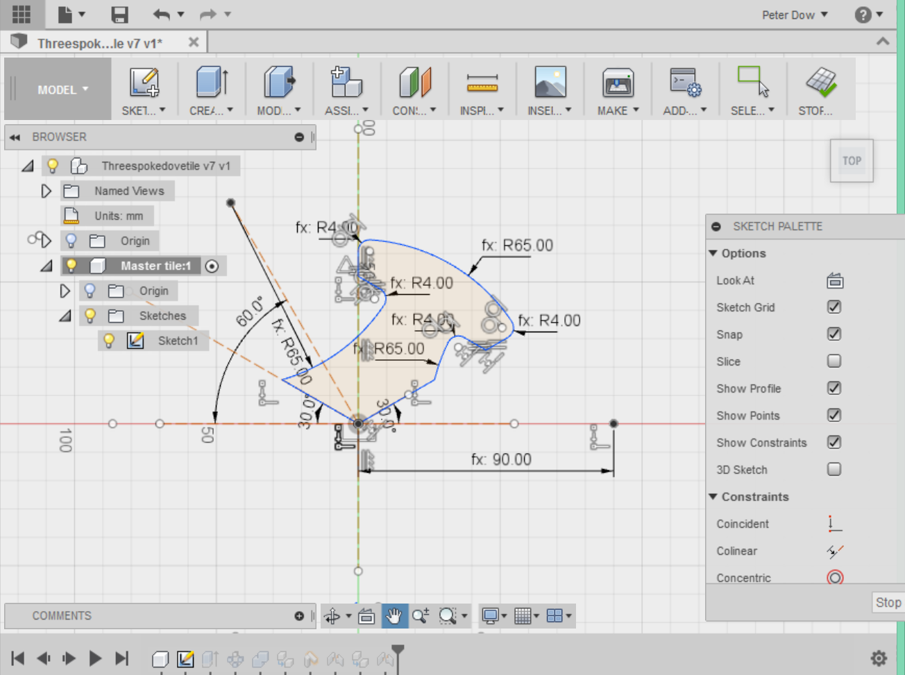

2 Attachment(s)
I thought that this was quite an interesting design, so I looked at recreating it with Fusion 360:
Attachment 19941
I have attached the F360 model. I have used the F360 User Parameter feature to allow the user to tweak dimensions easily. Outer_circle_dia gives the diameter of the tile. Hex_spacing gives the centre-centre spacing of the hexagons that make up the underlying structure. Corner_rad gives the fillet radius on internal and matching external corners. Yes, I tried to fix the "sharp internal corner" problem.
Obviously, you can just go straight from design to gcode using F360 CAM and choose your own cutter diameters. You could, if you wanted, export a DXF version of the basic sketch. Note that because I was having serious problems in F360 in trying to draw one spoke and then use a circular pattern at sketch level, I actually extruded one spoke and then built up the tile using a circular pattern at the solid body level. This might make sense to someone with F360 experience, and if any of those people can point me at what was going wrong, please do so!
Attachment 19942

Neale
Attachment 19941
Attachment 19942

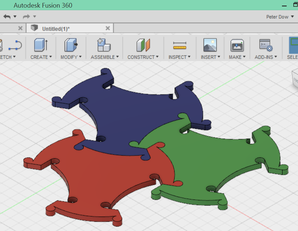

I'd like to know how to use Fusion 360 in that way, if you care to explain Neale, please?
I couldn't see the parameters you mentioned - "hex_spacing" or "outer_circle_dia" - I didn't even know where to look for them.
I found the data object tree obviously enough and had fun clicking through it, finding something new each time.
Attachment 19953
OK found the parameters on the pull-down "MODIFY" menu.
Still finding my way around this software package.
This was the result of changing one parameter - "Outer_circle_rad" from 65mm to 70mm.
Attachment 19957
Hmm. Not quite what I hoped for.

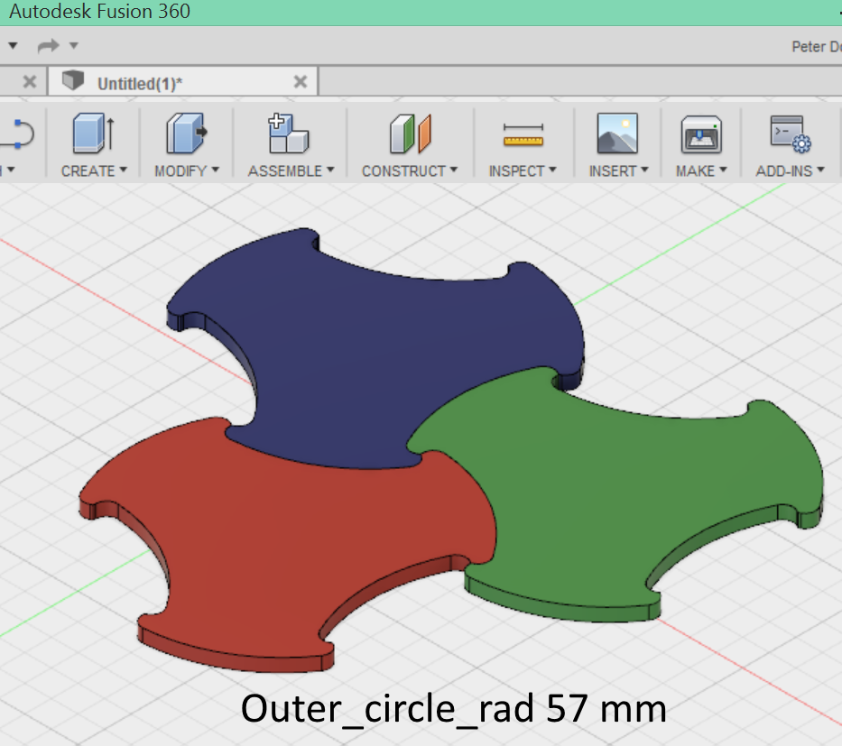

2 Attachment(s)
OK I got this by discovering that it doesn't like big changes in parameters at once, but little by little.
To get it to Outer_circle_rad 57mm, I had to step from 65 mm to 61 mm and only then to 57 mm.
Attachment 19968
If I tried a bigger change directly from 65 mm to 60 mm the design went crazy.
Attachment 19969
So it seems temperamental but with a bit of coaxing you can get it there.

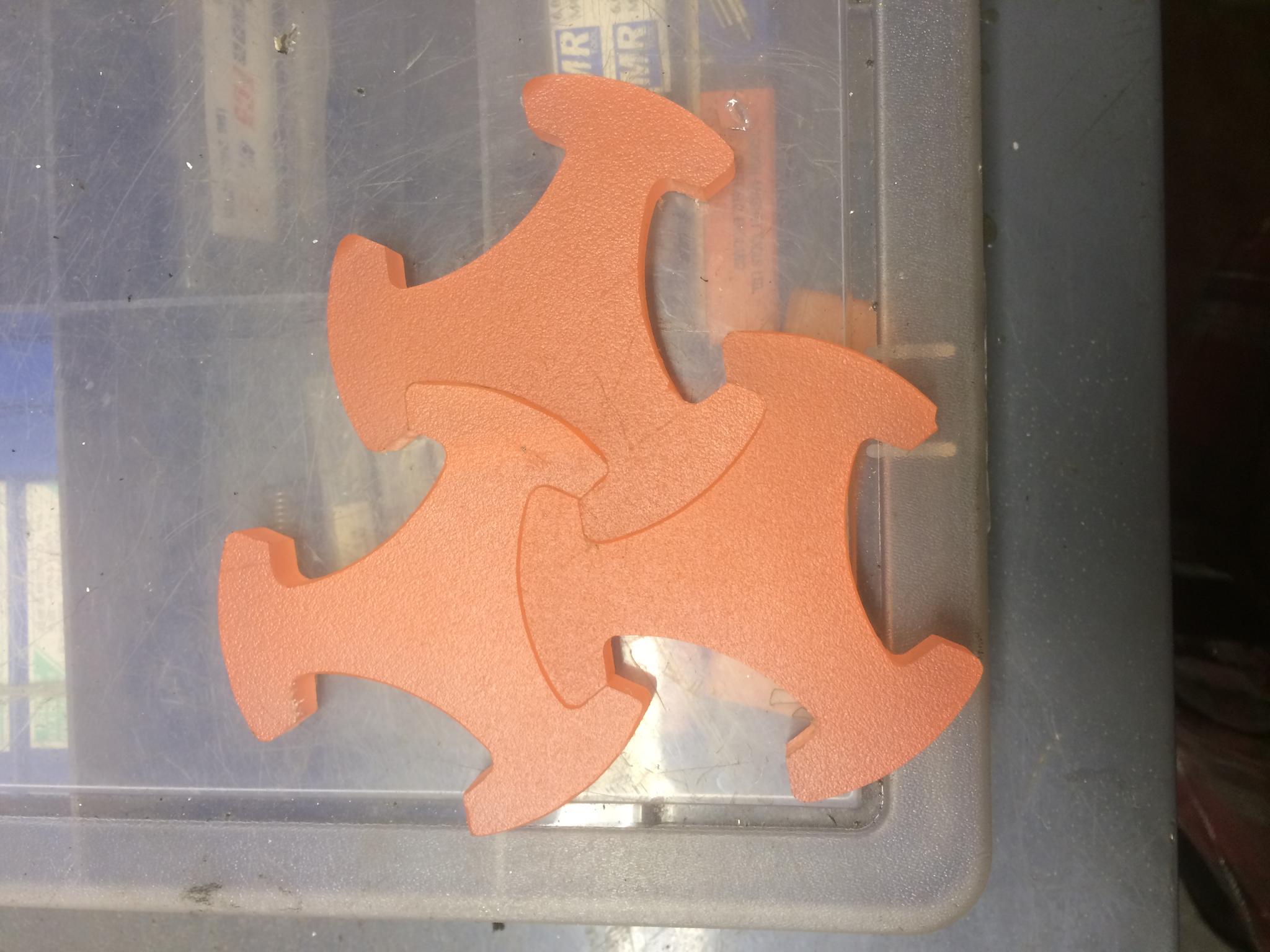

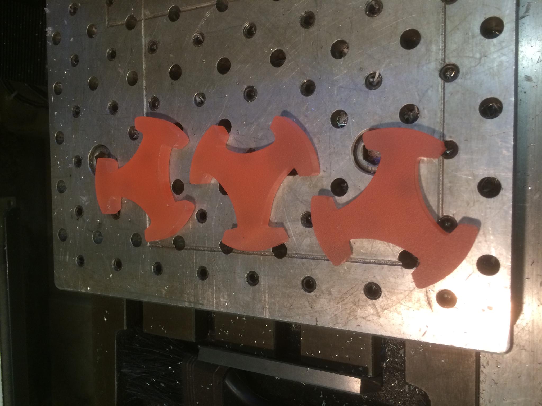

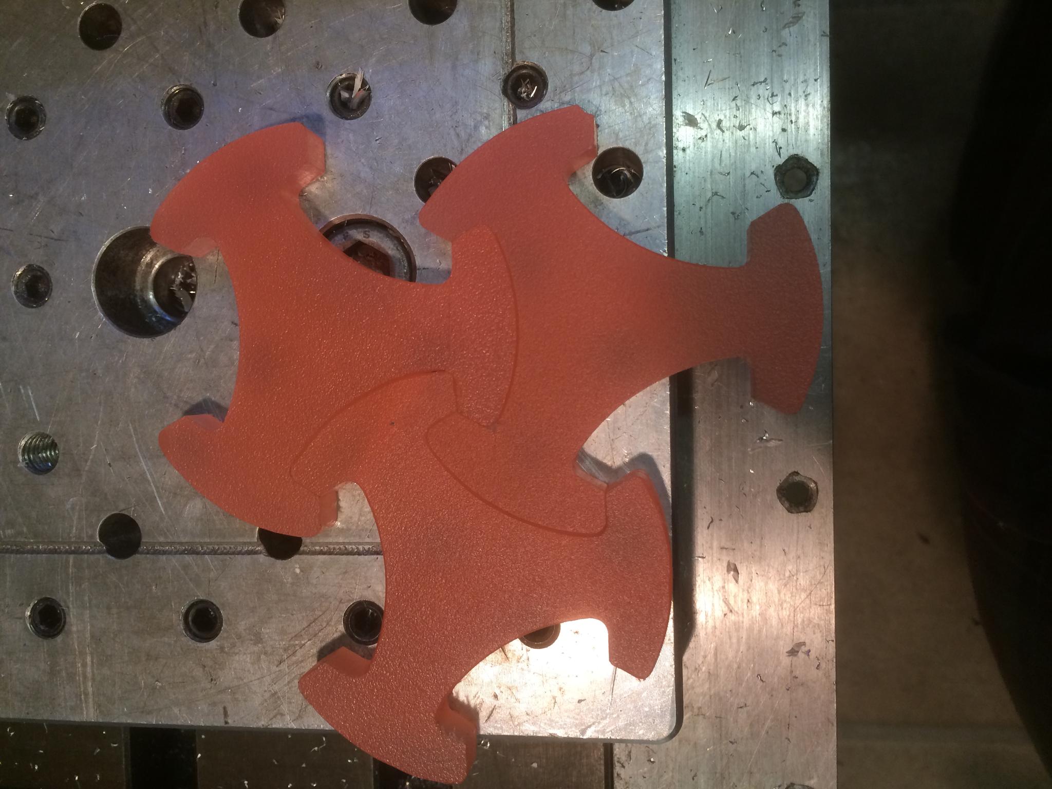

After following this thread for a while and being completely baffled by the circle/hexagon thing, I then had a look at Neale`s fusion drawing, and decided to try cutting a few of these dovetails out. Although I have fusion 360, I still find it easier to work in solidworks so, I downloaded Neale`s fusion 3D drawing and exported it as a iges file. Then in solidworks I opened it up, seperated a single tile from the three, and saved it. After opening it back up as a single file I then shrunk it down to a maximum outer diameter of 48mm, (the width of the piece of scrap chopping board I had lying around was 50mm) and saved it as a dxf. I am now about to go out to the mill and try cutting a few out:nevreness:
If this works, I will take a couple of pics to let you see the results. Just to add, I cannot take any credit at all as I am using both Neale`s drawings, and Peters original input for this experiment. So, big thanks to you both as I think it is a very nice looking and unusual joint !

3 Attachment(s)
Well that was quick & painless, seems to have worked a treat:peaceful:
Attachment 19970
Attachment 19971
Attachment 19973
Thanks to Neale & Peter.
Excellent. Good to see that it all works. I think that the corner radius was a good plan as it makes the design accessible to those with routers but not laser/plasma/water jet cutters (which probably means most of us) but thanks to Peter for the initial idea and doing the bulk of the leg work.
Needleworks - you need to make another 3 or 4 more. People see them sitting on a flat surface and can't help picking up a tile, turning it round, and dropping it back in somewhere else. At least, they do with my Escher reptile-based design, and I can't see why these shouldn't work as well.

TRISPOKEDOVETILES ROUTER CUTTING
My trispokedovetile CAD-CAM webpage now offers an (X,Y,Z) option for router cutting using rotary tool paths between spaced out tiles -
Attachment 20025
I've simulated the CNC router code -
Attachment 20026
Excellent!
It now merits the designation CAM ;-)
- Nick
