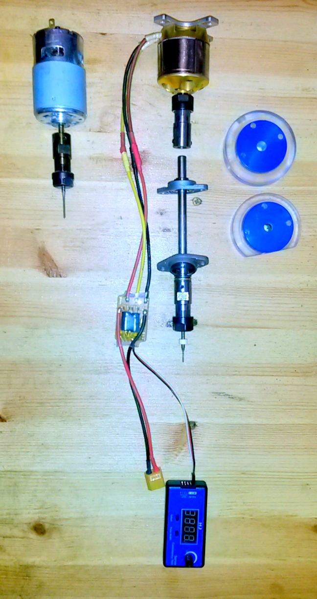

I rigged up a brushless spindle for the router, photo attached. This was made to fit in the original mount. Mk2 will have pillow blocks rather than the flanged bearings of Mk1.
A torque arm stops the motor from spinning.Attachment 26819
