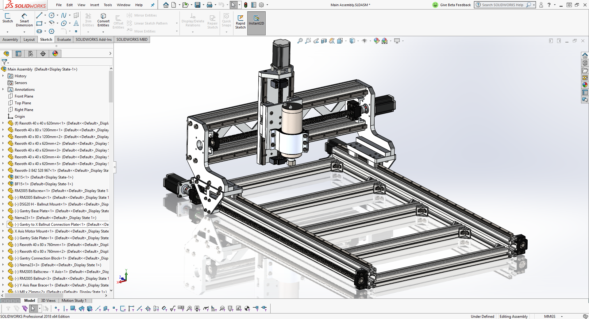

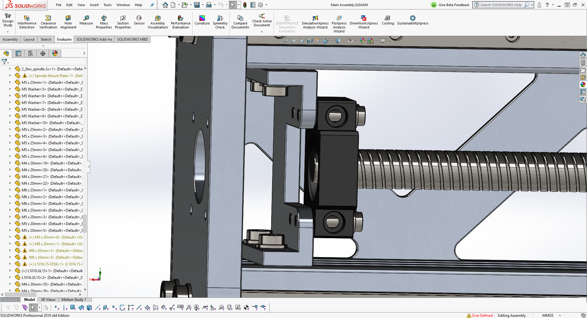

Hi All,
Just signed up this forum, i am currently designing a small (Large Desktop?) sized CNC Router for our business, it will primarily be used to machine 1mm Intumescent Fire Sheet, but also for producing one off parts for some of our older machines (Aluminium, Steel etc?). We have two much larger CMS Routers already that we use for production of which i create C Based programs for. I have a pretty sophisticated knowledge of building 3D Printers but this will be my first router, i had found this design online and really like how robust it looked:
https://jeremyyoungdesign.com/2016/0...inal-assembly/
So the design is heavily based on that machine.
So far it is looking to be built from the following:
Frame - Genuine Rexroth Extrusions & Connectors.
Gantry - 18mm Aluminium - Bespoke Plates, Would need to have these made (Pricey?!).
Low Profile L1016 Linear Rails & Carriages from Automotion Components - On all Axis
4NM Nema 23's on All Axis ( This Kit: https://www.cnc4you.co.uk/CNC-Kits/S...-4-Axis-Nema23 )
Dual RM2010 Ballscrews on X Axis
Single RM2010 Ballscrew on Y Axis
Single RM1605 Ballscrew on Z Axis
Appropriate Fixed & Floating Blocks on each Axis.
Ebay / Chinese 2.2kw Water Cooled Spindle
So that is the rough spec of the machine currently, the main things i am concerned about so far are:
- Controllers - The motor & driver kit comes with a parralell breakout board, however i want the machine to be compatible with newer Laptops (Windows 10 x64), when building 3D Printers i tend to use Clone Smoothieboards, would these also be suitable for this CNC Build? They perform well and are cost effective, also have stepper signal breakouts.
- Endstops - Mechanical endstops are common practise on 3D printers, i see many Router builds done using proximity sensors or hall effect sensors, are any recommended for maximum repeat-ability?
- Resolution - Will the 10mm pitch and 5mm pitch provide me with a balanced resolution / speed combination, i was advised previously that 2005 screws on the X & Y might hold back achievable speeds - or that i might be disappointed with the feed rates they would achieve.
- The build this is based on uses Aluminium for the majority of the Gantry and Z Axis plates, would steel also be acceptable? I was worried about making he gantry too heavy.
- I was considering buying the ballscrews from china, if they arrived with runout evident, could they be straightened, or might they straighten out once fixed in position?
- Might anyone recommend a company / individual who cold produce the bespoke plates.
Any help / criticism / heads up on missed items would be greatly appreciated.
Attachment 22441
Alex

Welcome to the forum Alex.
Some comments: Kits of parts are never a good idea, I hope you have not purchased them yet.
Nema 23 4nm are overkill I would use and have done several times nema 23 3.1nm from the same source now then that kit is using a 36v power supply you really need about 68v to get the best out of the motors so build your own (look up Joe's excellent vid https://www.youtube.com/watch?v=WISDqx-e23M ) go for AM882 drives from China as they have stall detection etc (you will need that if you are putting two motors on one axis)
Linear rails and ball screws can be got from Fred at BST [email protected] China very reliable guy.
Just email him for a quote and mention the forum. You may need to have the F length on the screw to be altered from standard 15mm say to 30mm to fit the pulleys Your screws are fine for what you want to cut.
Spindle again China be careful with the vfd as there are two types that look the same to the untrained eye. So post a link here before you buy.
proximity sensors are good and cheap about £3.50 china or ebay
Finally keep all your questions in one place then people can see what you are doing and chime in
Good luck with the build
Edit go for 20mm rails all round 15mm are fine but much harder to deal with.
Edit Just noticed the screws 20mm!! I would use 16mm all round but it depends on the length.
Re: Building My First CNC Router, Looking for Advice & Other Info

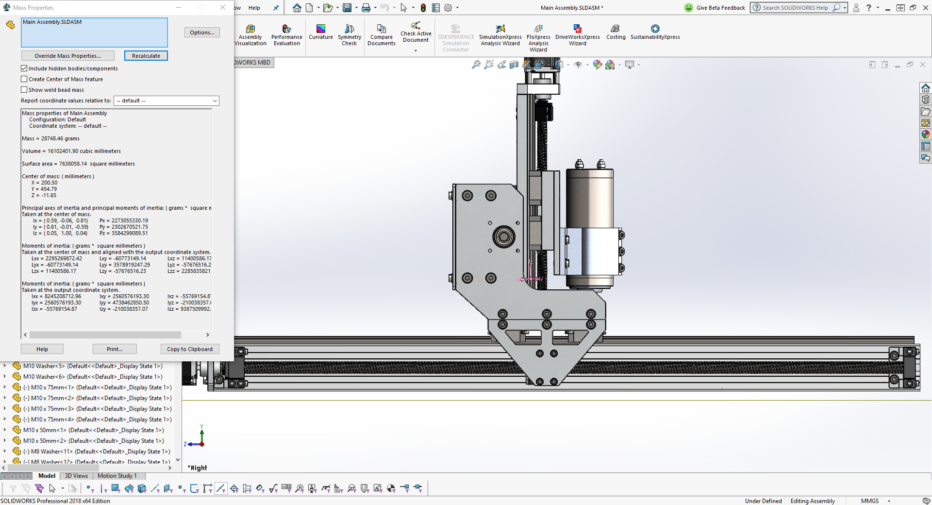

Welcome Alex! I'd personally be rather worried about how the weight from the gantry is being applied to the X-axis bearing blocks at such an angle. I'm not sure if anyone else would share the same worry but It's certainly a great design! Now as someone who recently within the past two months purchased ball screws from china there is two things you need to know customs will sting you for import tax and the quality of the screws is fairly decent (20mm screws 5mm pitch).
Also to some more of your questions. My gantry was built from steel and I've regretted doing it ever since. Far too heavy and aluminium would of done the same job with ample structural rigidity. Proximity sensors are much better than mechanical switches, break out board wise if it has a parallel port if you want to connect to modern computers just buy a UC100 connector and all your issues will be resolved but make sure it's the legit one and not a Chinese fake one otherwise it ain't going to talk.
I have got a post talking about my gantry on my build post if you want to see why steel was a bad choice by me.
RobC
I'm not sure I understand what angle you refere to... If it's about the gantry weight distribution to the X axis glides assemblies, the answer is at a few SW clicks distance. Make sure you have set the actual material/ mass of the components then look at the center of gravity. It should be close to the center of the X axis bearing blocks assembly in the vertical plane perpendicular to the X axis.
paulus.v
Yes i was referring to how far out from the blocks the weight is being applied.

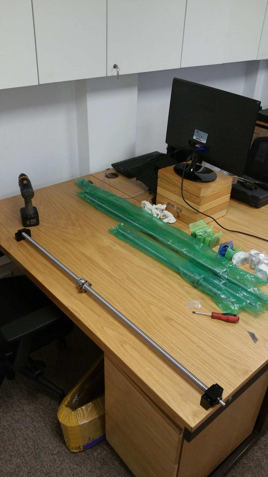

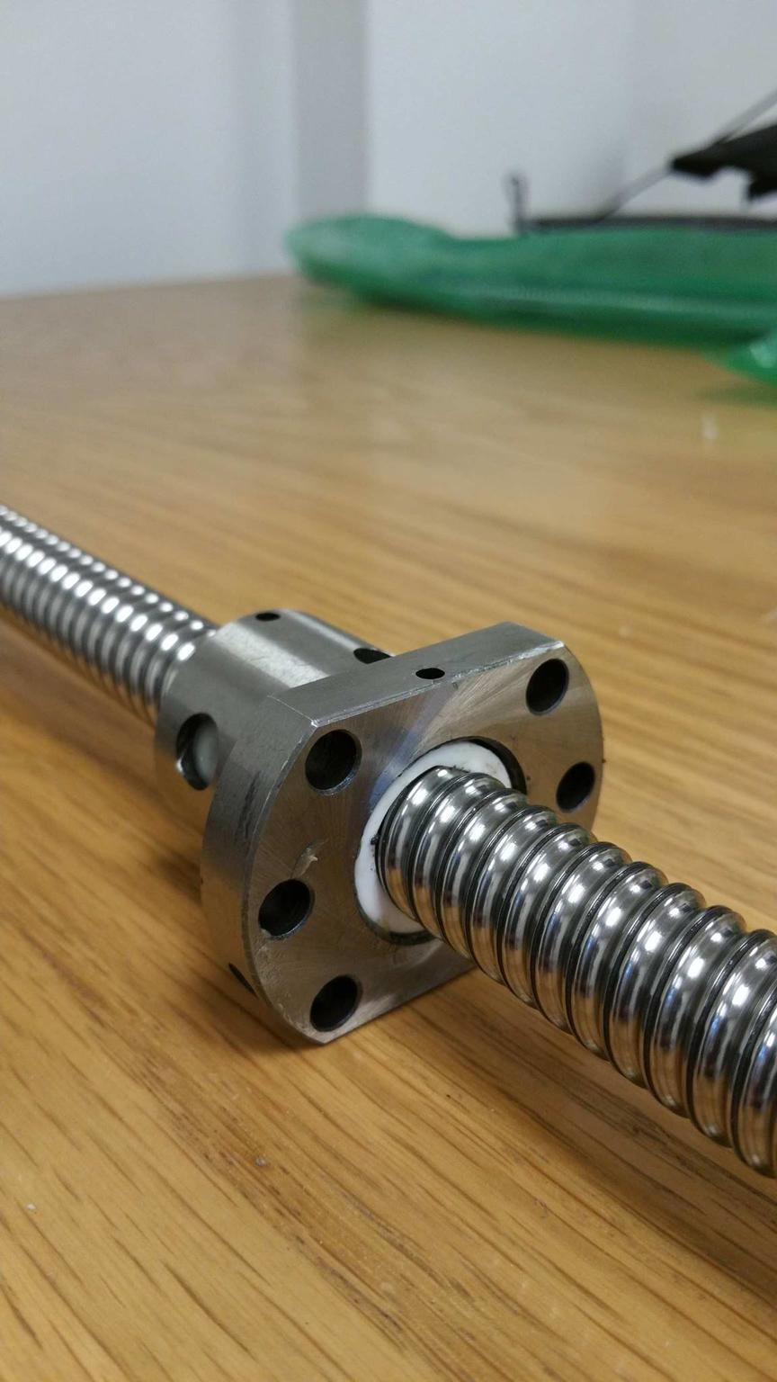

Hi Clive, thanks for the pointers! I have as you said decided not to buy the kit, the saving was insignificant and i did not want to be using that breakout board they were supplying anyway. I also questioned why they supply a 36v PSU with the kit, when you look at their higher volt PSU's it states that they are not compatible with the Drivers supplied in that kit...? Seems iffy to me, maybe the drivers are cheap and can't run at the stated specs. I will probably go for those drivers you have mentioned if they come with good recommendation.
Not sure i feel comfortable building my own PSU haha, i will try to find a higher quality alternative.
Ok so, when building my last 3D Printer i had used a chap on Aliexpress to provide me with the ballscrews and everything else associated with them. I compile a list of what i needed this time and first priced it from the UK, so i had a list of what i needed which was going to come to about £690 + Delivery here in the UK, went to aliexpress and returned to the guy who supplied me before and sent me this quote back:
2 x SFU2010- 1200mm with 2pcs nut with end machining=$42
3 x Set BK15 BF15=$24
3 x DSG20H=$6
3 x XB30x40-8x12=$8.46
1 x SFU2010- 712mm with 1pcs nut with end machining=$16.46
1 x SFU1605- 362mm with 1pcs nut with end machining=$10.2
1 x DSG16H=$1.21
1 x Set BK12 BF12=$6.22
1 x XB30x40-8x10=$2.82
Price is $117
Shipping costs is $100 by fedex to UK
Total is $217
Now i honestly could not believe how cheap that was, if i ordered today it would be £166. I got a price from another supplier on there and they quoted ~£340 delivered, would your guy be anywhere near this do you think? Even if they were bent there would be lots of room to play in terms of having them straightened at that price.

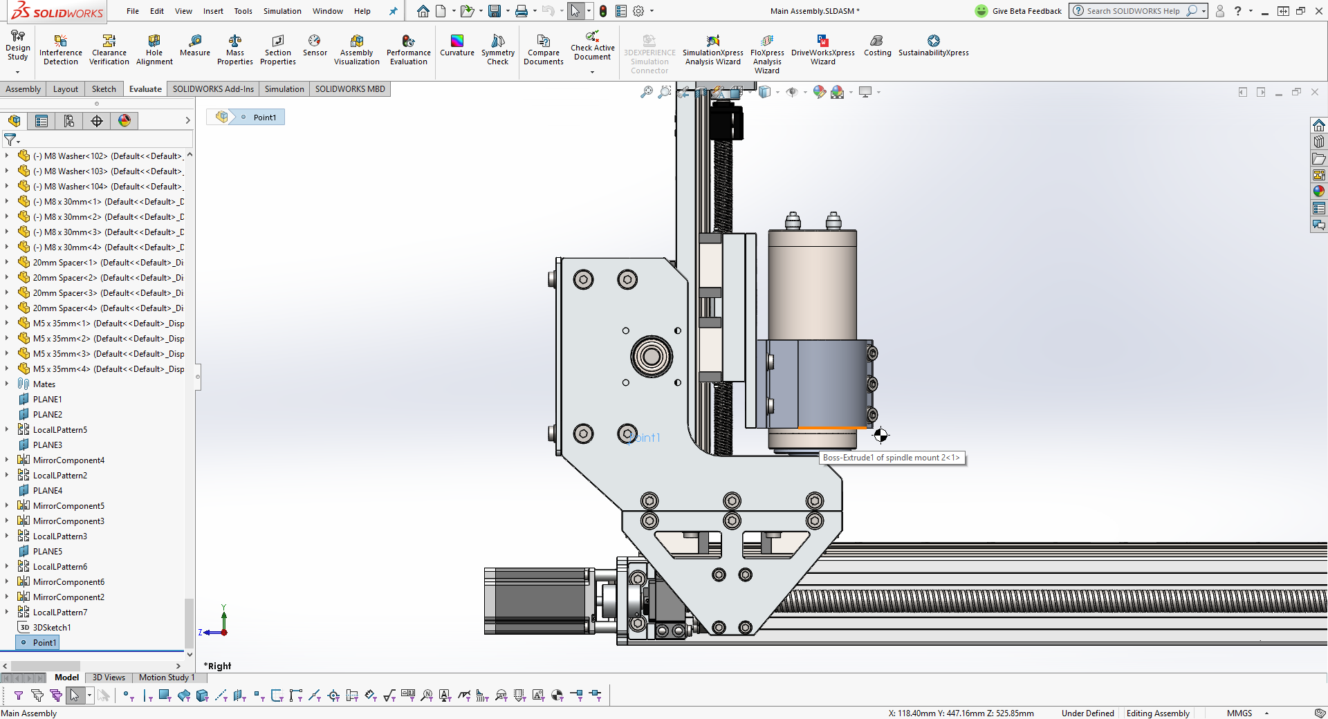

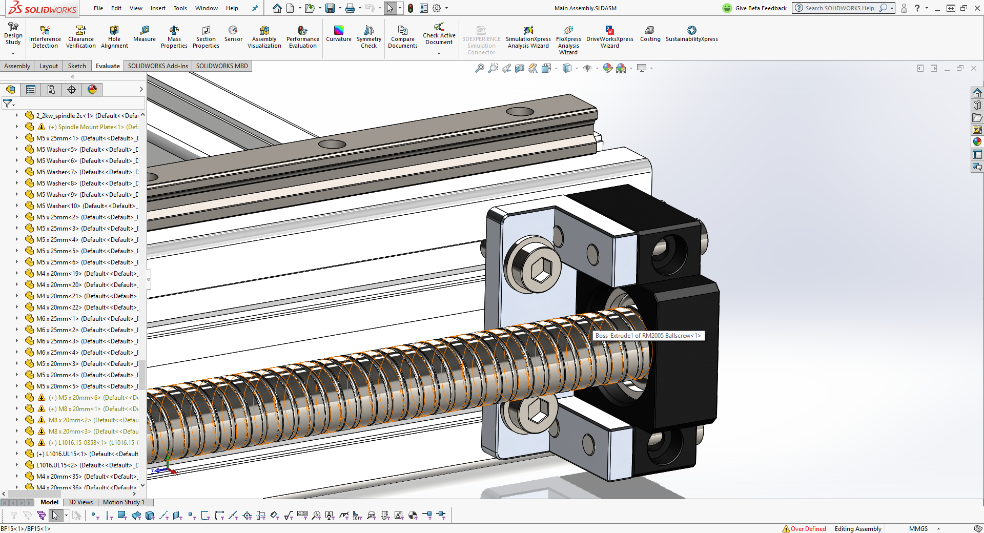

Ok, so the Axis is orientated as is to try and get the maximum workable area within that size of frame, i could have made it more central "looking" but in reality its not really central because on one end of the axis the spindle can reach past the machine, and on the other end you have a few hundred mm of area that you cannot reach, this is why i have tried to balance it and make the most of the space available. I'm nt sure of the weight of the spindle but this is obviously very important in order for Solidworks to calculate the centre of mass, i had read online that in general a 2.2Kw spindle will weigh in the region of 5Kg. So i set that as the mass of the spindle and run the evaluation, and it came out pretty well imo, more than acceptable to me, the linear rails and carriages im using are supposed to be high quality so im hoping that they will be fine:
Attachment 22475
EDIT: Just realised that picture isn't so great, the Centre of Mass appears to be just in front of the left side carriage block, and it also shows a slight angular (right word?) pull, twisting towards the rear of the X Axis. Possibly i could move the right carriage block towards the middle some? This would seriously hurt my OCD of having them space equally.
Thanks Again for all the replies i've already learnt alot so keep that criticism coming :D

Unconvinced with my result from the Centre of Mass evaluation i done, i got on the phone to Solidsolutions, who provide our solidworks license and also provide support, indeed i had done it incorrectly. Here is where the actual centre of mass is on the gantry. It's hard to see, but where it says "Point 1".
Attachment 22476
Not sure how much of a problem this poses, are the carriages likely to be affected by this? Not how i might remedy this other than reducing the Gantry to a single 40x40 extrusion as opposed to 40x80 and then centralising over the Gantry Base Plates further. This in turn might affect how rigid the gantry is surely?

Just wondering now about the weight distribution on the gantry before i start ordering bits.

Ok, i need to do some serious research to see if that controller can handle that, i know it provides for 4 Axis but im not sure if the 4th can be setup as Dual Axis.
So i know i keep banging on about the weight distribution of the Gantry, but i really am being stupid today. It seems at some point i had lost all of the material properties for my assembly parts, ive just spent a little while going through and properly setting the weights of each component, i have based the Aluminium Plates on being a 6061 Alloy, whether or not this will be the material the plates are cut from i dont know, but it was the most common material so i though i would go with that, i re rain the analysis and it has given me a hopefully accurate Centre of Mass for the gantry, indicated by the Red Dot, im hoping this is a pretty acceptable balance and wont cause any undue wear or stress to the linear bearings:
Attachment 22477
Alex

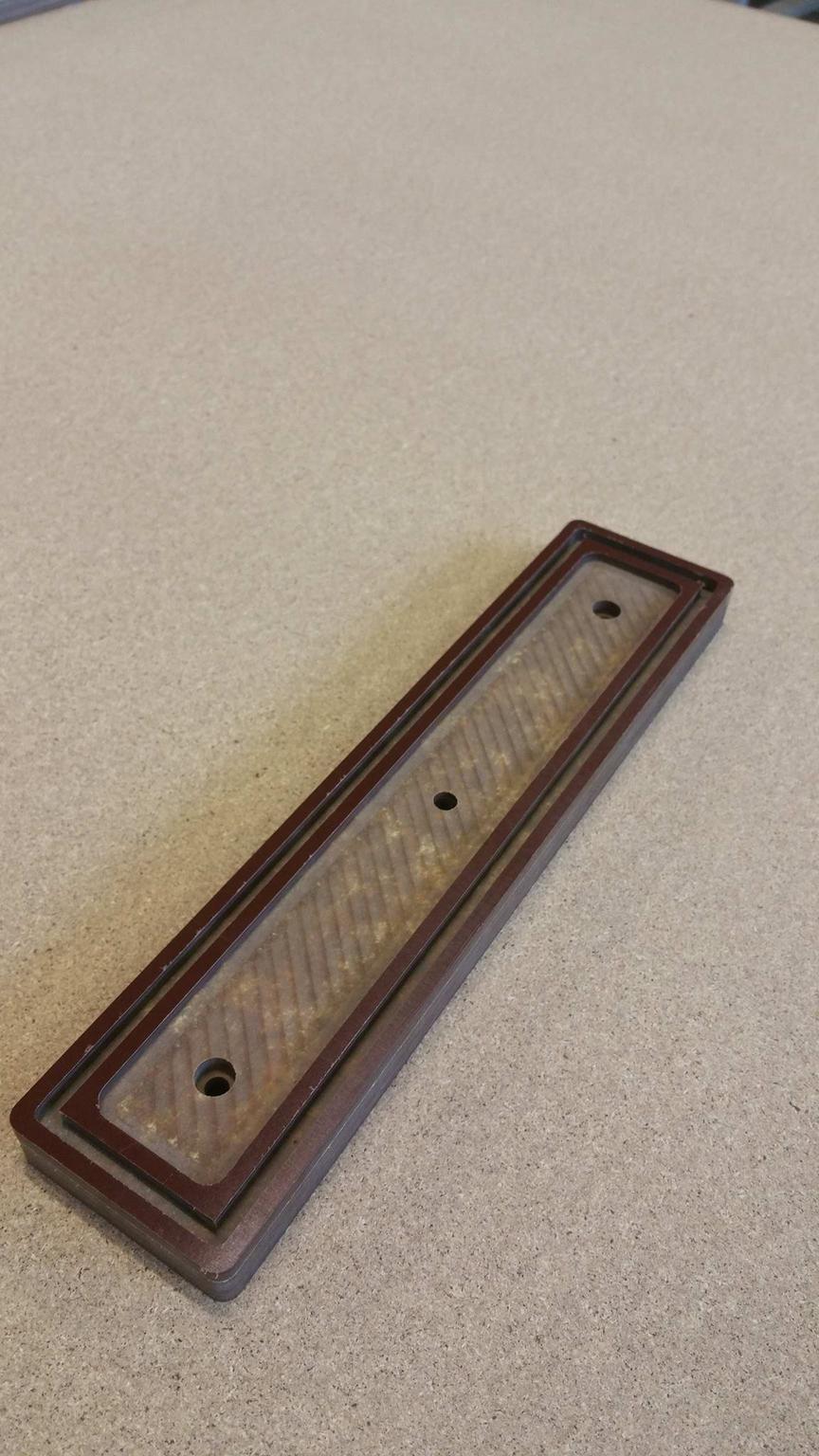

For the machines main function (Routing the 1mm Interdens), i will simply use 18mm MR MDF, and use strips of double sided tape to hold the sheet and keep the cutout items in place after they are separated from the main sheet.
I will also drill the MDF and fit a grid of threaded nuts to use standard clamps / buy a machine vise for machining components we hope to make out of aluminium / bakelight / acetel.

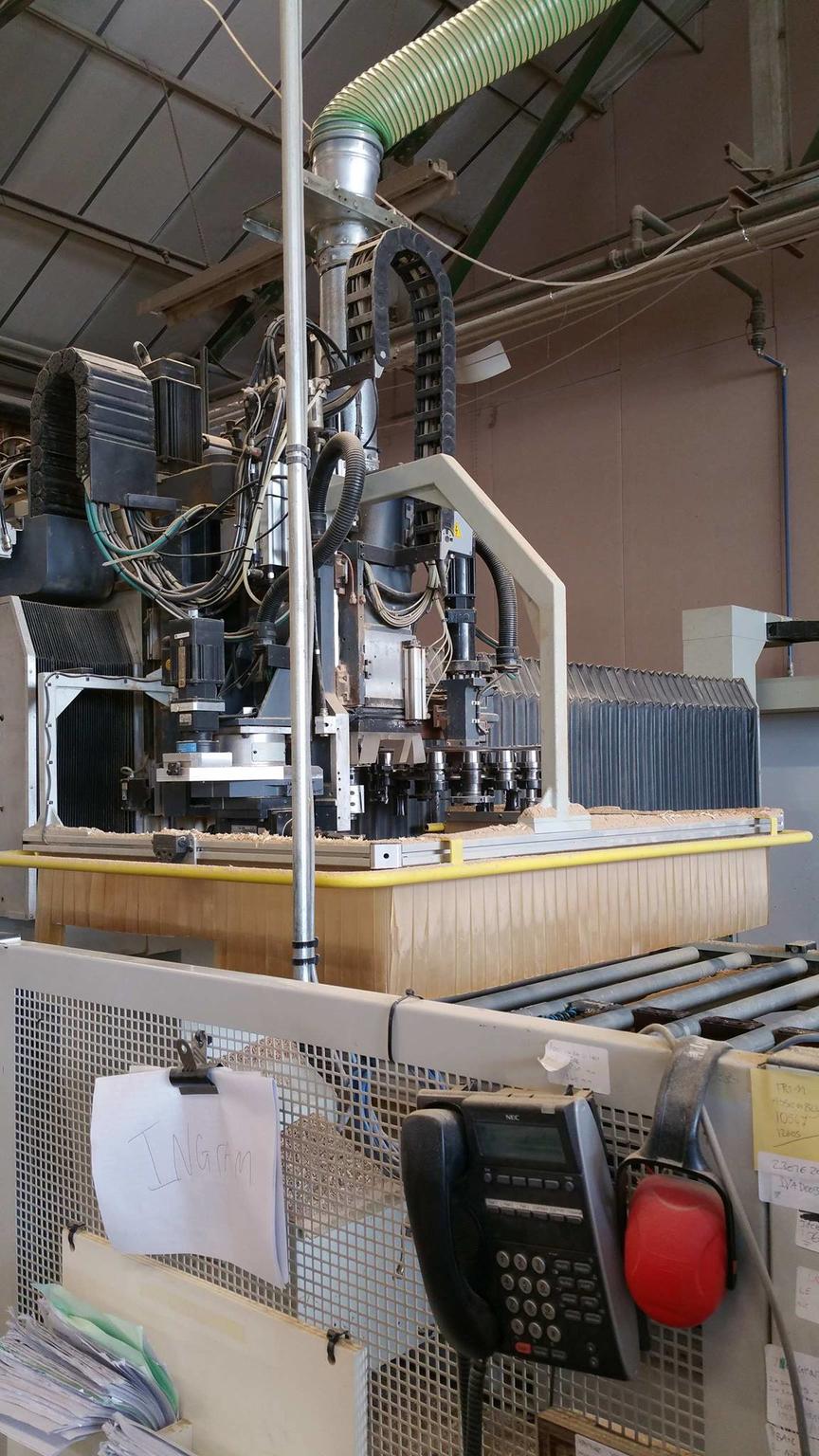

Our larger CMS machines use vacuum pods, sometimes these suffer a nasty end if they happen to meet with a cutter :( I have machined them before on the smaller of the machines but i find it difficult to get repeat-ability in the jig i made to machine them. It will be much easier on this machine. The largest of the pods are 80mm Thick Phenolic Plywood so it will be a good challenge, i think i have enough Z Travel.

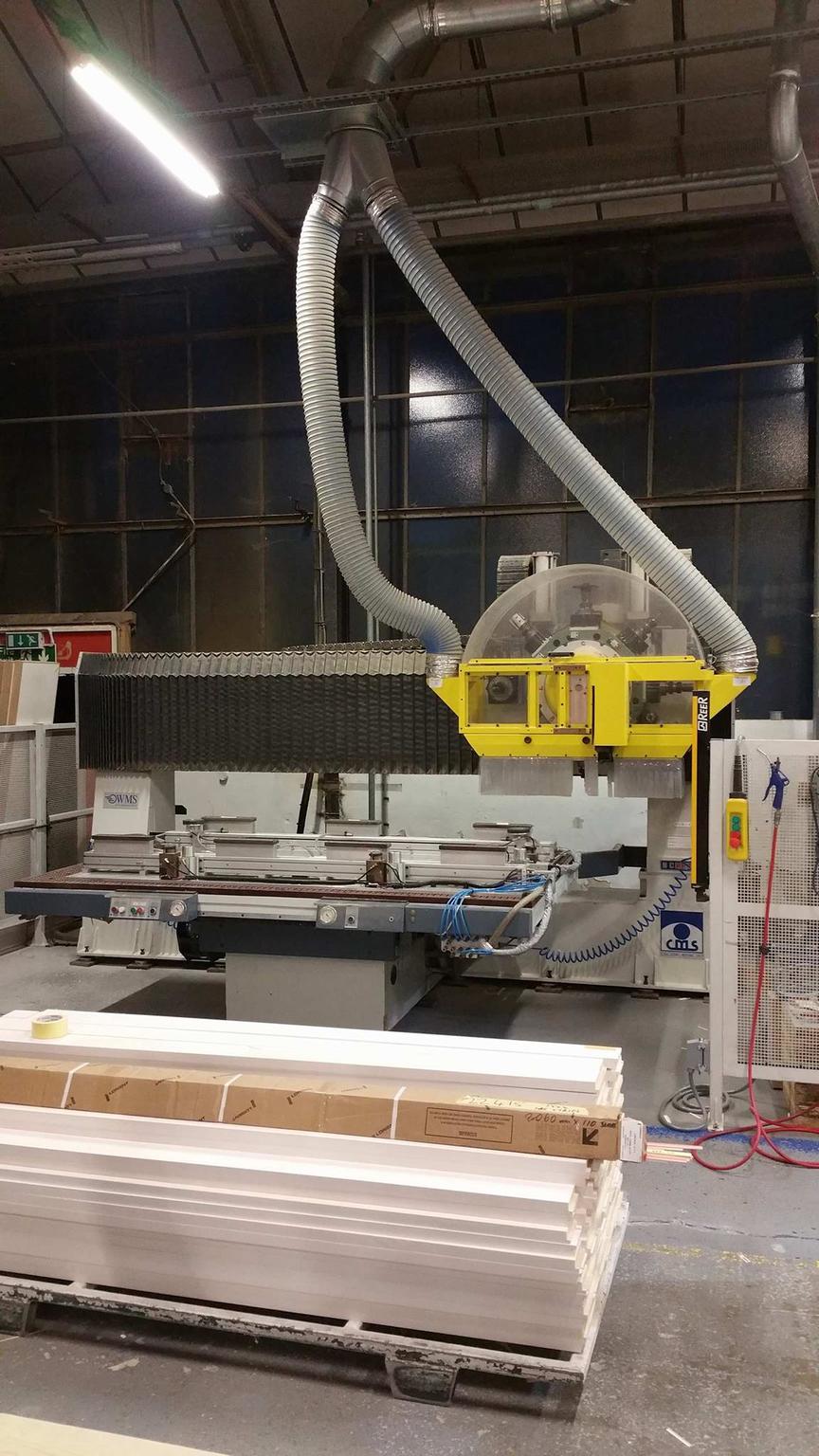

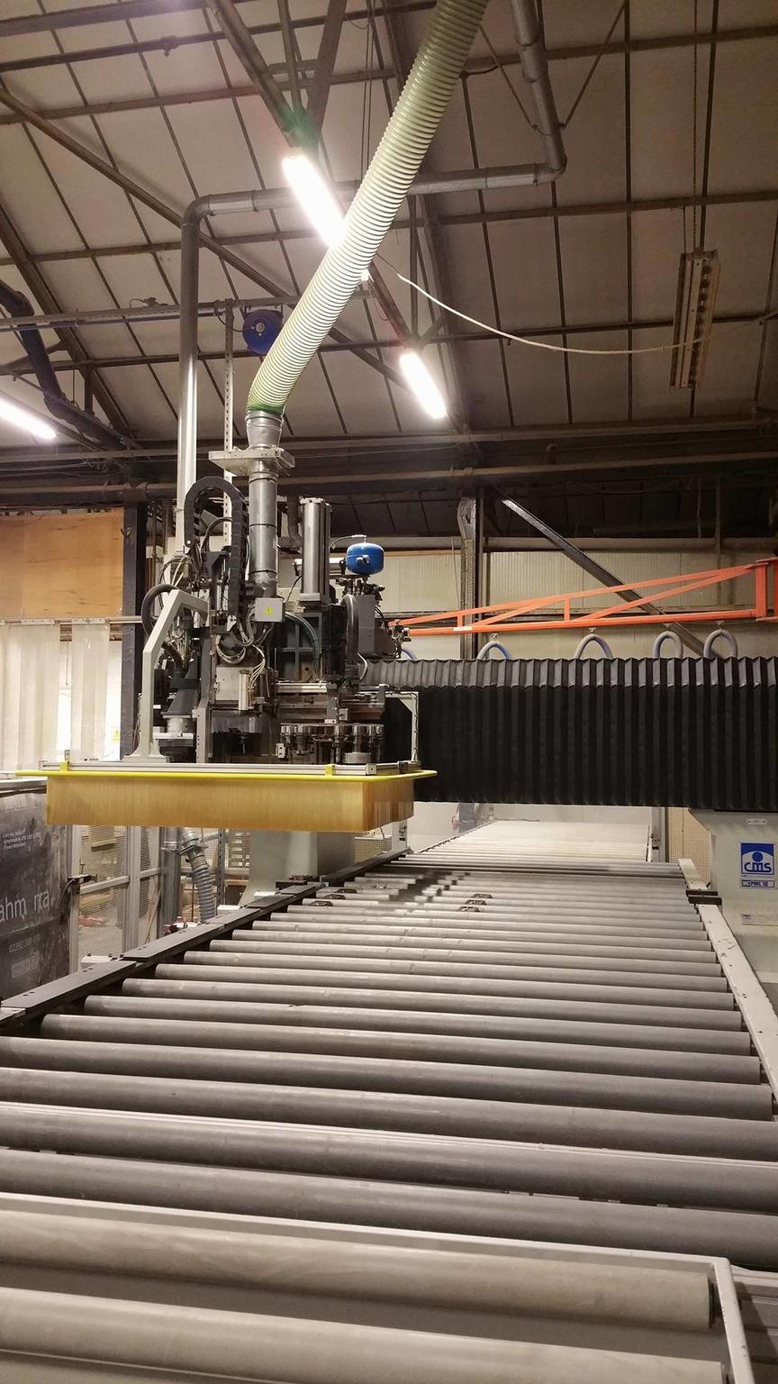

Here are some pics of the 2 Bigger Machines and an example of the Vacuum Pods. The Larger Through feed machine has a 3200 x 2000mm workable area (depending on which tool your using in the Horizontal / Arbitor A Axis), It has a 16 Space Carousel Tool Changer. It has a "5th Axis" which actually only controls the mobile vacuum pod row.
The smaller machine has 2600 x 1300mm workable area, 1 Horizontal / Arbitor Head - 8 Head Revolver (8 Motors Fitted with Tools, very fast tool change, mass production suited).
Both machines use an OSAI Controller, programs are generated from a CAM Package called DDX PowerCam - I write C Based Programs for Component Files, we use an Access Database where the guys in the office can build different Door Configurations (We make timber fire doors), Access exports a text file of parameters, PowerCam reads the text file and builds the CAM File autonomously, no manual drawing is ever done.

I holed the extrusion cad model then emailed them the model as a .stp but you're using solidworks which they do so you can send them a solidworks file. Make sure the holes are the correct size lol, should be 13mm I think but check this they can tell you if you ring them.
As for counterboring just tell them to counterbore every hole on 1 side with the correct size head but again they will know this is a pretty standard operation. There's no need to model the counterboring.
Make sure your hole size is correct! I can measure the correct bolts with a vernier calliper but will have to wait till tomorrow.
You are using 9045 and 4545 extrusion? If so you will have the same issue I have if using BK12/BF12 ballscrew mounts the hole distance is 45mm between the tracks and the hole distance for the mounts is 46mm.
My Y axis I'm having custom mounts made for the gantry I'm just going to wangle the mounts into T nuts but did consider custom T nuts offset by 0.5mm. I still might have them made.

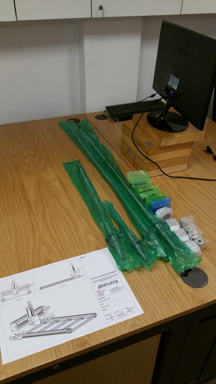

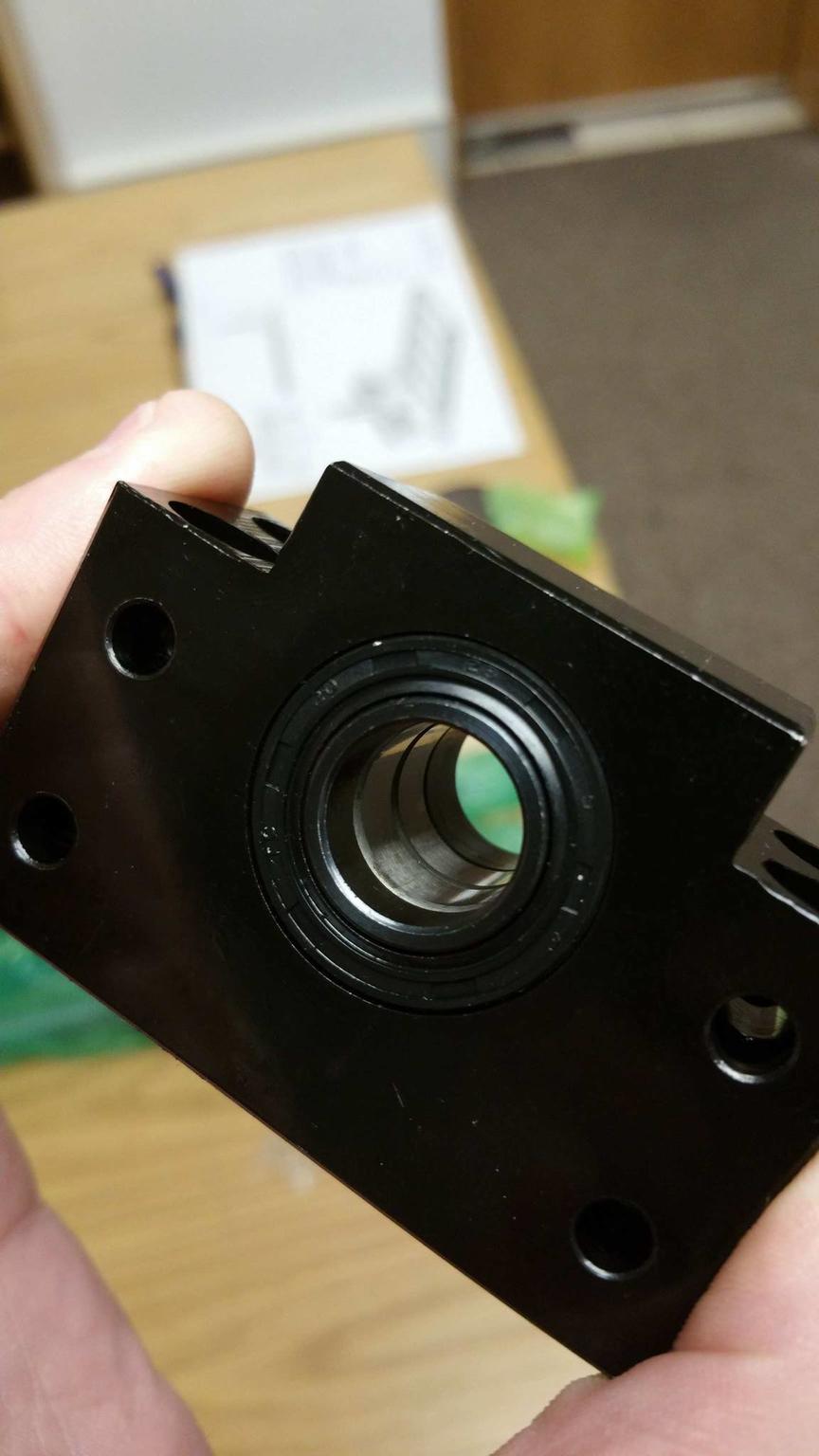

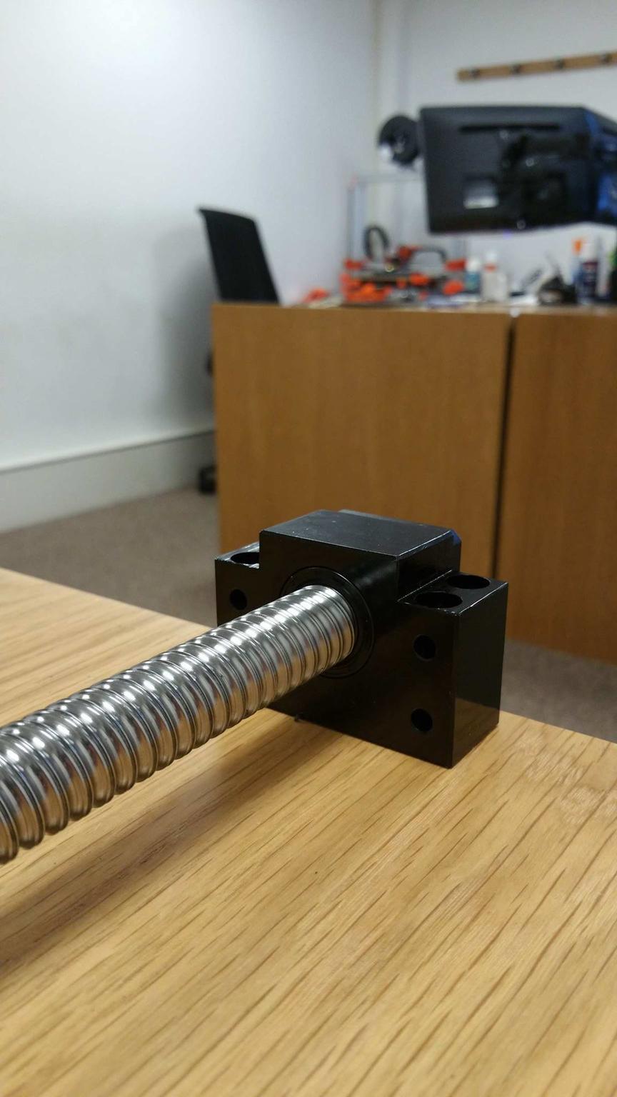

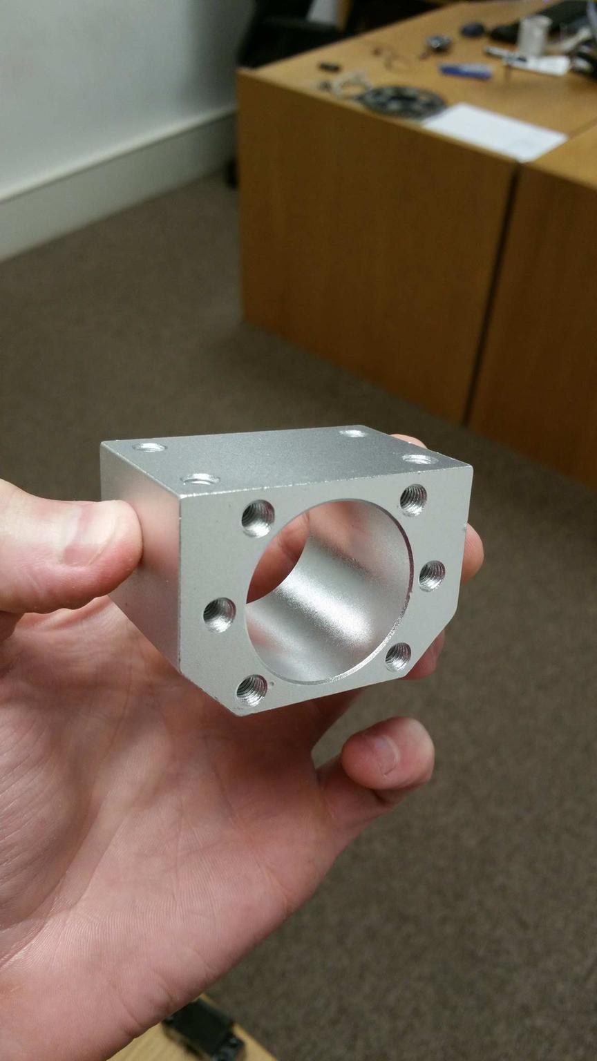

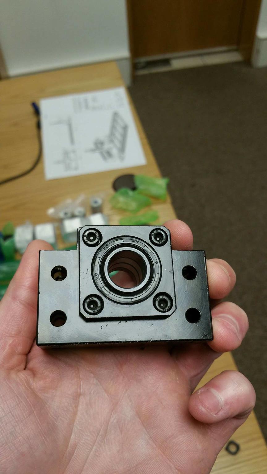

So my Ballscrews were dispatched from China last Thursday and arrived yesterday, upon first glance they look to be pretty decent (for £170 delivered!), none seem to be particulary bent compared to what i have seen in some threads / videos, the RM2010 screws seem to be slightly stiff but im hoping this will clear up once they are greased / run for a while.
Ballnuts, supports etc look pretty cheap but will do the job just fine.
Ordered the extrusion which should also be here this week and also all of the fixings.
3D Printing the aluminium parts to do a dry assemble, still waiting to hear back prices for the aluminium plates but wont order anything until i have assembled it using the plastic parts to check everything fits properly.
Alex
