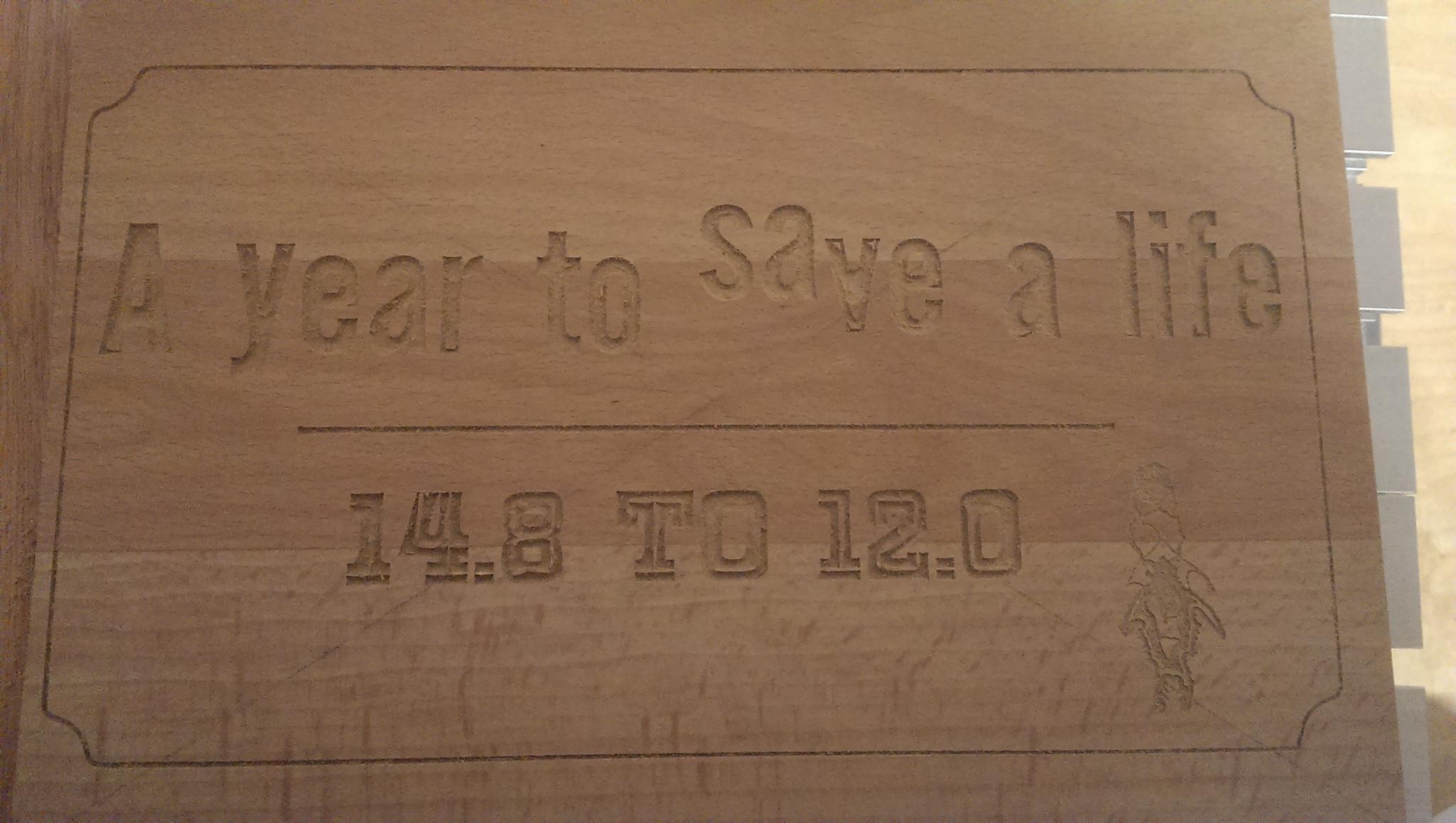

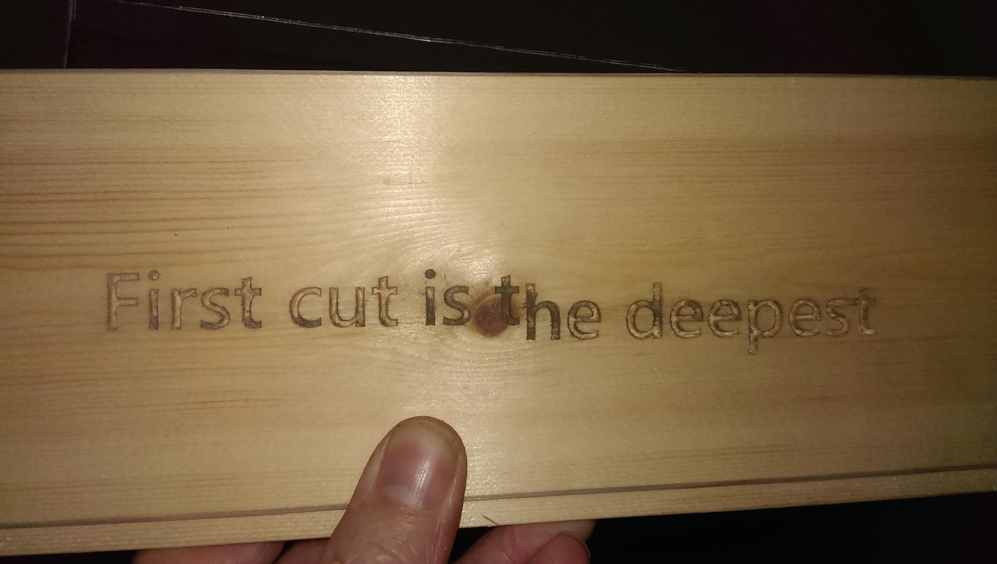

CNC router occasionally makes jarring noise and home jumps when it does this. Help!!
Hi Guys I was hoping that you could help me track down the problem behind why my CNC 6040 router now and then (but pretty much most jobs) it will happily be machining away. When at some point the machine will make a louder 'jarring' kind of noise and it appears to be along the Y axis by what it does to my work pieces (the longest axis which the gantry moves across). The machine doesn't appear to stop but it looks as though it jumps by about 10mm. I haven't been able to physically see this by eye as everything is always too quick and it's not spectacular enough. But I can see it jumps on my work.
You can see from the photos attached what it is doing.
The machine appears to be operating just fine until this happens i.e circles are all correct as are square shapes.
I know that they have lots of quality issues, but I would be really grateful to you guys for advice on how to diagnose this.

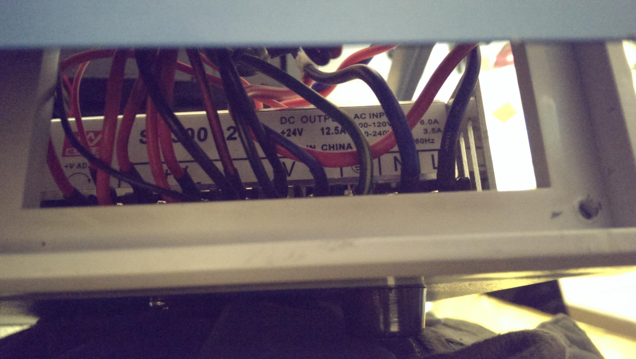

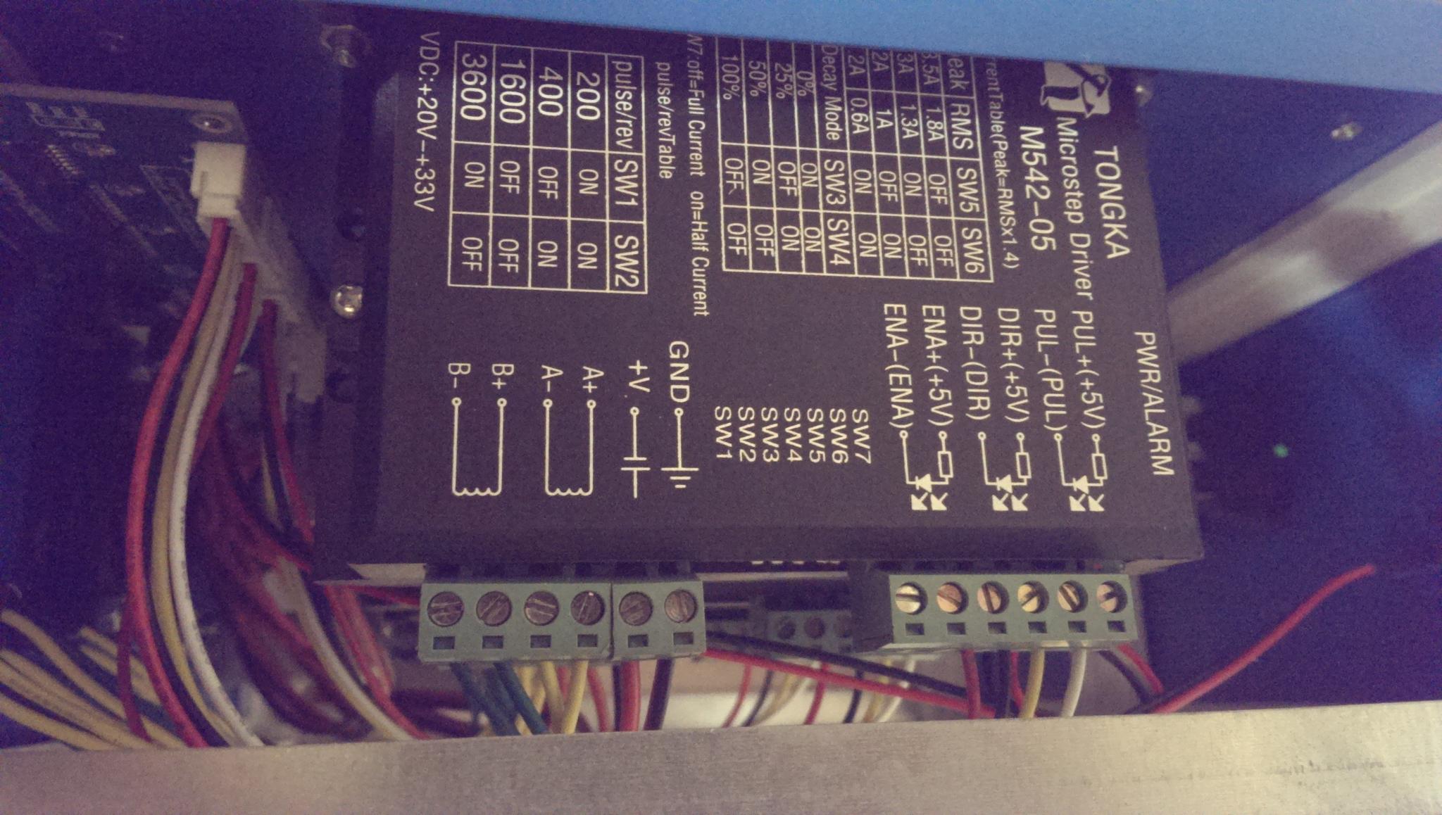

Upon starting up the CNC router and running mach3 on my desktop all 3 stepper motors lock as they should and the router happily runs/jogs along all axis. I can turn the stepper knobs by hand freely and cannot feel any rough parts of travel in the ballthreads.
Please help me diagnose this with simple steps. Is it more likely that it's wiring or a stepper motor or driver?
Just guessing possible Y axis wiring issue. But would love to see what you all think.
As you can see this error has made it into all 3 jobs below. Looking forward to hearing what you guys think.
Cheers andy

On the second photo it looks like it jumped then came back into line again, did it do that itself or did you intervene and correct it ?

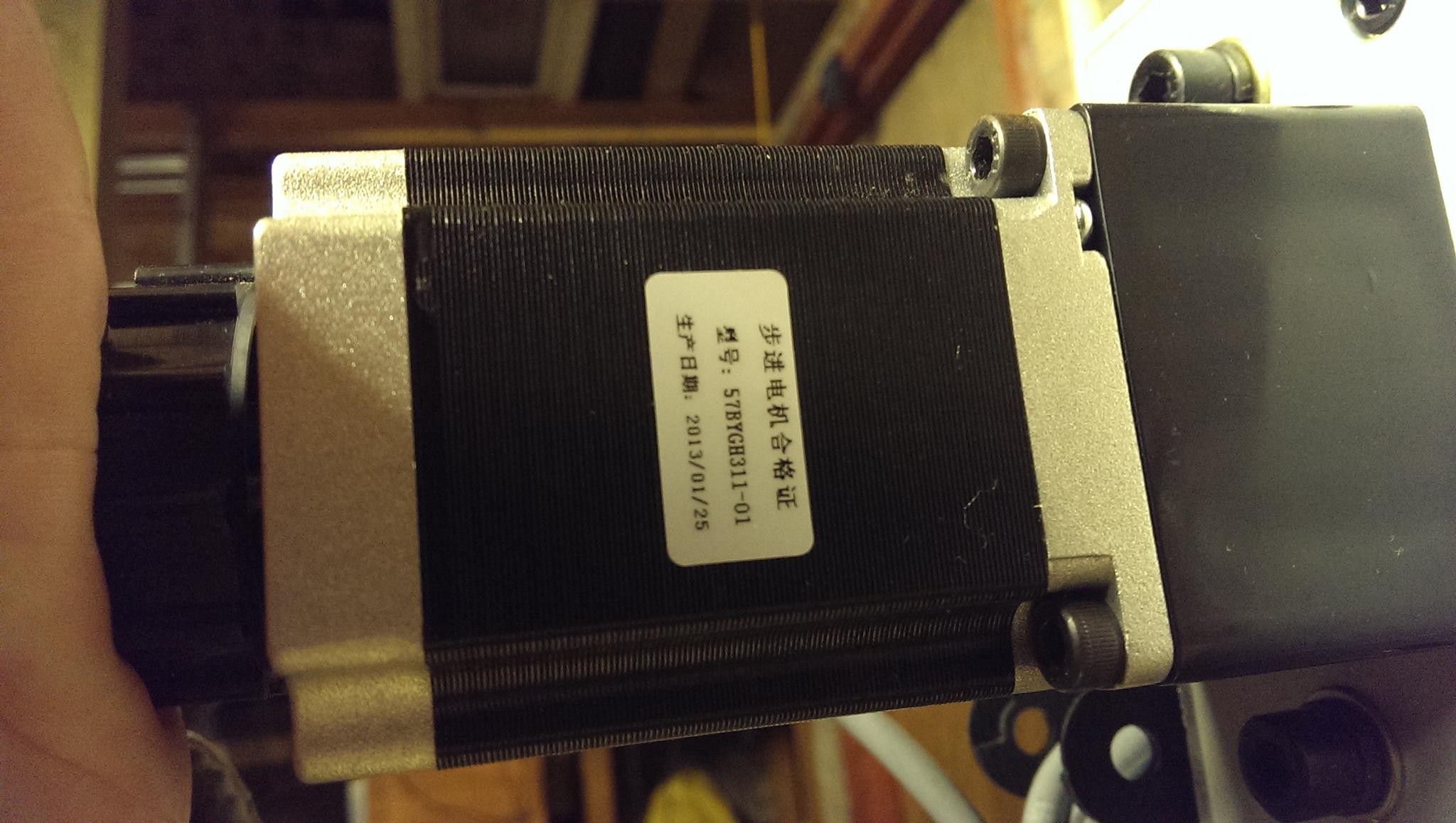

Is it direct drive or via toothed belt ?
Re: CNC router occasionally makes jarring noise and home jumps when it does this. Hel
I think in the second photo it jumped twice by different amounts, as it's not gone perfectly back into line.
It could just be the Y-axis motor is very occasionally stalling. I'd try running this code to test it more thoroughly and report back.

For 2. Only advise I can give at this stage is if your wiring is not using shielded cable, then replace that with shielded CY cable and ground the shield at the control box end only and to the same ground point all the other earths on your machine should be going to, which should in turn be wired to mains earth. Make sure the ends of the shielding at the stepper motors are isolated i.e. not contacting anything. Other than that you are looking at driver, control board/BoB replacements, but I can't advise on diagnosing your existing components. Also I have seen some stories of inadequate grounding within the control box itself, so check that out.
Oh also if the machine came with a cheapo parallel cable for connection to your PC then try another one. I had a problem with my machine getting spurious e-stops that turned out to be a shoddy parallel cable. Replaced it with a chunky shielded one and that problem went away.

If it's a sudden jump straight after the Jarring noise and it's just on the Long axis then I suspect it's the ballscrew end bearings floating.?
Grab the gantry firmly at both sides and try to move back n forth. If you have end float you'll feel it clunck.
If it's losing position over time then I'd suspect a lose coupling first, after that then I'd look at the wiring. These cheap machines come with crap wire on the motors which gets brittle and breaks internally but still works and causes all sorts of strange things like this. Same with the connectors there rubbish and need replacing.
From you saying it works fine then does this then I don't think you will have it over tuned or anything so wouldn't go messing in that direction just yet.
With the noise your saying it's making then 90% chance it will be mechanical 10% wiring or electrical.

Thanks guys loads of ideas to look at here! eddy its a direct drive stepper motor without any drive belts. As for the photo and it correcting itself. I think it did the top text line in a different order I.e do a few letters and go do something else then come back. I haven't corrected anything in any of the pics.. hope that helps?

Check your pulse train speed as I had a sort of similar issue and found I was running too fast. If you want to post up your axis settings I'll check them against mine. I've got a 3020, but I think the settings should be similar?

100% the noise is motors stalling from being over tuned and trying to cut too fast.
Looking at the speed you where cutting at I think your being too ambitous on the Feed n speeds for this little machine and the motors are running out of torque and thats why your getting stalling motors.
Drop the feed rates down and try again and I think you'll find it works fine.
You could play with motor tuning which would help but I think your just pushing the little thing too hard.!! . . .. Try lowering the Accel first if you adjust motor tuning has that will have the biggest affect and would cause this kind of stalling/missed steps.

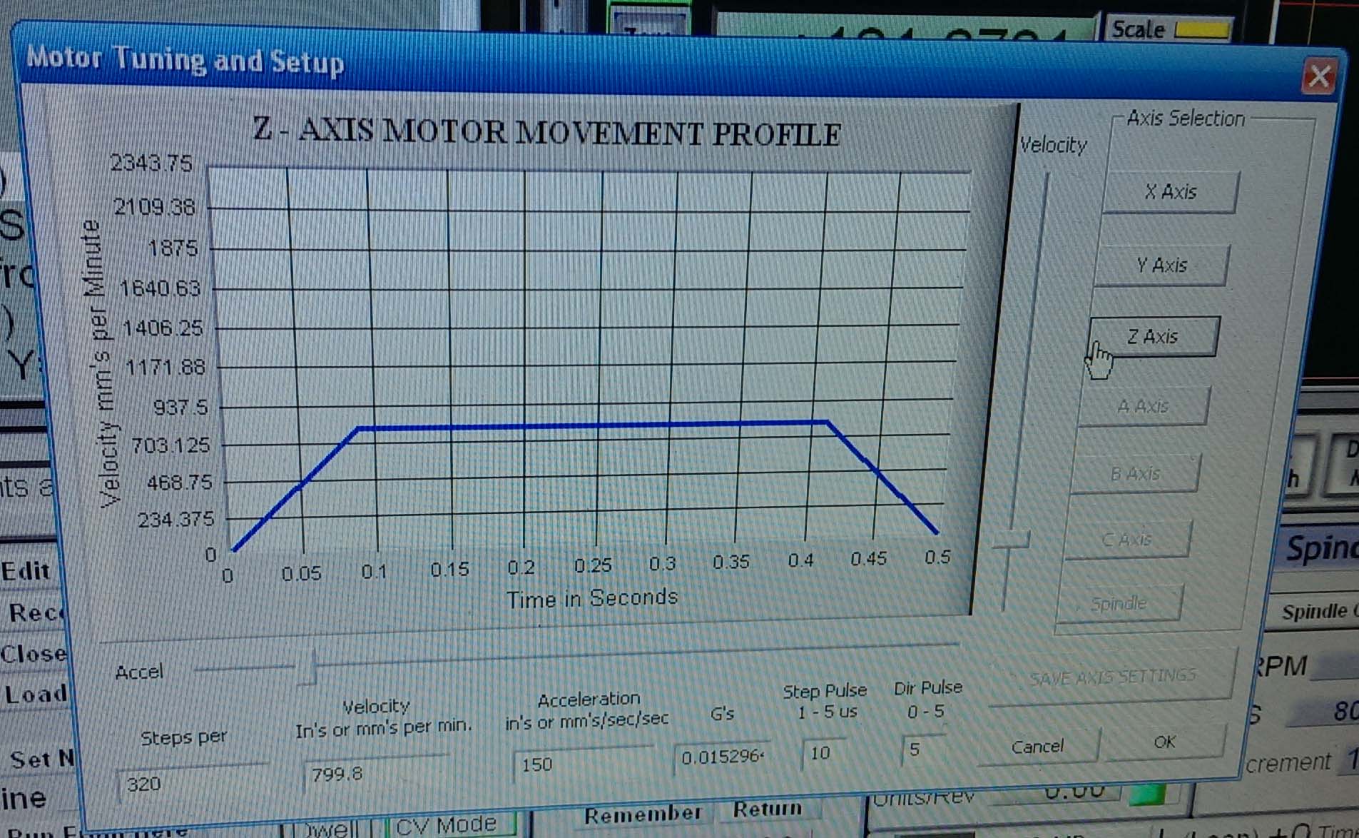

Rapid speed is the Velocity setting in Motor tuning.
If you watch the video it stalls while cutting not rapiding between moves so I think if you tweak the Accel first and lower the feed while cutting then you'll be ok.
Basically it's stalling under the cutting load which isn't much at this depth but your feed rate is so fast your at the limits of the motors torque so it doesn't take much to make stall.
Just drop the Accel by 10% and try again.
What feed rate was it set at while cutting.?
Edit: If you want to test and see the affects of lowering feedrate without altering anything, machine or G-code, then just lower the feed rate over ride to 75% and try it again.!

Just for the sake of clarity Velocity and Accel are two different settings in Mach they are in config\motor tuning. Not to be confused with each other Jazz is referring to the Accel setting that might be a bit too high. Good luck I am sure you will get this sorted. ..Clive
The way i think of it is, the Acceleration and Velocity settings in Mach act like your speed limiter, they over-ride whatever settings the CAM software specifies in the job.
Its also critical (although I cannot explain why) to ensure the Acceleration and Velocity settings are the same for both your Y axis and X axis. (Z can be different) Otherwise (I found) it effects 90deg corners. Where (I think) the machine is still decelerating (moving) when the next move starts
Personally (others will disagree, I set the accelleration very low (often 100), and the velocity to a comfortable speed for the machine as Im far more interested in quality, than speed) I also find having acceleration set so low helps when jogging your machine manually into a start position and also makes a nice smooth start and stop to each move.
As mentioned above, Mach is your speed limit. So if you have set your velocity to 6000mm/min in mach, and your tool to 8000mm/min in vectric (or your cam software) mach wont let the machine exceed 6000.

It's not critical and perfectly fine to have differant setting for each axis, Mach will only go fast has the slowest axis anyway when moving 2 axis at same time. Try it.!! . . Double the Speed of Y axis velocity (if machine can do it) and home the machine and jog away good distance and Type G1 X0 Y0 F ( Feed value abobe X axis velocity or same has Y axis velocity) in the MDI box.
Like Jonathan pointed out most if not all of trouble is coming from having the Accel far far to low.
Molasses moves faster than that so MAch's gets tired of waitng and Knobs off to the pub for a quicky but has few too many so when it gets back it's forgot where it was upto and thinks bollocks to it i'll just carry on from here and that's why your getting square circles.!!. . . . Mach pissed.!! . .Lol . . . . Ok well maybe being bit silly but the point is your messed up on tuning.!
You really want to be within 500-800 just for normal use and 1000 and above this if doing mostly 3D type work.
Just remember the golden rule that you can't have High Accel and High Velocity you need a balance and you won't go wrong.

I wanted to update you on my progress with getting this jumping/ noise issue out of the way. Well... I figured that you guys Jazz I think mentioned it first that I was expecting too much and the speeds were too high with the rapid and cutting settings.
Well, Lo and behold after trying lots of different tuning combinations. I discovered setting the speeds too low also made for some horrible sounds. But I came across a another post with some supplier recommended settings. That were indeed a lot slower than what I had been gave.
Attachment 11297Attachment 11298Attachment 11299
These settings were actually found to be the best for my 6040 machine. And they are
steps velocity accel' step dir
X 320 2000 200 10 5
Y 320 2000 200 10 5
Z 320 800 150 10 5
My old settings that made the occasional noise and stalled the motors were
X 320 3000 200 3 1
Y 320 3000 200 3 1
Z 320 800 200 3 1
It sounds loads better now and doesn't fly about making my table shake slightly with the speed of movement of the gantry.
I have re-cut a few test pieces and haven't had the horrible sound or any missed steps.... yet ;-) Never say never eh!
I just want to say a really big thanks to all you guys for all of your invaluable advice I really do appreciate it and would have been stuck without all your help. cheers guys
Andy :-)

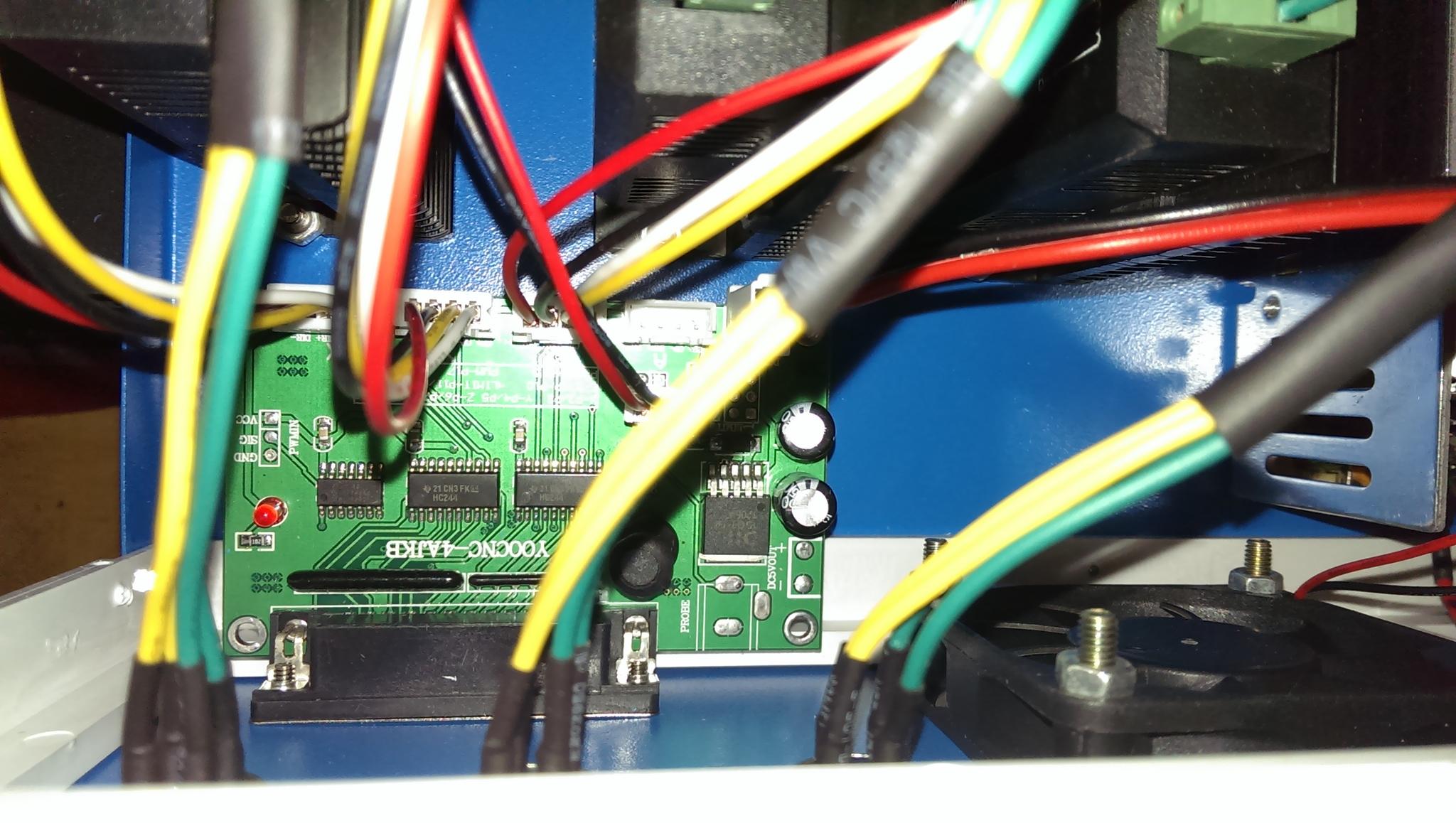

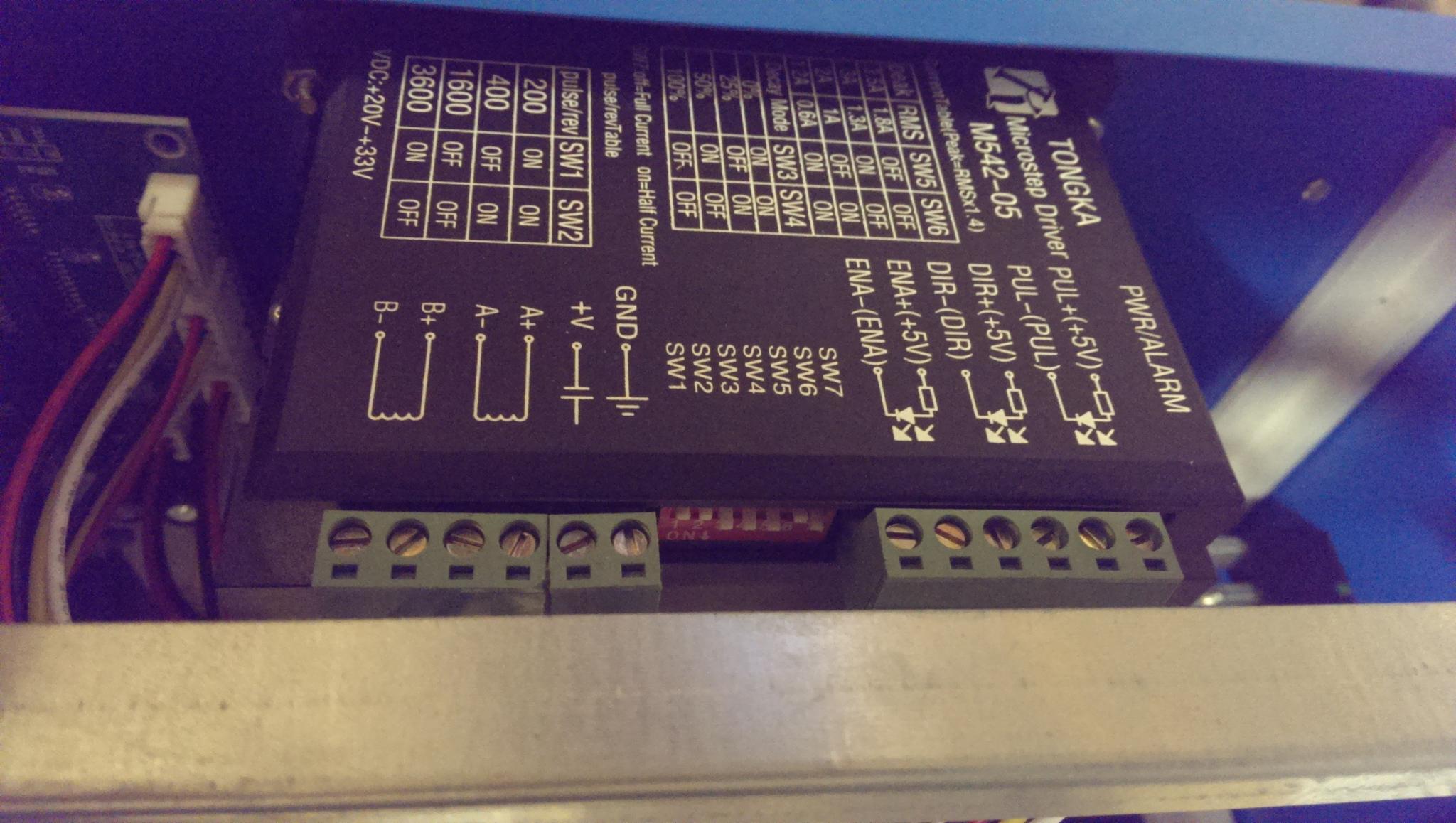

Calm down Mr mannering don't go scraping things just yet.!! . . . Still some other things it could be and if you have separate drives there's half a chance it's just a setting or pulse issue.!
Looking at your motor tuning with 320 steps Per setting and presuming a 5mm pitch screw means the drives must or should be set to 1600 micro steps.
This is relatively high for these machines so It could just be your system can't handle that many pulses and your getting missed steps.?
So first we need to confirm this so can you give us a good quality picture of the drives and there wires and Dip switches if any.
Try and find out ther PSU voltage.
Next what is the Kernal speed set at.? You'll find it in ports & pins.
Show us more before spending any money.
8 Attachment(s)
Lol Cheers Jazz ;-)
Just got frustrated with trying to get it running consistently! I have just gone out and taken the case off and had a look inside.
It looks like the switches are set for 1600microsteps. From the PSU I can see on the label (DC output 24v and current 12.5A) outside case says drive voltage 24v DC drive current 3A.
The kernel speed is set at the lowest setting 25khz? I have attached some pics of the controller.Attachment 11307Attachment 11308Attachment 11309Attachment 11310Attachment 11311Attachment 11312Attachment 11313Attachment 11314

First are you 100% sure there's no mechanical issues.? No binding etc. It won't take much stickage at these speeds with such low powered motors/drives to rob torque.
If not then next try cutting the same part but in air without spindle running. This will eliminate VFD/Spindle interference.
After that then carefully inspect wires at the motor connectors and at the BOB/drives for any lose connections.
The drives are better than some of these machines but still cheap low quality drives. That said they should do this job thou with just 24v you can't expect too much.
Again I'm clutching straws here but you could try setting the micro stepping to 400 on drives and see if it changes anything. Just do the problem Axis first to see if it alters any thing.
You'll need to go into Motor tuning and set the Steps Per to 80 and retune the motors. You'll see can get much higher velocity on that axis now but I wouldn't anyhigher than you have it now.
Failing any of this working and machine being mechanicly sound then scrap it all and get this MX3660 - 3-Axis DSP Based Digital Stepper Drive Max 60 VDC / 6.0A along with 48V PSU.
It will transform the machine and I'm pretty sure it will fit neatly into your existing box with only slight modification. It comes complete with Digital drives, built in BOB and Spindle speed control.
Rated upto 60V 6A and will easily run motors at 50-55Vdc with a unregulated PSU so if you want to upgrade motors to say 3nm at a later date then you can. . . . .Or take it with you to another bigger machine.!!
