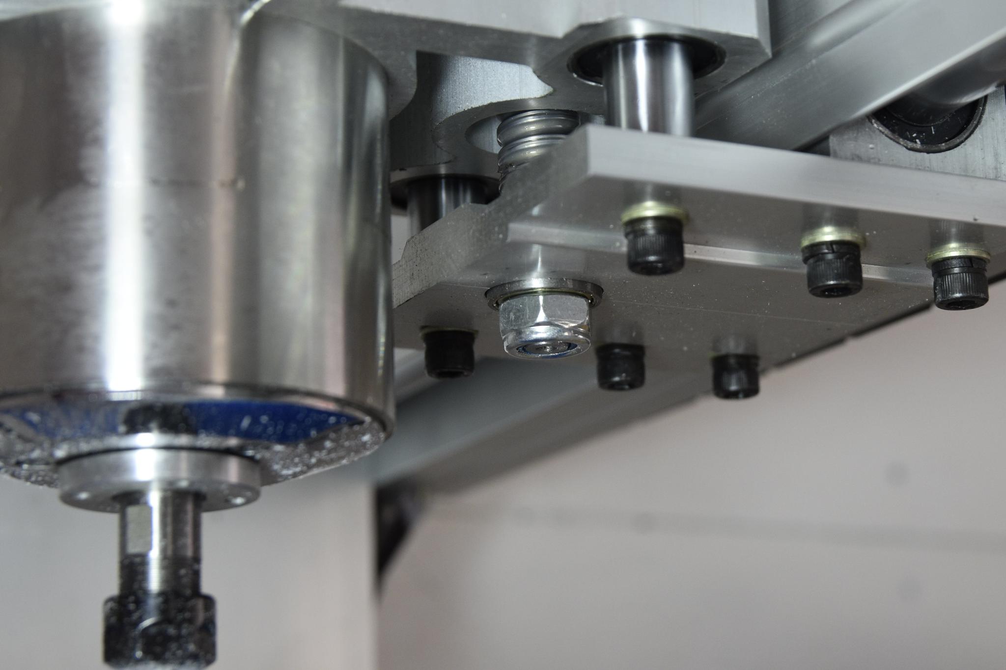

Here is a YouTube video of the issue, and I have attached a photo.
Attachment 18222

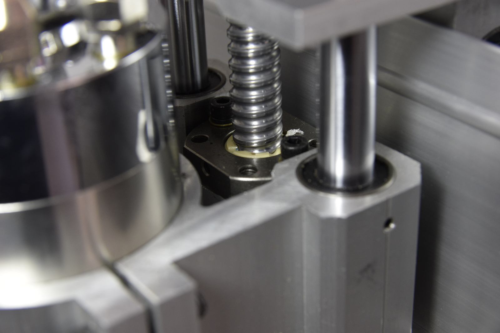

It looks to me that the leadscrew for the Z axis is not clamped at one end (it should be floating in one bearing and fixed in the other)
Here's a a couple of photos to show what I mean.
Attachment 18223Attachment 18224
It looks as though your machine is using the stepper motor to 'fix' the Z screw. However the type of coupling you are using negates this option.
It is bad design to use the thrust bearings in a stepper and you should post some pictures of the leadscrew bearings at each end for us to check this out.
The 'Oldham' coupler you have is not designed to resist being pulled apart, which is what is happening and the whole leadscrew is slipping downwards.

Nick, I think it is the leadscrew bearings that are design deficient.
Rob

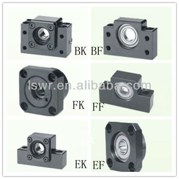

They are talking about this type of coupling https://buildyourcnc.com/images/rigi...01-4%20200.JPG
As we have said - this uses the stepper motor bearings to fix the position - it is not the proper solution - the Z axis leadscrew needs to be in a fixed bearing at one end and a floating bearing at the other end.
A better compromise would be to have a collar on the top end of the leadscrew, but we would need better pictures of the leadscrew mounting arrangement to be able to advise you properly.

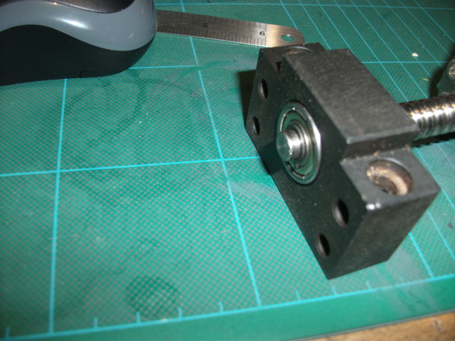

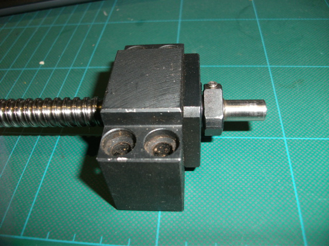

I assume I have the same machine, and this is where the ballscrew is fixed.
Atleast on my machine, no motor-coupling would have anything to do with it.

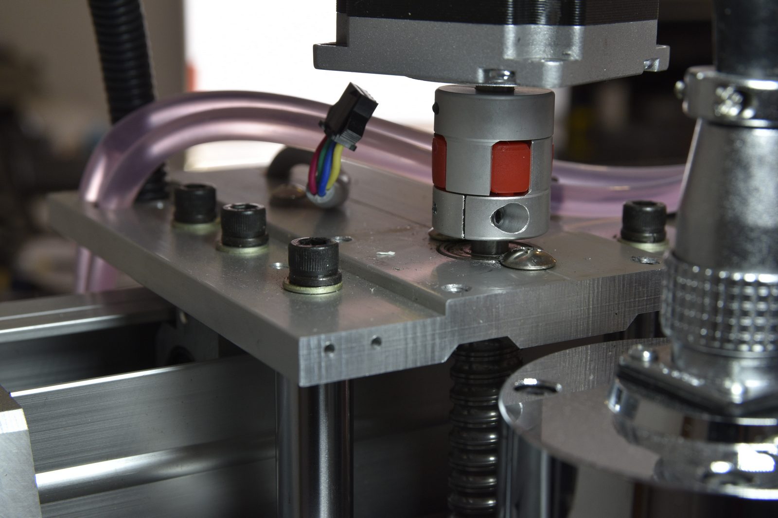

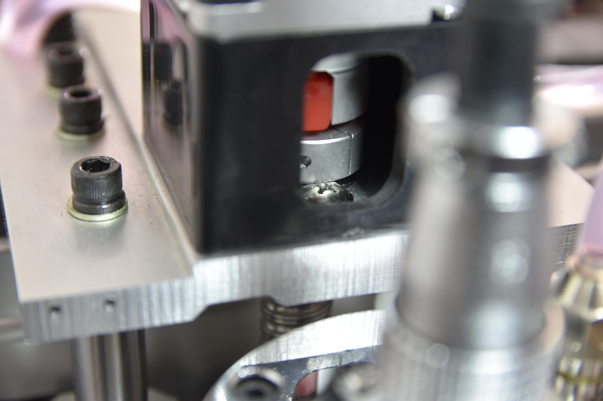

Hello All,
Here are some photos of the bottom of the screw, the mid point, and another of the upper section per your request.
Thanks again for these tips and info.
Attachment 18237 Attachment 18238 Attachment 18239
Re: Engraving small font - the bit digs deeper and deeper as the job goes on. 6040z
Check the bottom bearing is not loose in the plate. It just looks like a push fit and it could have gone sloppy.

In the photo in post #4 there's a gap between the red buffer and the driven section of the coupling, either the ballscrew moved down or the driven section of the coupling moved down.
If the driven section of the coupling can move down then it's not tight enough and would also slip in rotation, and because more torque is required to lift Z than lower it the axis would slowly slip down.
If the coupling driven plate is slipping then stripping, cleaning, then reassembling with a stud & bearing fit compound may provide a temporary fix,
- Nick

The coupling can slip down onto the ballscrew and off of the motor shaft without the screw or the axis actually moving poor grip and gravity with a little help from vibration, also the video of the screw is someone elses problem not stated by this poster as far as I can tell.

And the clearly visibly out of place coupling lower half in his video would suggest?
OK I'll give you this one, either the ball screw has moved down or the driven side of the coupling has moved down -

Today, we are going to pull off the coupling, and wrap a sheet of aluminum onto the spindle, and re-attach the coupling.
This may add enough friction for the coupling to stop slipping.
Right now, we believe it is a coupling issue where it is either damaged or badly designed. We are located in North Idaho and nowhere near a place to take the bad coupling into a store to replace it. So we have to rig it until we can find an online store to order a replacement coupling.

It may be better to run a drill though the coupling and tap it put an m2 or m3 screw in for each side to lock on as an addition to clamp would be better than a shim but as that coupling is two pieces held together by a piece of rubber which is a just a friction fit I still think it may not be your problem and nothing to stop rubber coming away if ends stay in place. Check mill not slipping in collet and put a dial guage on top of acrylic to make sure not lifting seen acrylic do this many times, if using a bit with a helix try a straight router bit, also if it misses steps on upstroke it will get deeper. Anything movinng 3.75mm is going to be obvious so material or bit moving or missing steps sound much more likely to me.

Good point I seriously doubt this slipping coupling is the problem its two pieces held together by the friction of the rubber alone so if ends stay firm nothing to stop rubber moving.
In fact that's the only thing that makes sense if everything else is secure the rubbing coupling is causing enough friction for the stepper to miss steps so that the Z axis is losing its integrity.
What you talkin' 'bout Willis?
Some thing is pulling that coupling apart. If it were just loose on the stepper shaft there is no force to pull it downwards. I would recommend running the program but just cutting air and looking at the Z axis to see what exactly is moving.
If that red bit in the middle is the least bit squidgy you and drive it in either direction and it will push the two metal sections apart ;-)
We checked the nut at the bottom, and it was fine.
So, we took both the couplings off and examined them further.
The first thing we noticed was that the couplings appeared to be mounted slightly too low. So, when we put the motor housing back on, it may have been pushing the couplings down on the cylinder.
Here is what we did to patch/remedy the issue:
1: Used a dremel tool with a cutoff wheel to lightly score the cylinder (to create some friction for the couplings to adhere to)
2: Moved both coupling halves up slightly on the cylinder.
3: Reassembled and ran a job.
So far, the results are positive. There is no slippage of the couplings.
NOTE: We did originally try to wrap a tiny sheet of aluminum around the cylinder to use as friction, but the tolerances of the couplings to the cylinder was too tight. It would not fit. So, we came up with an alternative idea in scoring the cylinder to create friction.
Anyway... Thanks for the tips. The tip on the aluminum sheet is what mainly led us to success. (that idea eventually led us to consider creating friction using a different method)
Let's hope this stop-gap method works over time.
Originally you said the cutter bit was being dragged down into the job I don't think fixing the coupling will have anything to do with the first fault as the two halves of the coupling are not fixed together. So either the bit was loose and came out of the collet or the fixed bearing is faulty. Only time will tell.
If the bottom coupling was slipping on the shaft most slip would have been when working against the greater force required to lift the Z axis rather than when lowering, resulting in Z gradually slipping down,
