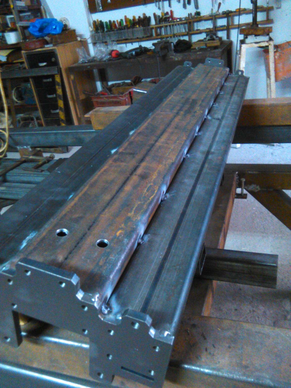

Today i go on with the gantry

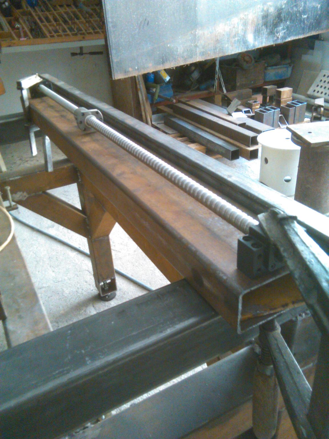

I start by drilling the holes for the bf/bk on y axis. to do this i remove the 120X60X3mm middle tube of the gantry. I put the ballscrew on place and point the holes
Attachment 13094Attachment 13097

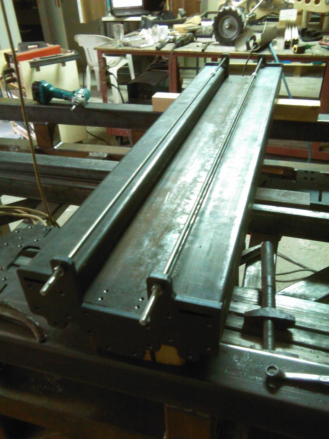

Then i put the tube back to the gantry and start aligning the tubes with the steel plates. After that i start spot welding the pieces. With small weld in order not to produce muh heat
Attachment 13096Attachment 13095Attachment 13099

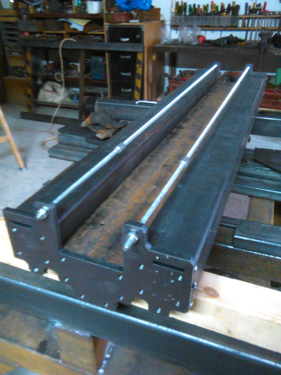

At this photo you can see the 1120mm long m8 bolts that i use to keep in place the side 10mm steel plates
Attachment 13098Attachment 13100

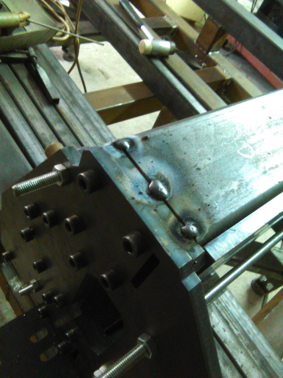

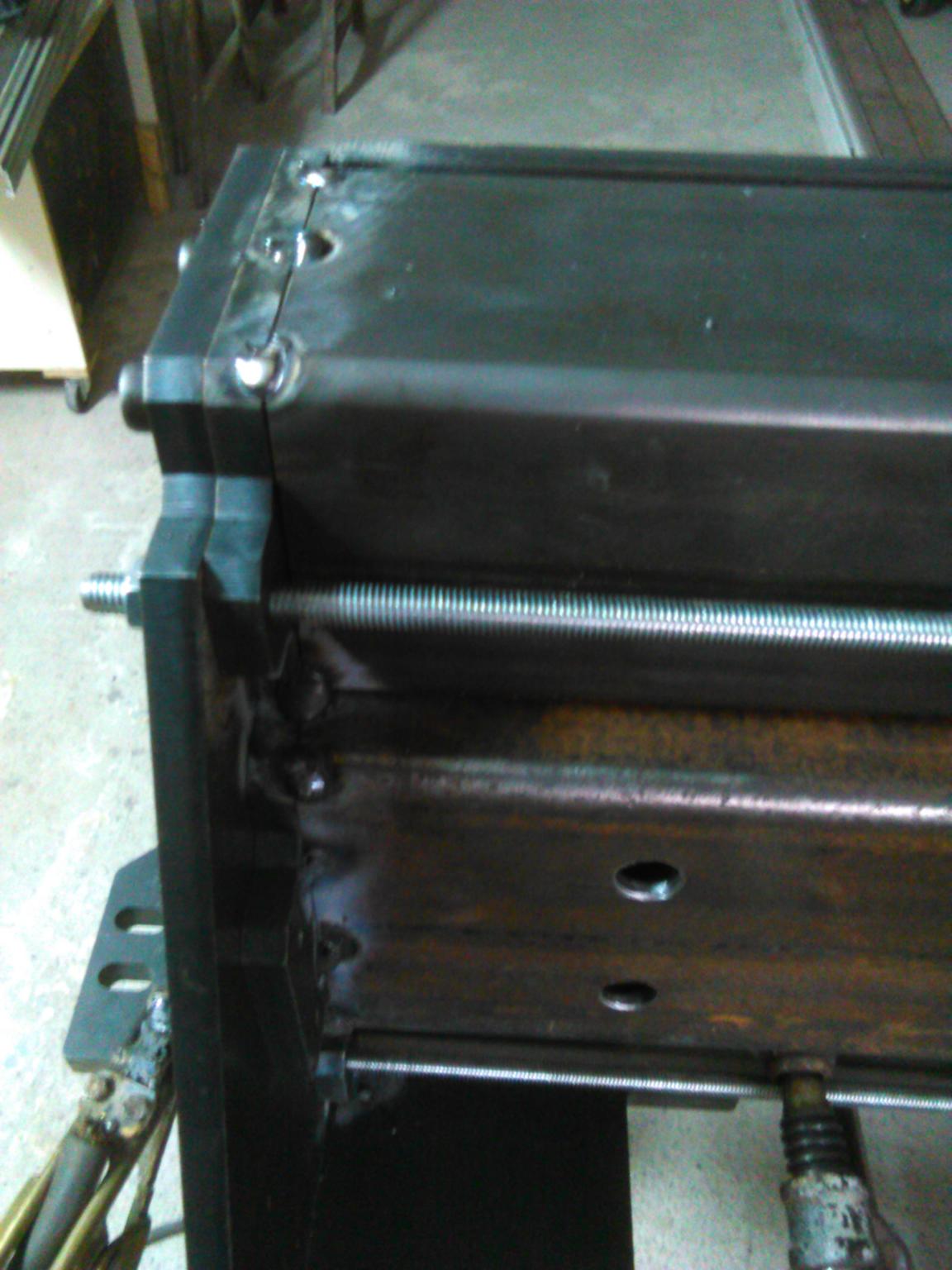

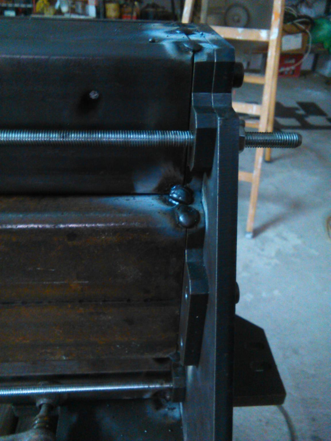

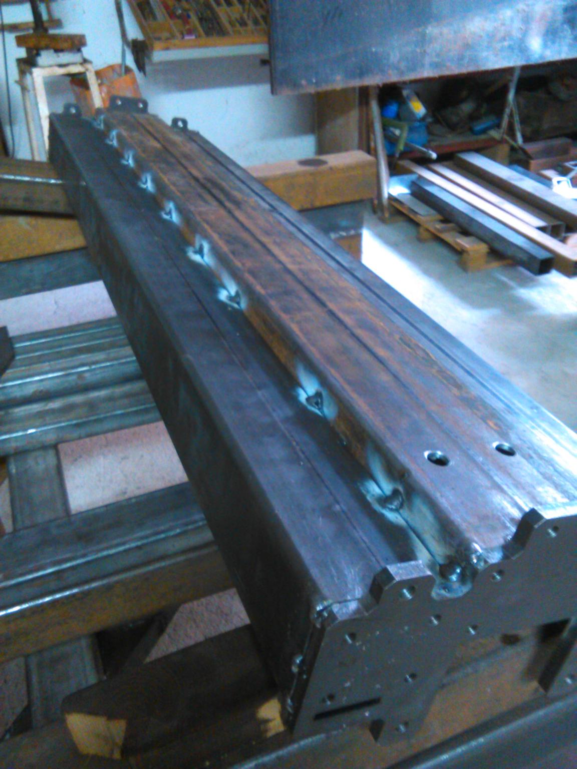

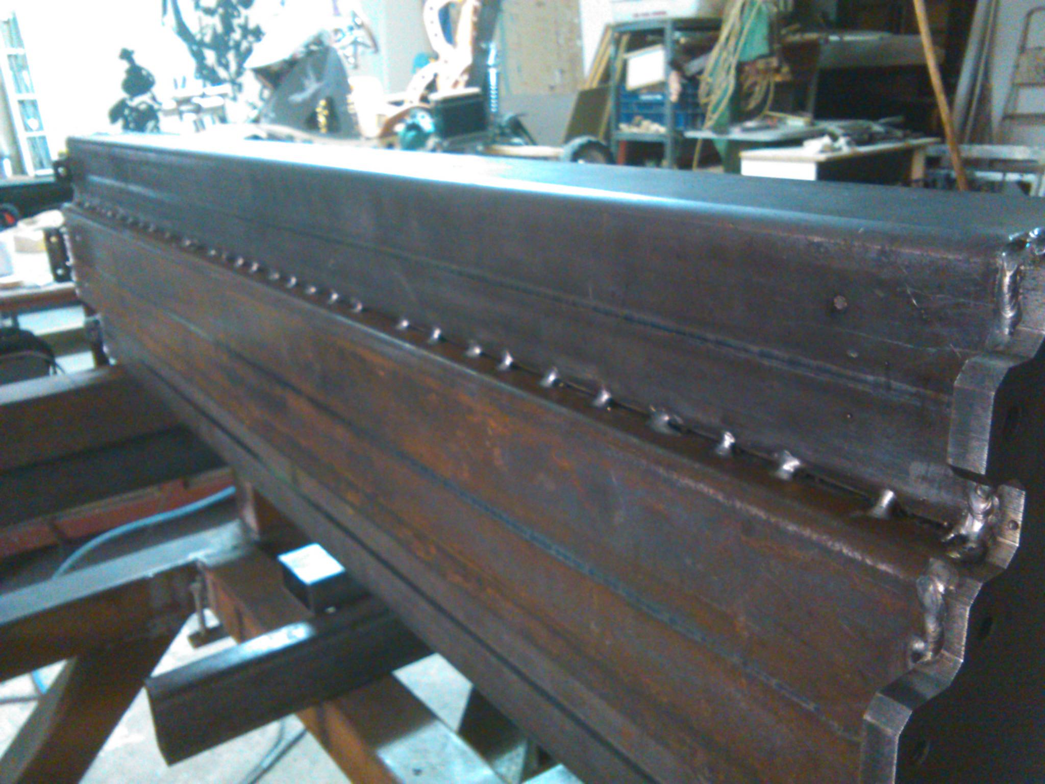

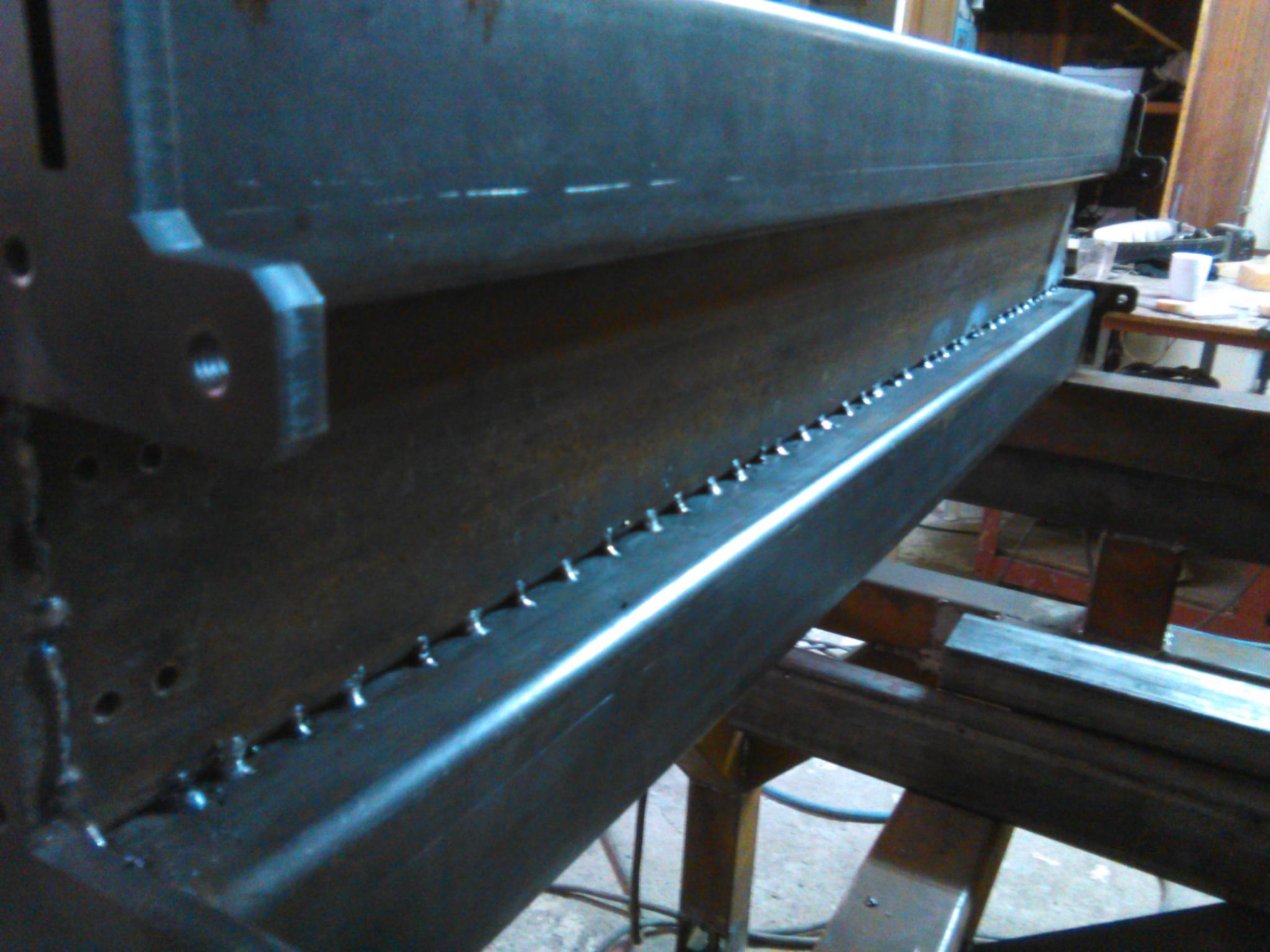

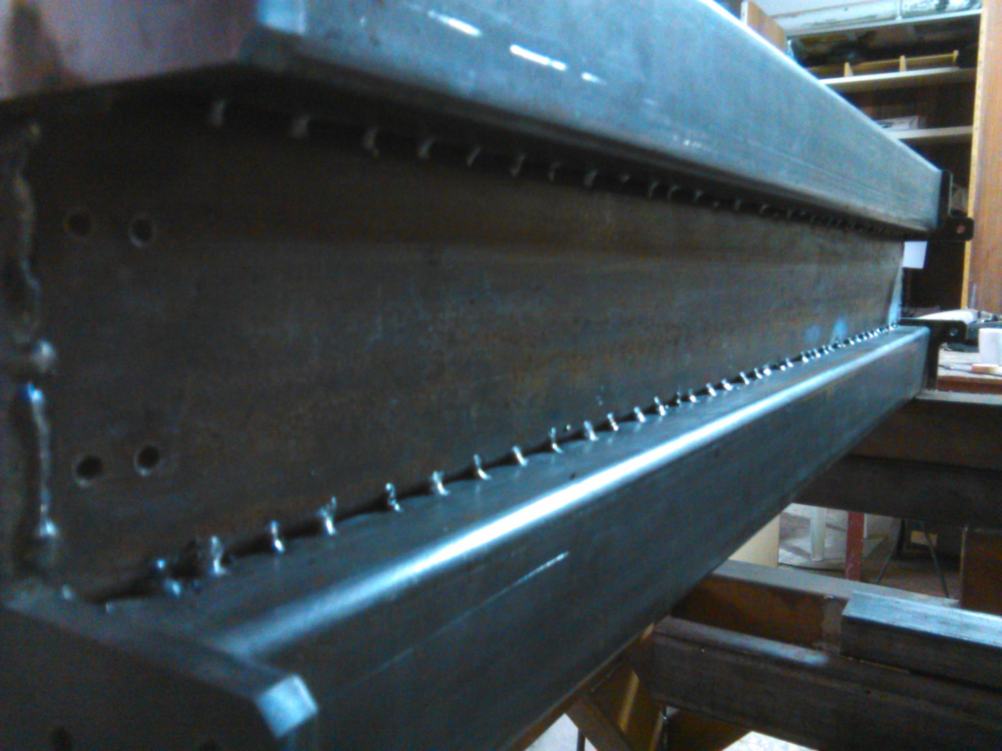

After the side spot welding i had to weld the tubes at their side that atteced each other
First pass i start with spot welding every 10-12 cm. Second pass i weld between the old spot welds ( every 6cm) and so on.... In order to have better result i turn the gantry a bit
Attachment 13102Attachment 13101
Finally i end with this result
Attachment 13103
Attachment 13104Attachment 13105

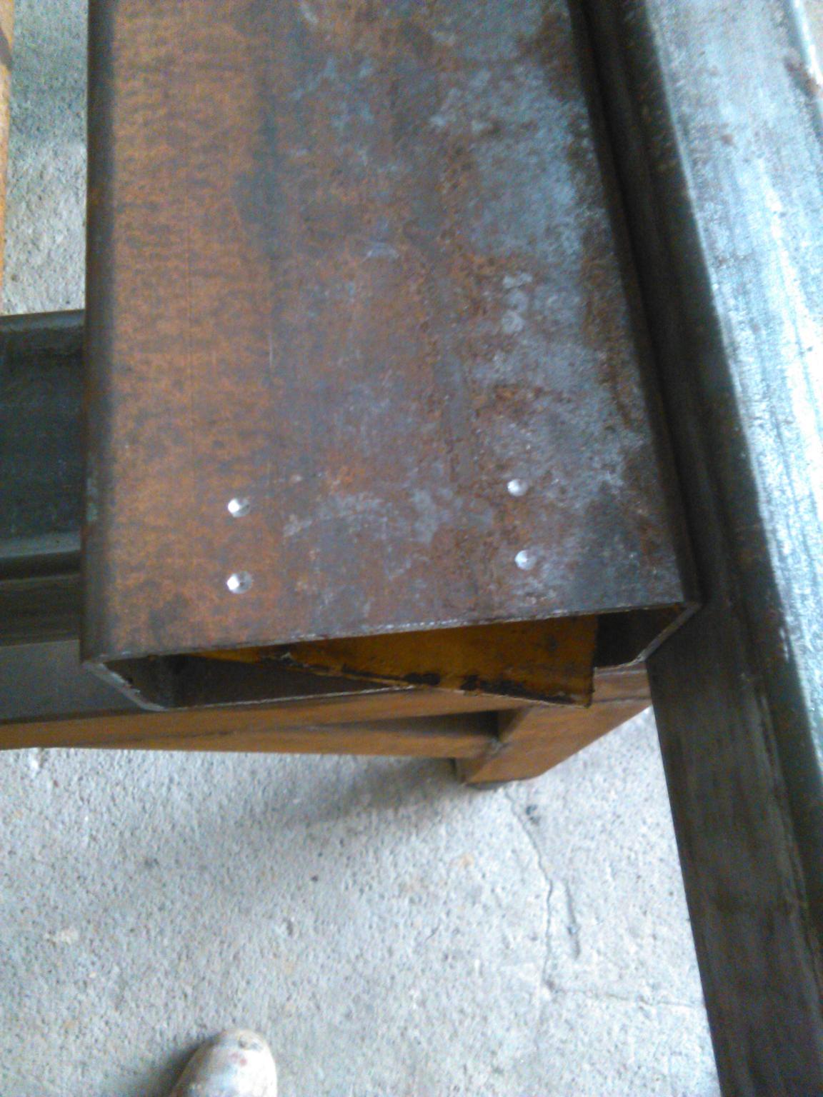

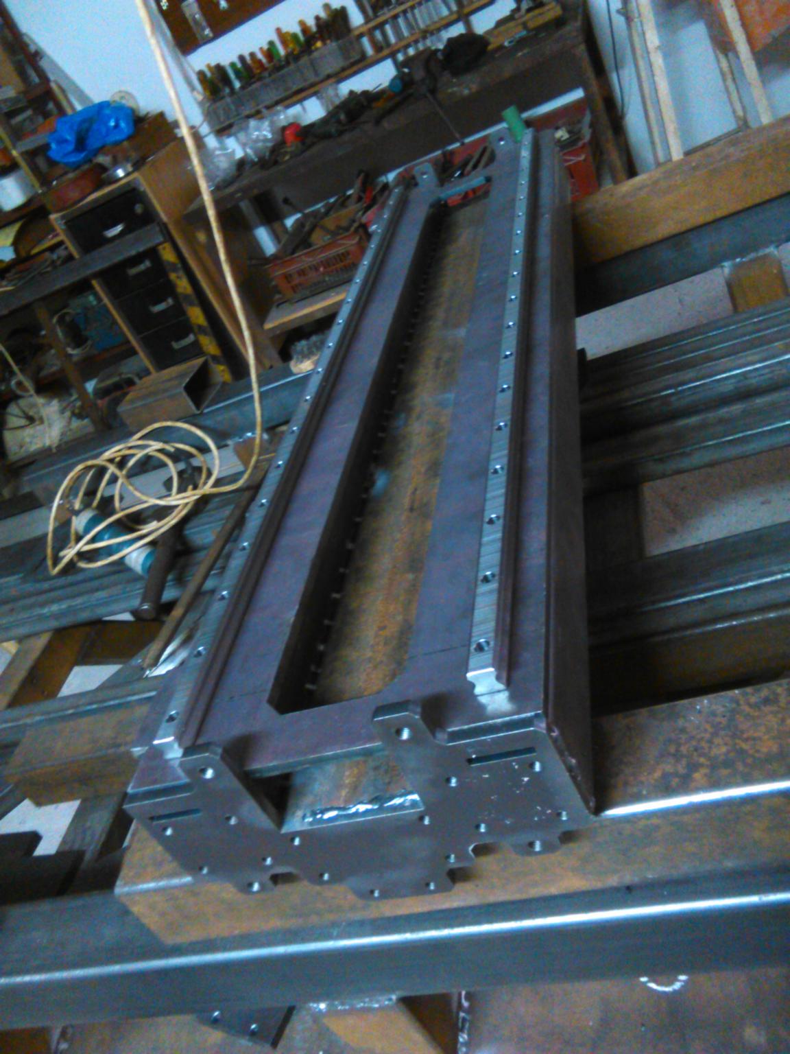

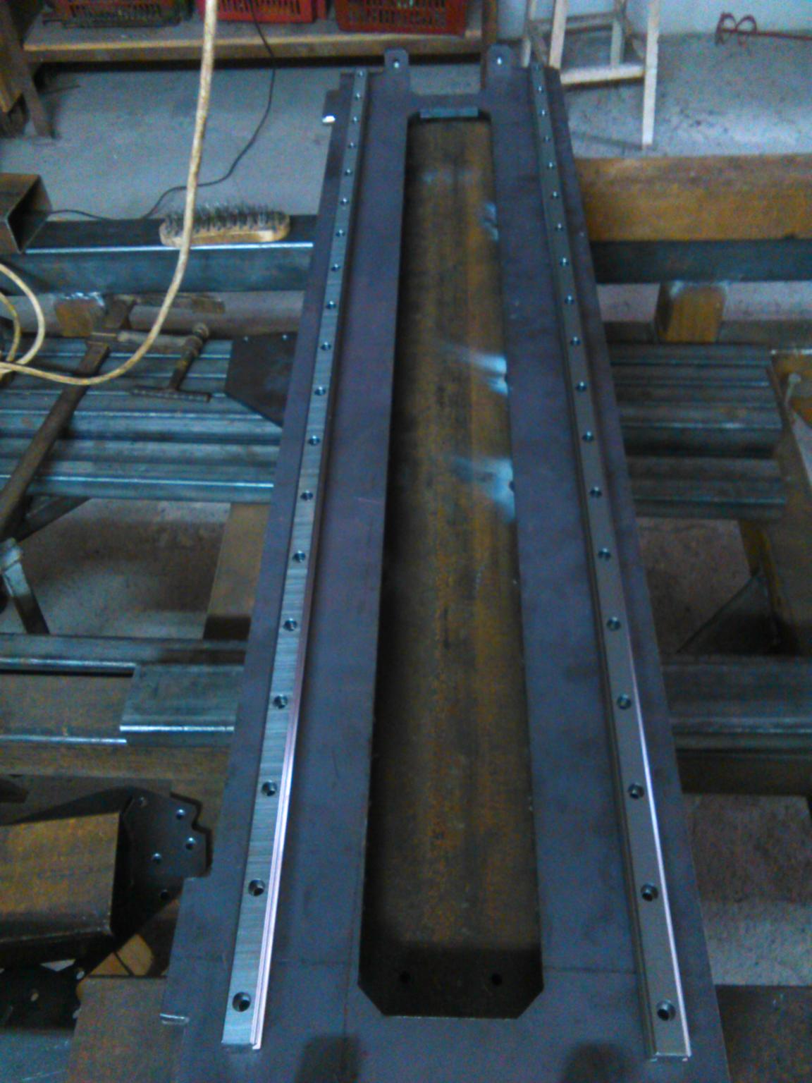

Then i put the front steel plate on the tubes construction and temporarily i put the rails on, in oredr to see where to drill the holes in order to bolt the plate to the tubes
Attachment 13106Attachment 13107Attachment 13108
The only question i have is about the way i weld the tubes. Are these spot welds ( every 3-4 cm) enough or i should make a full weld
Thanks for your time
Any suggestion will be glad to hear
Vagelis

That with the long screws holding the plate is great idea, thanks for sharing the photos. I will do the same, as i don't have long clamps.
All looks very good!
I fully welded the gantry on the machine i finished and spot welded the Z. Now that you have all in place why don't you repeat the spot welding until all spot welds are very close?
If it was me, i will fully weld it, though it seems that will work both ways. Welding precisely takes a lot of time , i know. I made 5cm stitches, and took care that the temperature of the gantry not to rise above 60 degrees. Used an infrared thermometer. And had to wait a lot for the metal to cool.
You were lucky if your long plate was straight. I had to hammer down to rectify some of the laser cut stuff. Good that i have very big plastic head hammers.
Syliavski i think ( not sure, that is why i ask ) that i have nothing to add to the stiffness of the machine. One small spot weld is too strong . On the other hand too much heat may cause deflection and twist . Dont forget that my machine is bigger than yours ( y axis is 1160mm long) so it is more possible to have twist issues.
I think it is not but when i bolt it on the tube construction it will be as straight as the tubes. Even then i am not sure everything will be straight. May be machining or epoxy method will be applyied.

Apart from stiffness there is dampening of vibrations to consider. Not fully welding may worsen things there. I have never seen commercial mill or cnc spot welded, that should be enough answer for you.
