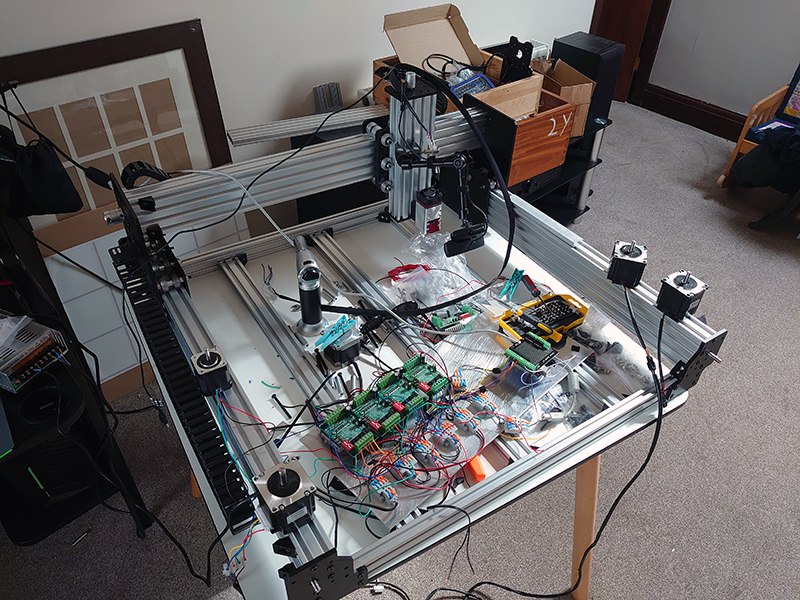

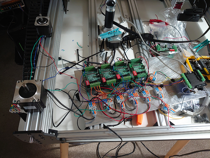

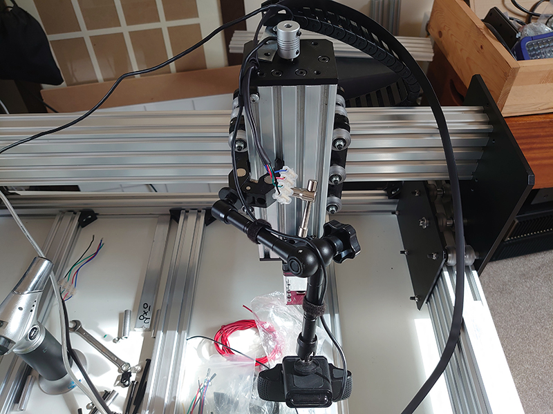

Starting a diary of my Openbuilds laser build - good - bad - ugly
This started 5 years ago !! I'm determined to finish it this year.. no matter what lol
@JAZZCNC look away, the next picks may offend you lol :)
As I achieve some minor victory during this war of attrition, I'll post details of - what it is, specs etc and my thoughts on it.
Attachment 30145
Attachment 30146
Attachment 30147
its footprint is 750mm x 750mm
working area 600mm x 590mm
Build cost .. not sure about £1000 by the time I've finished
It will be capable of Laser and wood milling/routing
Like I said I'll break it down in to achievements by post and add the details.. but so far not any major problems.

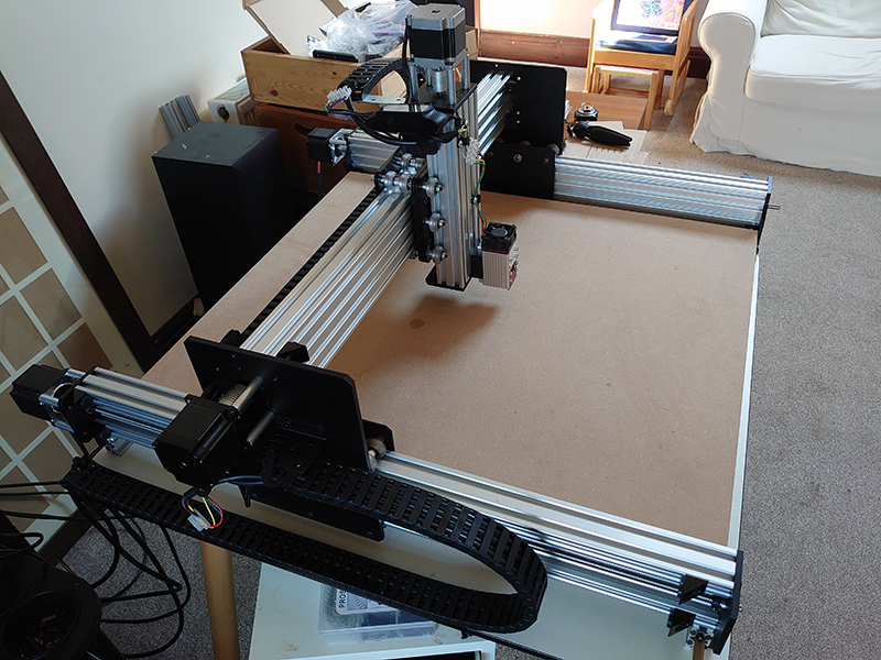

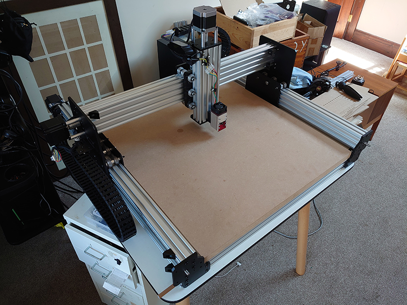

Ok.. thanks to m_c the power problem is solved. Thanks to Doddy for the help as well.
here's my first power/speed scaling test. Seems good so far. Need to do a lot more tests before I have accurate rates , but that's the fun part :)

Looking good. Just a passing, friendly thought - if you've not got/planned it already - it's generally recommended for a little air-assist, particularly with composite materials, so when you ablate the binder/glue it doesn't deposit a sooty film on the lens of the laser. Nothing urgent, but think of it as a potential near-term upgrade.
Re: Starting a diary of my Openbuilds laser build - good - bad - ugly
Doddy
Its on the list mate :) I'll be encasing the cnc and making a nice heavy stand for it. I have my eye on a compressor from a you-tube video. Some triple 12v fans off Aliexpress and a home made air filter.
Fireproofing/cooling for the electrics.
Some heat and smoke sensors
the list goes on lol.
