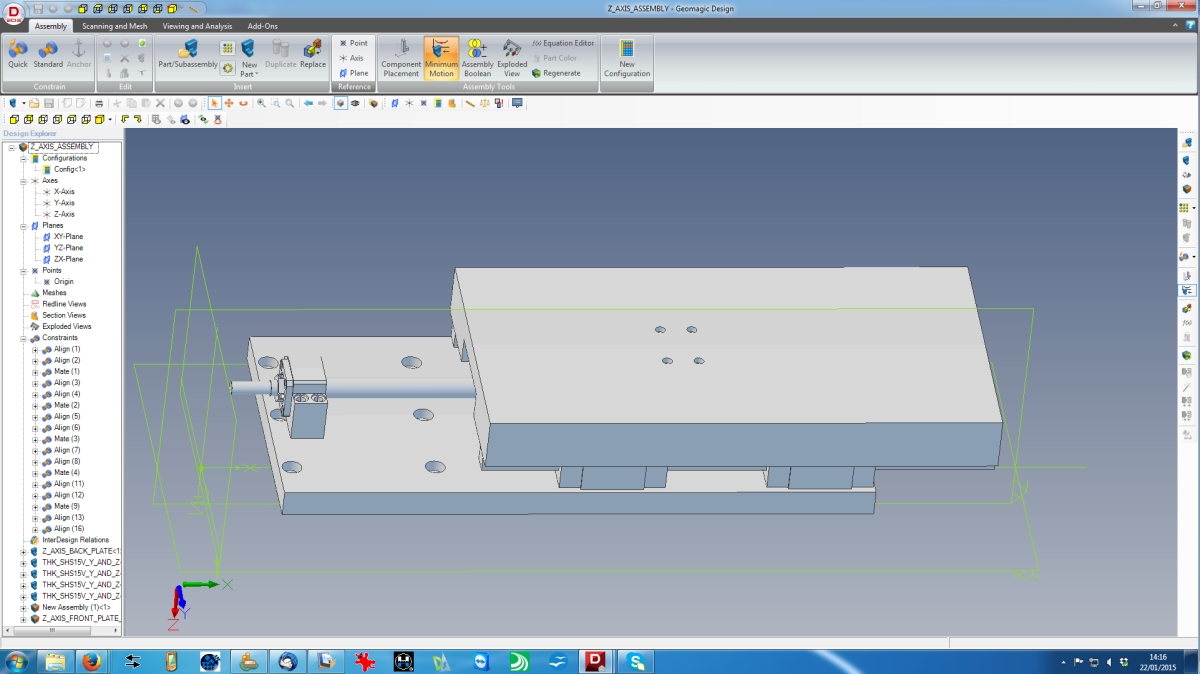

Been working on the Z axis today, not done it all by any means as work keeps flipping geting in the way...
Attachment 14480
Attachment 14481
Not drawn the plates that the Y axis Carriages attach to yet (simple so won't take long) ot the Z axis Stepper plate which is going to have a pocket for the stepper milled into it with slots so the belt can be tensioned. The Z carriages and rails are just blocks drawn to the correct dimensions but with no detail, couldn't be bothered and couldn't see the parts in the online library to download but not looked too hard!

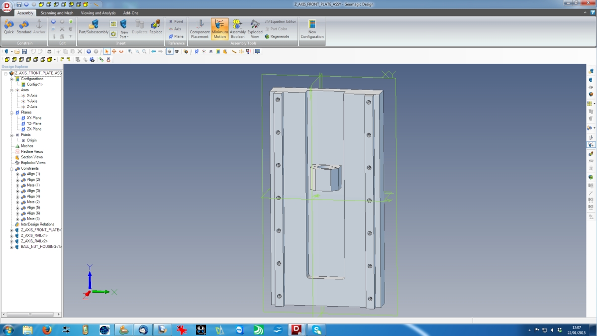

Put some material back on that front plate it will help with resonance. You only need to remove what you need to remove for the screw to clear.
Re: Comments sought on new build: A CNC Router for RC Gliders and Planes
JAZZCNC
Cheers Dean, I'll alter that tomorrow.

Front plate re-drawn with smaller pocket in it...

Dean, you did realise that the front plate is a 40mm thick plate? The pocket is 20.6mm deep so 19.4mm still remains in the middle.
Anyhow....managed to get another few minutes on the CAD....put together the assembly and surprisingly it all fits together!
Attachment 14485

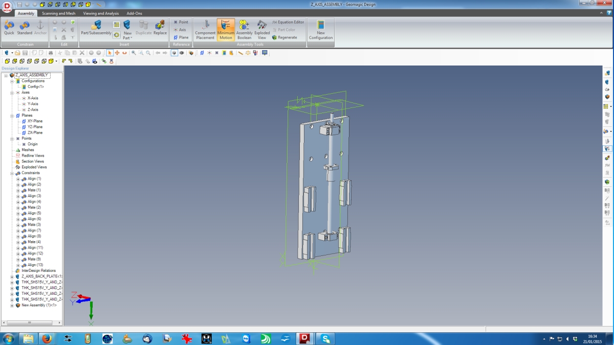

One last pic before home time.....the Z axis on the gantry....
Attachment 14486
