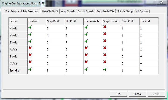

Hi all I have set up my CNC 6040 machine now and have an issue with the motors jamming whilst manually moving them (jams and makes a high pitched noise)
To my understanding this could be my setup of the motors but when I initially got my machine moving yesterday I moved all the motors fine with no issue so not 100% sure.
At the moment I am just copying what others are telling me to put in mach3 settings but I would like to know what I am inputting and why so that I can better understand my machine.
Is there anywhere particular I can look up for research material or download a book etc. and or is there sites to avoid as known for giving incorrect information?
If you are interested my settings on the motors are on the attachment, I am not sure what else you require other than I am using 220v and all three motors have jammed.

Halve your speeds and try it again, if that works creep them up until you get the occasional issue then back off 15% or so
Re: Where is the fountain of knowledge for learning about CNC setups / understanding
I'm guessing from the Mach3 settings that you have 5mm lead ballscrews with 8x microstepping in the stepper drivers. That explains the "320 steps per unit" in the motor tuning page. That's about right, but you also need to check the drivers themselves to make sure that they are also set to 8x microstepping to match. If they are set wrongly, you might be trying to move the machine much faster than you expect. The drivers normally have a little table on them showing DIP switch settings.
As long as that's correct, Nick's advice in the previous post is spot on - you can do as much analysis and design as you like, but at the end of the day we all just gradually crank up first speed and then acceleration until the machine starts misbehaving, then back off a bit for safety.

The high pitched noise is the motor stalling.
Stepper motors rely on their windings being energised in order. If you overload the motor mechanically, rather than the motor spinning smoothly, it will stall, and vibrate as it jumps between the activated windings, which is the noise you hear. If you were to feel the motor, you would also feel the vibration. The motor will only start spinning again, once the winding switching speed slows to a point where the rotor can be accelerated fast enough to re-synchronise with the switching.
As others have said, reduce the settings, and try again. There are that many variables involved, that it's hard to accurately calculate readings, so trial and error is the easiest option.
Looking at your figures, I'd reduce max speed to 2m/s, as you may be pushing the limit of what the stepper drivers are reliably capable of.
But I'm confused in your screenshot, because the acceleration figure doesn't match the graph. 300ms2 is very slow for acceleration, yet the graph shows a setting nearer 16'000, which would likely stall even the best of CNC stepper systems.

To setup the Motor tuning correctly in mach3 you'll need to know several things.
#1 Ballscrew pitch: To determine this measure how far each axis moves for one revolution of the ball screw. Do this for each axis because very common for Z axis to be different to X & Y.
#2 What micro steps are set on the drives. Most drives have DIP switches that are set in a order depending on what MS you desire. Often the MS setting range is printed on the drives or board. The available choices will be something like 1x 2x 4x 8x or 200,400,800,1600.
If unsure post pictures of your actually board/drives not some one else whcih are the same.
#3 Power supply Voltage and Motor size/Step angle. Two of these are technicly not required but they do give a good indicator for setting Velocity/Acceleration.
To explain the Micro steps ie: 1x 2x 4x 8x: This relates to the Step angle of the motors. So if motors are 1.8deg then this equals 200Steps per Revolution. (360Deg/1.8=200). So 1x 200= 200Ms per rev, 2 x 200=400Ms etc etc.
Now if 200,400,800,1600 etc this says exactly how many Microsteps per rev so easy to workout.
So to calculate the steps Per setting in Mach3 take the MS setting and divide by the ballscrew pitch. IE 800MS / 5mm=160 step per
Now Velocity and acceleration are some what trial and error and dependant on many factors. Motor size, voltage, Friction etc and no two machine will be exactly the same, even if built exactly the same. This is why people just tweak the settings.
However Voltage plays big part in speed/torque that can get from stepper motor so if you only have low voltage PSU Ie: 24V then you'll need to tune Velocity/acceleration much lower than someone with say 48V supply.
This is why knowing the voltage drives use is good indicator regards tuning. 24-36v will struggle much above 2500mm/min so start low and work up.
Also note you cannot have high Velocity and High acceleration, it's one or the other.
So start with both low say 1000 @ 300 then Change one at time and run machine before changing next. Suggest Start with Velocity try it and if motors don't stall then increase acceleration.
Do this several times until find point where changing either one will stall motors. Then back both off 20-25% to give safety margin.
The reason your E-stop isn't working is probably because you have accidentally changed the Input Pin # or Active state.
If your sure E-stop button is working then go to Inputs settings find E-stop setting. First check there is Pin number assigned, if not then thats your problem.
If yes then next toggle the Active Lo setting. Ie If ticked then un-tick vise versa. If mach resets then push the E-stop to make sure it working.

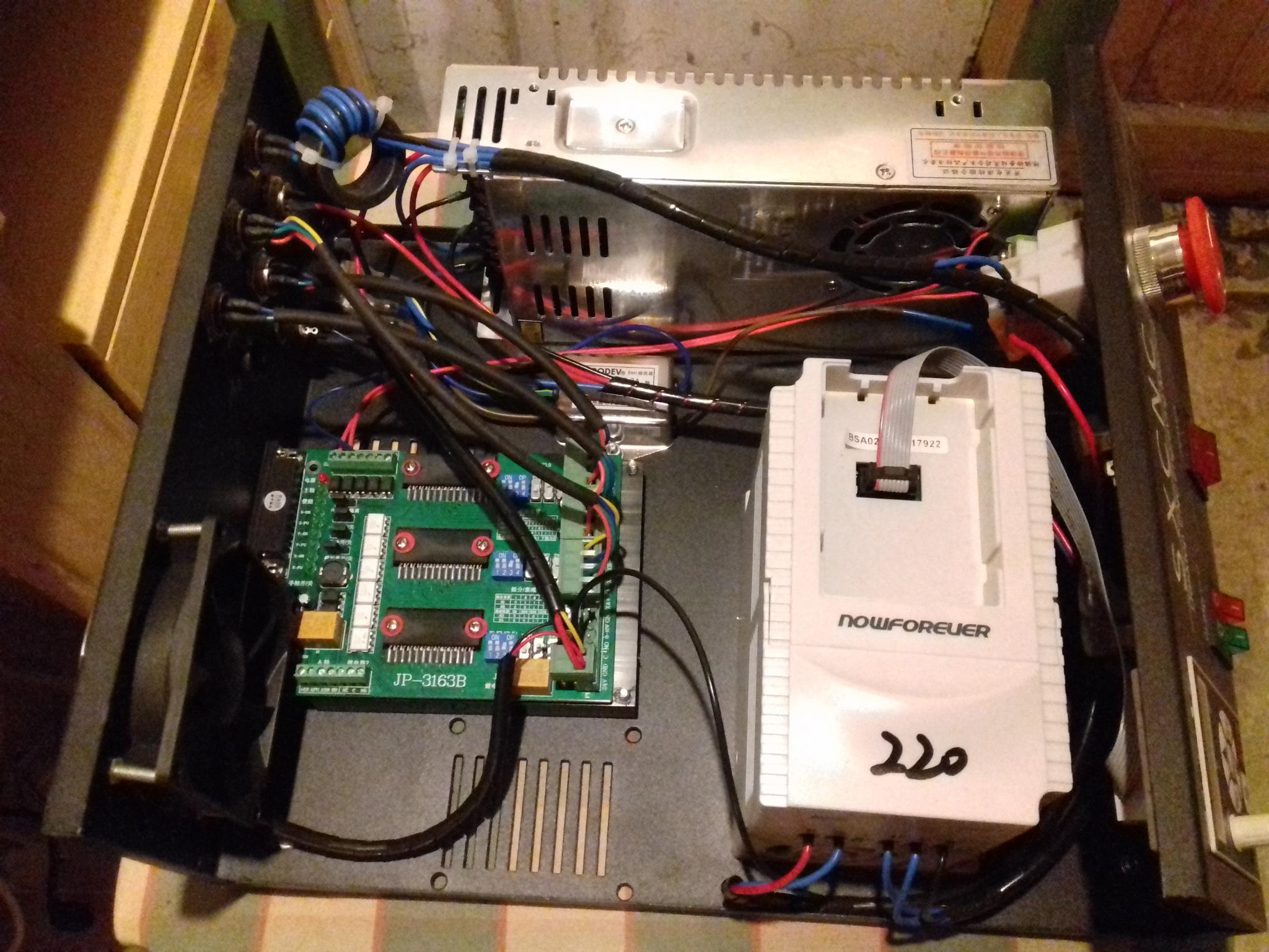

ok so I think I did the ballscrew pitch check? I couldn't find a how to do video on it so went along like this, placed ruler 0'd with the drill bit, marked the bolts holding the ballscrew's, 0'd the axis and then inputted a move instruction and stopped the movement when a full rotation of the bolt came round... probably way off what you had in mind.
anyway with this I got the following results:
Y axis moved 5mm with 4.9535 on mach3
x axis moved 5mm with 5.0031
z axis moved 5mm with 3.6062

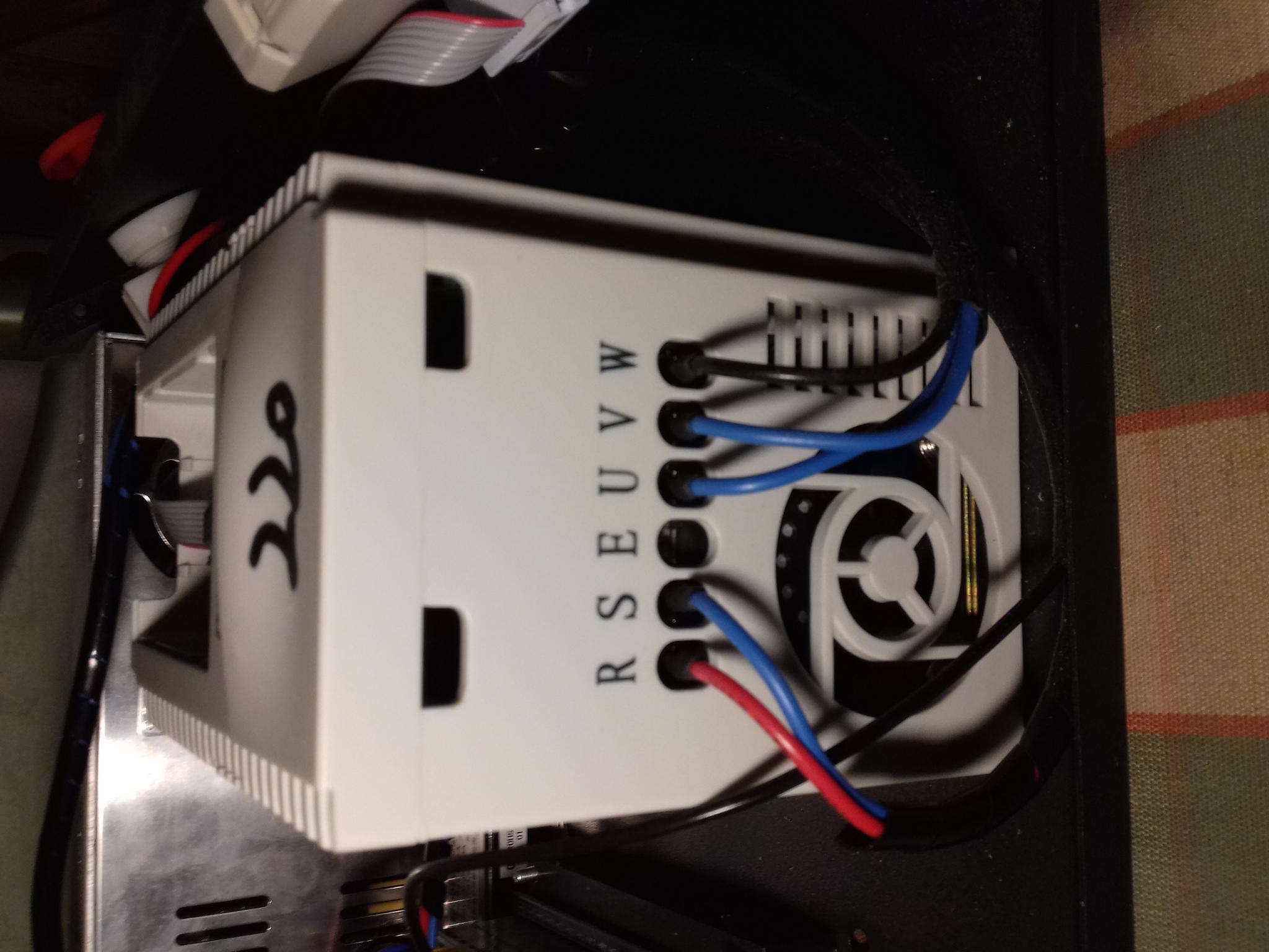

I took photos of the inside of my control box and you were right its different to the previous photos.
I found the DIP Switches were set on 3 (K3), the X Y and Z axis were also set on SW1.
there is a chart but as its in Chinese I weren't 100% sure what it meant as K3 had a 1 marked in 2 (25%) and 16 (100%)
the motors are 1.8deg
the power is apparently 220 (written on)
please see photos

Ok, so you have 5mm ball screws.
Now the Sw1 SW2 SW3 set the current range for the drives which must match or be just less than the motors rating. This setting can be set above the motors rating but recommended to keep on or just below.
In your case looks set at 1.8a for all motors even thou the motors are rated 3A. This is a common practice of manufactures when they use these cheap boards. They do it to protect the drives so not working at maximum and overheating.
What this means to you is that you are not getting the full power of the motors. However, it's double edge sword because if you turn them up you'll most likely fry the board unless put some cooling on it.
SW4 it doesn't mention but I suspect it will be to turn motor current reduction on/off. Currently set to ON. What this does is reduce the current to motors when at idle.
The amount of reduction is probably set by K3 K4. Currently set to 50% which is a standard current reduction on drives.
K1 K2 set the Micro stepping which looks to set at 8. Which means 8 x 200=1600 Micro steps.

urgh this machine is doing my head in... really tempted to just scrap it all, been trying to find out what the Chinese charts actually mean on the board so I don't damage the board by doing something wrong.
I initially was looking around at breakout boards and their reviews and discovered my breakout board has on board axis drivers as well so if I ever decide to replace it I have to buy stepper drivers as well.
So was looking at the MX3660 which seems perfect (all in one, little hassle) just trying to find a seller and then thought I'm getting distracted again.
I have on the board ("ON DP" K1, K2, K3, K4) accompanied with SW1, SW2 AND SW3 per X Y and Z drivers
K3 and SW1 are the switches set for all three drivers
I found a chart that may assist but still I know too little on this side as all I wanted was to make stuff with the machine.
http://img.yunqudao.com/UploadFolder...ault/3_649.jpg
is changing K3 to K1 what you mean Doddy to set the micro stepping?
Also I'm going to do a test by taking the motors off of the frame and see if they still make the jarring noise when not attached to the rails, if they still do whilst disconnected then that should eliminate any frame/rail/ball-screw issues I presume and my guess would be either power or a faulty connections somewhere right?
if the motors run smoothly and no jarring when loose then I pretty much scrap the frame? (take hammer to it)
Also (sorry for all the questions) but how can I tell what PSU I have as the only sticker on it was all in Chinese?
