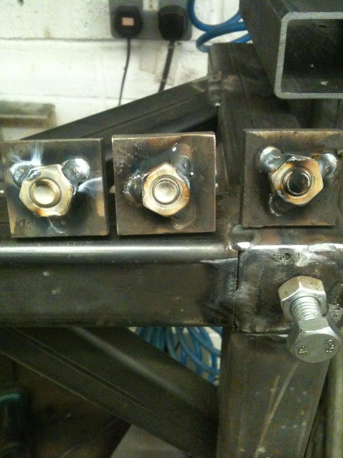

Well got out in the works for 1/2 hour just now...miracles do happen!!
Managed to drill some holes on some 40 x 40mm flat and weld on some M12 nuts to the back. These are for adjusting the frame flat whilst the epoxy is setting, they won't be used for feet as it's going to be vertically mounted......eventually.
Managed to weld in one of the feet and tidy up a bit with the angle grinder. Also put the top part of the gantry on and stitch welded it to the bottom half making the L shape. Camera died before I could get a picture of it though...
Attachment 11769

All feet are prepped up and the second one is tacked in to the frame. I'm in the workshop for 3 hours tomorrow morning so hope to get lots done as there will be no: setting up...do 10 mins welding...then put it all away again...I hope!

Ground all the welds flat that needed it. Tacked on a piece of 50x50 angle as the bridge between the rails.
http://img.tapatalk.com/d/14/03/08/degebasa.jpg
Realised I'd left the stop plate unwelded on the top so put a run if weld down and ground it back. Now the epoxy won't leak there.
http://img.tapatalk.com/d/14/03/08/nytabupa.jpg
Frame being forklifted round to the test bay, no point carrying it when there's the equipment to do it for you!
http://img.tapatalk.com/d/14/03/08/a7y2y4uj.jpg
Frame tucked away and feet adjusted so it sits level.
http://img.tapatalk.com/d/14/03/08/uzymasa3.jpg
Sat out the way in a corner...
http://img.tapatalk.com/d/14/03/08/mygyvysu.jpg
What's missing from here? Yep my digital scales so no epoxy mixed and poured today :(
http://img.tapatalk.com/d/14/03/08/ryjamyza.jpg
All moats in place. Used masking tape to seal the gaps.
http://img.tapatalk.com/d/14/03/08/zytuga2u.jpg
Put the gantry on the frame and shimmed it level and 90 degrees to the x axis mounts.
All ready for the pour which will be first thing Monday morning before work. Not a bad 3 hours work this morning really.

Great job !, and a good wide epoxyduct between the rails, wasteful but necessary to get good flow and hence level all round. Pity about the scales, or lack of should I say.
Did the draught excluder go on okay ? give it a good pressing down all round just prior to pouring.
