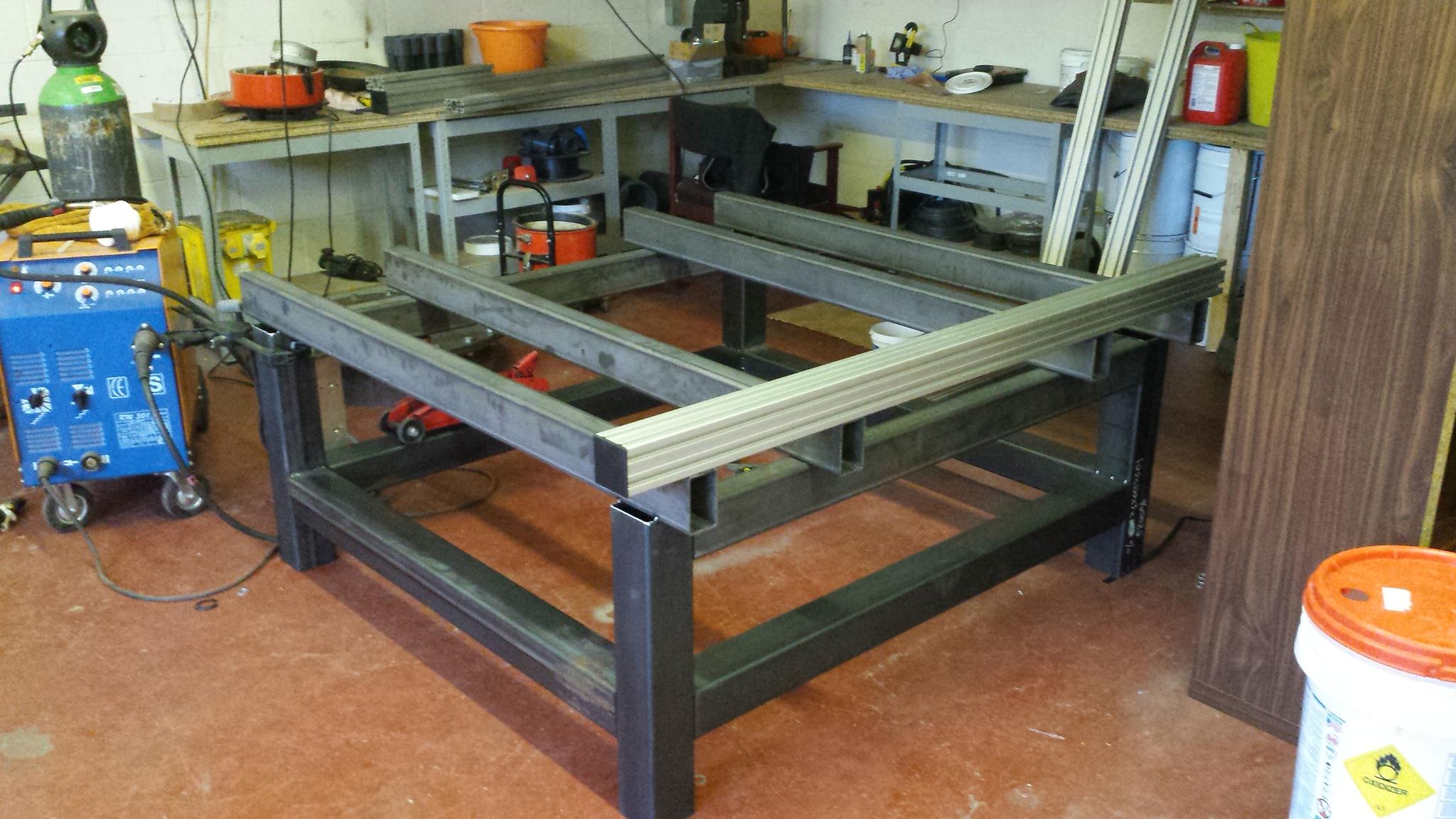

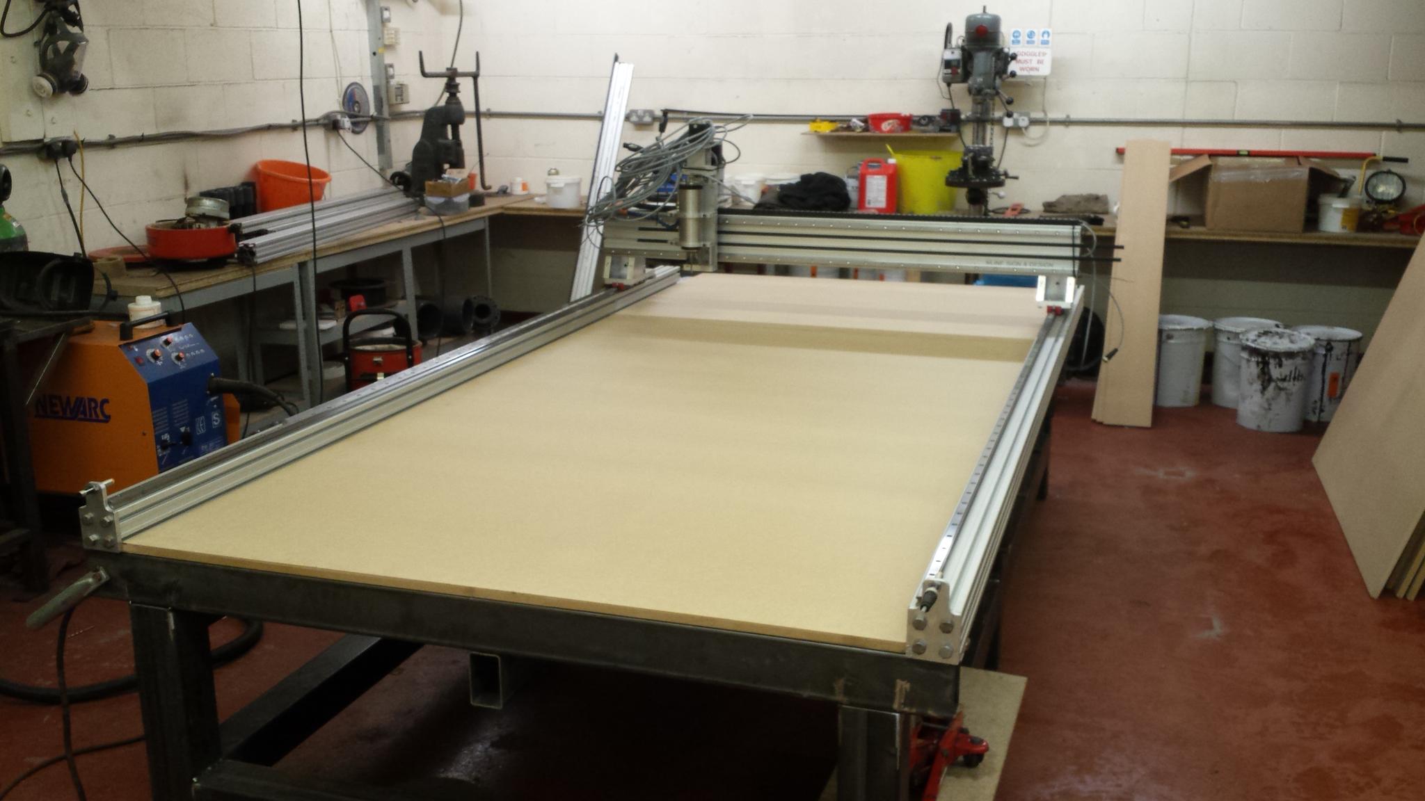

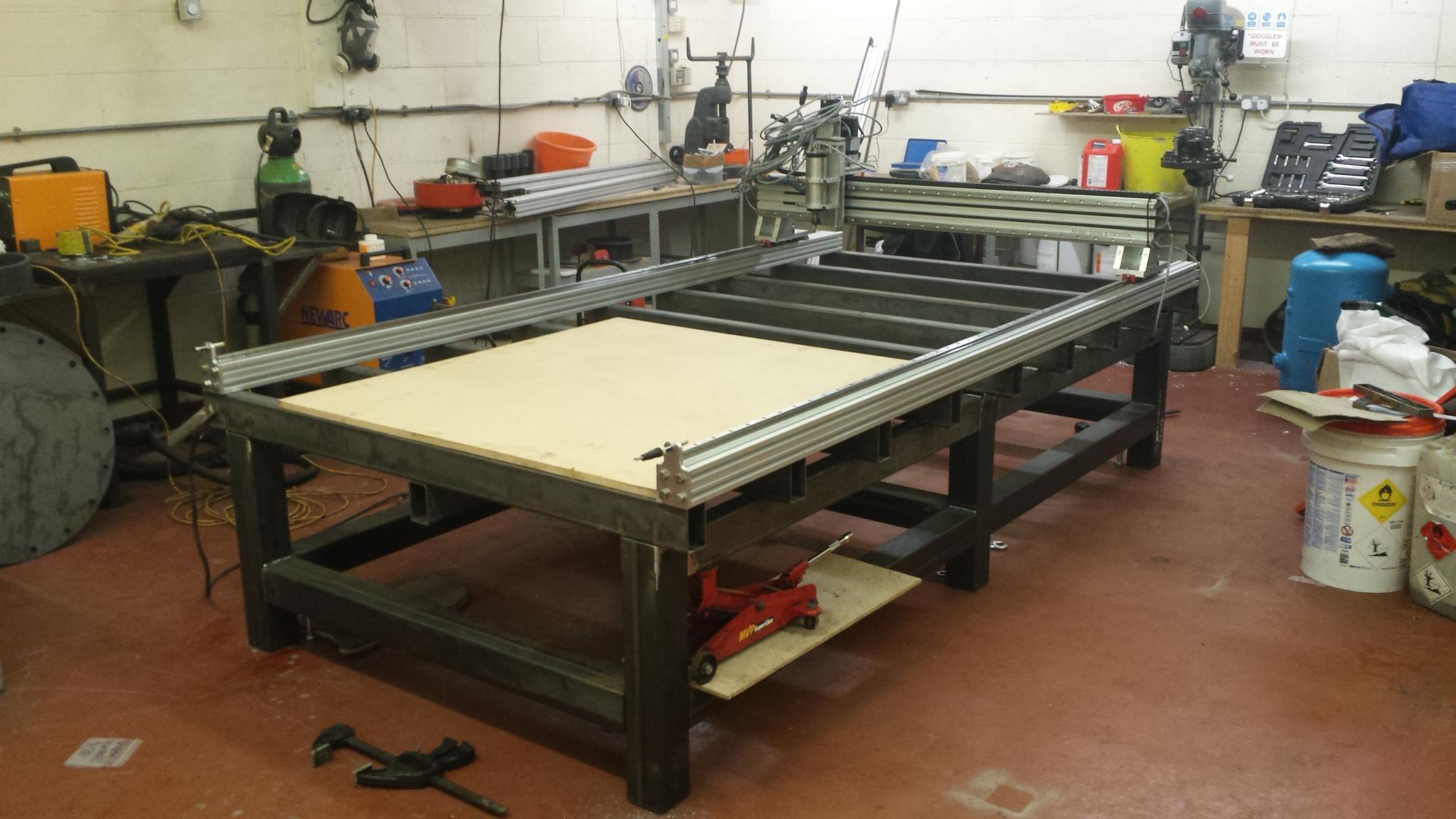

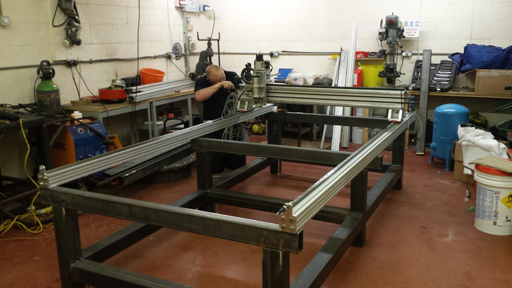

Well, I've managed to get a good start on the machine over the past couple days. This thing is solid!
Attachment 13937Attachment 13939Attachment 13938Attachment 13936
Re: 8x4 router build. Steel base & Aluminium gantry gantry
What a beauty. My heart warms looking at big steel structures :hysterical:
