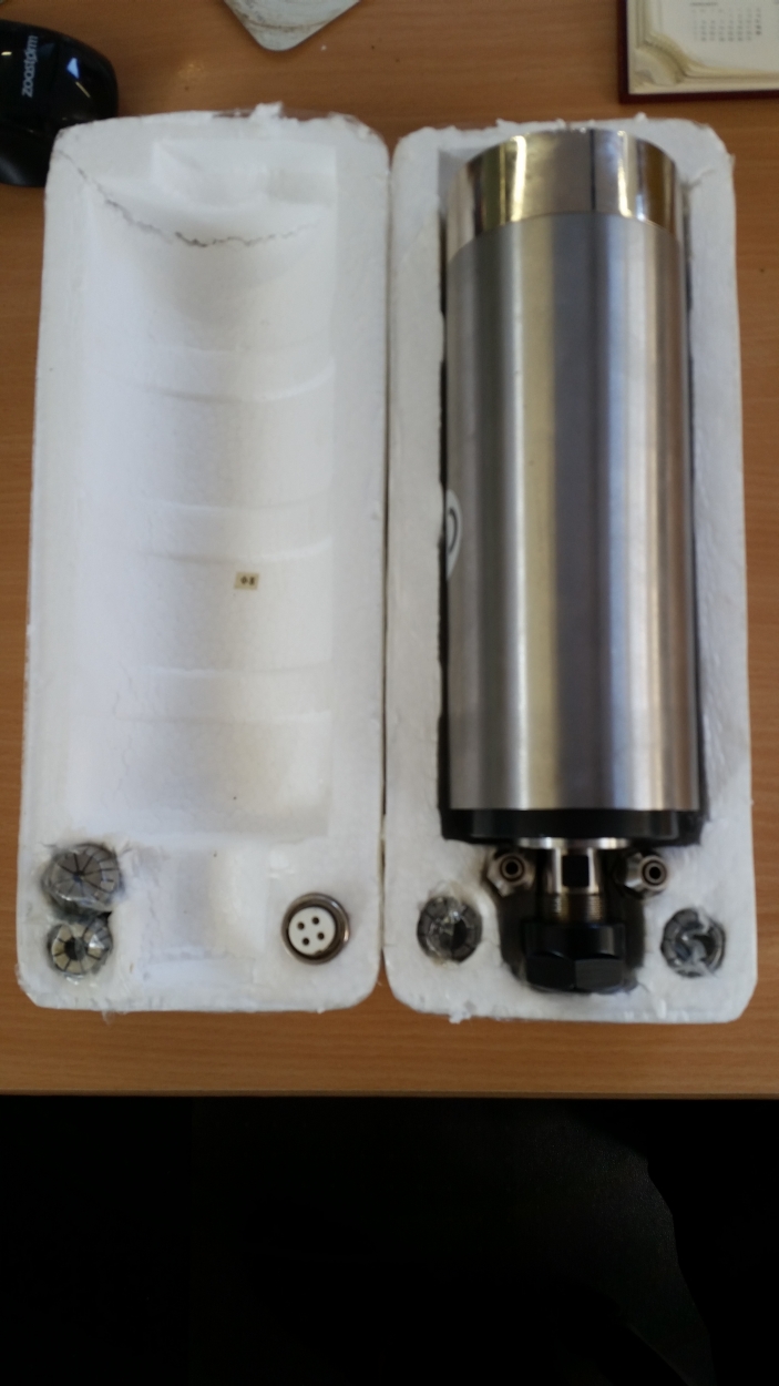

Had a delivery today, scrapping my original home made spindle design for a "standard" 2.2kW one...
Attachment 14915
Slight bit of damage where it looks like it was dropped, nothing serious just cosmetic and nothing that can't be sorted with a file! Spindle spins freely and smoothly...
