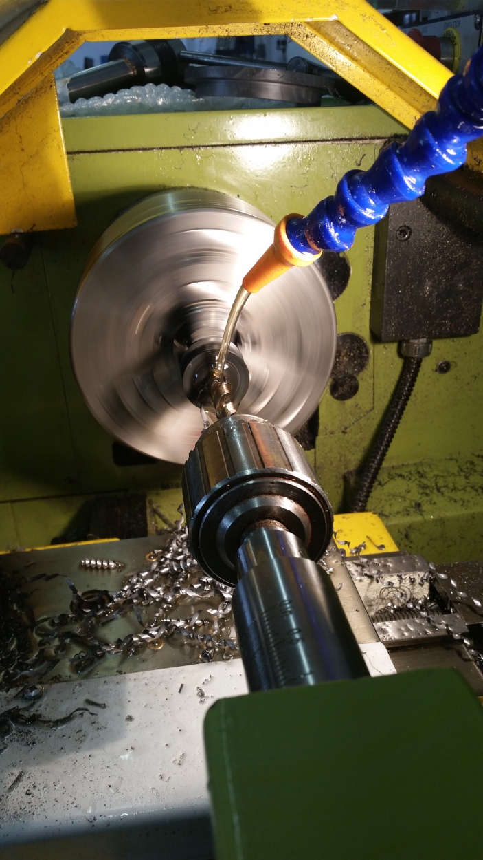

I realise that the pinions aren't pilot bored like the ones from belting online but I was going to have to drill them out to the correct size for the ballscrew ends and stepper shafts on the lathe anyway.

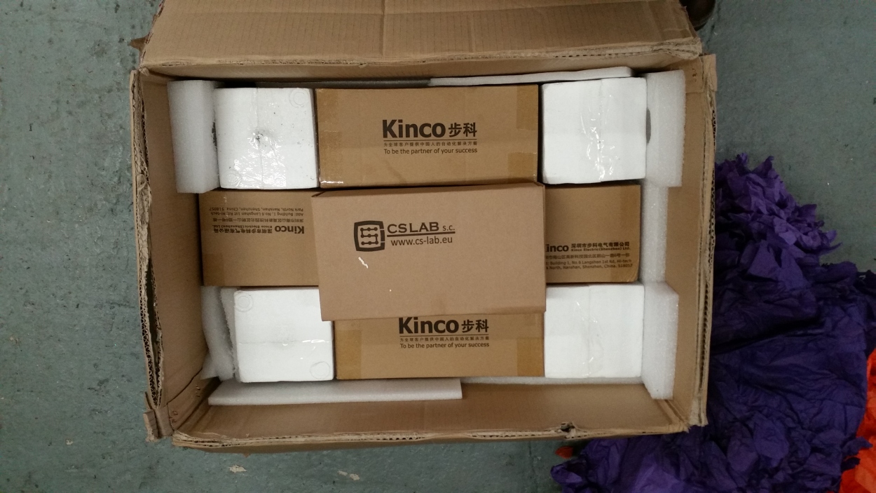

Got another package just now....it's like Christmas :yahoo:
Opened the box from Gary @ Zapp...
Attachment 14753
CSMIO....
Attachment 14755 Attachment 14756
Showing it's size against a Nema23 stepper and AM882
Attachment 14754
Kinco 230V Driver
Attachment 14757Attachment 14758Attachment 14759Attachment 14760
Nema34 8.7Nm motor...(4 off)
Attachment 14762Attachment 14761
Showing the difference between a Nema23 and 34...

Drilling the pulleys...2x8mm, 4x10mm & 1x12mm
