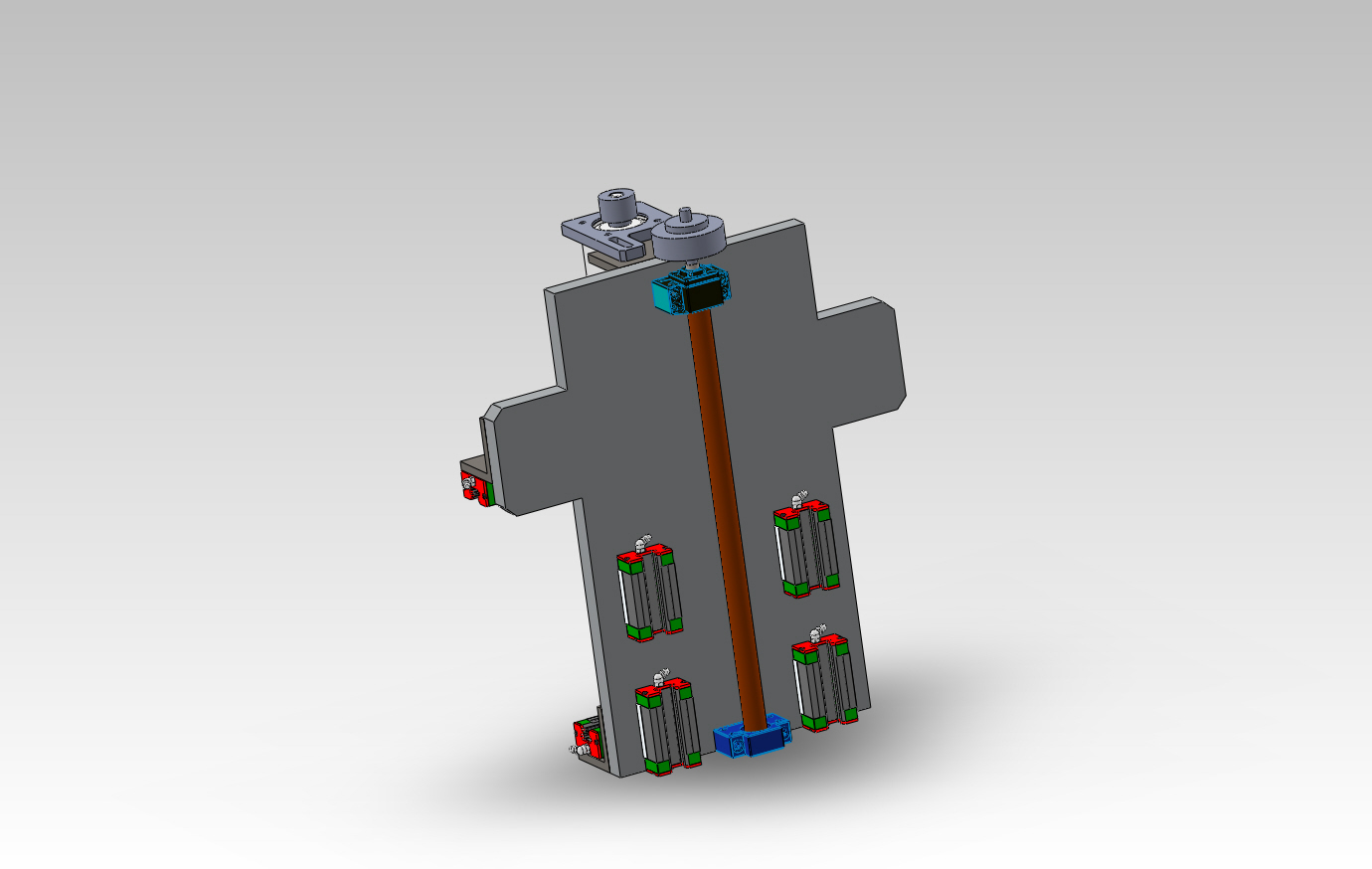

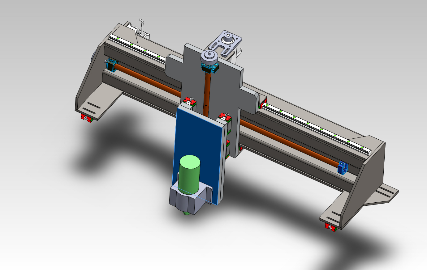

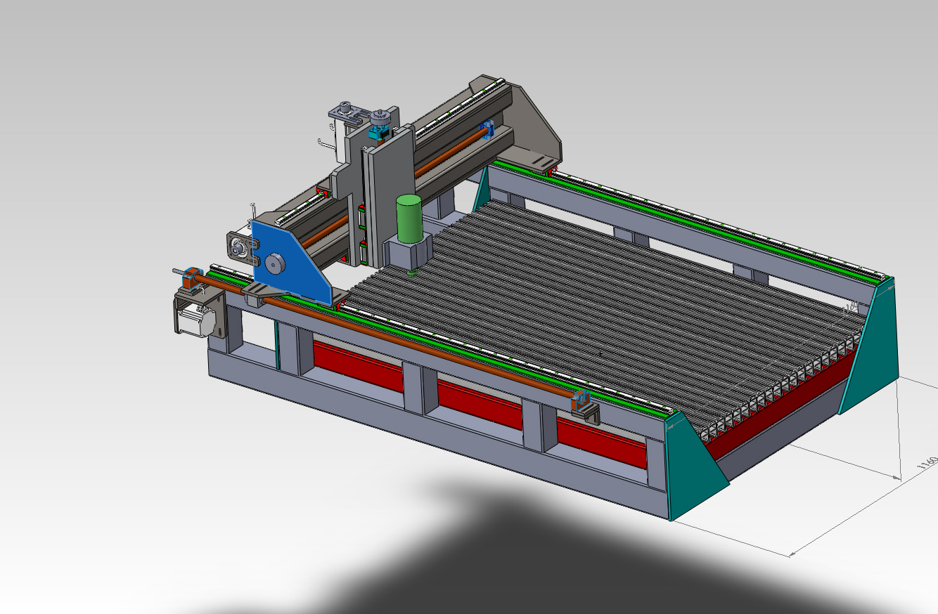

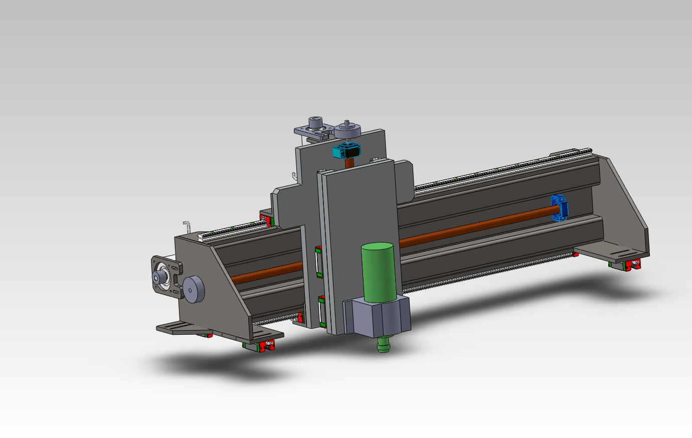

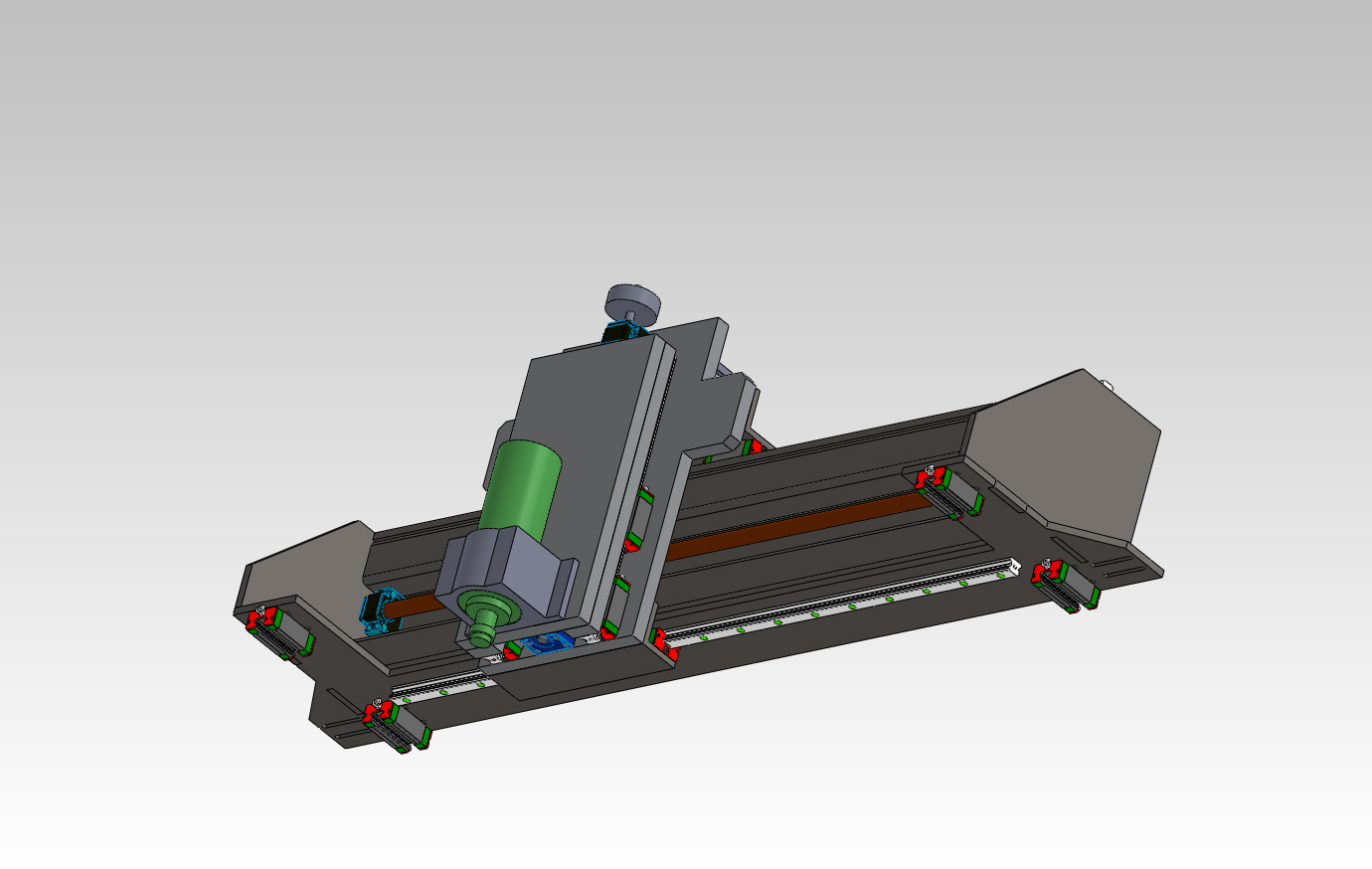

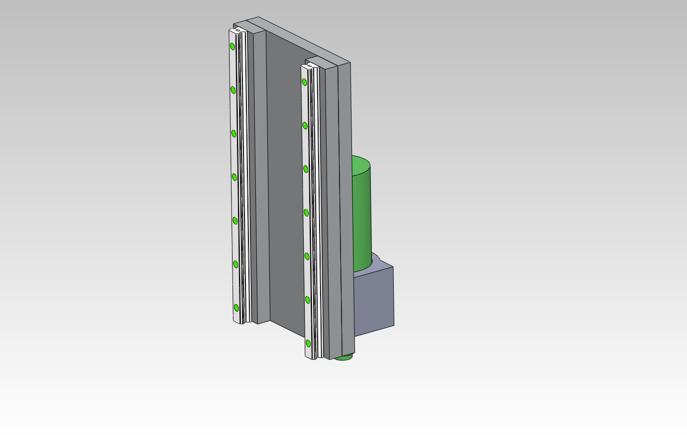

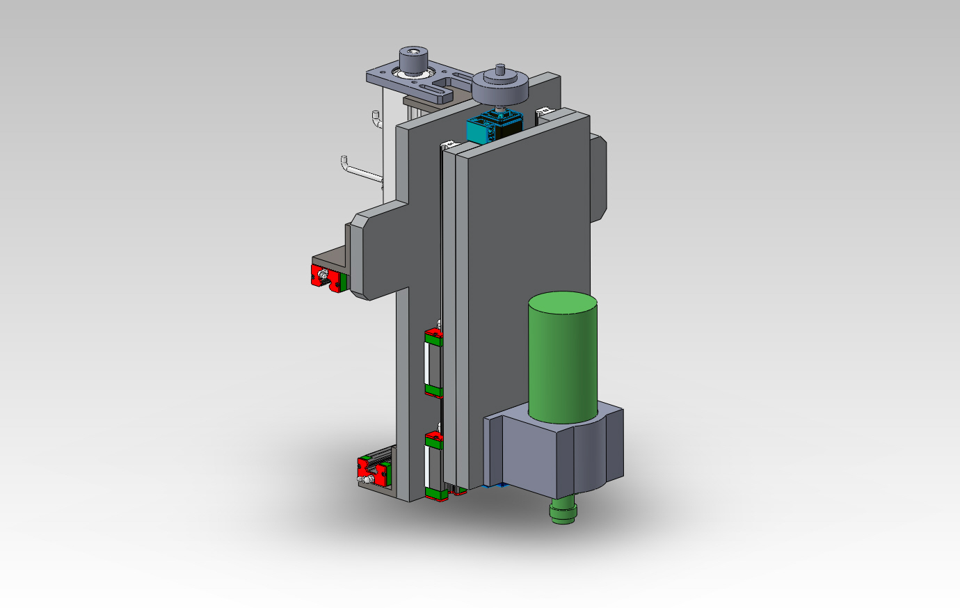

14 Attachment(s)
Re: Stell frame cnc 1500X1000. Adjustable table your opinion please

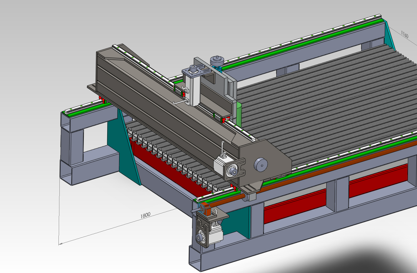

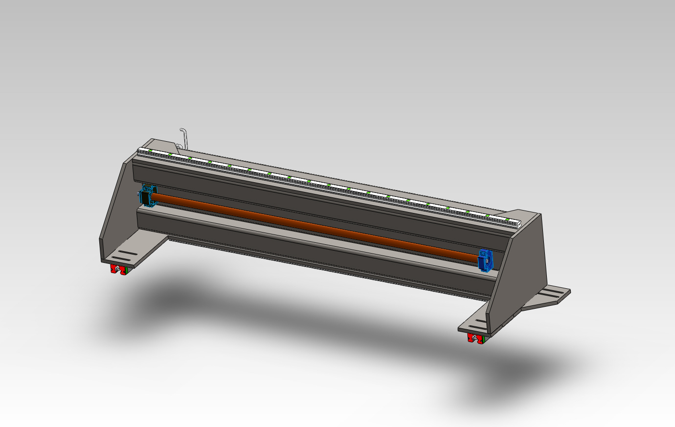

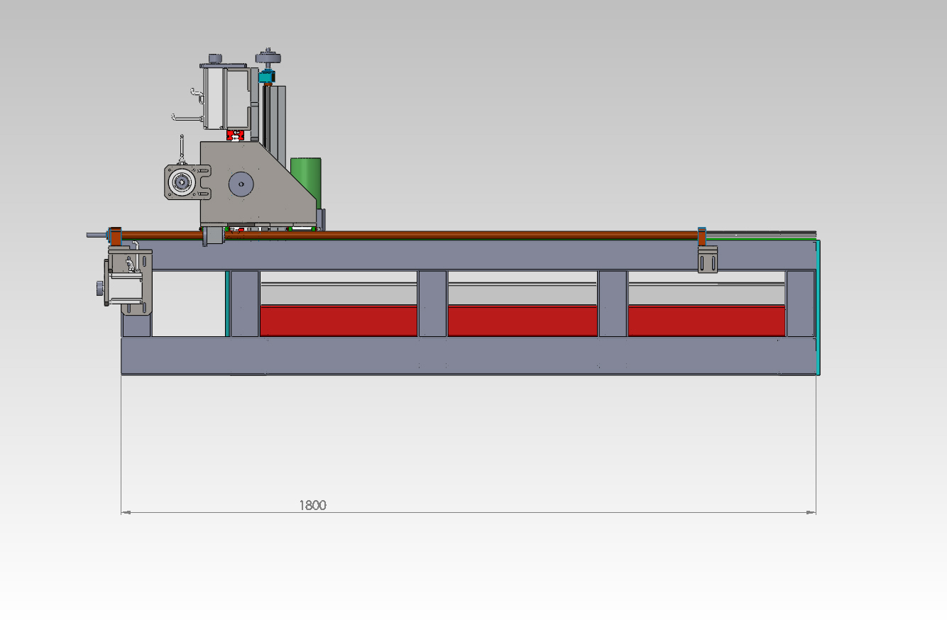

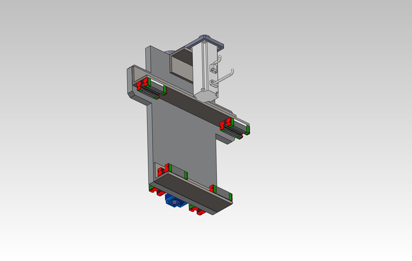

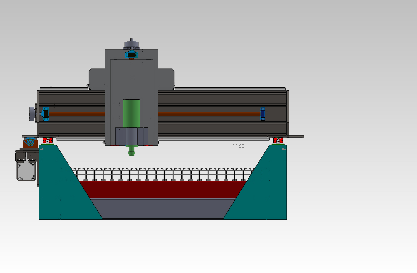

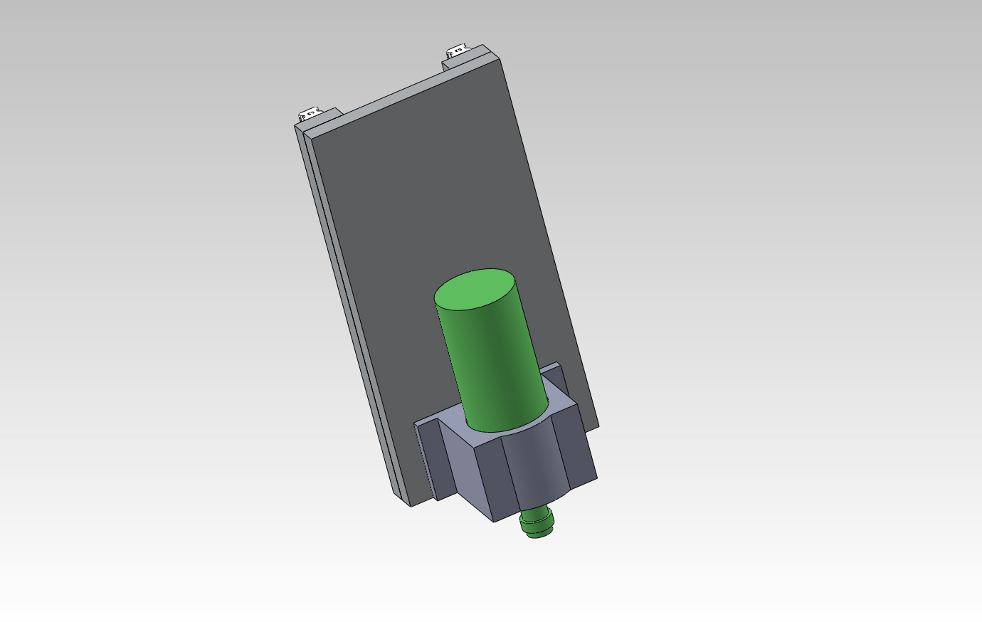

Here is some progress.
Ganty side plates 10mm steel. Doyou think i need a second side plate each side?
Gantry body 210mm height, made from two tubes 120X60X4 ( up down) and 1 tube 80X80X4 (middle) welded together
All gantry will be welded and then apply epoxy in order to have bottom side carriages in the same level
Z axis from 20mm aluminium and some parts from 10mm steel.
Y axis upside carriages at 400mm distance
Y axis bottom side carriages at 250mm distance
Z axis travel 200mm
Spindle plate 200mm wide
On Friday i will confirm my order to Chai for ballscrews dimensions leave 50mm for pulley attach and easy alignment
I will be glad to hear any advice or comment
Thank you for your time
Attachment 12284Attachment 12285Attachment 12286Attachment 12287Attachment 12288Attachment 12289Attachment 12289Attachment 12290Attachment 12291Attachment 12292Attachment 12293Attachment 12294Attachment 12295Attachment 12296Attachment 12297
Have you thought how you will access the mounting bolts on the Z rail blocks (4.jpg) it looks like the Y rails blocks will restrict them. On another point it seems like you are use angle iron for the rail blocks (Y) are you sure that they will be at true right angles and that the inside edge is flat and parallel to the outside edge. ..Clive
Clive S
Aluminium angle is a lot more accurate than steel so maybe you could use a thicker section aluminium angle instead.
Do you need the full Z travel ? if not I would move the Z Hiwin blocks further apart.
Also now is the time to work out where your cable drag chain (energy chain) will sit, you'll need three lengths of the stuff and will need to know the lengths, bend radius, internal dimensions.
Looks like it's coming together nicely.
