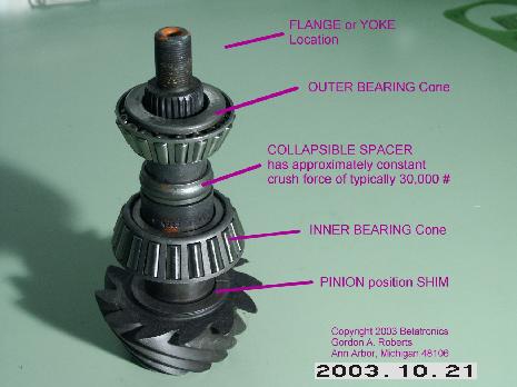

I have been talking about collapsible tubes as used extensively in some applications.
Because your tubes would be relatively long a pair of thin wall aluminum tubes would compress the amount needed, a bit of trialing to get the right combination of force/distance needed, perhaps a bit OTT for you.
Oldish American video, they call it a crush sleeve.
Setting pinion bearing preload on the Ford 8.8" axle - YouTube11193

I guess the tube acts as an additional way of protecting from too much preload, right? without the tube, there's no way to stop the bearings from being practically destroyed by over tightening the locknut / cap-bolt?

Well not quite, if you get too enthusiastic with the wrench and collapse the tube too much, you can still destroy the bearings. If you exceed the preload on assembly the recommendations are that you use a new sleeve, which of course they always do :highly_amused:
What it gives you is a high torque retaining nut/bolt with the ability to set a small preload and a very rigid assembly. In practice it is quite easy to feel the spindle start to take a preload and is also possible to adjust later if required, not so easy with fixed length spacers.
Differential pinions do have stringent requirements, high loads from the hypoid gear at perhaps 200hp 6000+ rpm and must run quietly.
