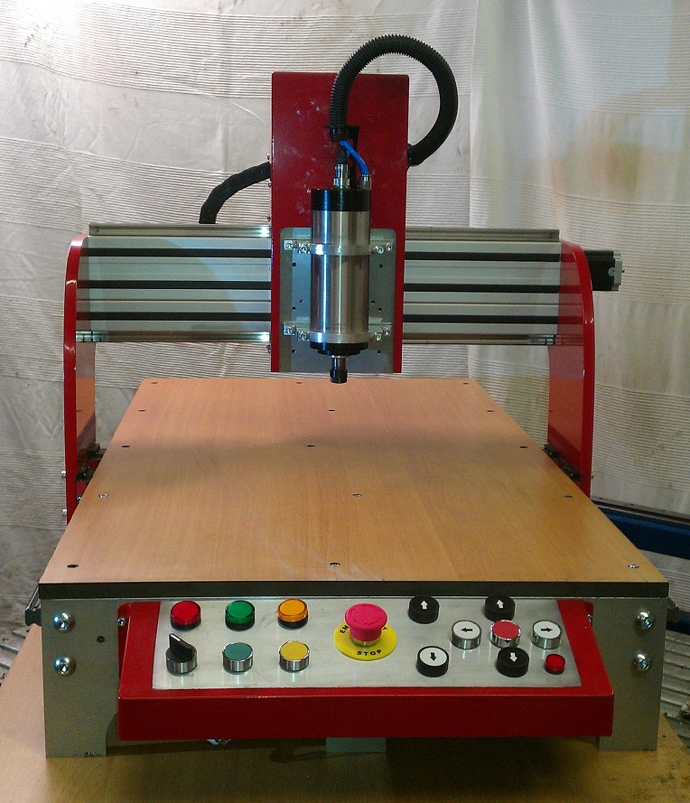

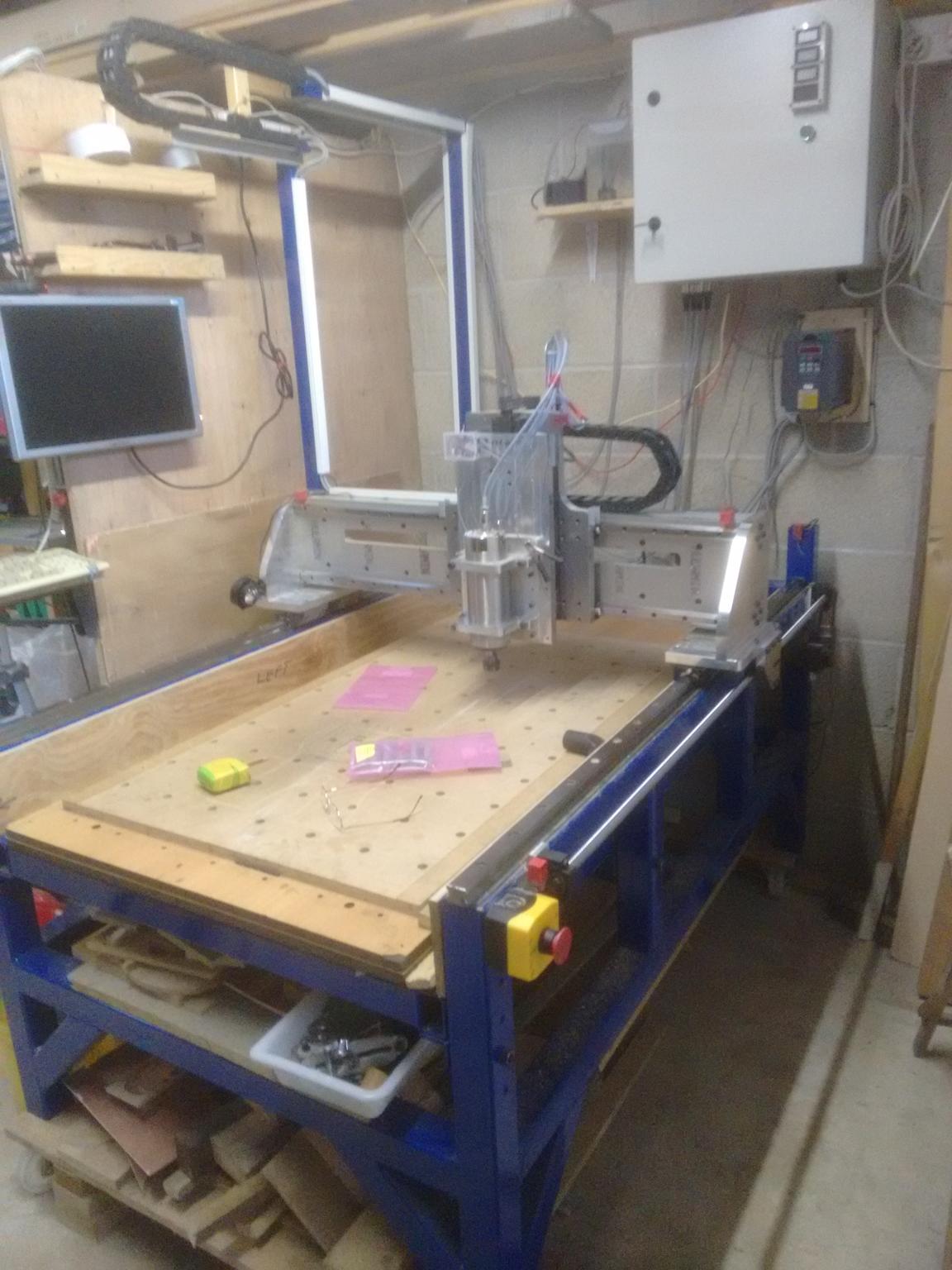

Ive been having a look through some of the build logs. I like the look of this one http://www.mycncuk.com/threads/6988-routercnc_MK3
I feel I have a few long days of looking through build logs and the forums to get some sort of idea of parts that I want to look at. Happy days!!
That's my machine. Glad you like it and for its size it will happily cut wood no problem although you will need 1610 screws not the 1605 ones I fitted (to get the feedrate up)
But if you want to go bigger (1200 or 2400mm that you mentioned ) this would need some work. The gantry is only 80x80 heavy gauge profile and would need to be bigger or multiple profiles or steel box if double the width.
I would also recommend the raised X style machine which many others have built as this removes the gantry drop down sides. Much stiffer and not much extra work to build. Keep the ends open to feed in the sheets.
Also at this size you should look at the pros and cons of rack and pinion on the longest axes instead of ball screws, especially at 2400mm

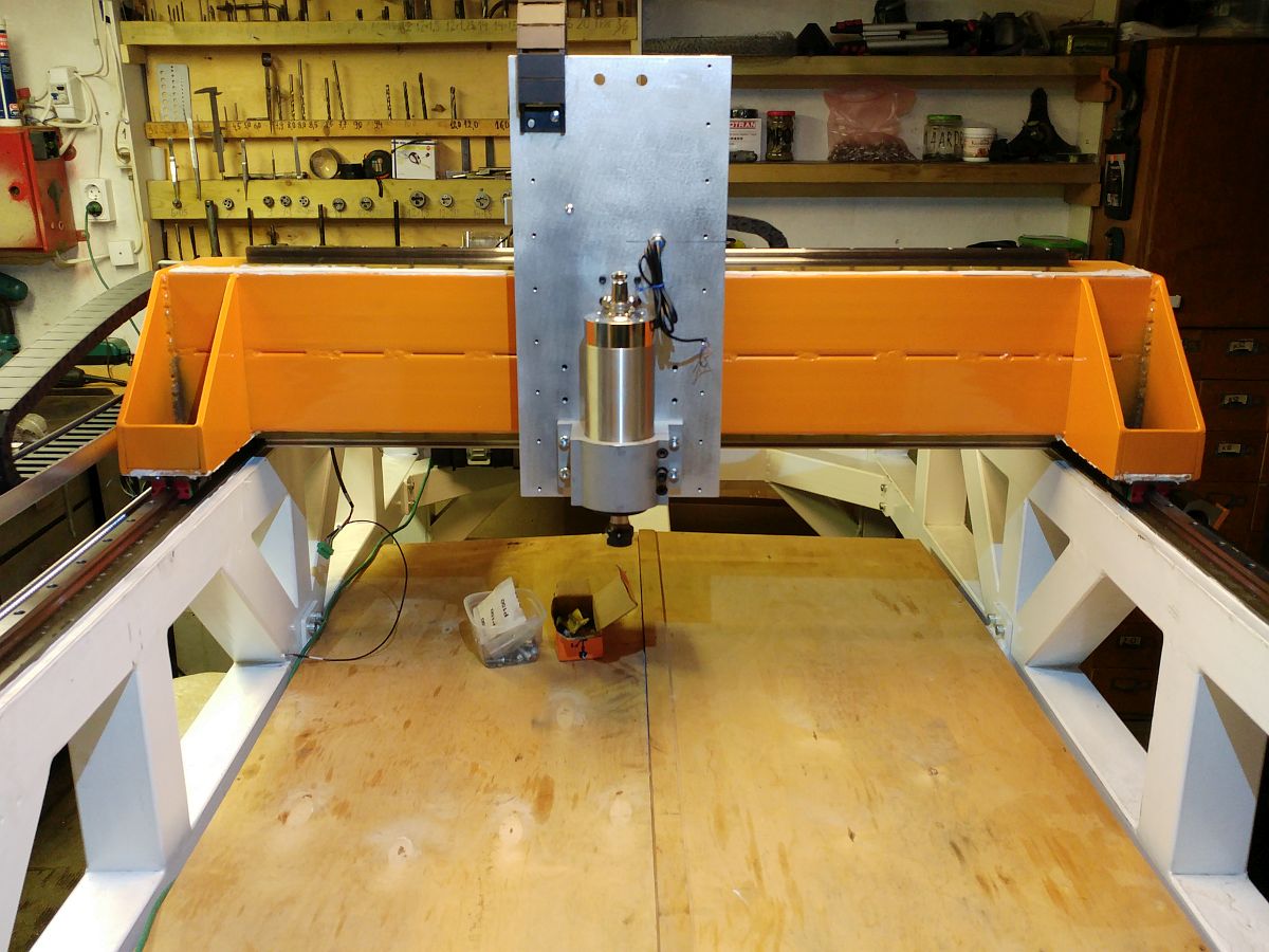

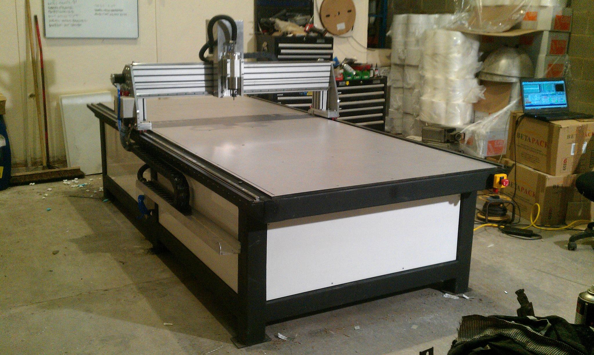

Both these larger machines below are built from same materials (steel, profile) and do the same job of cutting woods, plastics etc. Both are strong strudy designs and Only reason the designs are different is because each had different needs. One needed flexiblty of cutting deep materials so uses an adjustable height bed, the other is mostly for panel work etc where access is more important.

I haven't cut timber for a long time now - been cutting aluminium parts for 6-12 months, but from memory cutting depth probably ~3 - 6 mm and feed rates ~1000 - 1200 mm/min (limited by 1605 ballscrews and analogue drivers). This is a bit slow for wood but worked OK and I was only doing bits and pieces / small one offs.
I don't want to prescribe a specific gantry size until you have sketched something and have decided on gantry span, but 80x80 aluminium single profile is too small for 1200/2400mm wide, and 100x100 profile is also a bit on the small side in my view.
Raised X axis means that the longest X axis rail is supported up at gantry level by structural members which are part of the bed. It can therefore be made very rigid. The gantry is then a simple beam which rides on this. Couple of examples:
Attachment 21015 (Clive)
Attachment 21013 (Toomast)
Opposite of this is where the X axis is level with the bed and the gantry then has to be supported by drop down sides. Although these drop down cantilevers introduce some loss of stiffness, they can still be plenty stiff enough and allow 'all round' access to the bed for big sheets. Good examples posted by Jazz/Dean:
Attachment 21011
Attachment 21016
The raised sides machines have many benefits for the DIYer. Stronger, easier to level and build. Plus if you fit there thin sheet it will keep the dust more or less in bed. Cause a dust shoe in a sheet scenario works well, not so when cutting deep shapes, 3d jobs, stuff raised on vacuum table or fixture and so on.
