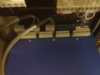

Would it be possible to get a photo of the inside of the control cabinet, if you can split it into about three and get close ups might be able to help further.

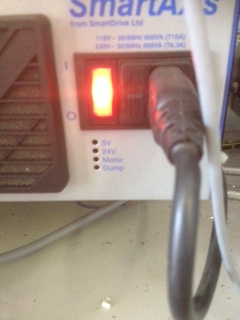

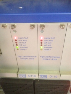

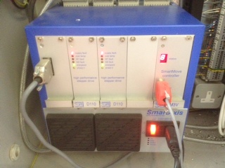

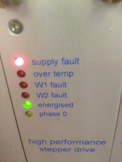

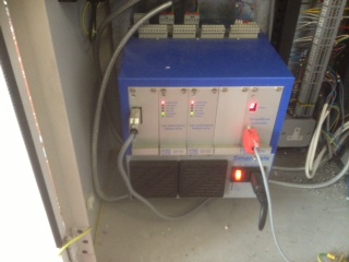

6 Attachment(s)
Re: Stuga routermaster problems computer dont seem to be connected to machine
Thanks for all your replys,much appreciated.
I have had someone come in and take a look at the machine although we got over the emergency stop/reset issue we have found another problem.
The "smart axis controller" seems not to be working properly.
I have taken some pictures of what it could be in some of the pics there should be some lights on underneath the power cable,i am not sure why these lights are not on as we have checked all the fuses and they seem fine,however if i knew why these where not coming on it could lead to the problem.
Attachment 7963
Attachment 7968Attachment 7967Attachment 7966Attachment 7965Attachment 7964I have also attached the pdf of all the technical details on the "smart axis"
http://www.smartdrive.co.uk/sa46.pdf product
Technical http://www.smartdrive.co.uk/sa46.pdf
Does anyone have an idea why these lights are not coming on,and where there maybe a fault??
