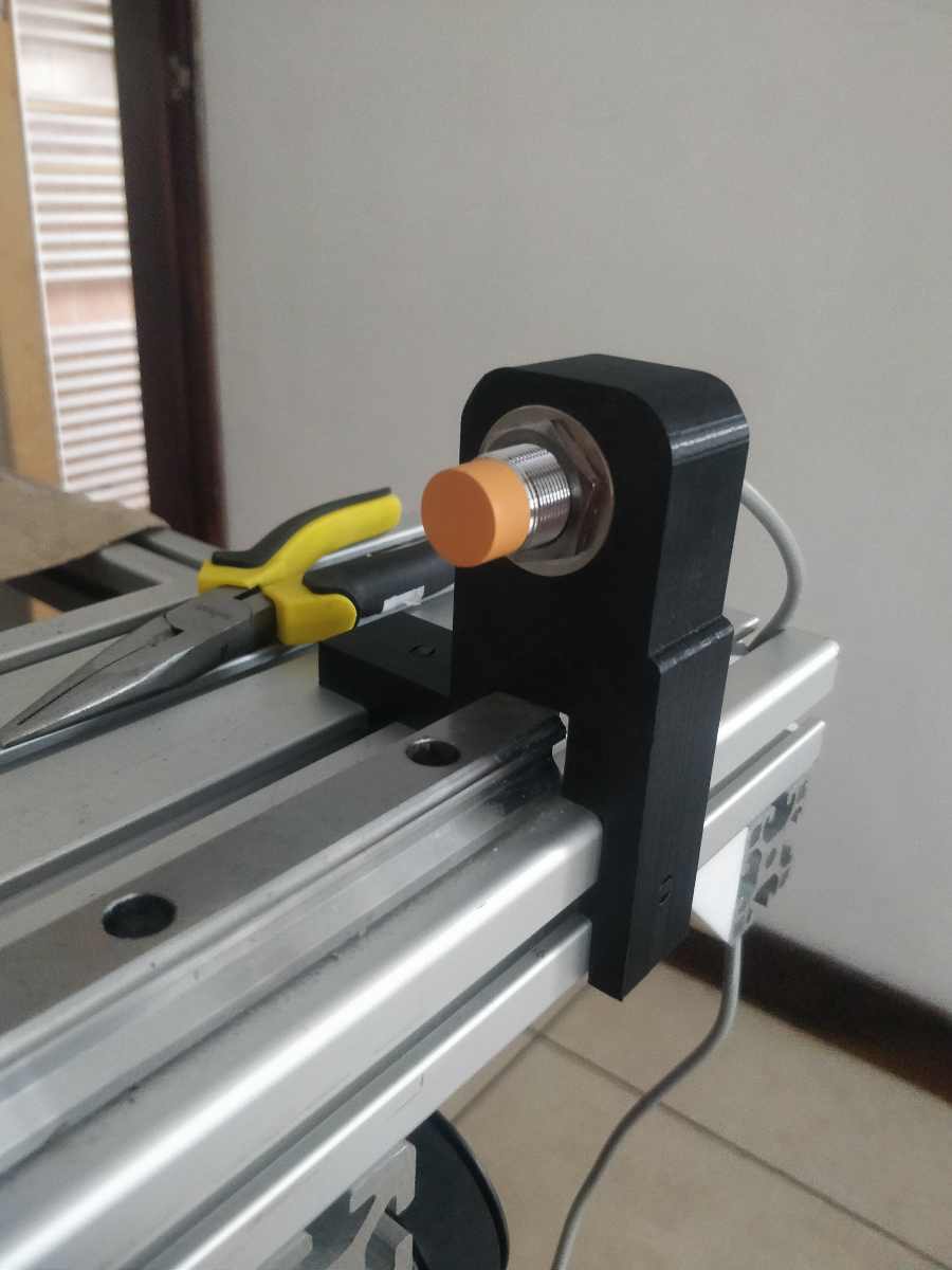

Attachment 26925
I 3d printed a mount.
Thanks again for all the advice.
Re: Proximity switches or limit switches
You may wish to revise the end-on approach, the first time you jog into and crush a switch. Don't ask me how I know. They work just as well when the profile just glides in from the side.
cropwell
Hmm, I could mount it sideways on. Im planning on using it as one of the home switches and just using mechanical switches for the limits that I would mount on the other side.
Cropwell I've just been playing with the homing function and guess what? I did manage to run into the proximity switch. No damage though because I had my cursor on the reset button in Mach 3 and the switch mount wasn't fastened down. What I can't understand is why is the proximity switch detecting the gantry, stopping and backing off as it should but then moving forward crashing into the proximity switch. Could it be because I haven't set my steps per mm properly yet?

Your setup is not a good one.? Often when you crash into limits it's not slow like your doing in testing, it's usually at rapid feeds or higher cutting feeds when machine loses position
by missed steps due to things like Sticktion or binding, etc. In cases like these, the gantry doesn't stop instantly and you get over travel which will smash your setup to pieces.
You need to ride over switches, not into them.!
Point taken I'l change it when I put it back together. If what you say is a possibility of happening then how do we guard against other things getting damaged like BK / BF bearing blocks? Is it therefore wise to leave a good margin of rail / ballscrew for stopping distance?
