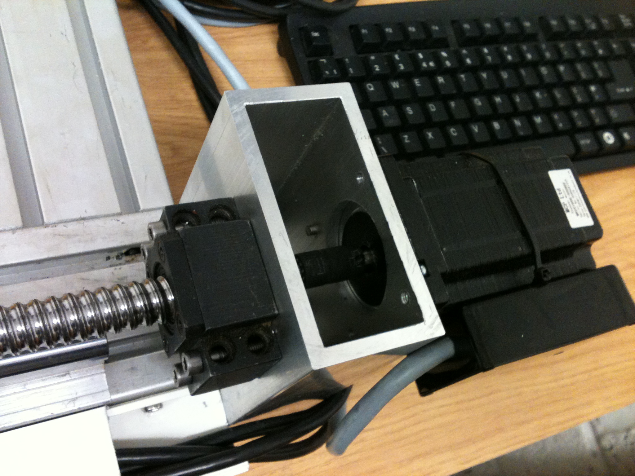

I went with a small project box over the area on the stepper motor where the wires exit, making it look a bit tidier. Also adds a bit of impact protection. Inside the box I used a choc-box.
Attachment 14851
But solder and heatshrink, with the option of netted sleeving also work.

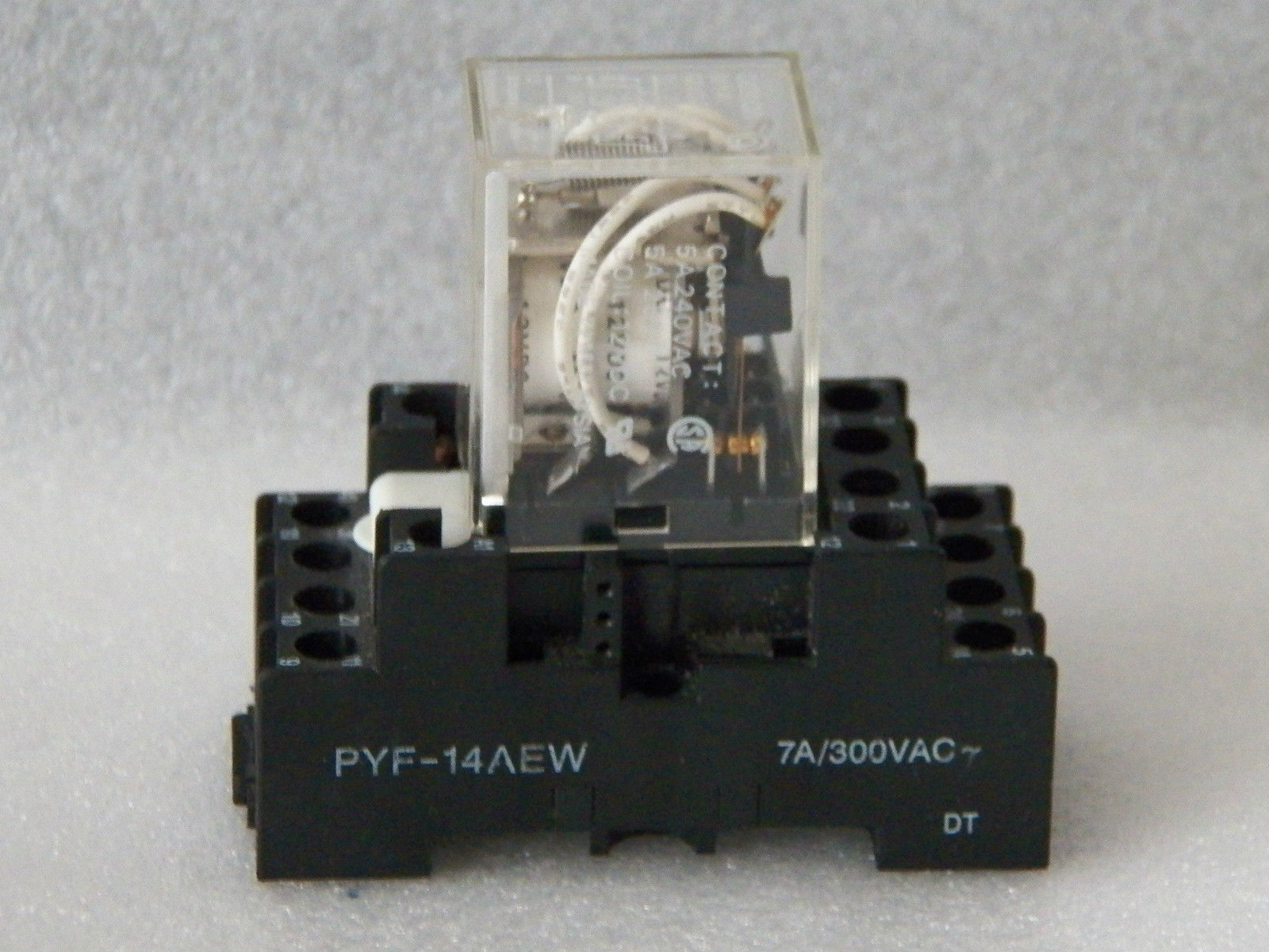

Next question! I'm going to get a safety relay (probably a second hand Pilz from ebay) for estops, limits, home switches etc. What's a good model to get, I've seen some Pilz PNOZ X3's which seem to fit the bill?
I'm not going to talk you out of a Pilz style relay as I looked at those as well and was impressed. However, I will mention that a level of safety interlock can be achieved with a cheap multi (4) pole relay - mine was about £8 and has the option of DIN mounting:
Attachment 14852
One of the poles can be used to form the latch, and the rest are free to switch whatever you need downstream. However, if you don't mind the expense then the Pilz system is neat is and is what the industry seem to use.

routercnc
Attachment 14852
I agree pilz are nice to have but not really required at DIY level. Normal relays work just as well provided they are correctly sized.
As stated a latching circuit is easily created and standard 24Vdc relays are cheap and easily sourced for any future problems. Depending on level of safety you'll still probably need a plan vanilla relay or 2 anyway as the pilz won't provide enough contacts.!
Attachment 14851
The Z axis stepper will be covered by a cover ill be making from sheet metal to cover the entire Z axis (Jazz's idea) and the Y stepper is enclosed in the gantry (or will be) so the only stepper exposed will be the X axis one, I might look into a cover for that once the machine is up and running. It'll also be tucked away at the top of the router (it's going 80° vertical on its side) at the back so hopefully out of the way.
