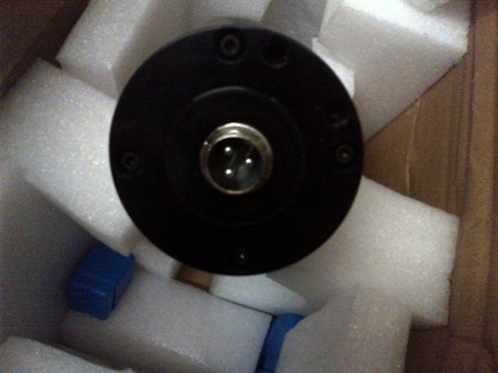

The spindles from Portsmouth are the 3 pin type, I don't know if that means anything.I have to say delivery was fast and it was well packaged,I paid £218.00 from lovehappyshopping.
Attachment 11622
That looks Good Andrew
