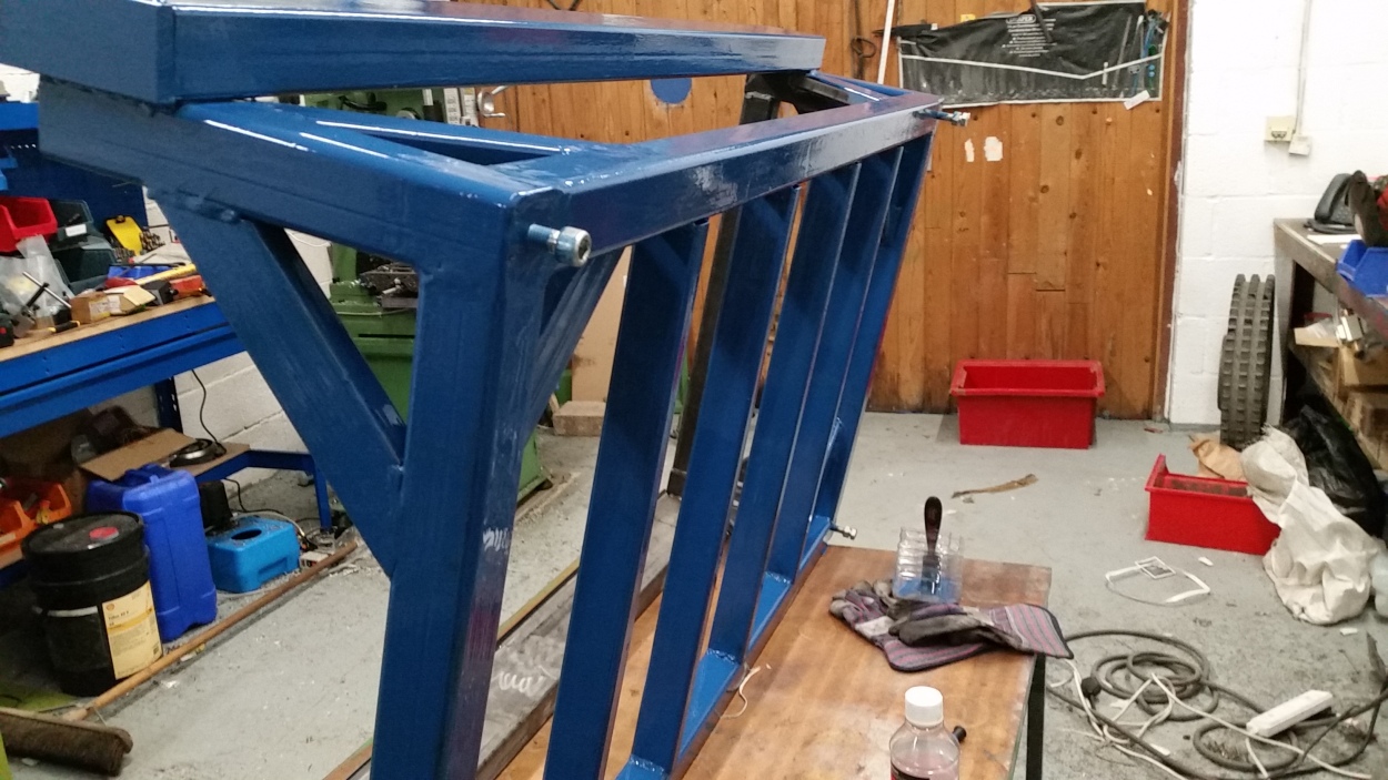

Did a bit of painting this afternoon for an hour....
Attachment 14664
