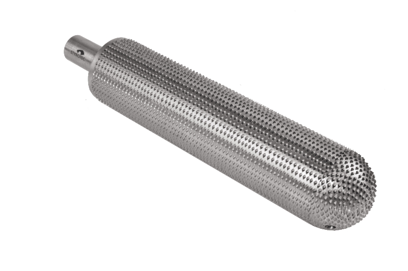

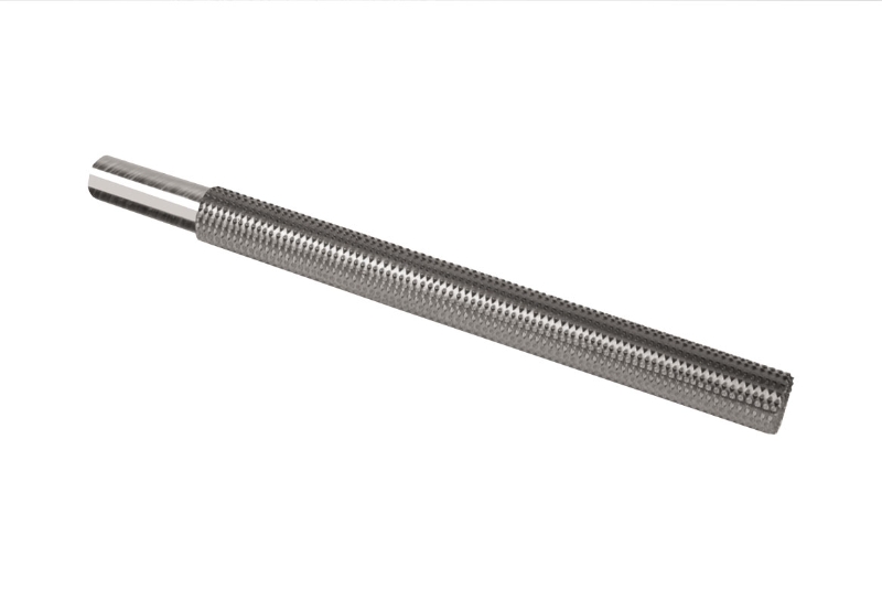

I've been milling insulation board for ages with ground drill bits and ball mill ends but a someone requires styrofoam to be milled and it looks like it requires a different mill. There are specialist companies like Styrotec who make solid and hollow bits for polysterene but they are super expensive.
Where can I buy a cheaper alternative rotary rasps in 6-8 or 10mm diameter that will cut 120mm of cutting depth? see pics http://www.mycncuk.com/attachment.ph...id=15919&stc=1http://www.mycncuk.com/attachment.ph...id=15920&stc=1

I buy from Ricicnc.com. I've just received an order from them for 8,12,16mm radius endmills all with a custom shank reductions. I dont have the invoice for those to hand but I bought a pair of R6 HSS ball endmills from them in 2018, deetz below. Three weeks from order for delivery. Couldnt find anyone in the UK to match.
D12XR6X150X200 4T foam mill bits, unit price $21, Qty 2, carriage $34, total $76

I wouldnt use them on plywood. I only use these on EPS and PIR foam at 12mm diameter and 200mm long they would just snap cutting plywood. Yes they do hold up well i've have several keep sharp for ages but i've also snapped a few just by taking too deep a cut with too large a stepover into PIR (like100mm pass at 80% stepover)

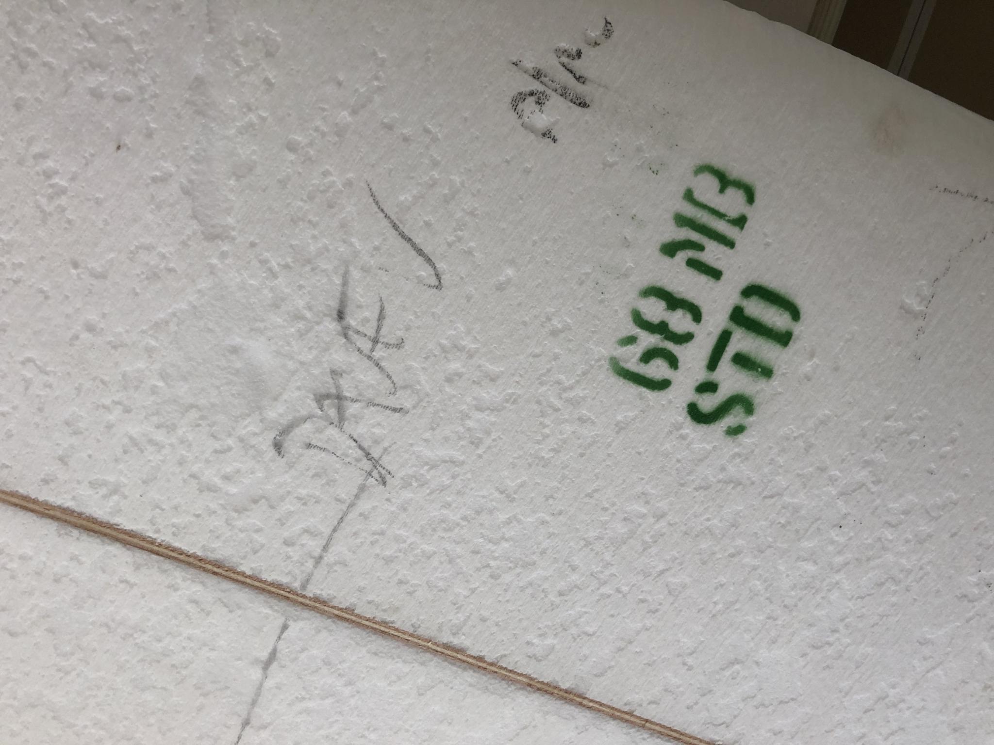

ok.. have you seen the plywood in the centre of a surfboard.. that's what it would cut..

Can you post an image or diagram

Ok so its a bit of 4mm or something. Horizontally or vertically down the centre? TBH need a bit more information to discuss solutions.
If its just a single thickness sheet of ply and you know the depth can you not set up a cut path with a 2 flute just to cut the ply then have another toolpath and cutter for the foam? I have 12mm 2 flute endmills up to about 100-120mm which will take down that ply in just a few layers. it all depends how deep you need to mill.
