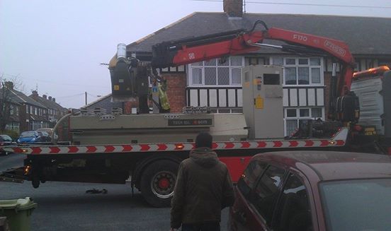

that was invaluable firetrappe thanks, These are one solid machine, and apparently am not he-man any more, or so every muscle in my body is screaming at me. Had to leave it outside the workshop till the morning. Start work on upgrading it tomorrow

Got it home today ( on front, not in workshop yet ).
Placing the machine in position (pallet truck and machine skates) took some doing
Ha, ah i can laugh now, these are a nightmare to move on skates over uneven ground, every fiber in my body is screaming, even my eyelids acke.
