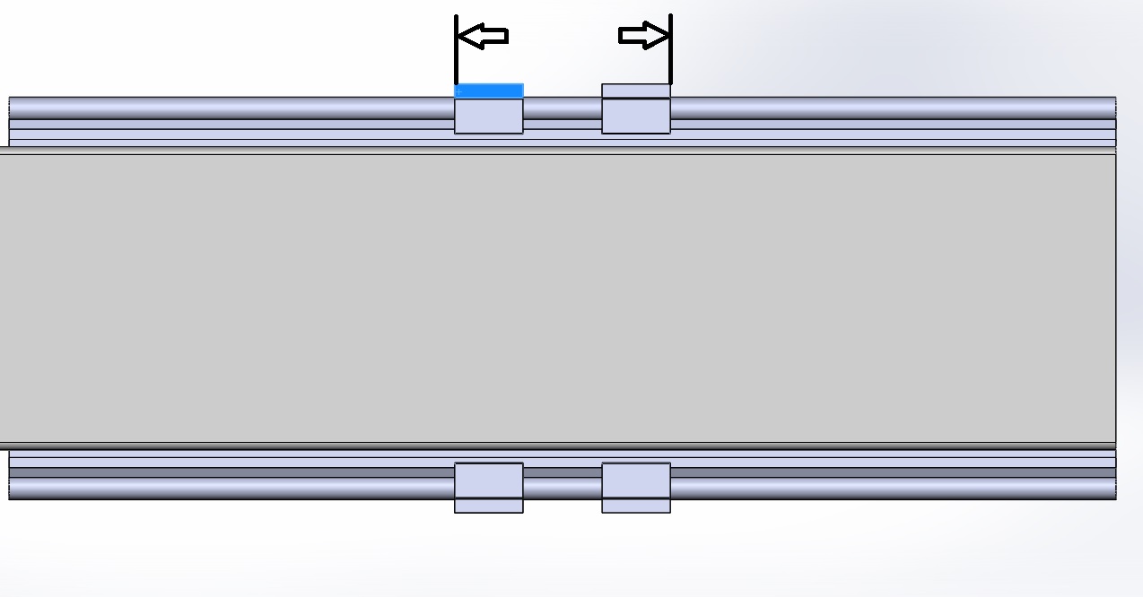

What far more important is the bearing spacing on the Y axis and the more(within reason) you have the better it will be, obviously this comes at the cost of cutting width so it's a balancing act and personally I won't go any less than 200mm with 300mm being better.
Dean - could you confirm this for me.
If Y supported rails are mounted to the top/bottom of the gantry - do you mean the height of the gantry itself ie, the distance between the rail mounting surfaces?
I think my design is at 175mm currently so may need to extend it.

CraftyGeek
Yep no problem but I like pretty pictures to save my fingers typing so that should show better what mean when say spacing between bearings.
Attachment 10170
Re: Steel/Aluminium design/build, sorta smallish, cuts ali hopefully
I think Dean means the spacing of the Y rail mounting bearing mounting blocks horizontal should be spaced wider ..Clive
Clive S
Yep I think he does has well. .:loyal:
