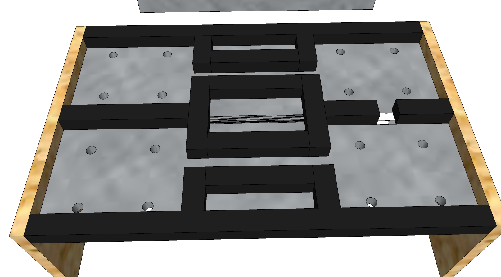

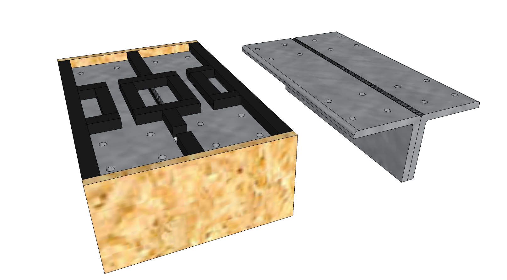

Will have a play with the epoxy sometime soon. Will level the angle that I'll be using to space the x axis rails out with a little like the pictures below. This will let me play with the epoxy and get used to mixing and pouring it and also give me a nice level surface to mount the carriages to.
Attachment 11503
The bridge between the two rails will be silicone sealant, all the foam will be stuck together and the MDF end boards will be no-nailed to the steel.
Attachment 11504
I'm seriously thinking of welding two steel 100x50x4 sections in an L shape and getting the machine up and running that way. I'll use epoxy on the steel to level the Y axis rails so they're level.
Attachment 11505

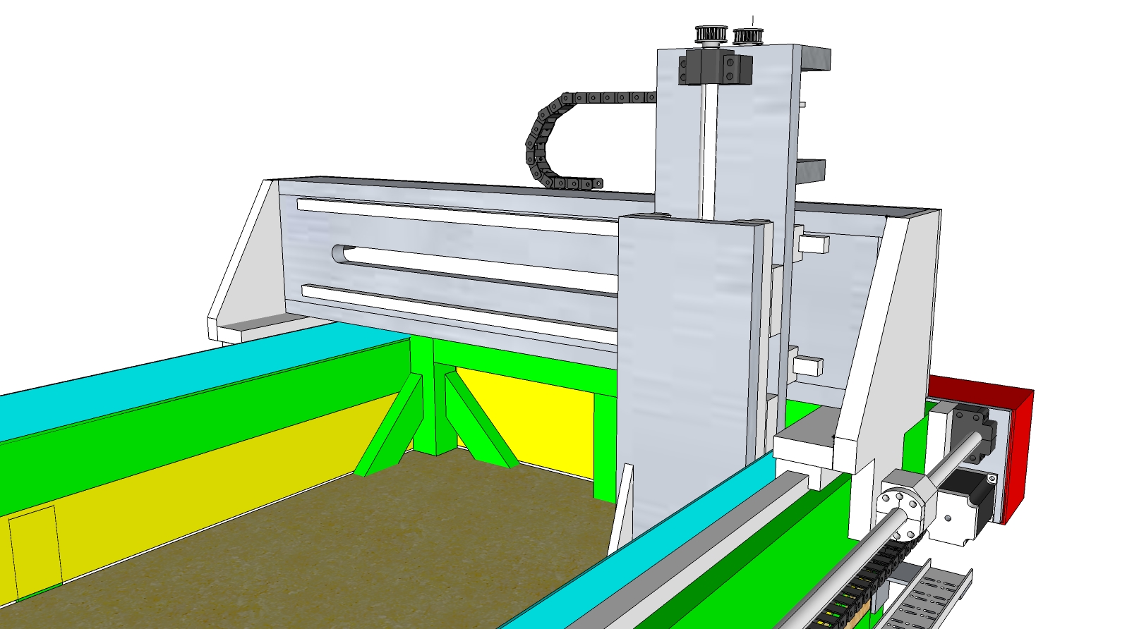

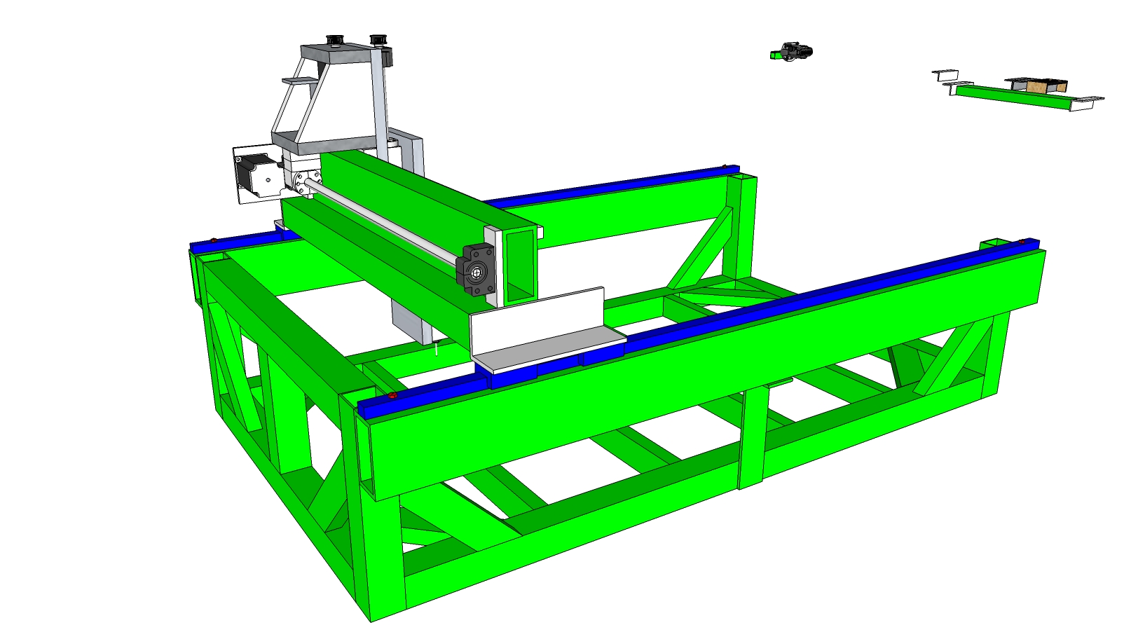

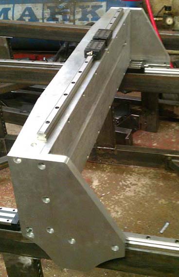

Yes I remember reading Kingcreaky's build, I was just thinking that to get it going and to keep costs down I'd use what steel I have left (got to use it up somehow) and build the gantry out of that and level using epoxy as I'll have a bit left over from doing the x-axis rails. Then I'll either keep it as it is or...use the machine to cut parts for itself and build the proper gantry...

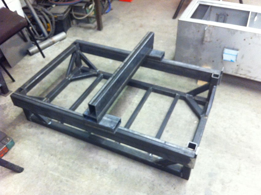

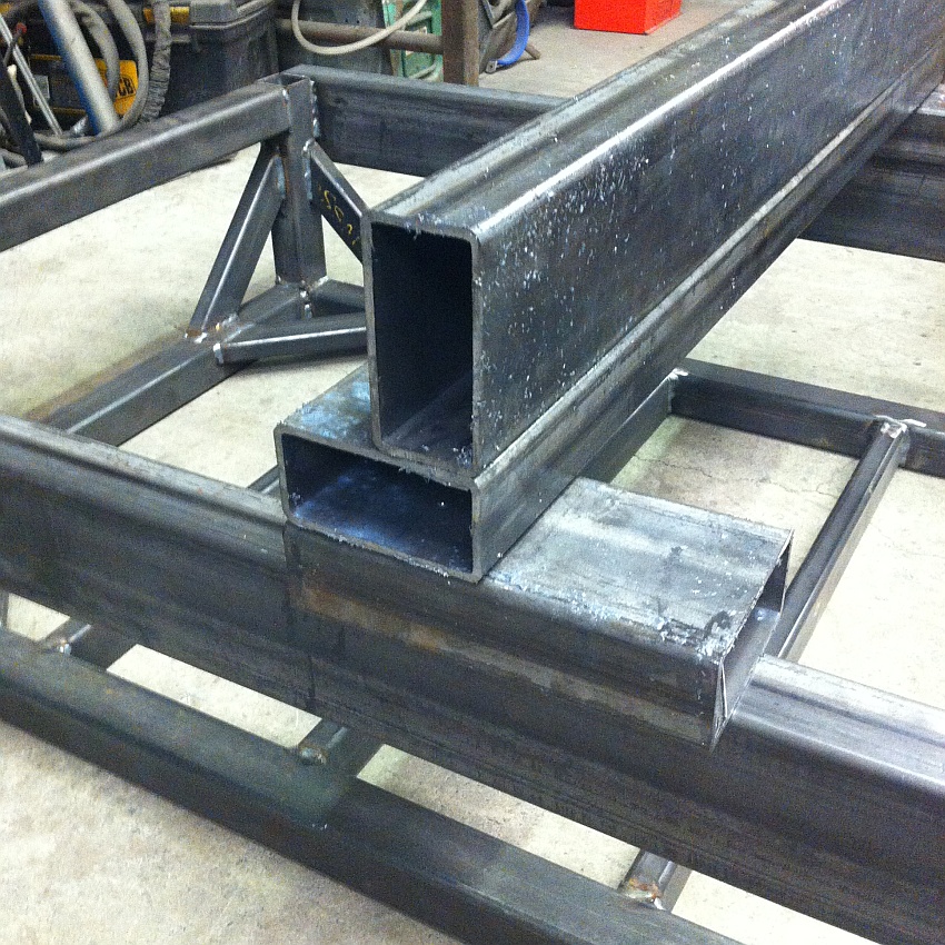

Cut up some of the 100x50x4 rectangular section steel to make a temporary gantry and just placed it on the x axis rails to check I cut it to the correct length!
Apologies for the blurred photo, took it on my phone...
Attachment 11552
Close up of the steel...fresh off the bandsaw so still got swarf and cutting coolant.
Attachment 11551
I'll hopefully weld up the two pieces tomorrow and drill the mounting holes for the 20mm carriages in the 200mm long bits. I'm thinking of bolting the L shaped gantry to the 200mm pieces and then once it's square I'll stitch weld them to keep them square. Going to epoxy the face of the gantry for the rails and also the bottom of the 200mm pieces so the carriages sit flush unless by some miracle the steel is perfectly flat...

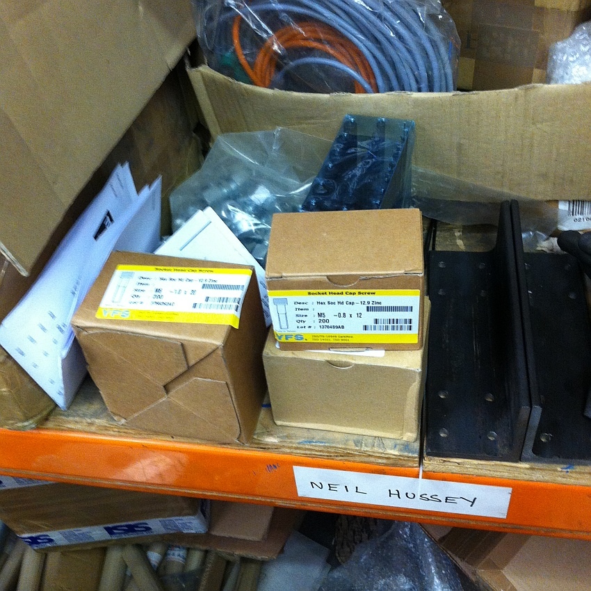

Had a delivery of some cap head bolts last week, I know I'll need more and different sizes but this should get me going!
