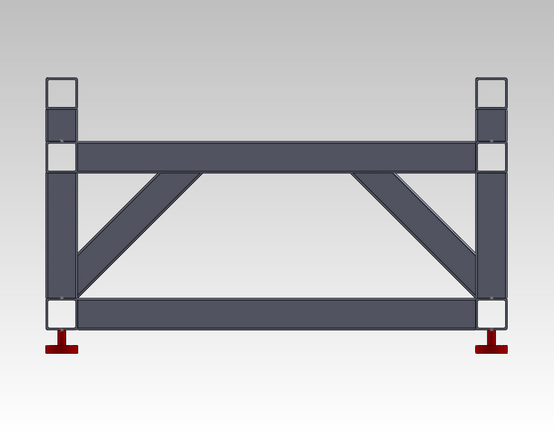

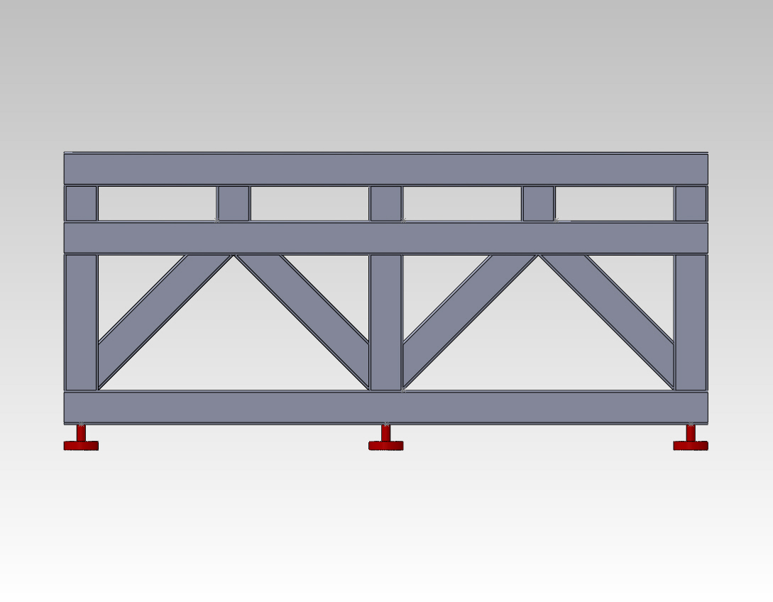

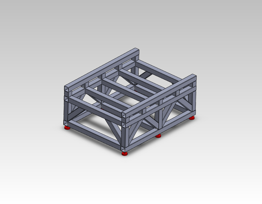

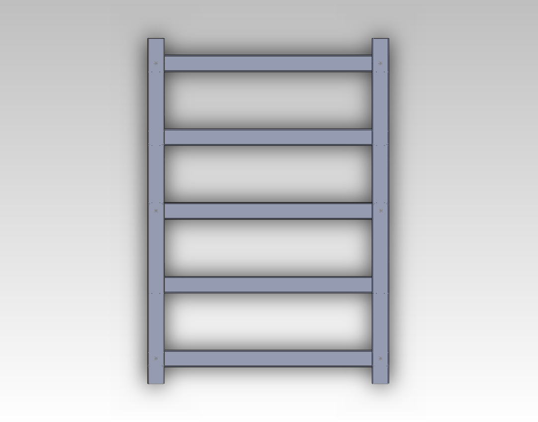

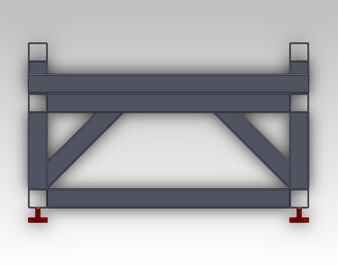

Stell frame cnc 1500X1000. Adjustable table your opinion please

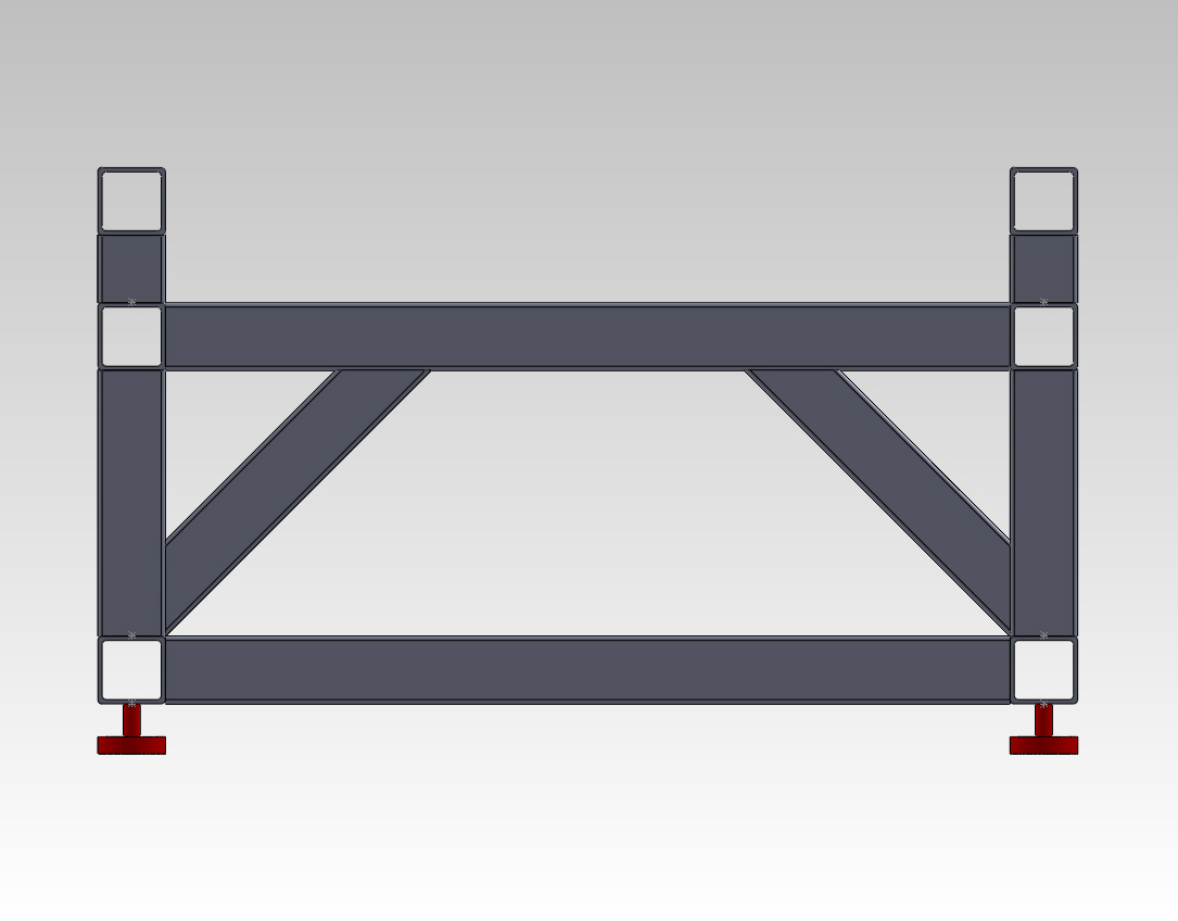

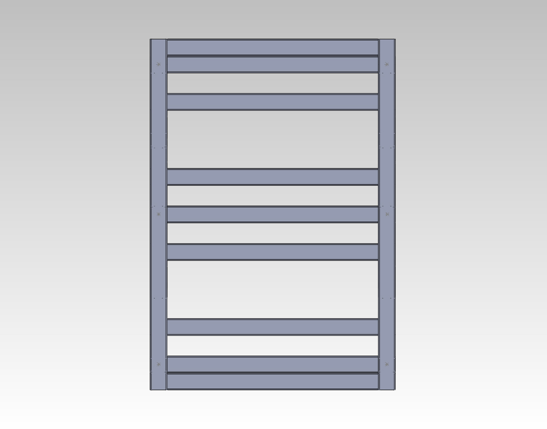

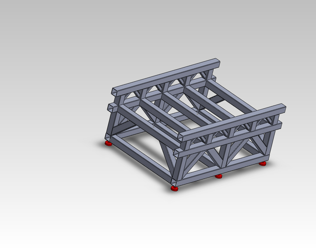

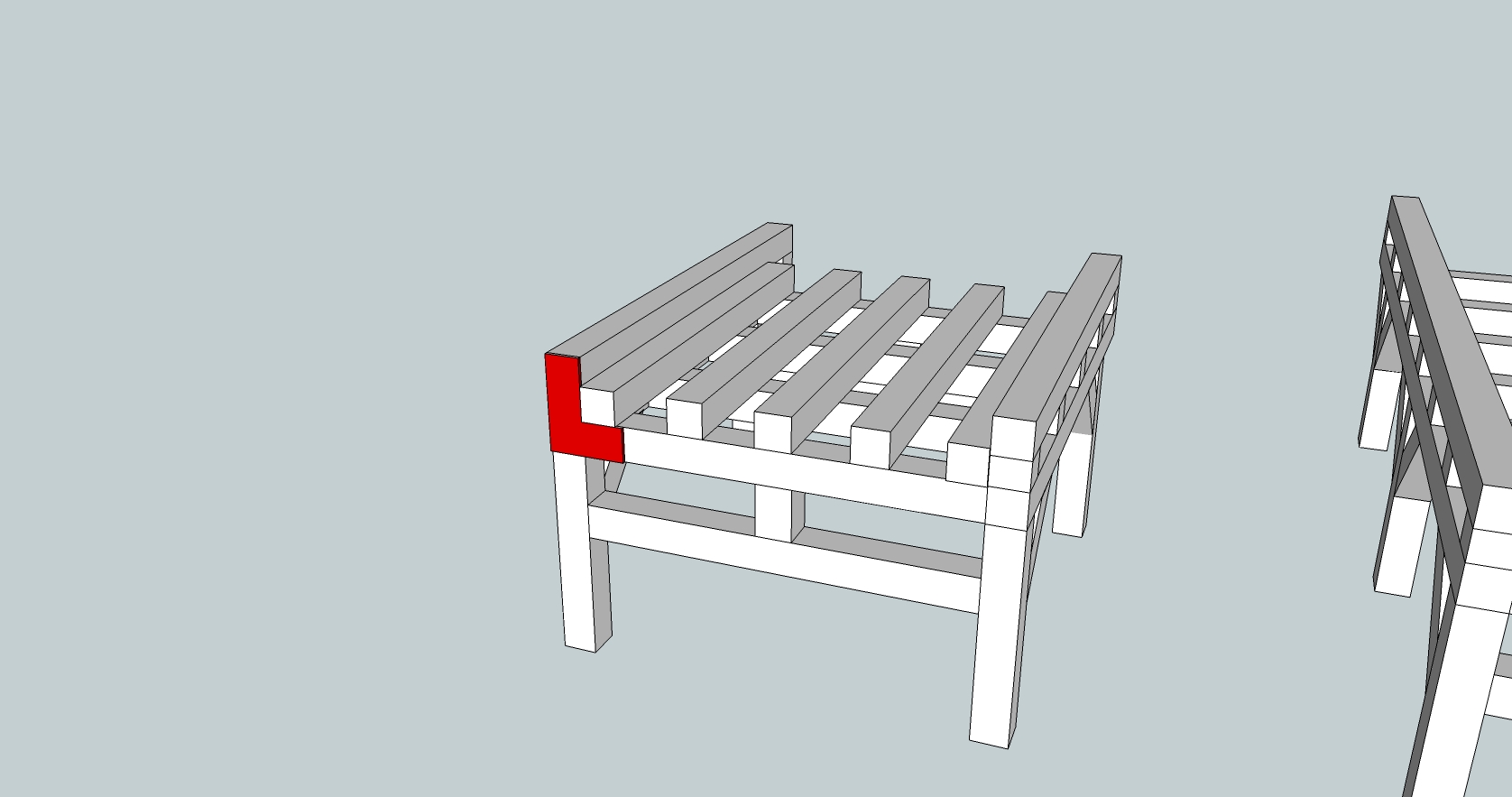

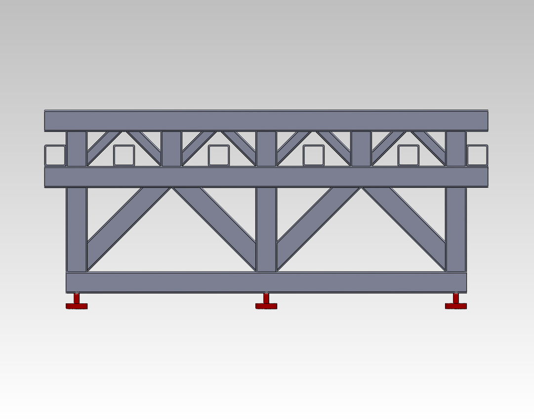

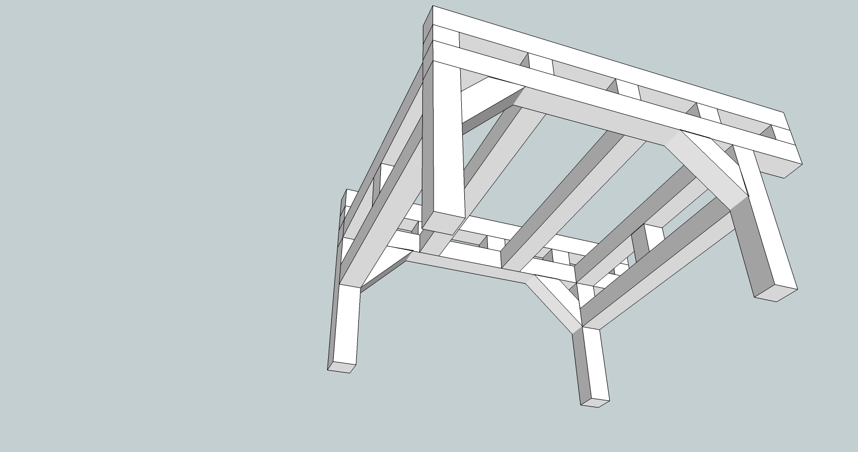

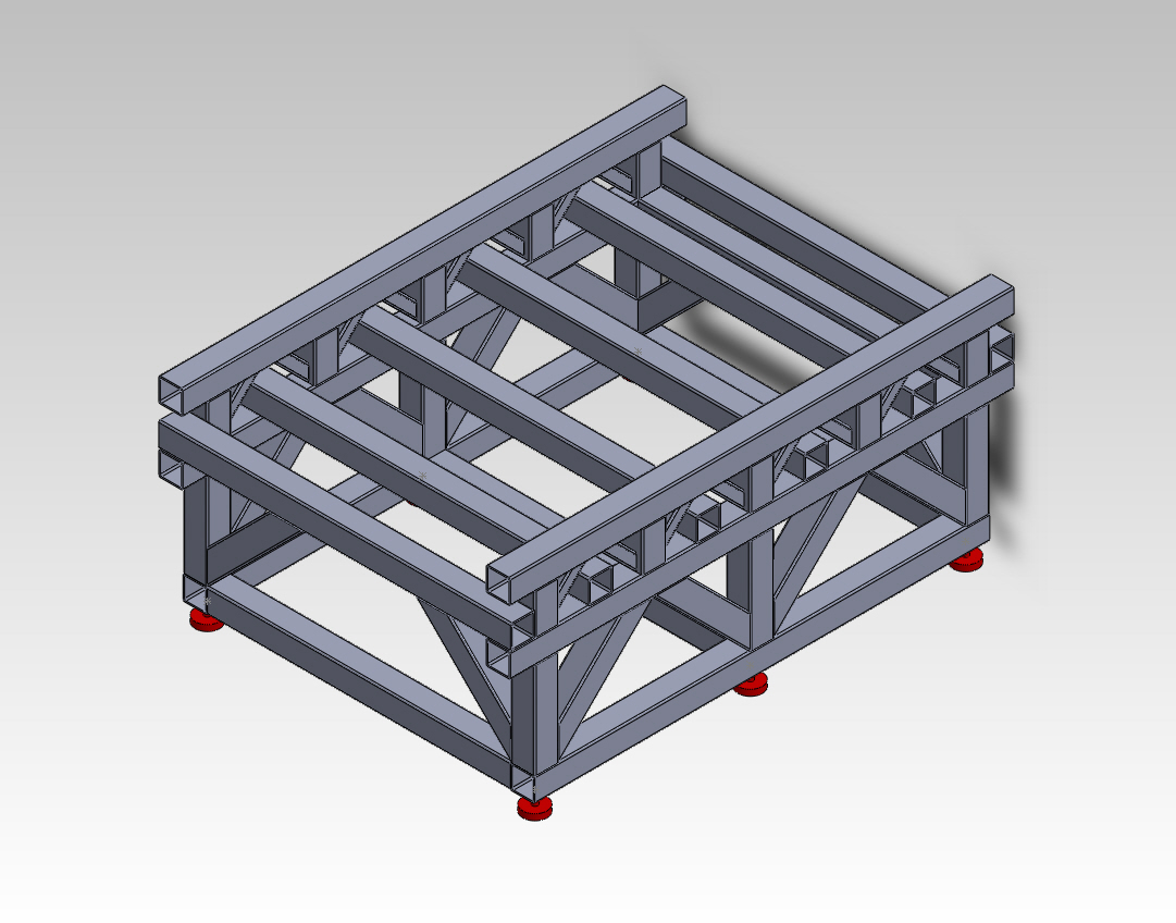

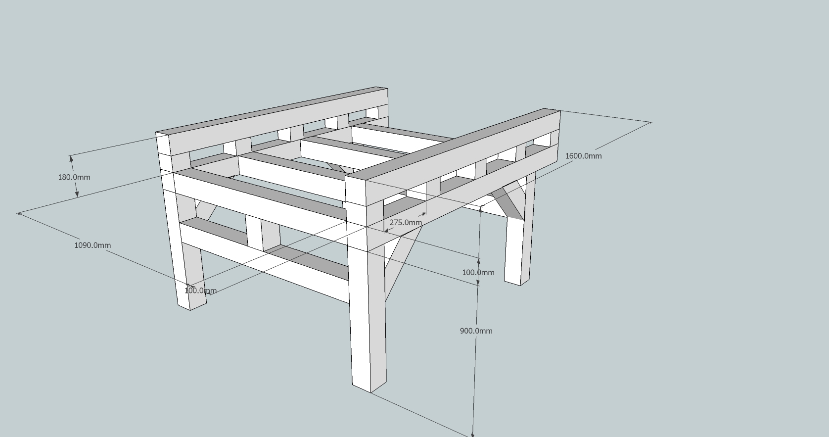

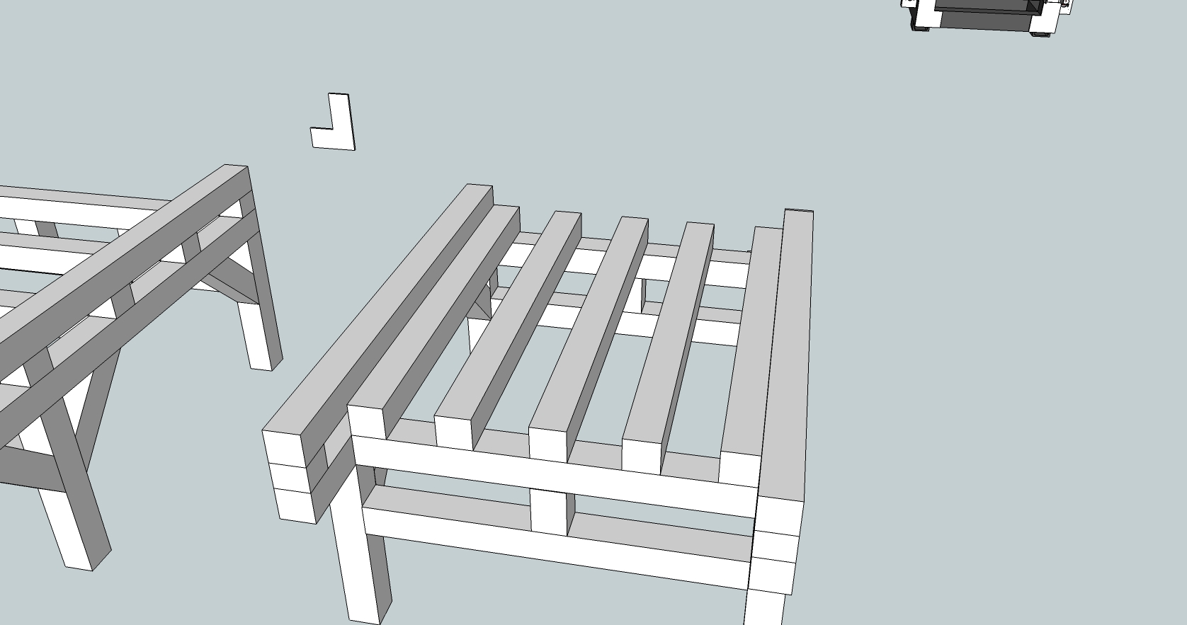

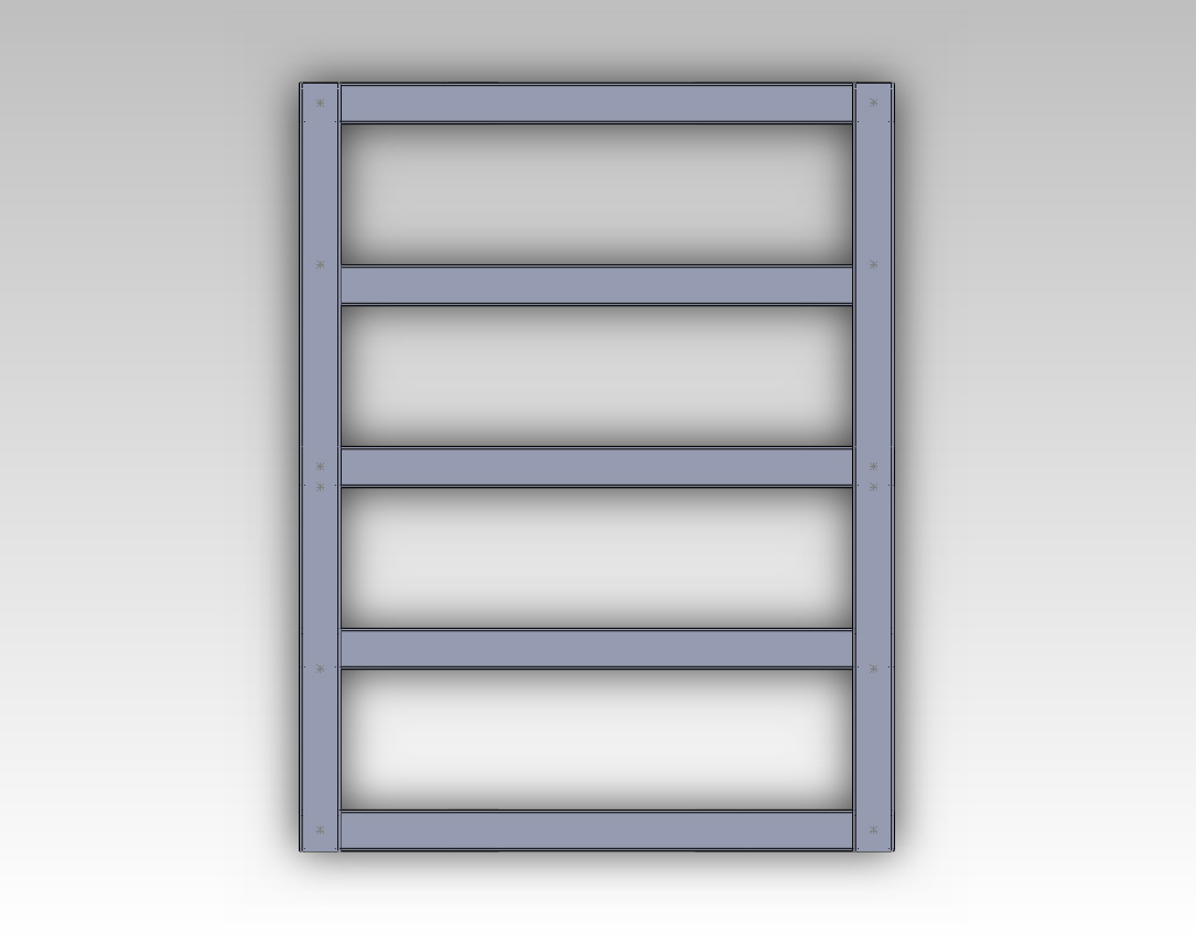

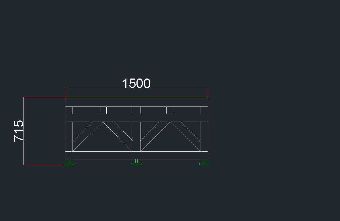

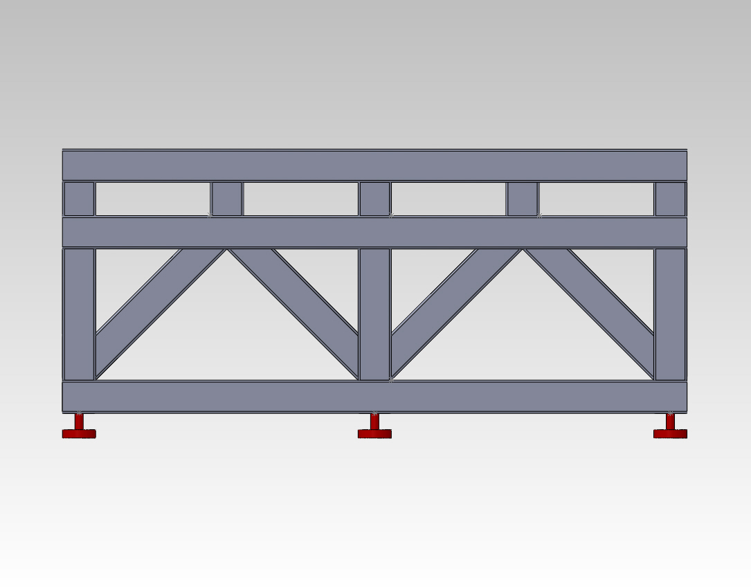

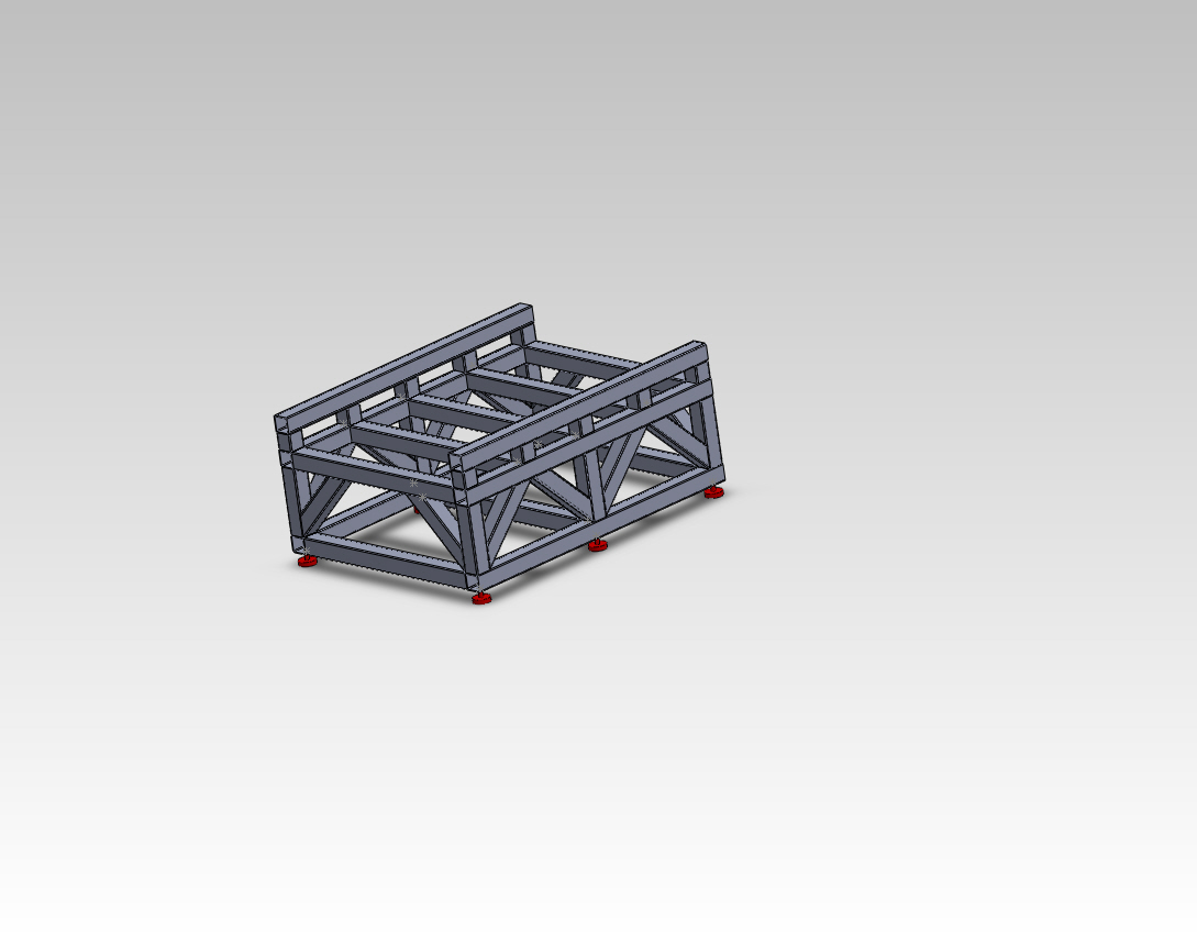

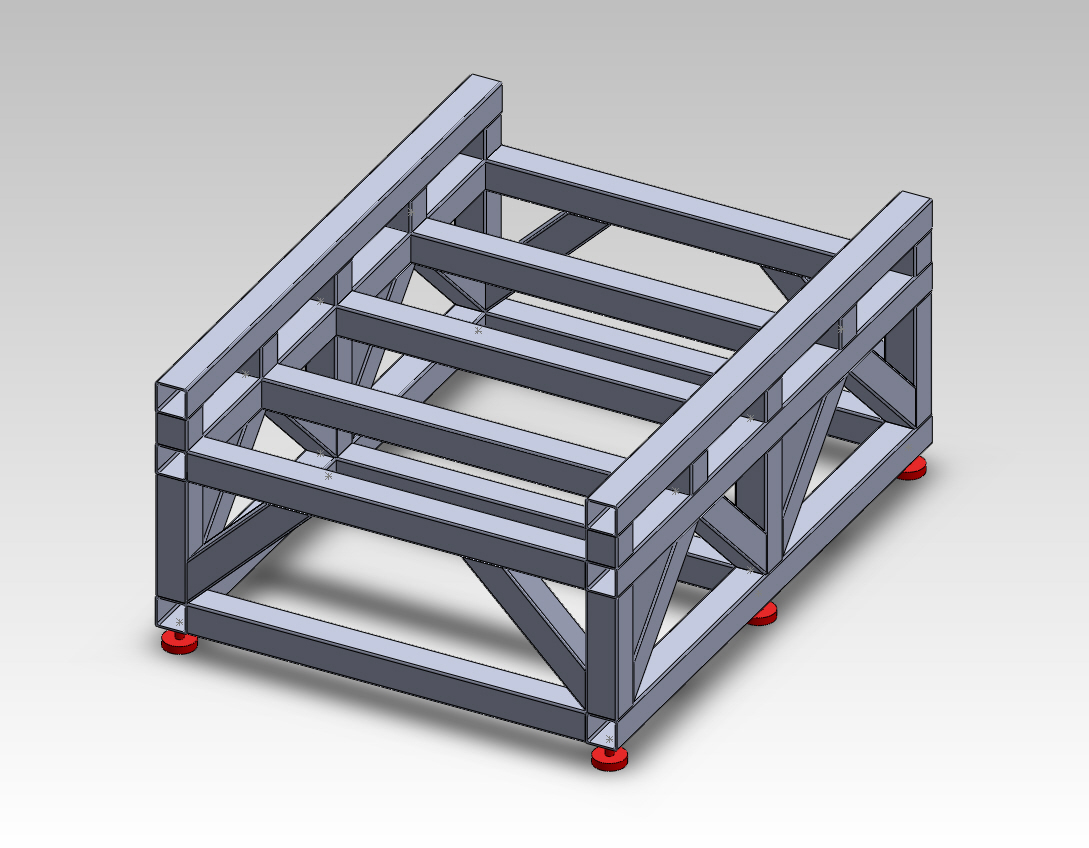

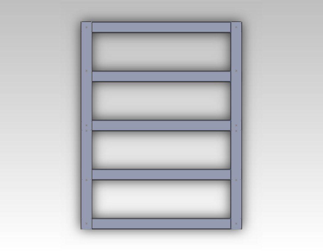

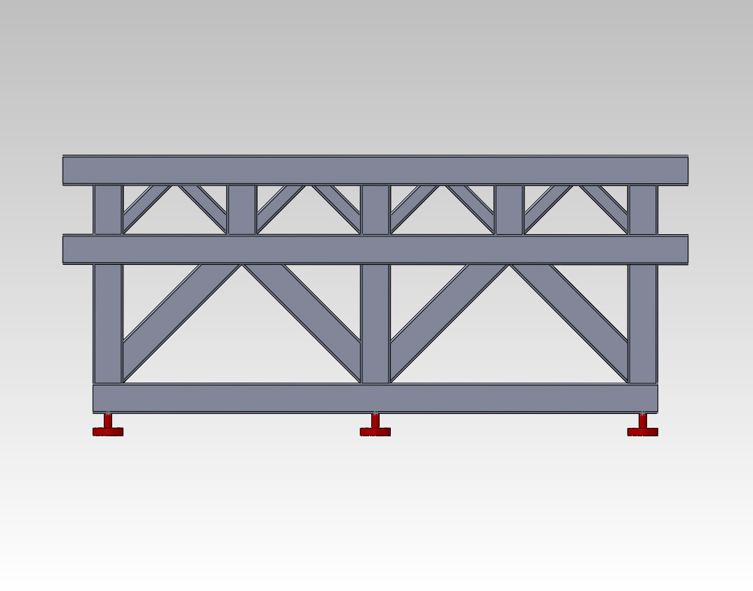

Hi Everybody
My name is Vagelis and I am from Greece
I would like your advice and your opinion on the plans below.
Involving a cnc (1500mm x 1000mm) which
will runs with Yaskawa servo 400 watt
Supported profiled rails 20mm, ballscrews X, Y 20mm Z 16mm
Spindle 2,2 KW water cooled
The following plans have to do with the table
I want to make something stiff and adjustable
The main table is made with 80X80 5mm square tube and the X axis rails will be placed on two ( each side ) I beams. The one I beam (120mm height) will be welded on the table and the above will be adjustable up-down left-right with screws. Before i go on with the plans i think that it will be good to get some opinions from the "experts" as i am amateur at cnc constructions ( sory for my english).
My main concern is if I beam is suitable for this purpose, or it is better to go with 120X60 5mm tube
The cutting surface will also be adjustable from the brown L shape angle that can be moved up and down.
Thanks everybody for your time

Vagelis,
I am an amateur like yourself but have recently read a lot of information about cnc machines. I am designing a frame myself at the moment using 50x50x3 steel box section, my work area will be about 1000x650.
You see where you have two crosses in the side panels, I think if you had just 2 diagonals like this I/I\I it would be enough because you just need to create a triangle. For your size machine I would say the 80x80x5 might be more than you need but if you are fine with that then more is better than less. The I beams I would change for box section because I beams are not so good with twisting and you might get more sideways twist than you would with box section. Also you have not put any diagonals at the ends like you did with the sides. Good things you have included are 3 legs each side, adjustable feet, adjustable top I beam to get the top surface straight. Looking at the drawing, I can't see much adjustment on the brown angle and wonder if it's worth it other than making sure the table is the same height under the cutter across all of the table.

In my opinion your legs are overbuild and the rails support underbuild.
The I beams are bad idea.

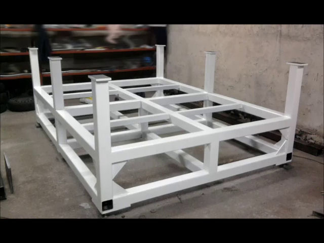

After a lot of thoughts and considerations for me:
-a whole machine build from 80x80x3mm with a careful design could be the best solution for a DIY sturdy CNC
-a whole machine build from 100x100x3mm with careful design could be a real beast of a DIY extremely sturdy CNC
The people who build with more than 3mm thickness either have a design which is not so perfect or are pro builders who know what they are doing and definitely its not their first machine, usually some beast with a special heavy duty purpose
It would be nice if you take your time and read the entire Tony CNC build here where he started with similar to yours idea, the calculations of the price and weight, how he implemented and personalized the design from another build of mine adjusting to his dimensions and needs.
More or less i could say that the particular design of mine could hardly be beaten for strength, weight and $$$ combination, permitting the final result to be extremely sturdy CNC with deep 160-200mm Z travel.
The trade offs are that it is better to be all soldered and adjust the table bed by fitting thick table bed instead of raising and lowering the bed structure itself.
The plus is that its very easy to cut to size, one profile only, cheap, very easy to solder precisely and completely scalelable from small to big machine.
the gantry could be made from 2 profiles soldered together so finally will be 200x100 or 160x80, which both a are great and in the ideal range for 20 size supported rails
Its not tested on a finished machine, but i am currently building one and can assure you is steady like a rock. If you scale it, mind the distances between every element and don't change them, just add or take elements to make it bigger or smaller.
Its deceivingly simple but many things are taken into consideration.
Hope that it helps.

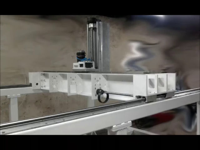

My advice is when comparing designs take the calculator and see the KG and what you receive for these KG in strength. Then compare. Every KG is an euro :encouragement:
Attachment 10413
PS. FYI just went in the garage and measured the deflection of my machine under 100kg weight/me/. Its very similar, with different measures. Table bed is 67cm wide and is 135cm long. So stepping on any of one the table bed beams gave me 0.05mm deflection of that beam and stepping on any of the sides that that support the gantry/supported at both ends only/ gave me 0.03mm deflection. So keeping the design and not under doing something when everything mounted will give you real life deflection which is unmeasurable/or for sure less than 0.05mm/ . So my machine with mine particular dimensiones with table bead mounted will have over all deflection of less than 0.01mm. isnt it great?
Re: Stell frame cnc 1500X1000. Adjustable table your opinion please
Thanks everybody for your advices
The basic conclusion is that I should replace the I beam with square profile. That was what I have in mind from the beginning. The reason that I choose I beam for the drivers support, was because it was easier to connect the two I beams ( upper and lower ) with bolt and nuts in order to have a fully adjustable table.
The plan that you suggest me to make Syliavski looks very strong and stiff. My question is how am I going to adjust that table if I have imperfections as cause of arc welding. The basic advantage of arc welding is the stiffness, on the other hand if I only weld and have no ability to adjust with bolts, I think is more than sure that my X axis rails wont be on the same plane. So I think that I will keep the solution of the bolt adjustment an replace the I beams with 80X80X3 or 4mmsquare beam. The Chinese says 1 picture 1000 words, I will design it and I will come back. Meanwhile I will be glad to hear any suggestion.

Hi Vangelis
- between 80x80x3 and 4mm, the best choice is or 80x80x3 or 100x100x3 .
Why?
80x80x3 1m=7.17kg/m
80x80x4 1m=9.47kg/m
100x100x3 1m=9.02kg/m
Looking at their properties from my suppliers brochure the conclusion is that roughly the second is 20% stiffer than first and the third is at least double stiffer, hence for the same weight ~9.kg the 100x100 x3 will make quite stiffer machine structure

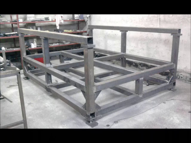

About soldering:
With careful thinking and careful soldering and only 2 big clamps i achieved a structure where not only is up to the mm precise but the beams are on one level and the supporting beams are on one level too. Nevertheless i will use Epoxy to level bellow the supported rails. As suggested by fellow members here i bought West system Epoxy with Hardener
from dansonmarine.co.uk who will ship in europe, contact them.
1kg of 105 resin and .33kg of 209 hardner, £45.00 per pack +£17 to Spain
Delivery is £17.00 to spain
It took me a whole day to weld it and i would not go other way. You can do it with a helper, 2 or even better 4 big clamps and a 2m aluminum profile or a real straight edge.
there is an procedure that has to befollowed, check my build or if you dont understand i will explain later.But mostly it consist of designing and welding "stair like" the individual assemblies, which at the end are soldered together in a "stair like" fashion. That means left and right part of the table should be finished first and then connected as suggested above.

Hello Vagelis,
Following your PM I did see this thread and forgot to post Sorry.
First Agree with Silyavski that your double I-beam design is bad idea and would drop it like hot potato.
Also agree that a fully welded Bed is slightly stronger but it doesn't allow easy adjustment if you need large items and having raising platforms like suggested can be inconvenient and take up space for storage.!
To decide which best suits your needs then you'll have to consider closely what your cutting needs are.? . .If you only plan to raise the bed to say just cut Aluminium so bringing table surface closer to spindle a fixed amount every time then go with the fixed bed and build raising platform to suit. (If you have room to store it.!!)
But if you what to cut a range of material thickness's then adjustable bed is the better option. If designed correctly and built strong then the strength difference is negligible for most cutting conditions except really heavy duty or very hard materials, In which case you have probably built the wrong design machine.!!
Now regards the table Bed and getting it parallel to the cutter then don't worry this is not a problem.? Because every time you move the bed or in Fixed bed case Add the raiser block you MUST surface the table to be sure it's parallel to Cutter.
This also means it doesn't matter if the adjustable table isn't perfectly level or even in twist because after being surfaced it will be parallel to cutter and thats all that matters.
NOW what is VERY VERY important is that the X axis~(long axis) rails are on the same plane and not in twist.!! This is where all your efforts need to be concentrated on getting correct. The Bed could be Banana shaped and slopping at an angle it doesn't matter because after surfacing it will be flat and parallel to cutter BUT ONLY if the X axis rails are on the same plane. Any errors in this department affect the whole machine.
Several ways to ensure this but really only 2 that are realistic to the DIY builder. These are Epoxy levelling or adjustable top rail and careful measurement.
Epoxy is probably the easiest because it doesn't require accurate straight edges or equipment.! It's just more time consuming because of prep to surface to ensure clean and setting up dam walls and bridge etc . . .Plus it's messy and requires clean up afterwards!.
Thou For first time builder then I'd probably suggest taking Epoxy route has it's easier to ensure rails are on same plane and doesn't require machines to ensure top rail is surfaced flat.

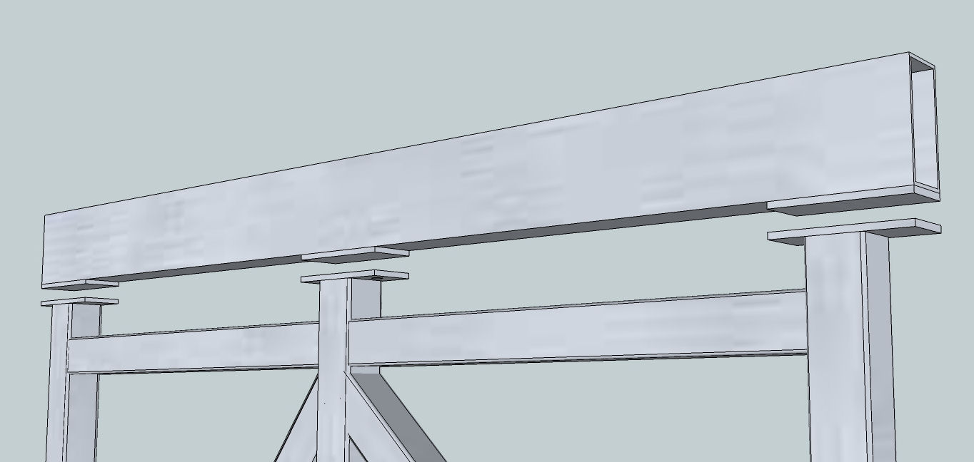

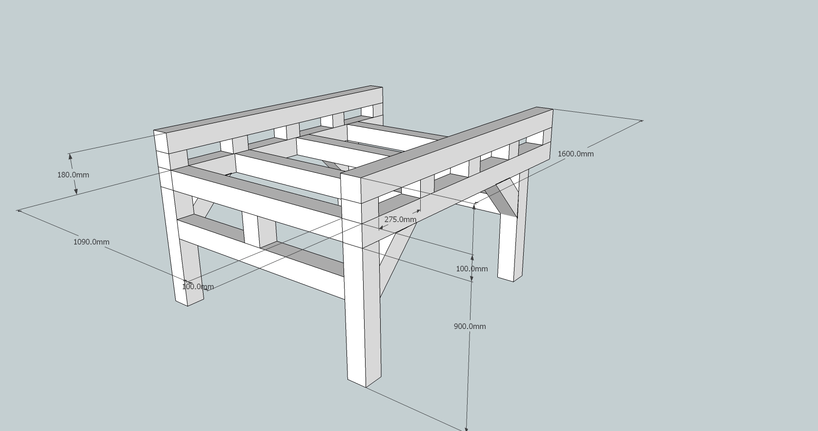

This is how I plan to do my top rail.
legs 50x50x3 steel box
top rail 100x50x3 steel box
6mm or maybe 10mm plates welded on top of the legs and welded to the underside of the top rail.
Bolts will pass through the plates on the legs and will screw into threaded holes in the top rail plates and right through into the box.
These joints will be shimmed to level the top surface of the rail and to ensure both sides are in the same plane.
Before bolting the pieces together I will grind the surfaces of the plates flat, checking with a straight edge
It would be easy to weld 2 further intermediate points if this found to be flexing.
Attachment 10440

First of all thanks everybody for the participation to the thread.
Next i would like to introduce some of my conclusions and ask some things about all these that i have already read
1. I beam will not be used
2. For the rails support beams I am between these profiles
80X80 4 mm
80X80 5 mm
100X100 4 mm
100X100 5 mm
and for the table structure
80X80 4 mm or
80X80 5 mm
i want your advice

3 Attachment(s)
Just grabbed these out of a video I saw if any use
Attachment 10447Attachment 10448Attachment 10449
details are here 3D Model of CNC Router c4d, obj, 3ds, fbx, dxf, skp, iges
and it looks like they had to add some triangulation to the legs after these photos

Here are some autocad plans. They represent side view of X axis. I design 4 solutions ( A,B,C,D )
The upper yellow line represents profiled rails, and the green color is adjustable legs
Tell me your opinion.
I haven’t decide yet if i will go with 80X80 or 100X100 box section. It depends from the cost. The following plans are made with 80X80 box section
Thanks for your time
Attachment 10509
I like B but not everyone will
I like A but if i were you, would turn the 4 diagonals 180 degree/ mirror them upside. That will separate on smaller sections and support even further the X rails support + when pushed from upside will make a stretching force to the lower beam, not pushing, as it is now.
I mean instead of MM WW
If full height is desired, as Eddy says B is best, simple and strong + the diagonals will stretch again the lower beam, if pushed from above. And we all know steel can not be stretched:victorious:
6 Attachment(s)
Silyavski before i check for any new post at my thread i design in autocad this
Attachment 10510
and then i read your post
I think that we are thinking in the same way
To be honest you inspire me for my table plan ( especialy for the rail support beams ) thank you.
Aslo thanks everybody else like Eddycurrent and of course Dean for their ideas
Day after day, thread after thread post after post i feel that the knowledge and the experience of people that willing to help, give me the ability to make a solid machine. You know it is very important to make a step and have no question to be answered. That is what i almost fell now about the table plan. May be some small changes will be done, but the basic consept i think is this.
I will post 3d plans soon
PS A machine that is having rail height at 70 cm from the ground, has any disadvantage compared to a machine that is having rail height at 90-100 cm from the ground?
I will be happy to hear any other advice.
The only question that is waiting for answer is the beam dimensions 80X80 or 100X100 and of cource the thickness
And here i have some 3d plans.
I will come back with another plan a little bit different
Attachment 10512Attachment 10513Attachment 10514Attachment 10515Attachment 10516
It will work both with 100x100x3 and 80x80x 3 or 4mm. Depends on how strong would be your gantry, what spindle you will like to mount and how further you will like to push it.
I suggest you make your gantry from 2 pieces of the same profile you will use soldered together, hence 200x100 or 160x80 or do it from aluminum, the way Dean makes his machines, with a ball screw hidden in the gantry, depends what means you have.
The drawings look very good. Now if you aim at certain weight or to be able to pass through normal 1m wide door, don't make it higher . if you want to make it higher and at the same time light, just make the legs longer. Also if length, weight is a problem, you can lift the 4 lower beams to the middle of the M , and remove the middle leg below this point, this will not compromise the strength.
If you aim aluminum and hard stuff mainly, maybe a gantry like Jonathans will be better, look at his exemplary build

After hours of design i come back with 3 final (!!!!) plans.
Plan A
( i have already post it but i repost it near the other two plans )
It is the most simple within the other two and also needs the less steel
Attachment 10527Attachment 10528Attachment 10526Attachment 10529
Plan B
It is the heaviest within the other two
The difference with A is that the beams of the cutting table are lieing between the two X axis rails support beams. It also have extra 40X40 beams for reinforcing X rails beams
Attachment 10532Attachment 10530Attachment 10531Attachment 10533
Plan C
Attachment 10536Attachment 10534Attachment 10535Attachment 10537
This plan combines A with B. The beams of the cutting table have been welded as plan A and the reinforcing of X axis beams is as plan B
All plans are made with 80X80 box section steel. Plan B and C also have 40X40 diagonal box section between X axis rails support beams
I am waiting for your advices
Thank you
Plan A must be strong enough for this size machine. I know that silyavski likes to have the horizontal beams supported at 2 points like your end view but you loose the triangle in the middle and that is not good.
Also where there are no diagonals or triangular pieces on the cutting table to stop it twisting.
Having said that it will still be very strong if you make it like the drawing.
If you notice all the three plans carefully you will se that the x rails supported beams have contact with the ground at 3 points not 2. It is possible you get confused between the side and the front view.
At the side view you can see that every pair of supported rail beams has straight contact in the middle with the groun as my plan have 3 ( red ) foot at every side.
From left to right i upload Isometric-Top-Front-Side view for every plan
You are right about the diagonals. I will put them to the plan. Thanks for your advice
Is there any need for the bars connecting the legs at the bottom. I'm constructing mine at the moment, interested in the replies.
alex wight
Alex, that is a very good point. I think the only reason they are in there is to provide a means of adding triangulation support in the horizontal plane at ground level ( i.e. some metal to weld the triangulation members on to) but if enough triangulation was put into the cutting bed maybe that would be enough ? I'm also at this stage in my build log and reluctant to start cutting the metal yet as I feel the best solution has not yet been reached.
ba99297, I was referring to the front view, the dark colour one.
I've built one of my sides, roughly the same design, but without the material connecting the legs. As there's angled supports at the top, it should be strong enough. It's had the go ahead, so I'm happy to continue with the other side.
alex wight
Actually no need, that's what i said before. Or they cut be cut in 2 and raised higher at the middle of the M, that's what i suggested before.
With 80x80 profile or bigger the machine will not twist , so no need for triangulation on the bed itself. remember that the spoilboard willnot permit eventual twist there.
However for the sake of absolute rigidity i would have soldered additional plate vertically along the center beam of the bed itself , that will strengthen immensely the bed
PS. option 1 looks perfect
9 Attachment(s)
Any of these are strong enough but the design can be simplified regards building and be just has strong. No time at moment to get into full debate about why etc but here's frame I've drawn that's similar.
Main points are the sides and Bed are welded flat has separate units then joined together with end braces etc. The Bed being a separate unit means the outer frame pieces support the bed material at the edges, the way yours is drawn the edges will be unsupported and could bend or flex under cutting conditions.
Lower diagonal braces help keep machine frame square and stiff, remember it's not just strength you have to consider there's resonances to deal with and bracing helps reduce resonance.
Welding major parts in sections on a bench then either welding or bolting together is much easier than struggling trying to weld individual pieces together and keep every thing sqaure and flat, aligned etc.
One other note.!! On this design the top rail extends.? This is to make full use of the Bed without wasting material having the bed/frame longer than needed which can't be used.

2 Attachment(s)
Deans design is very good, after all he is far more experienced at building and dealing with vibrations. I like the Z at the baze, that would definitely help with resonance. I like the extra bed frame, i have thought it but never included it in my designs, due to extra weight.
Dont get me wrong on what i will say, but i am fan of simplicity. I will say the same what i said to Tony at his thread
Look at that design below and adjust it to your needs if you like it. Just don't change anything radically, cause in its deceiving simplicity there is a lot of reason. In fact 2-3 months of reasoning. There are no random distances there. Tony changed it a bit and you can see his great looking machine. He made it from 80x80, mine is 100x100x3
If you look at my thread i have a frame soldered in my garage with the same design and it has deflection under 100kg of load which is irrelevant.
Now what Dean says about resonance is true. Its not the same as stiffness. In fact in some cases the stiffness will help the resonance, especially in our case where we build machines from thin walled profiles.The great thing about my design is that all the forces are working only at the upper part of the structure, its stiffness does not depend at all of lower elements. The legs are just legs / i am talking about 100x100 or short 80x80/.
Now there are hundreds of points why resonance will not happen at all in the machine i am building, nor twist or bending, even if i were able to route deep aluminum and why not steel / which will not happen cause i limited it with 0.8kw spindle/ . This points are too long to explain, but be careful, cause these are particular decisions, like that the machine i am building will have 100mm thick MDF bead, underneath plastic sheet or aluminum sheet and etc...
Long story short, just take a look and study it. Use it if you like it. It implement Deans idea of the shorter table. Also implements subtle ways of dealing with resonance, like the beams of the bed gradually don't coincide with the short vertical ones. In fact in my next build everything will be slightly offset here and there, to kill the harmonics.
The best thing is if like Dean says the bed beams flex, at a later time can be added ribs bolted to them vertically and if there is a twist , you can add the same Z diagonals like in Deans drawing of the lower part just drilling from below and bolting. Add if when you need, why overbuild now? Not to speak of that with 100x100 profile is way overbuild as my measurements show on my build.

silyavski
Exactly my plan, if there are problems later the frame can always be upgraded.

So in conclusion/my conclusion i mean :joker:/ , if maximum flexibility and at the same time rigidity for heavy duty aluminum jobs is wanted there are only 3 ways to go:
- Make a specific purpose machine from the beginning like Jonathan did for his friend, with removable bed
or if larger machine is desired:
-make a machine similar to how Dean does them, with removable adjustable bed and bottom frame structure
-make a machine the way i propose and use additional bolted beams to raise the bed or lower it, look at the picture below
In these both cases, at the end the material we use is roughly the same. main point in my design being limited space, so the legs can be removed without compromising the integrity of the design and having to redraw it again.
Attachment 10563
Of course that design can be further developed with cost savings in mind. For example the middle 2 beams from the lower bed can be made dis-mountable, so they can be used for the upper bed and so on... Look picture below.
Thats what i like about the constructive discussion. makes me think and develop. The idea of the removable 2 beams just made me realize what savings that would be on my next 1250x2500 design
Attachment 10567
Excuse me Dean but i don’t understand why my cutting table has unsupported edges. At every plan the cutting table beams are welded at the side pieces. Could you please make it more clear?
Ba99274 any of the frames shown including your own designs will be good enough so don't worry you won't go wrong.
Thank for your good words. The truth is that i don’t have time pressure. When i make a step i want to be sure about what i am going to do
I am searching over the internet for this construction about a year
The last few months although i thought i knew very much about the subject i find out that mycncuk exist
The answers that i take from the members make me change many of my thoughts
For example i didn’t know that the ball screws have critical speed. My first plan was to connect the motors straight to the ballscrews. Imagine how i would fell when i broke a ballscrew 1500 long running at 3000 rpm. I also thought that I beam is the strongest type of beam..... ( May be for vertical forces )
So every day someone in here give me an advice or correct me, i fell happy about avoiding another mistake

Since it's already been said that most of the frame designs posted here would be more than adequate, I'll just highlight some general points which may be useful.
I think the frame design silyavski posted in post #30 is well thought out since, among other things, it makes relatively efficient use of material. I'd be inclined to swap the two 100x100mm beams and 80mm spacers with a single piece, perhaps 200x100mm possibly with a higher wall thickness than the rest (or scaled down accordingly if making the rest of the frame from smaller sections). This will obtain a similar stiffness to the original, but reduces the number of pieces to cut by 12 and the number of welded joints is reduced by 20. This would save a lot of time and reduce residual stresses due to there being less welding. Clearly it may not be as cost effective as making the whole frame from the same size material.
Something else to bear in mind is that increasing the size of the steel you use can sometimes make the structure strong enough, with a lot less work than adding lots of small supporting pieces and without necessarily increasing the cost. For example, if you have a piece of 60mm box section with 3mm wall thickness supported at both ends, then in general increasing it to a 80mm beam of the same wall thickness will reduce the deflection to less than 2.4 times the original.
Also, it's better to increase the size of the beam (within reason), than to increase the wall thickness. Continuing with the previous example, the 80mm beam will cost about 33% (assuming it's priced by mass) more than the 60mm beam, so suppose you instead invested that 33% extra in getting a 60mm box section with 3mm thickness to match the weight of the 80mm beam. Both sections will cost about the same, however the 60mm beam is still only just over half as strong as the 80mm, as you've only made it about 33% stronger (not 240% as above). The reason for this is that increasing the wall thickness only gets a linear gain (y=k*x) in strength, compared to a quartic (y=k*x^4) relationship from increasing the size. So in general, you only use a greater wall thickness when you haven't got space to fit a bigger section.
With regards to resonance, MDF is actually a great material to use for the machine bed as it has such good damping properties. I had a lot less problems with resonance on my machine with the MDF bed than I do now with aluminium. If I'm machining an aluminium part for which the finish is more important than the accuracy, I'll sometimes put a piece of 18mm MDF between the part and the aluminium bed as the MDF damps the vibrations, making the 'sweet spot' to get a good finish a bigger spot.
Jonathan
Well ounce again I'm going to have to disagree.!! . . . Not on the strength basis has that's true but on the fact it's better to use larger.? It's only better if the application warrants it and in this case it doesn't. The thicker wall thickness will be more beneficial because it will be less resonant, going Larger on the tube size just increases resonance. For this application then 60mm tube will be more than strong enough so strength isn't a problem so any extra efforts to improve would be better focused on reducing resonance and going thicker on the wall would help here.
Jonathan
Oh dear again I'm disagreeing. . Lol . . I don't have any problems with my aluminium bed and differing finish.? I get the same finish regardless of whether I'm working direct on bed or on any other sacrificial surface. If your bed is affecting finish then reckon you've under built it or your clamping methods are poor.!!
If anything I get more trouble when using MDF than I do when working direct on bed because material can slide if cutting deep, direct on the bed I get much better hold down.
Also Poor finish comes mostly from the tool chattering so if your struggling with finish then I'd be looking at the machine strength and resonance, hence why I put more importance on material Thickness than Size when it comes to steel. (obviously size has to be fit for application)
BA 99297 I'll say it again to be clear "Any of the designs will be strong enough" so if any more focus is needed then I'd direct it to reducing resonance rather than strength.
Oh when I said about unsupported edges I meant you don't have any members to support the Bed base material at the edges. On your designs the edges between table supports won't support the material or any sacrificial material. It may seem a small detail but it can make a difference and for the little extra material/work it's not worth not doing IMO.!

Attachment 10584
Dean or anybody else could you please suggest me a link ( or links) where i can read about resonance dampening basics ( i mean what i should avoid in order to reduce resonance )
So far ( tell me if i am wrong ) i realize that low mass and symmetry amplify resonance is that correct?
Now i understand what you mean but i didn’t say that vertically to the table beams i will put t slot aluminium profile ( a friend of mine who makes solar parks on the houses roofs has many meters of them)
