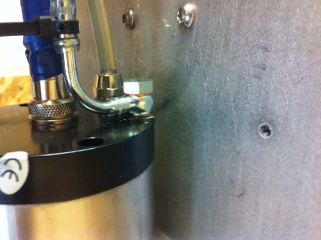

Attachment 9309 just thought id share, I had a problem with a cracked fitting for the water cooling on my spindle and found these things fit and work ok. It's called a banjo and can be found on eBay with the correct thread fitting of m8x1 also makes cableing neater as all the pipes and wires run nearer each other.
