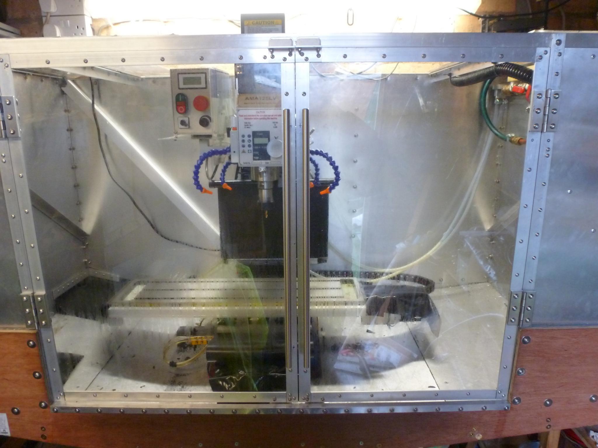

I've only just finished my AMAT25. Hopefully start testing it out this week, time permitting.
Attachment 27621
Attachment 27622
Attachment 27623
Attachment 27624
Attachment 27631
Attachment 27625
Attachment 27626
Attachment 27627
Attachment 27628
Attachment 27629
Attachment 27630
