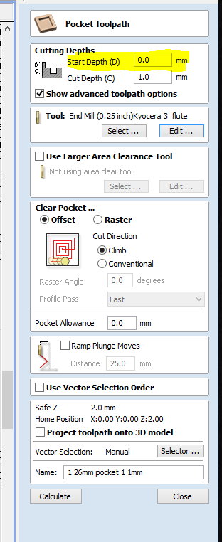

Check this:
Attachment 13233

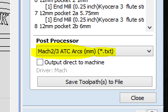

The post processor is this inch or mm with or without the ATC/adds tool change command/ and the out put is txt in both cases, not .nc
Attachment 13234

I wonder if plain G Code in txt will work, even though the PP program suggests .nc extension... Not sure why there is a difference....

My PP file extension needs to be .nc according to the instructions. Not sure if it will accept metric .txt, but I may try.
I'm setting the machine toolpath in "Profile Toolpath"...Do you think I should be using the "Pocket toolpath" instead ? The setings in your picture are the same as the ones I my program too,

Sorry , i though you use mach3. Though you can just rename the file.
There are places that profile is used, there are places where pocket is better, to avoid triangualr and similar small left overs. Though it could take a bit longer.

The file .nc extension will open in notepad. When you click it to open and get the message saying choose software to open with then use notepad and save as default for this file type.
If you create file in note pad then just replace .txt with .nc and it will work. Both are just plain txt files the .nc extension is nothing special it's just the DSP will be looking for .Nc extension. Chances are it will use .txt as well and just defaults to .nc.?
