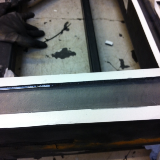

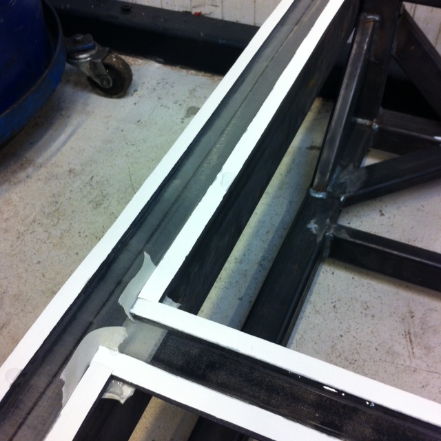

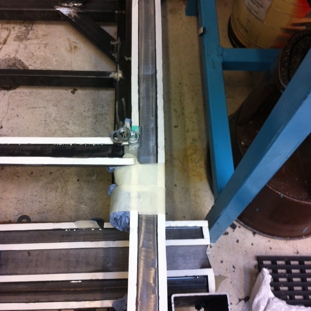

Well I spoke a little too soon. I did press them all down firmly before pouring and still had a couple of leaks. As soon as the epoxy finds a leak path it lifts the draft excluder. Spent 1/2hr chasing 2 leaks...managed to stop them with some blue paper towel and masking tape. After 1/2hr the epoxy is slightly more viscous and stops running (famous last words) as much. Going to check in another 1/2hr to make sure no more is leaking out.

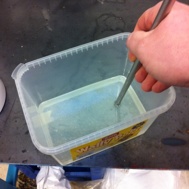

I used 1kg (mixed) for the rails and the gantry. I'd guess the rails are 4-5mm thick and the gantry 2-3mm. The large container (like an ice cream container) I used was ideal as the epoxy didn't get warm at all after mixing. I was quite vigorous in mixing and there were quite a few bubbles but the 7mm hole I drilled in the side of the container coupled with pouring it from about 12" high eliminated nearly all the bubbles. So if you're pouring it do it from a height so it pours in a really thin stream and it gets all the air out. Pics below.

Pity about the leaks, someone posted a video of using epoxy and the idea was to pour a thin layer first, this would both find and plug leaks for the final layer.
The 7mm hole works great, anyway it looks like a great job, nice and flat and clear. Remember to give it plenty of time before bolting the rails on, you don't want it compressing slighty like mine did after 3 days.

Given more time I'd have done it in a couple of pours and spent more time sealing and doing the moat. I'll be leaving it all week to cure (if I can curb my impatience) before doing anything more to it. I've got to cut all the linear rails to length as the X axis are 100mm too long (now wishing I'd extended the rails 100mm further forward but next time...) and the Y & Z are in one length at the moment so that will keep me busy for the next few lunchtimes.

That's cheating but I like his style! Just checked the epoxy and it's stopped leaking as it's now got too viscous to freely flow/run/dribble. It's a nice 24°C in the test bay so should go off nicely...
