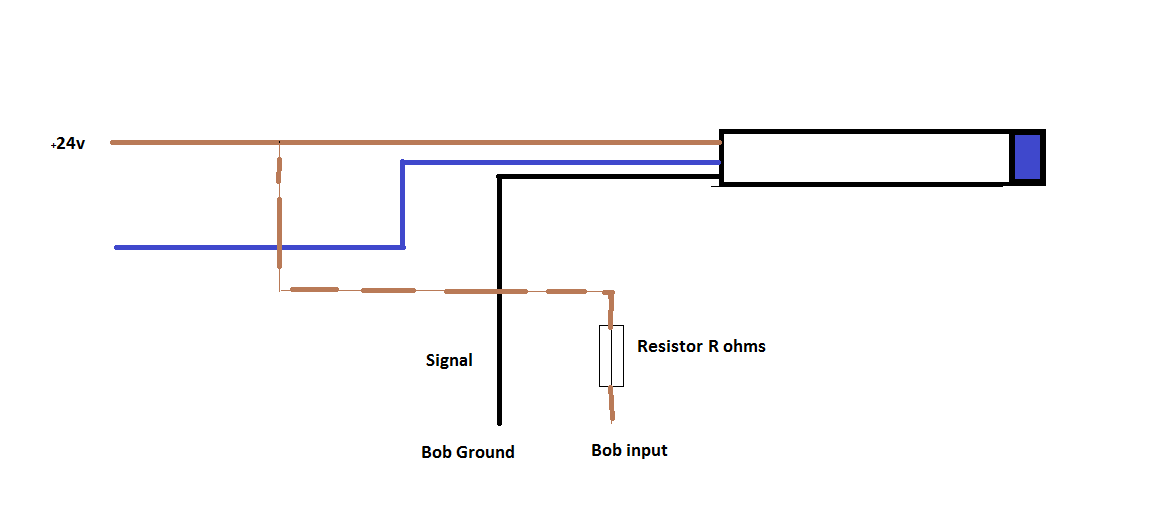

Just in case the OP is still with us and hasn't given up the will to live - this just confirms that your original wiring should be fine if you take out the resistor.
Hi Neale - I'm still here! Just about. But I must be having a brain fade because when I connect the black wire to pin 10, the blue wire to the pin 10 GND, then run a wire back to the -ve 24v supply it buzzes and does'nt work. I checked the GNDS on the ZP5A-INT board (it has a 5v supply from my Leadshine PS408/5 ), all the gnds are connected by doing a continuity check with the BOB unpowered from the -5v pin. I guess I just need to sleep on this and start again tomorrow. I must be missing something in what you guys have said and suffering from a case of "Goldfish brain" :dejection::dejection:

I hope you mean +ve and not -ve.
Best to go back to basics, wire up just the power and gnd to the sensor, and use a multimeter to check that the output is switching. Provided that works, connect it to the BOB.

These proximity switches come in so many flavours. The switch the OP is using switches to ground and an internal resistor makes no sense; the switch in the previous post switches to the supply rail and maybe an internal resistor is more useful.
If you use the NC version of the OP's switches, wired as suggested in series with the BOB input, you can connect a number of them to a single input. I have tested four in series, using 24V and a CSMIO, and that seems to work fine. Using the OP's NO switches, you would have to wire them in parallel but you lose the "fail safe" feature of NC switches.
Hi Neale - I gave up on this for a while but now my machine is working nicely I really do need to get my "fish brain" around this and get the homing set up with these proximity switches so that I can do auto tool setting height etc. So if I understand your post correctly I need to do this as shown in the attached picture
Attachment 22984
Choosing the appropriate value of R drops the voltage down enough for the input and away we go (hopefully!) .
