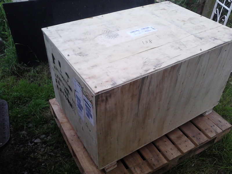

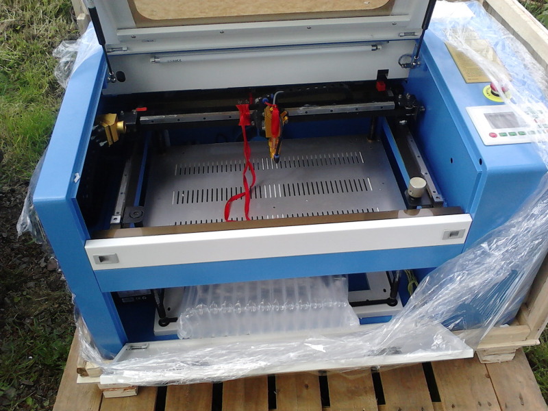

The Box
The pallet it's on is 4' x 4'
Attachment 12367
It was nailed and bolted together with speed bolts.
The top off

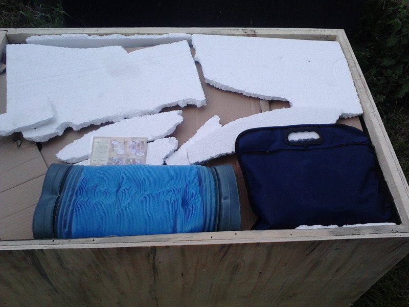

The exhaust pipe is squished ... the bag contains leads manuals software etc...
Attachment 12368
A couple more sides off ...
I opened it up to take out the extras.
The air compressor
The water pump
The rotary table (4th axis)
This reduced the weight a bit
Attachment 12369
Attachment 12370

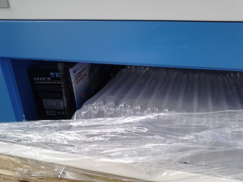

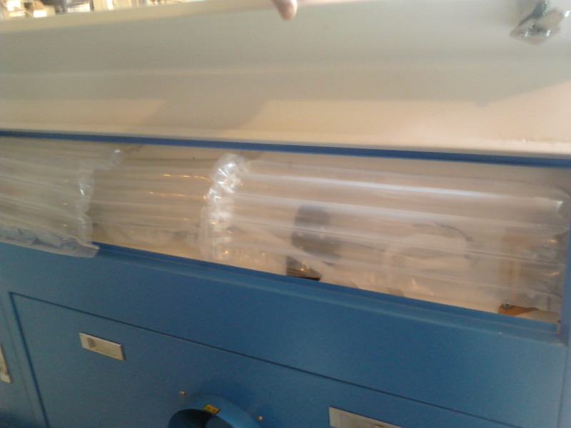

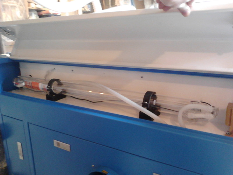

Once in the workshop, the tube compartment ... stuffed with air pocket packing
Attachment 12371
And the tube ... still in one piece :)

Over all I'm very impressed with the build quality , considering it's half priced and Chinese !
The cabinet is well made, powder coated and fits well together.
All the catches and hinges work as they should.
It looks the job !
Happy so far :D

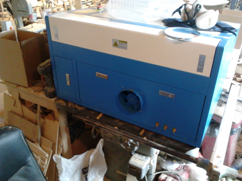

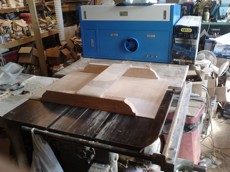

nearly ready to move it to a temporary working place .. at the cost of not having space to work at the mo !
This is it currently sat on my Wadkin table saw .. which isn't small !
Attachment 12375
Re: Laser cutting Machines
hmmmm ... not there either, else I can't use any of my outfeed table !
It really is bigger than I had imagined with a tape measure in my hand ! lol ... doh !!!
Attachment 12376
ok ... this will work for now ... I can use my cross cut sled again :)

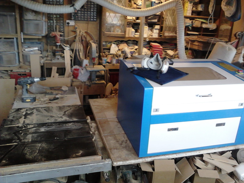

2 Attachment(s)

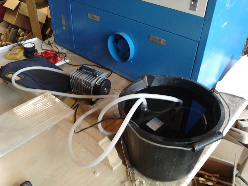

Water pump in bucket and air pump (silent!)
Attachment 12380

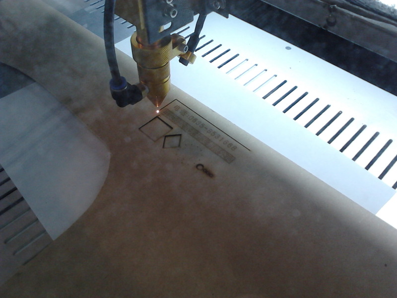

1st test cut ok :)
Attachment 12381
Is just the test pattern in the controller rom..
Cut 4mm MDF in default settings, 6mm in two passes.
I've not calibrated. aligned or focused yet, but all is good so far :)

Cooling !
I'm using the laser a couple og=f hours a day at the mo ..water is typicaly 18deg in the morning. I can get a couple of hours cutting and it's up to 30ged ... which I don't want to go beyond. I have a cheapey thermometer with a temp probe I leave in the bucket.
imeadiate solution .. ice packs or froxen water in bottles .. or bigger bucket.
longer tme solutions .. second hand/freebie/recycled freezer .. modded with tubes/pipes etc.. to keep everything cool ...
will update as and when :)
