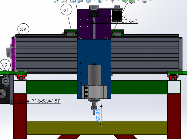

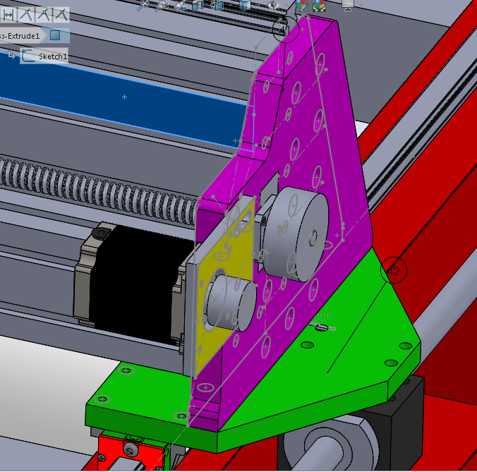

Thanks to every one after many hours of reading here is what I will make.
Here is the final version before starting the build and ordering the parts...
Attachment 18464
the green frame could be made on a bench before the red / yellow...
adjustable mounting of the ends...
Attachment 18465 Attachment 18466
the green plate is 15mm ground plate maybe. i'have found 20mm but is not ground...

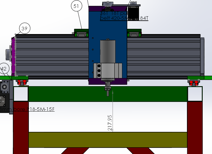

Attachment 18467
between collet and frame (without bed)
218mm Z up an 68 mm Z Down.
Attachment 18468Attachment 18469
Attachment 18470
For the plates 40, 50, 51 supporting the carriage would it be better to have 20mm not ground or 15mm ground ?
Do you have any comments before I start the build ?
Many thanks..
Re: Aluminum profile and alu plate 1500mm x 600mm x 150mm working area, first cnc.
pierantoine
Many thanks..
15 Ground, if you can't machine the mating surfaces.
Orange plate not needed, punch down from plate 51 to the nut (see pic example).
http://uploads.tapatalk-cdn.com/2016...be1b66616c.jpg
Or, if you really want to create a box, punch down from plate 51 to plate XX but make orange plate an X shape, locate nut in the center of the X (less material than current orange plate).
http://uploads.tapatalk-cdn.com/2016...1005bf5759.jpg

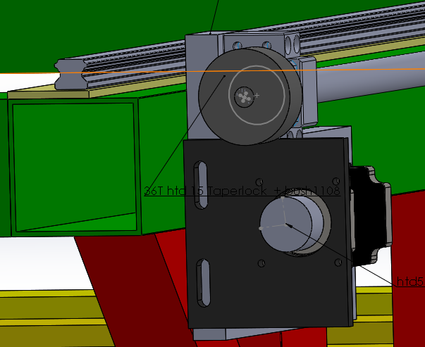

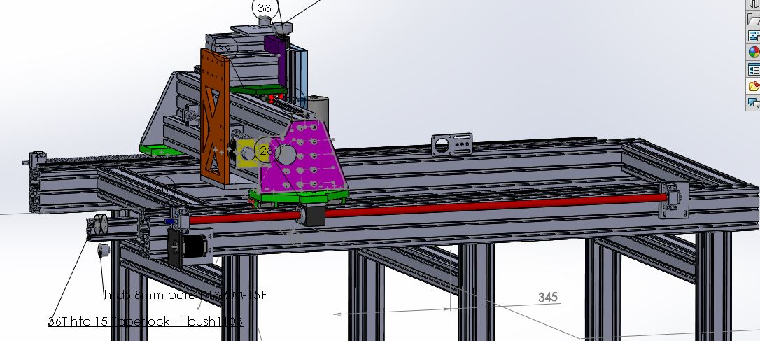

last version with 80x120 aluminium profile.
Attachment 20306
I have shorten the long axis to improve acceleration / whipping
i've read the forum and it seems that for 1500mm rm1610 could be a better choice than 2010 for acceleration reasons. do you agree ?
pierantoine
Yes for acceleration reasons but at that length your still high chance of whip with 16mm screw. And why would you need Higher acceleration than 20mm could provide.?
At this length 20mm is better suited and to improve things more go with 20mm pitch and use 2:1 ratio on the pulleys. Also have Fixed bearings at both ends.
This gives the advantage of lower screw speed and higher torque. The Fixed bearings make everything that little bit stiffer.
Hello Dean ! thanks for your answer, yes both fixed and 2:1 with htd5 15mm was planned with ali pulleys 2 grubscrews and i've seen that you also advises that using Angular Contact Bearing from Fred worth the price so i'll do like that..
pierantoine
Would only use 2:1 ratio with 20mm pitch. If done with 10mm pitch the speed will be too low for router.
Those green bars at front and back are not necessary. Dont worry about them. Its better to be open frame.
JAZZCNC
for info i have nema 24 4nm steppers from cnc4u,
This is my first router it will be used for multicut materials (aluminium, wood, polycarbonate, etc...) and i'm looking for the best resolution before speed, but on the other end i understand that for some materials.. a fast feedrate could be need, so maybe an rm2010 could be an intermediate solution...
1 - we always see Z axis with rm1605, i assume with 1:1 or another ratio ?
2 - For my long axis to get a 1400mm travel i could use a 1550mm rm2010 with an 1:1 ratio but will it work correctly ? (whipping...)
if it wont work wich length would you use maximum ?
3 - If using RM2020 for cutting aluminium do you think i can have a good resolution with a pulley change to something like 4:1
Many thanks for your help..
