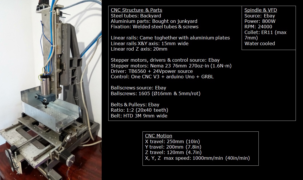

I already had build a 3D printer in 2013, I started to get bored with it, so I start to see some CNC videos on internet about CNC routers and I thanked: I can do it!!!
So I made a little research about homemade CNC's and I find out that I will need:
-Control system
-Stepper motors + drivers
-Transmission (belt's + pulley's)
-Ballscrews
-Linear rail/rods
-Metallic structure
-Spend little money as possible
So after that I went to my backyard and I found some 50*50mm steel tubes, perfect for the structure!
I went to the scrapyard and I found some aluminium tables with 15mm linear rails that looked perfect for X&Y axis and a linear structure with 20mm rod's that was good enough for Z axis.
I searched on ebay and found Nema 23 with 270oz-in with TB6560 driver + 24V power supply and mach 3 interface for a reasonable price.
The belt's and pulley's were ordered from www.bepltd.com, very nice guys, aluminium pulleys with 20&40 teeth for 1:2 ratio and HTD 3M belts, perfect for very small or no backlash.
After some time I found out my computer was not able to connect to Mach 3 interface via LPT1... So was time to search for USB solutions, and i found GRBL.
After that I ordered a One CNC V3 and an Arduino Uno from Ebay, perfect for the job.
After lots of welding, drilling, tappering, ect the cnc was running perfectly, almost squared!!!
At that time I explored the limits of the machine, and i find out that I abused with microsteps. The machine was too precise, too slow and with almost no torque.
Time to do some research:
-Calculation torque Vs microsteps & step/mm to achive resolution Excel link:
https://www.dropbox.com/s/lhz4ht3kh0...ixos.xlsx?dl=0
With this excel I understand why we should not abuse of microstepping, and why is important to choose a pretended resolution to you CNC machine.
An important factor is also driver voltage, TB6560 only are able to have a input voltage of 30V, this is a limitation to achieve max torque at higher stepper motor speed.

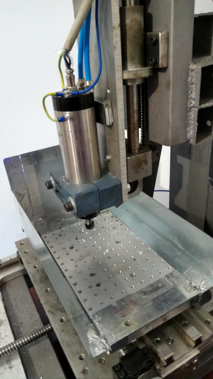

Spindle was a a very difficult choose since I don't really know what the machine can handle, so i went for 0.8kW+VFD chinese spindle water cooled from ebay, now I'm a bit regretted due collect 11 isto small(max 7mm mills).
Material:
CNC Structure & Parts
Steel tubes: Backyard
Aluminium parts: Bought on junkyard
Fixation: Welded steel tubes & screws
Linear rails: Came toghether with aluminium plates
Linear rails X&Y axis: 15mm wide
Linear rod Z axis: 20mm
Stepper motors: Nema 23 76mm 270oz-in (1.6N-m)
Driver: TB6560 + 24Vpower source
Control: One CNC V3 + arduino Uno + GRBL
Ballscrews: 1605 (Ø16mm & 5mm/rot)
Belts & Pulleys:
Ratio: 1:2 (20x40 teeth)
Belt: HTD 3M 9mm wide
Spindle & VFD
Power: 800W
RPM: 24000
Collet: ER11 (max 7mm)
Water cooled
Attachment 23018
Attachment 23019
So enough of talk and lets see the machine working!!
https://youtu.be/tHMQ5T7rxrM
Next steps:
-Add endstops X,Y & Z
-Mill Aluminium Spindle brackets
-Protect rails and ballscrews from chips.
-Make a box for CNC (maybe soundproof)
I know this is not a perfect CNC, but for the first one I'm proud of it!
If you have any idea or improvement please share, Thanks.

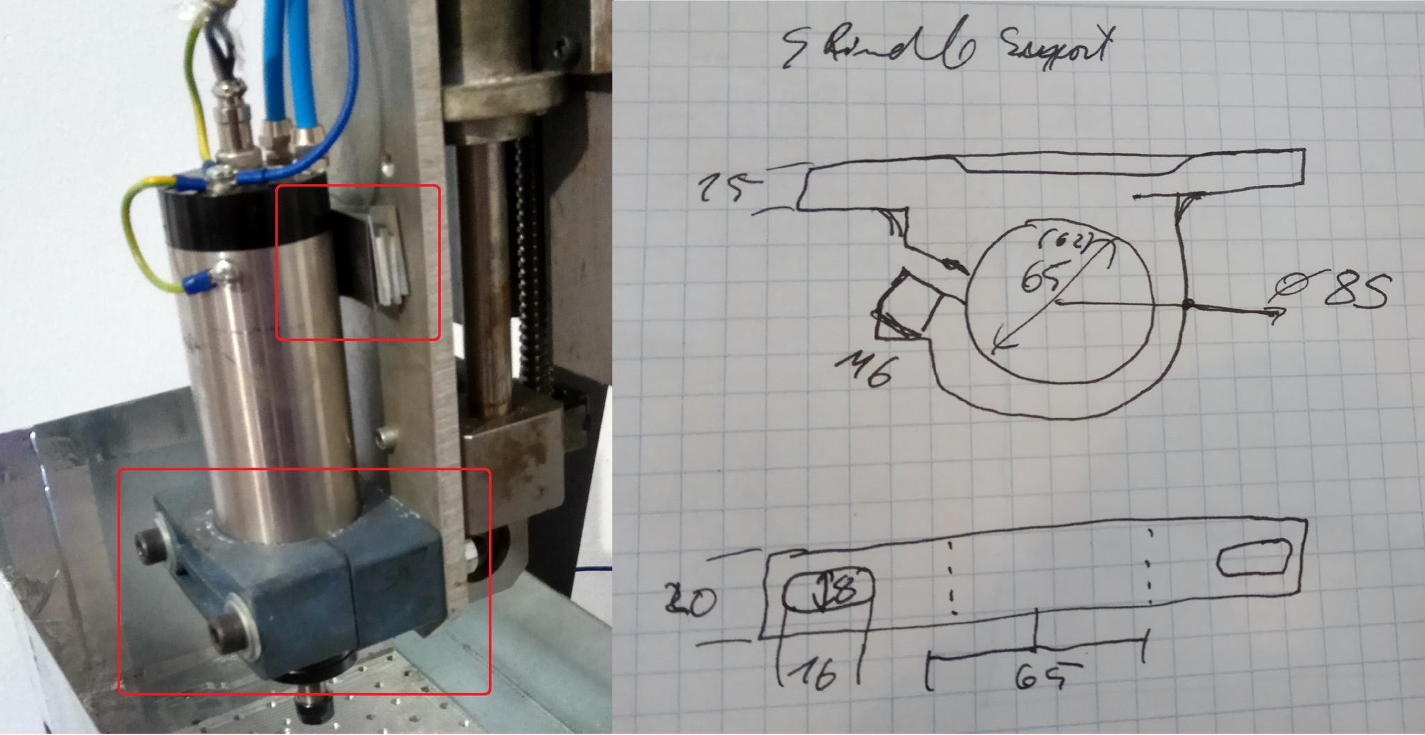

Hello guys,
So I'm doing 2 Aluminium brackets for my 0.8kw spindle.
Attachment 23046
I could do it by milling an aluminum plate, but long time ago I want to make a full video of lost PLA on plaster mold for aluminium casting.
So how I will document this:
Part 1:
-Fusion 360 modeling
-Slic3r Gcode generating
-3D printing
-PLA welding with soldering iron
Part 2:
-Make of plaster mold
-Dry of the mold & melt of PLA
-Aluminium casting
Part 3:
-Fusion 360 CAM
-Mill the aluminium bracket to the spec
Here you have the first video (Part 1/3):
https://youtu.be/C3L2OKaxrOU
Any idea os suggestion?
Thank you

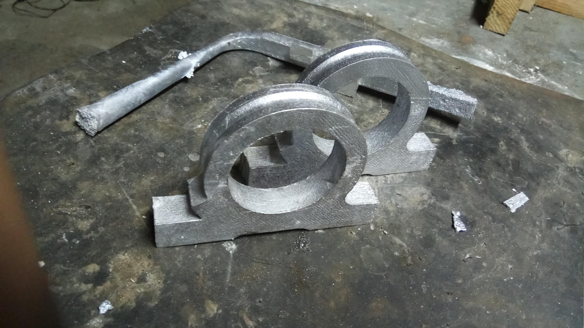

Hello guys,
Today I completed the part 2 of the video, the plaster mold preparation and aluminium casting.
Attachment 23114
https://youtu.be/TYHwJguXLYY
I hope you enjoy.
Thank you

Thanks for the comment!
I tried to mill the parts yesterday with some drawbacks:
-Too much RPM & worn out tool
-New tool with 12k rpm milled the aluminium with goos quality
-M30 at the end of Gcode that broke my carbide tool -_-
The CNC broke the mill with lots of class!
Check the video:
https://youtu.be/HhIX-PMxbrE
Thank you guys.
