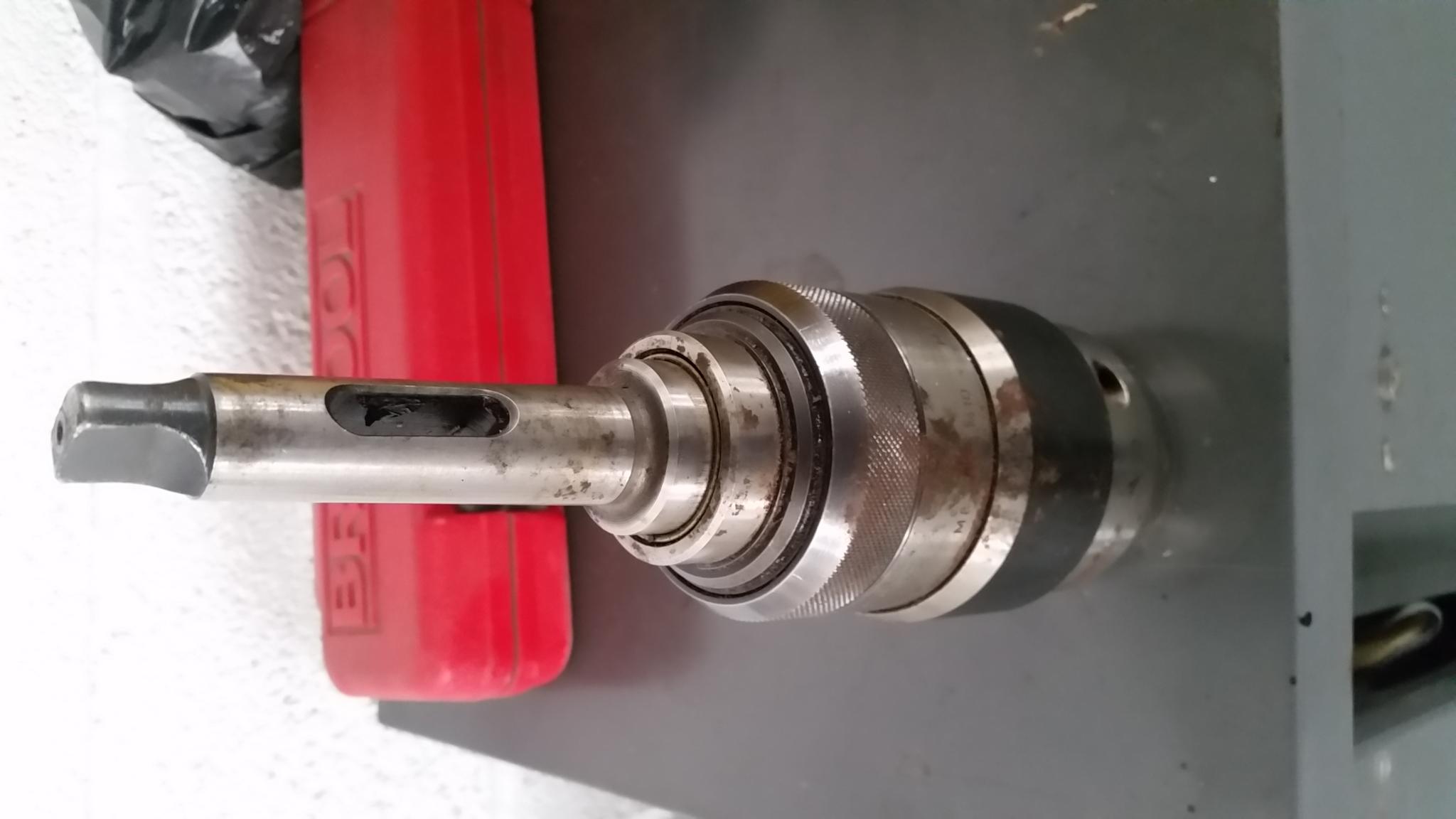

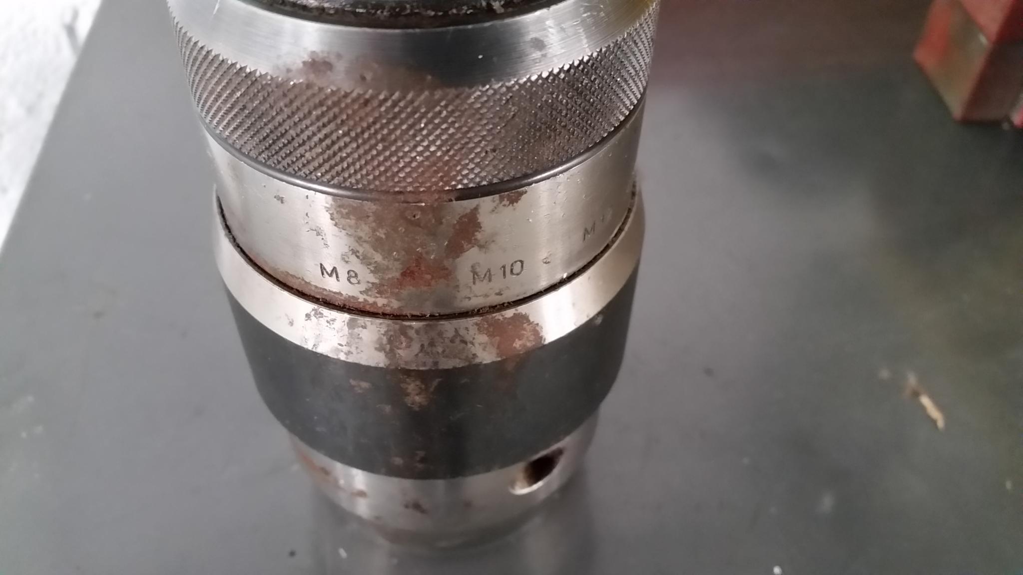

I presume that the below is some sort of tapping head? I've just dug it out of a box of large drill bits...anyone know exactly what it is and how it works?
Attachment 12691Attachment 12692
