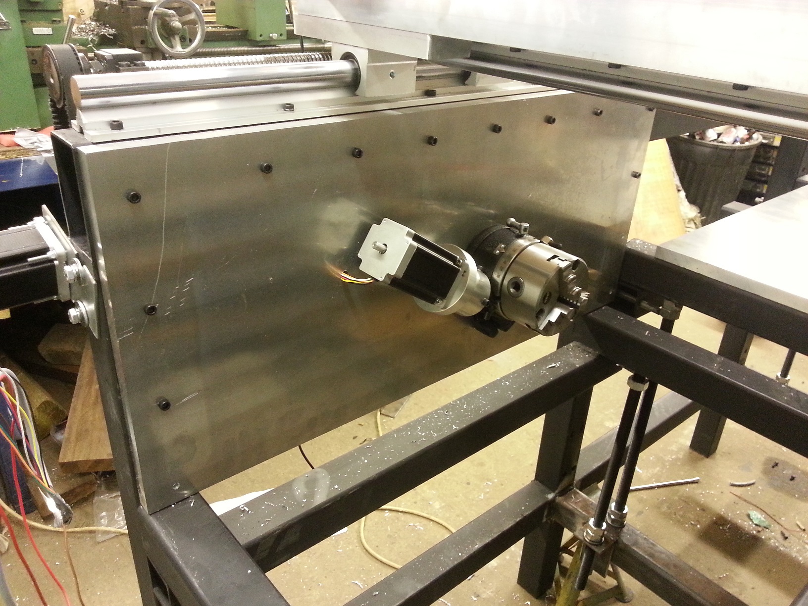

Hi.
I tried making a 4th axis using one of these cheap rotary tables off the bay
RDGTOOLS 100mm TILTING ROTARY TABLE & 100MM 3-JAW CHUCK | eBay
Attachment 9977
problem is, even if you exclude the stepper motor coupling, remove that altogether... one hand holding the input shaft, and the other on the chuck, you notice atleast 1mm of 'backlash' play.... unless you 'lock' it... which of course when used the way its intended (as a rotary table) is fine... but as a 4th axis its not.
so.... need a new plan... I need an accurate way of controlling a 100mm chuck from a stepper motor with minimal backlash
can anybody make any recommendations?

re: Diy 4th axis rotary table using 100mm chuck with minimal backlash
1 degree on a 100mm dia chuck is 100*3.142/360=0.87mm
20arcmnutes us .334 degrees so about 0.3mm
It sounds like you've not got the worm gear engaged properly. There worm gear is on an eccentric, so you can rotate the motor mount etc to push the gear into a tighter mesh, which will substantially reduce the backlash. There's a screw you undo, then the motor will rotate freely... it probably says in the instructions.
The rotary table you linked to wont be any better than the one you've got if it's adjusted properly.
P.S. You might want to put a grommet round the motor cables so that the aluminium plate doesn't cut them.
Hi M8
Check to see if your eccentric is at it's maximum travel, if it still has some throw left you could strip the unit down and try lapping the pinion and wheel with solvol autosol or similar, and then if needed make a new eccentric with slightly more throw (if you have to remove a lot of material for a snug fit between pinion and wheel)
