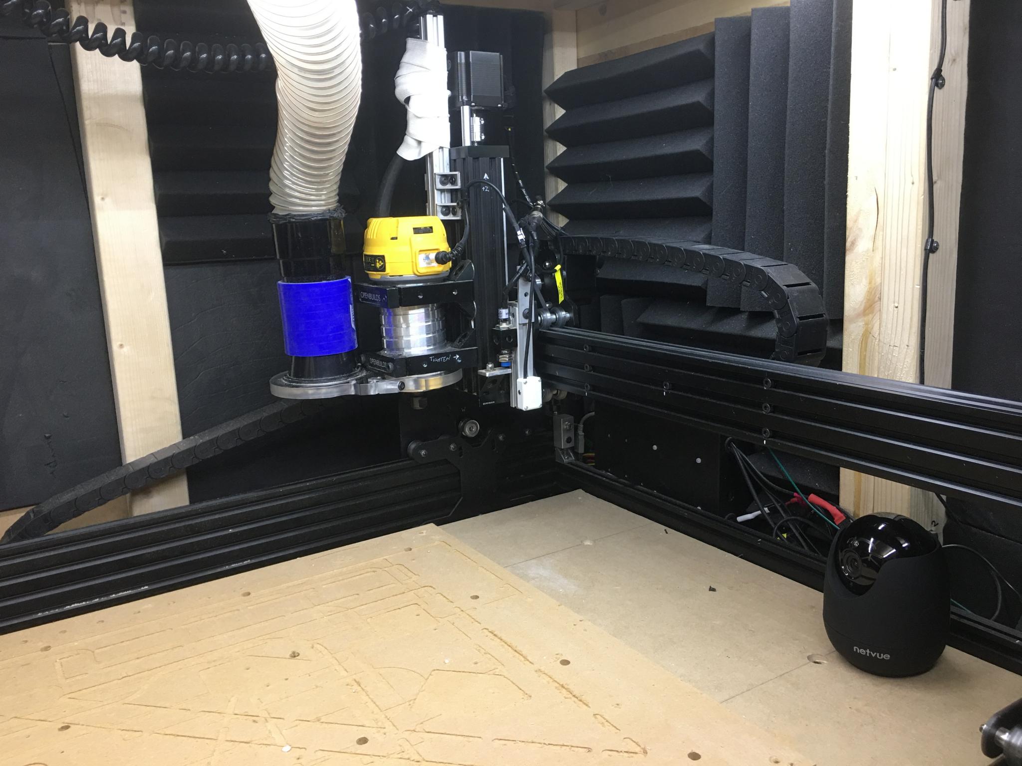

The round vs profile rail debate is one that has had me torn the most. Undoubtedly profile are superior in theory, in practice, however, I've been somewhat put off by the many worst case scenarios people have posted about when ordering the Chinese kind (which I strongly suspect is the only kind my budget allows).
This is the problem people only focus on those who have had issues, probably because they shout the loudest, but for everyone that as an issue there are 100's more who haven't and work perfectly fine.
Chinese VFD's and spindles being a classic case, I've lost count of how many sets of VFD/Spindles I've fitted and I've had about 3 failures in 10+yrs and those weren't all due to quality but more user error or wiring issues.
I was probably one of the first in UK to use the Cheap Chinese Linear rails and again I've fitted dozens of sets without any issues, Now I fit Hi-win because the price difference isn't too great, but both come from China so don't be put off. Either of them are far superior to round rail and worth the extra, trust me on this you won't regret buying them.
Juranovich
Second, being a first timer, I was hoping to get slightly more parallel mounting tolerance with the round rails (bc self alignment), and they provide more room for mounting ball screws on the same face (although that could also be achieved by spacers on the profile carriages). I'm curious though, in what way do you find profile to be less of a hassle?
Not quite sure what your meaning by Less hassle.? Less hassle than what.? Compared to using steel it's lot less hassle for obvious reason, try drilling and tapping 150 x M5 holes in steel and you'll understand this quickly.! . .Lol
If you are referring to my comment about using 45x90 because of the slot spacing being less hassle. Then I mean it's less hassle than having to make plates which first bolt to the profile so you can then mount the BK/BF bearings onto. Or having to Drill and tap the profile directly, which don't advise doing because never works out good. Like on this gantry that uses 40mm spaced slots and BK15 bearings with larger hole spacing.
Attachment 27138
Juranovich
With regards the bk/bf12, I thought bolt spacing was something like 46mm in which case standard t-slot nuts wouldn't work? Or is it merely a case of using good ol' force? .
The holes allow just enough wiggle room so that it works ok.
Juranovich
I long favoured flipping the ball screw and stepper positions, but figured ball screw placement as centrally as possible relative to the gantry rails took precedence over drop plate length.
I find comments you've seen made like these are made mostly by armchair theorists who have probably never built a machine.!
Because in the real world the difference between them is so negligible that you'll never see or notice any difference in how the machine performs. I've built all kinds of machines in all possible configurations and I've yet to see one that stands out to even slightest degree that says that's the best way.
End of the day if it fits your design best to have it raised up a little higher then go with it because you won't notice any difference if struggle on and have it the so-called "Optium" position.
The reason I say move it up is that being shorter it won't vibrate as much, which then goes into the screw, which then goes into the motor etc.
Also because the bracket is actually fastened to the top bearing plate anyway, the so-called optimum center position doesn't apply because the forces are being placed on the top bearing plate, not into the center of the Z-axis rear plate which is considered the Optimum position. So having it short means the forces are moved closer to the actual bearing plate which is what's being moved and makes everything that little bit stiffer.
Again don't stress over this stuff because it's not a game-changer or disastrous if not in the optimum place, you WON'T notice any difference. The little details like being stiffer or better-placed screws, motors, switches, etc make for a better more reliable machine than if a ball-screw isn't quite in the Optimum place.

First off- those are some slick looking machines! Also, I never considered using a cross beam under the frame for dual stepper set-ups.
The round vs profile rail debate is one that has had me torn the most. Undoubtedly profile are superior in theory, in practice, however, I've been somewhat put off by the many worst case scenarios people have posted about when ordering the Chinese kind (which I strongly suspect is the only kind my budget allows). Second, being a first timer, I was hoping to get slightly more parallel mounting tolerance with the round rails (bc self alignment), and they provide more room for mounting ball screws on the same face (although that could also be achieved by spacers on the profile carriages). I'm curious though, in what way do you find profile to be less of a hassle?
The square rails for me are may be the most important part of the machine in the long run, so there should not be any doubts about that. In fact better buy a smaller size square rails than round rails. mean 15 instead of 20 size , if machine is not intended for heavy duty use . You can always use one carriage more as they are cheap. rail is heavy hence expensive to ship. You get what i say?
About the Chinese square rails, if you buy from a good factory they are same or very similar quality like the Hiwin. You may need to clean a carriage or similar, but most important is to be from a good place.
I buy from these guys https://es.aliexpress.com/store/822038 12 and 15 size. Have not bought from them 20 size , but their rails are very good quality and price. Custom size also, contact them. make sure to buy the long carriages.

For info, I currently run a 6.8 KW HSD Spindle on my Concrete mill. If you look up my build thread (search for Thor), you will find it. I started with a 4KW Chinese spindle which worked OK. Low / no torque and ER collets, found a 2nd hand HSD spindle and not looked back.
Re: Was about to get a toy- then I did some research...
Chaz
The problem with hobby CNC machines using full sized spindles is weight. For example the reason most router based CNCs use router is because of weight either bogging the gantry down or causing the Z-axis to fall (like the Shapeoko, Ox etc). I think the Shapeoko actually used a SPRING at one time to help keep the router from dropping and not being able to get back up again. So a proper spindle is out of the question.
New builders also don’t take into account the weight of water in water cooled machines which is why it’s better to use an air cooled one on a smaller hobby machine. Plus water is another thing I would want to keep away from wood. I got some lubricant on my waste board the one time and it had to be replaced because it swelled up over night.
I think everyone I know of (bar one who went water cooled and had to go double belt and larger stepper motors before it would stop bogging down) has gone the air cooled spindle route. But if I could afford all metal underside and stronger steppers or drives there would be no question. In that case it would be water cooled all the way.
At the end of the day it all comes down to cost.

I use the popular 2.2KW water cooled spindle moved by a 1610 ballscrew which does fall slowly under it's own weight when the stepper motor power is removed. Part of my SOP is to put a prop under the Z axis before powering down the control box and removing it again after power is back on. It's not really a problem and I would expect to re-home after an e-stop anyway. No water leaks so far either.

A complete load of rubbish, do you know how much water is actually inside a water-cooled Spindle.? approx 250ml or 250grams.! How much does a fan and cowel weigh.?
If the Z axis can't handle that little extra weight then it needs re-thinking.! . . The truth is that if your Z-axis is this weak you cannot fit a Spindle of this size, it's got nothing to do with how it's cooled.
Your comments regards leaks and the damaging the bed is just laughable. They rarely leak when fitted correctly, I've fitted 100+ sets and never had one leak in use unless something caused it, like pipe got snagged or rubbed thru etc. Even then worst case it might wet the spoil board a little but it's not going to wreck the machine.
NeoMorph
Cannot blame the Tech because people select the wrong motors and underbuild Z-axis. There is also a reason why we tell people to avoid machines like shepeko with this being just one of them.!
NeoMorph
No at end of the day it comes down to if machine can handle the spindle or not.! . . . Not just the cost. From what your saying you have Shapeko type machine and the simple truth is these weak machines cannot handle large spindles like these. Got nothing to do with how it's cooled and everything to do with build quality.
Comments like your really piss me off because your actually discouraging people from using products which you clearly have little or no experience of using.
Anyone who's used an Air-cooled spindle then switched to WC spindle will say how much better they are. They also don't slag the Tech because the machine is rubbish.
Just the lower noise alone is enough for most people to switch but the fact the duty cycle is pretty much unlimited and the extra power they offer just blows the cheap Air-cooled spindles away.
Even much higher quality air-cooled spindles like HSD cannot match the cheap WC spindles when it comes to the duty cycle. Cheap air-cooled spindles are limited to just a few hours of constant running at high speeds which is useless to any decent machine. WC spindle will happily run for days at full speed.

This is my deformed Ox btw. Strange coincidence is that I only just found out that I was born in the year of the Ox in the Chinese calendar... and I ended up buying an Ox CNC machine. Go figure.
Attachment 27202
