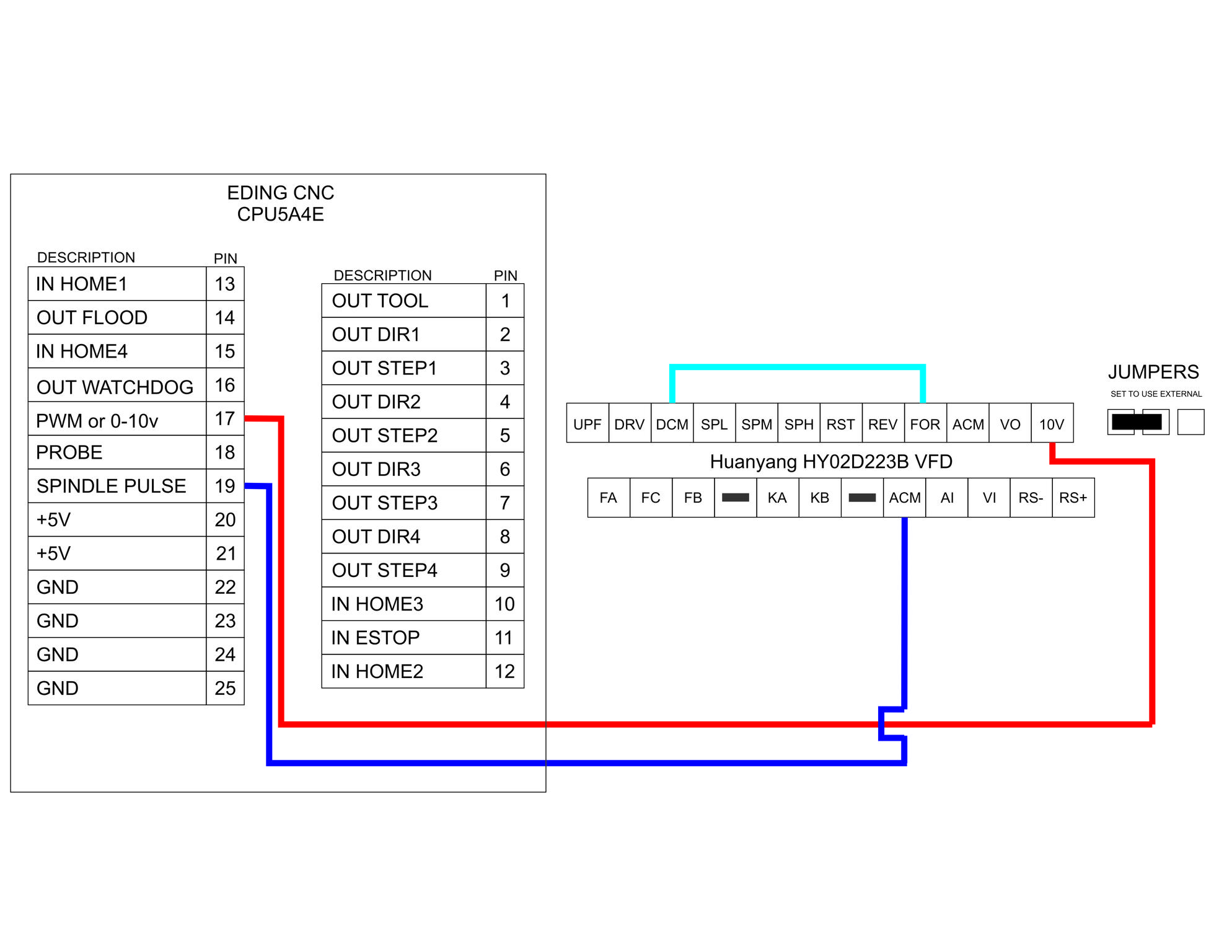

OK, guys so before I start plugging in wires is this diagram right?
I want to be able to start the spindle and control the RPM from the EDINGCNC Software
Link to the board manual in case needed http://www.edingcnc.com/upload/files/cpu5a_flyer_tech.pdf
Attachment 18338

Don't know if its just me but clicking on your diagram to view it locks my system, could be links blocked on my sysem for security reasons but only image on site I've tried to view that does this.

Not quite sure what it should be, but I don't think that there should be any connection to the "spindle sensor" pin. That's for sensing spindle position on a lathe for threading purposes, nothing to do with router spindle. I think you've wired the VFD so that it is forward-running only (no reverse, which seems reasonable) but there's no spindle start/stop signal from the board to VFD. I don't know how the Eding board and software handle for/rev or start/stop - I'm going through the same wiring design process with CSMIO/Mach3 and VFD which is a better-documented route.

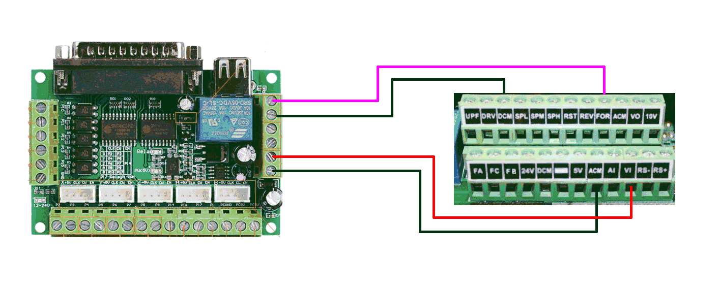

Here is how I have it wired:
Attachment 18339
I don't have the same board as you but it'll give you an idea. Red / black controls the speed, purple / black controls the start/stop :)

What board is that so I can get a little more info pal?

As far as I can see, the Eding manual says that you use the "tool" output pin as a start/stop signal to the VFD but I haven't worked out for myself which VFD pin it goes to yet - still reading that manual!
You're a gent! Thanks for taking the time!
I used to have the spindle running off the software but only start/stop I could control the RPM. The start stop was in pin 1 and pin 17
