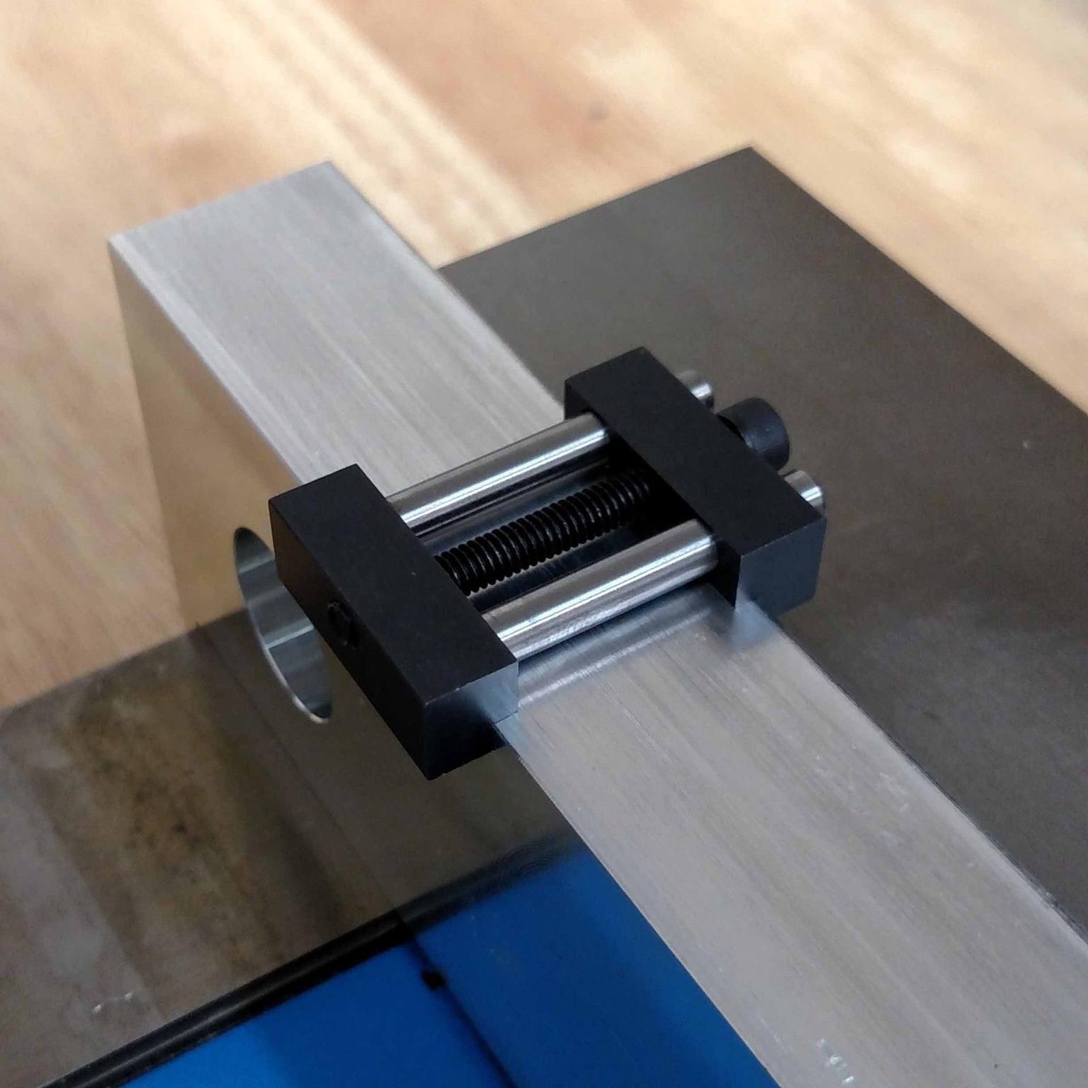

    When you say hardstop, do you use rubber in between the stop and gantry? if you do, will that not wear uneven?
    The 3d printing guys are al insane in their electronics and micro computers and programmes :D I want something else.. more industri, less mcguyver !
    When a machine is constructed correctly and precisely even moving with hand left screw / or nut in case of rotating nut/ moves easily gantry front back. When i say hard stop i mean a clamp or sth to be as a stop guide at end of the rail/ if there is a place.
    Vice stop locator on ebay. Imagine that is clamped at the end of the rails both one side so that when machine hits it gantry is straight square. there is a proper element in the Hiwin catalog but can not find it or remember its name. Definitely not rubber, as we are talking squaring gantry
