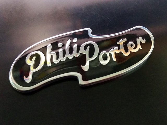

    Hehe. Hopefully not a mess... I've been having a go at the cold enamelling process and want to make as good a job of it as possible, hence the tank to squeeze out them bubbles...
    Here's a test piece that looks alright from a distance - I assumed the sparkle resin to be a paste and got my mixing ratios wrong and had to hurriedly mix in black paste after the pour. Loads of flaws in the epoxy, but it's got potential..!

    Looks good to me Wal!! Does pressure do it? I thought you vacuum degassed to pull out bubbles in things? Where do you get your cold enamel from? I fancy having a go myself
    Neil...
    Build log...here
    Wal's Avatar
    Yep, after a bit of research I decided to go with pressure - you can de-gas your mixed epoxy prior to pouring it (and that's probably best practice) but you'll end up pouring through the bubbles that accumulate on the surface and you'll likely introduce more bubbles whilst distributing and prodding the epoxy into the harder to reach areas. I can get a pretty bubble free mix by leaving the resin/hardener standing in advance and then taking care not to 'whisk' whilst mixing - you just need to go really steady with it. By allowing the epoxy to cure under pressure, you'll hopefully squeeze down any left-over bubbles - in theory 4 BAR should give a 4x reduction in volume of a given bubble.
