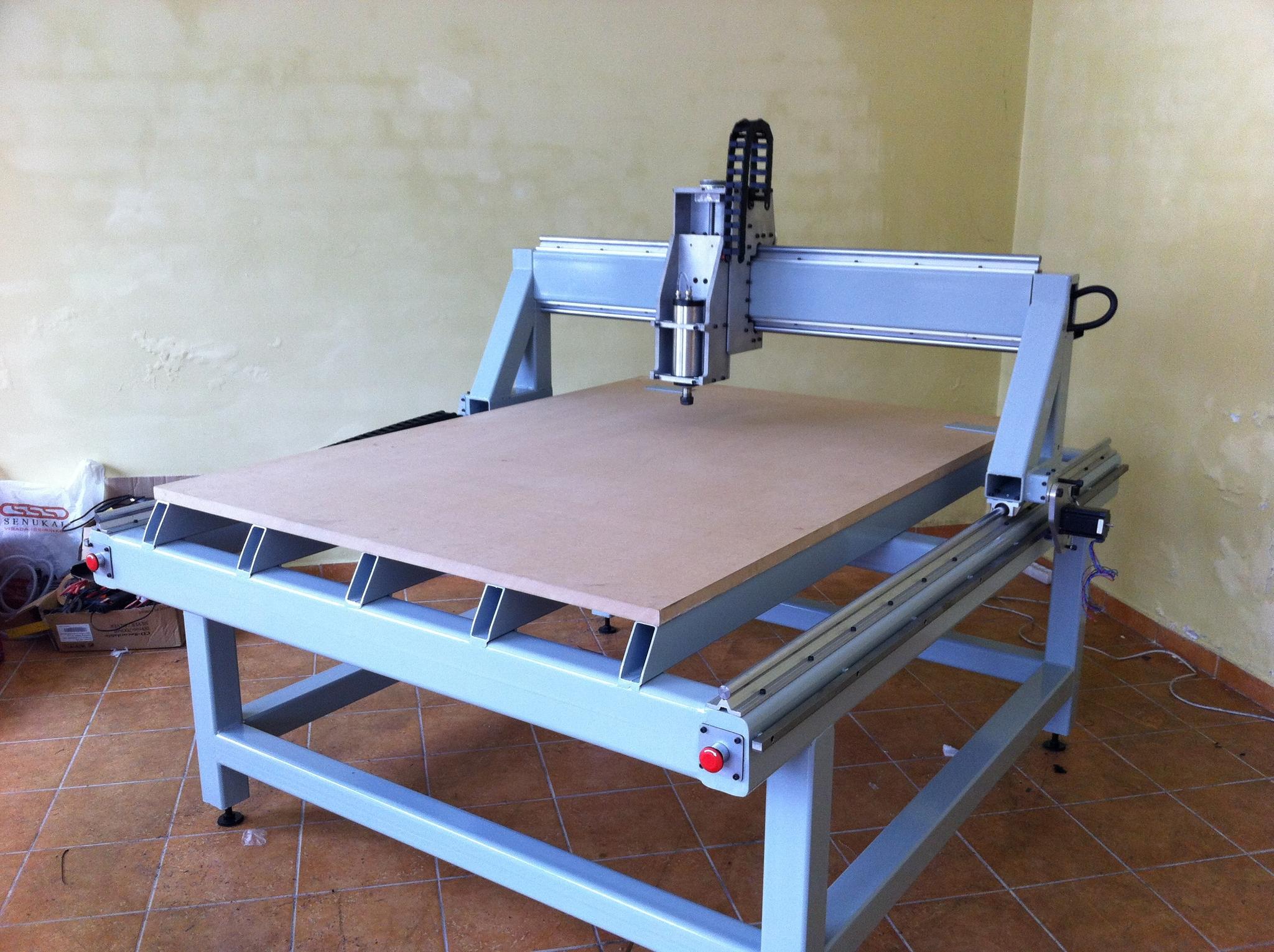

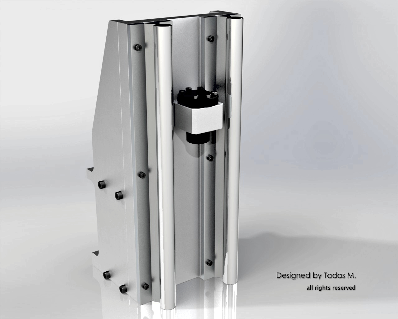

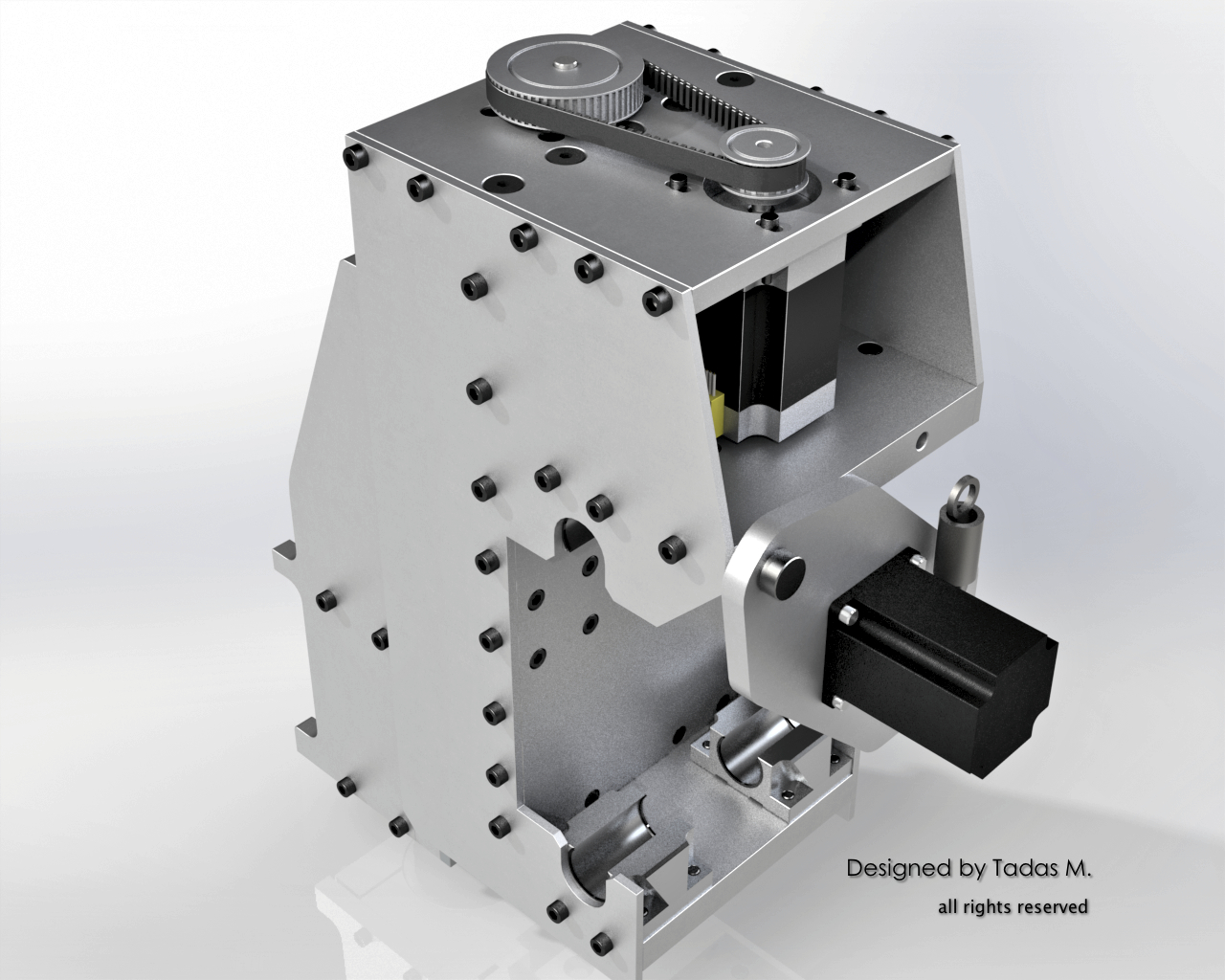

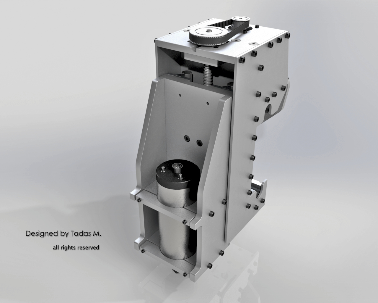

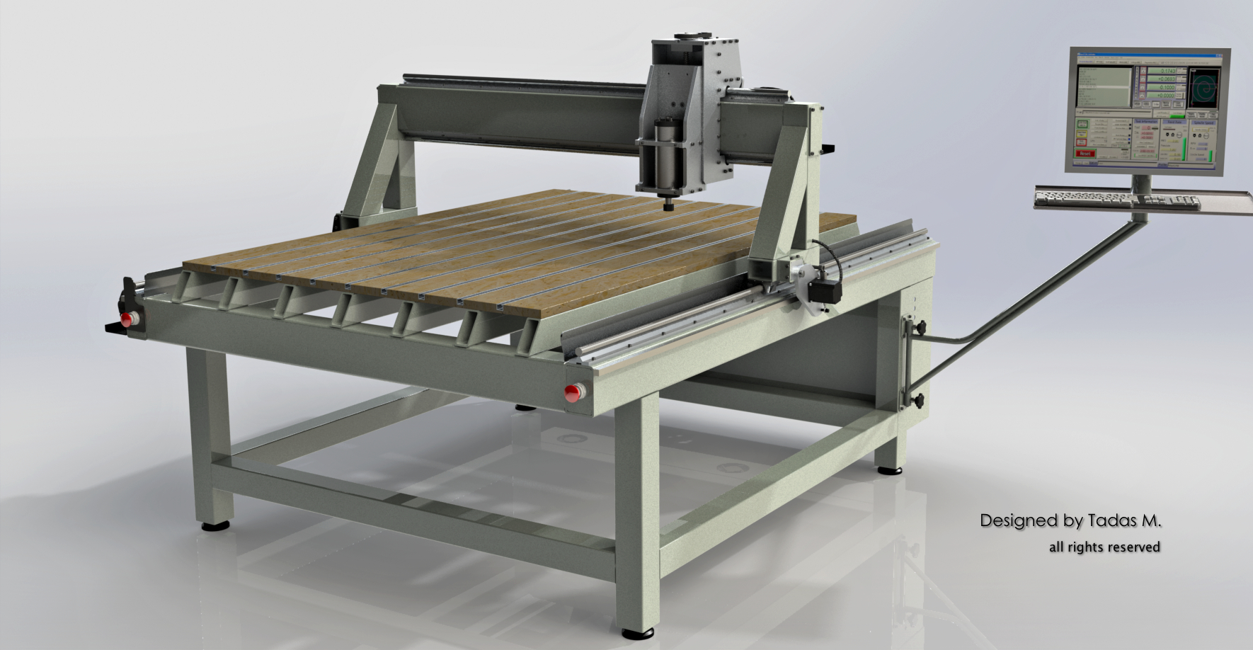

    Hello All,
    Some time ago I have built 1200x700mm machine and it was pretty clear what electronics, mechanics and other items to use. Now, some time has passed - I have decided to build small, desktop machine (approx 400x400mm). But facing challenge - what electronics to use. My pc's does not have parallel ports anymore - is there decent USB BOB, or should I use motion controller connected to BOB ? What BOB should I use, what motion controller should I use (if needed at all). I want to have reliable machine so I could cut wood, aluminium, etc.
    Any input, advice would be much appreciated :)
    Here is some pic's and video from my previous build:

    Hello Welcome,
    You made a nice job of that machine but has well electronics I'd look at using different components to what you used last time. Things have changed in last few years and now the price of Ballscrews and Profiled linear rails have dropped massively so with in reach of DIY budgets.
    Regards the Electrics then go with Digital drives not old analog type ie Not M542. Lead shine AM882 are a very good drives at ok money if bought from china. Thou for small machine you could use the slightly lesser spec Dm 556 with 50Vdc Max.
    Regards the Motion control then Ethernet is the best. For a small machine that doesn't use slaved axis then IP-M from Cslabs is by far the best. This doesn't need a BOB and comes with spindle speed control. It's very high quality unit with plenty of 24V I/O.
    Other alternative is ESS smooth stepper used with a BOB, extra Bobs can be used if more than 5 inputs are required. No speed control unless BOB comes with it and only 5v I/O so more prone to noise.
    These are the only two Motion controllers I'll use. I don't ike USB it's too unreliable but If I had to choose then the only one's I'd use are the UC300 or Pokeys 56CNC.
    Thank You for your advices JAZZCNC. Much appreciated.
    As for rails, I think to use MGN12 rails with MGN12H carriages for Z and X axis. For Y axis HGR15 with HGW15CA (or other type, depending on final design) carriages.
    I have concerns if MGN12 with MGN12H will be enough for Z and X axis ? (even though I have seen those used in small cnc machines).
    I really liked the CSMIO/IP-M 4-axis Ethernet Motion Controller, but in specs it shows that the spindle axis is not supported ?
    I have ordered 800w water cooled spindle from aliexpress (the size was the buying factor - 158 mm fits nicely in my design) I expect this will be good enough for small aluminium works ? :)
    As for stepper drives, I will go with DM556 (or if needed - AM882). But what about steppers ? What torque I would need? (I plan to use pulleys and make 2:1 gearing or just leave it 1:1). The size is important too - smaller steppers are better for my design :)
    Do I need closed loop steppers and drivers ? (are they worth the money ? )
