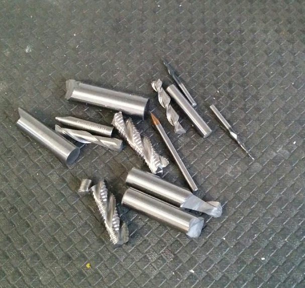

  5. Can someone help me out. I have a working machine for some time now, very happy with my first diy project. Till recently i thought i hit the limit with feeds and speeds but when i saw how much material can cut similar or even less robust machines i am getting frustrated that i cant cut much more (Chris's machine cuts very nicely https://youtu.be/6lyh3ctUCgk ). That would mean 3h job instead of 5-6h. So for example, my parameters for 10mm carbide cutter is 12mm doc, 0.5mm stepover and 4000mm/min at ~10k rpm. I mill aluminium 6082-T6. I have tried tons of combinations (ripper too), but this is the fastest i could cut without any issues. I cut dry with help of air and also with wd40. wd40 gives better results ofc. Whenever i go more stepover (with lover doc ofcourse) i break tool or it will about to. Countless broken tools. All 3 axis have 0.01mm or less free play, machine feels solid. Is there anything i can do or is this all i can get out of it? Could be the servo motors (400W KRS servos) not tuned properly? Or the machine is just not solid enough which i doubt. I plan to fill steel frame and bed with epoxy granite too. Is maybe problem in the spindle in a way. It has a little runout, about 0,01 or 0.02...
    Z axis doesn't have any counterbalance so the servo is holding the z weight. When cutting 3d contour and z axis is moving down, it is not smooth moving but i get steps on the part i mill. I fixed that with PID tuning. I didn't try that on x and y axis yet but i will asap.
    Any suggestions?
    Hi Matt,
    Looking good now mate.
    Are these adaptive toolpaths your using.? What Cam package.?
    How many flutes.?
    How long Flute lengths.?
    Also does the machine actually sound like that or is the video making it sound worse than it is.? Don't remember it sounding like that when we skyped.!

    I am using adaptive toolpaths with Autodesk Inventor HSM. I have used 2 flute, 3 flute, rippers. The only tool i didn't use was 1 flute. I have tested with tools diameter 10mm, 8mm, 6mm and had similar problems. Because of the nature of the workpiece i was mostly using long flute lengths (10mm x 45mm, 6mm x 35mm, 6mm x 20mm). I have tested with short flutes too ofc (10x26,8x20,6x16) and it's the same issue. The machine sound is so loud because the room is very small and echo is really loud on the camera. It's not that bad IRL but its not quite ether . Here is the last batch of broken tools

    Your machine looks pretty stiff so for cutting aluminium faster I would have a go with mist coolant. Lots of posts on here about how to do it so you don't fog up the workshop. Do you have a compressor ?
    Also it might not effect things greatly but the concrete will shrink a bit when dry so might pull away from the walls. I'd try the mist coolant first though.
