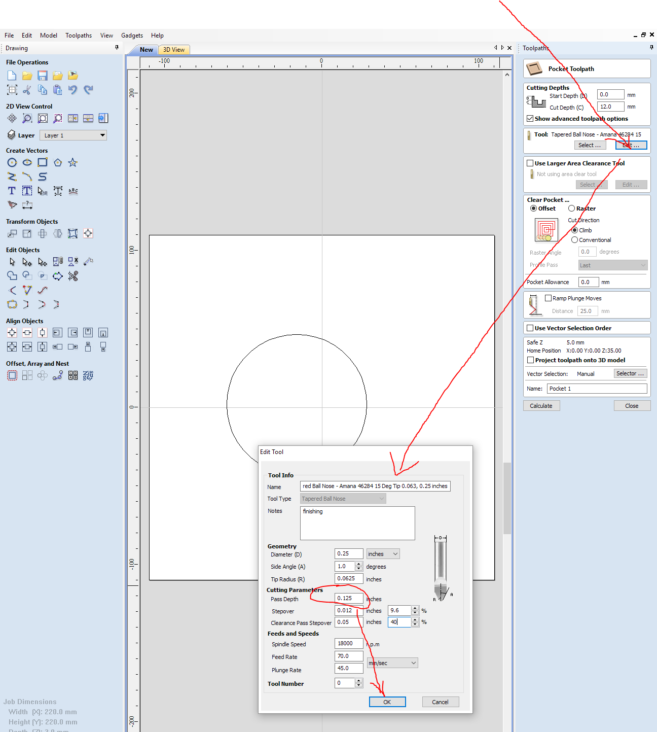

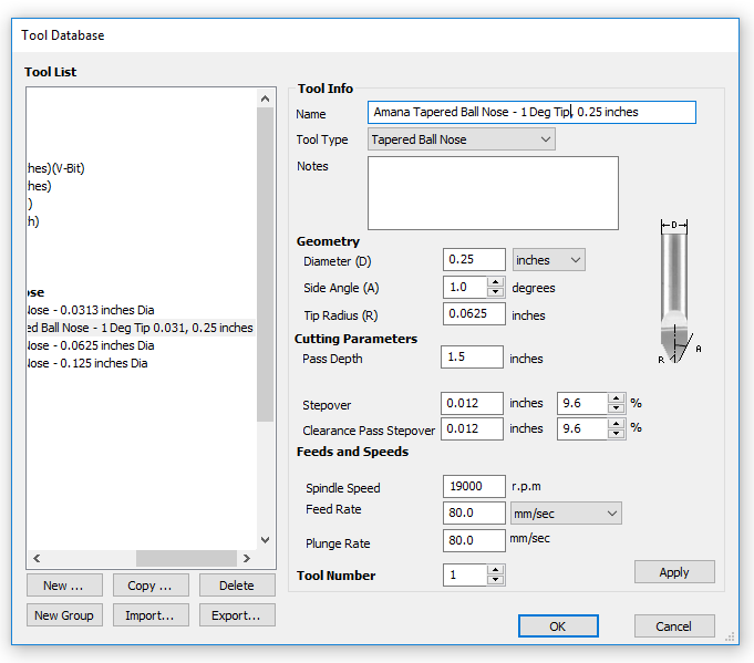

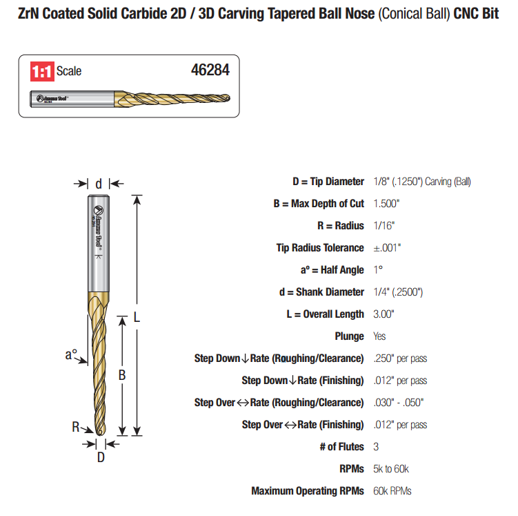

    I hope this is the right subforum. I purchased two tool bits from amana tool a couple of months ago and only just got round to putting the tool data into vectric. I'm just looking for some advice and a sign off on whether I input the tool settings into vectric okay.
    Below are the tool data and the screenshot of the input fields I used.
    Any help is appreciated. Thanks

    Well you don't say what machine or what you want to cut but some of the setting are wrong ie your pass depth you have set to 1.5" the data sheet says 0.25" roughing.
    The feed rate and plunge rate you have set to 80mm/sec that is 4.8mtr a minute without knowing what your machine is capable of it seems very high especially the plunge rate is miles too high.

    Thanks Clive for the fast reply. Yes, I made the mistake of taking the max depth of cut 1.5 as the pass depth, so as I am using this for finishing so I will use 0.012. Thank you for highlighting that for me, I'm new to all of this. My machine is a Gerber system 48. I'm still fine tuning the speeds on my machine, I will be working on it this weekend. That's why I thought I would look tool bits I bought with vectric this evening.
    Now I understand I was getting ahead of myself. At first, I was looking to use the above tool on some insulation foam and then onto solid woods. Thank you for the input below is a link to the machine running.

    Go back to Amana Tools and get the profile DXF use that to select the profile of the cutter you want to use and it sets it up in the toolbase as a tapered tool enter the settings and save.
    PM me if you need further help with the tools DXF I might be able to let you have a copy, by the way as Clive say's somethings not quite right with the machine don't go cutting anything yet till it's sorted.

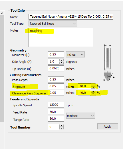

    There is no need to go back to amana tools for the shape. The angle is correct for cutting length. I checked it. its very easy in fact. In Aspire introduce B of tool as cut depth and change angle to bigger, its not possible, cause geometry is not correct, etc...
    Here are the correct ways to fill the tool / + the ~correct feeds and speeds at 18k rpm, adjust accordingly knowing the chiploads if you like different rpm/
    rough cut:

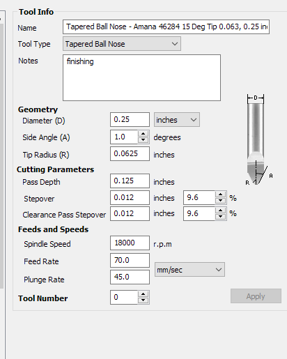

    finishing cut:

    I suggest you follow what i say and save them as 2 different tools with same % for clearance and finishing as above at picture, otherwise you will make mistake sooner or later. If you save them properly as per Aspire says with different percentage, then you have to change cut depth at each operation:
    when changing this way pass depth or anything in tool parameters , you change only that particular toolpath, tool will not change in database if you call it for a new toolpath for example...

    Thanks Boyan for doing the workings out I will definitely be saving them both and follow your instruction.
